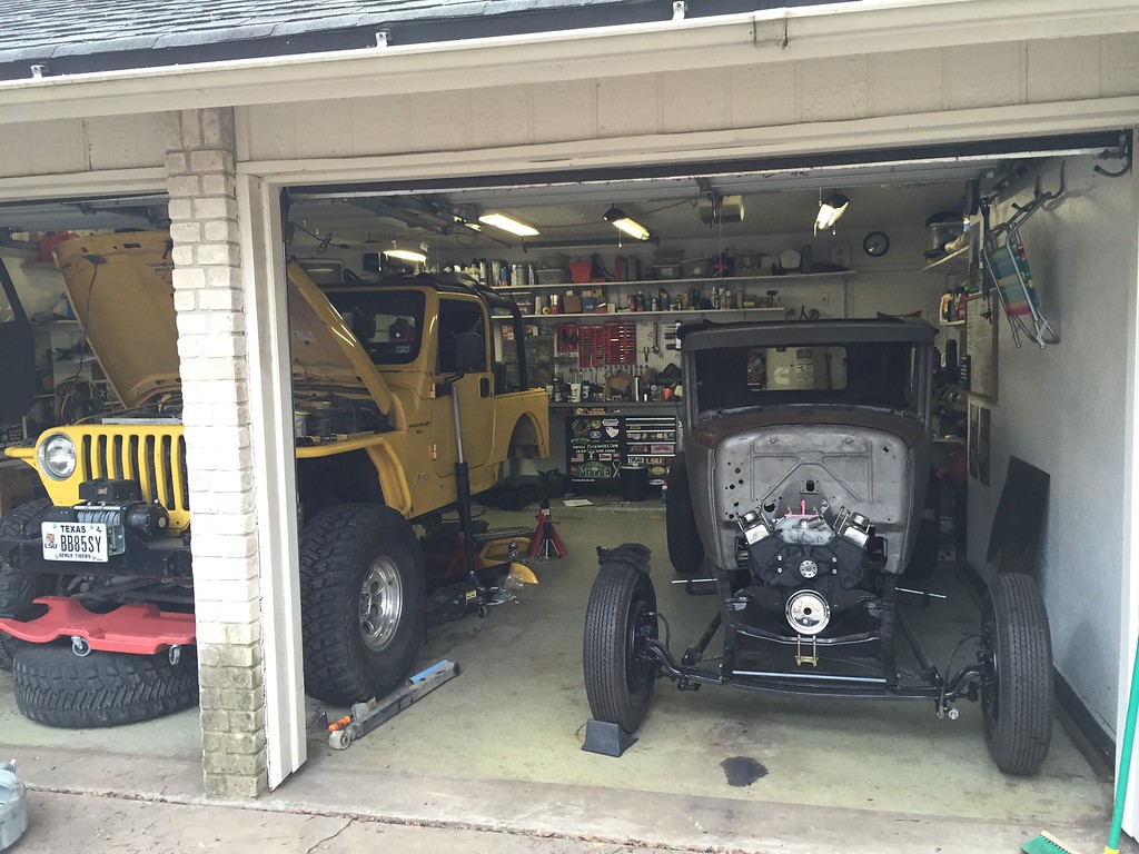

    Back from the dead! :) Yes, I still have the coupe and yes, I am still planning to build it. I've been swamped with Jeep projects these days, but within the next week or three I should have my garage back and am looking forward to getting back onto the A. First order of business will be to build some subframes so I can get the body properly mounted to the rails.
    But since the car is still essentially just a big pile of parts, I think it's time to start planning on upgrades for the motor, right? Ha!

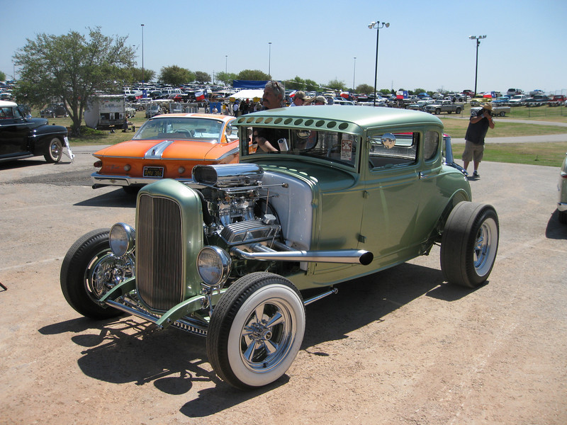

    A buddy of mine may have a lead on a 6-71 blower set up for a SBC. I don't like how low motors sit in non-channeled hot rods and always had this thought in the back of my head that a blower would give me the look I'm after. Of course, the added power would be kinda okay, too. ;)
    So here's my question... I'm a traditionalist, but am not a die-hard about it. How "traditional" is a 6-71 on a SBC for a late '50s style build? Were they on the street or just the track? Multi carb or single? What kind of linkages were they running? I'm excited about the power potential (just looking for ~500 hp eventually), but I'd like to keep this thing looking as period correct as is reasonably possible. So I'm looking for info. on this, but figured I'd post here and resurrect this thread to see if any of you had thoughts.

  11. woodhawg
    Joined: Apr 11, 2009
    Posts: 1,021
    woodhawg
    A voice from the past. Good to hear you still got the A and are still planning to get it running again. Can't answer your ? about blowers in the 50's, but can say I have a friend that has a 31 Chevy 2 door with a blower on a SBC and it looks COOL!!!! and runs pretty good too.
