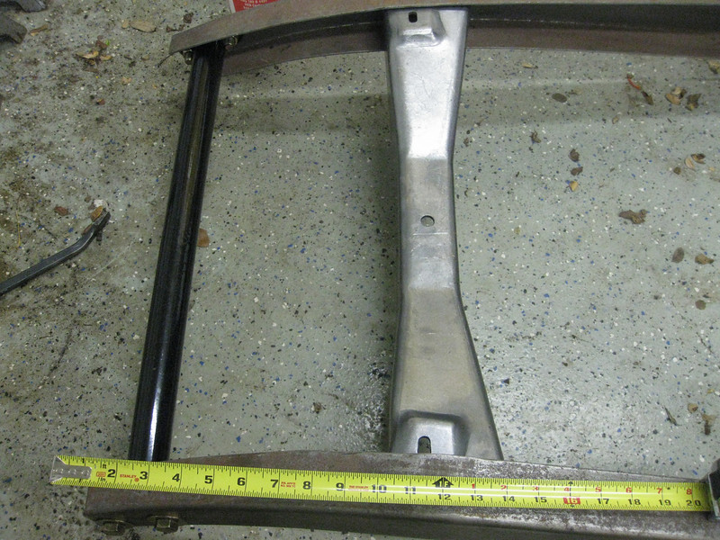

    In fact, looking at Rolf's front crossmember placement (also on reproduction rails) looks fairly similar to where mine is currently mocked up. Hopefully he won't mind me linking a photo of his!
    And mine:

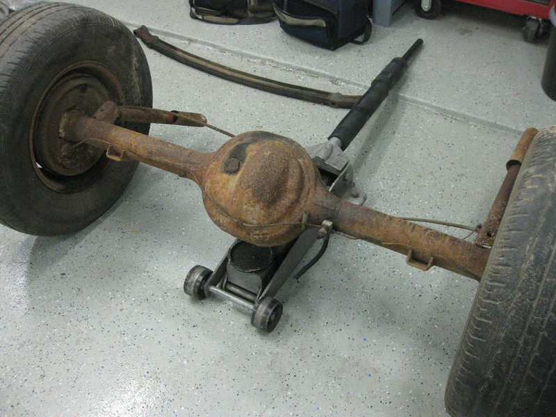

    Picked up a rear axle yesterday. It's a 9" from a '71 early Bronco so it's got a 58" WMS to WMS width. The good news is it's only got 58k miles, came from a running truck, and it's got 4.11 gears which will match up nicely with my T5 trans (not purchased yet) and 7.50-16 tires. The bads news it's in dire need of a good cleaning and maybe some rebuilding....and it's an open diff. However, a friend of mine in Chicago just replaced his center section in his Bronco so he's selling me his with a Trac-Lok. I'll rebuild it and will have a 4.11 geared, limited slipped, 9" to move this thing down the road....just like I wanted. :)

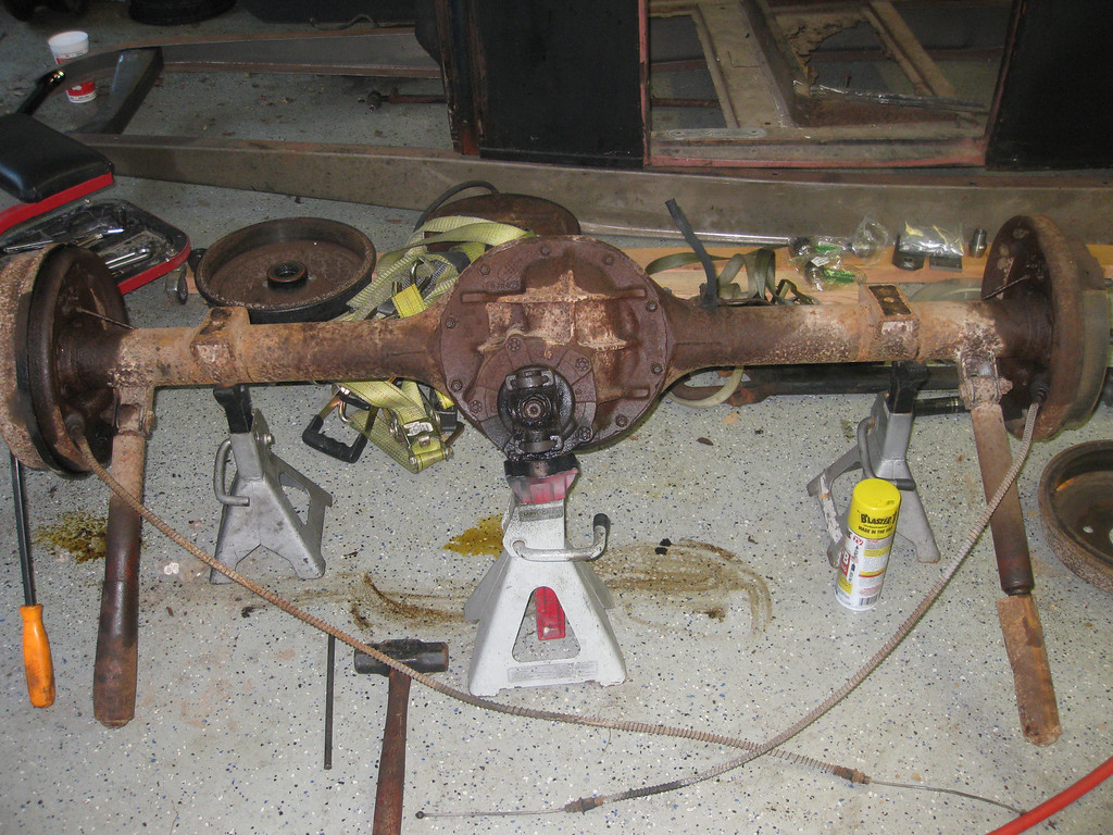

    Last night I did a little more research on my 9" axle. First off, I wanted to verify the 4.11 ratio. The pass. side brake drum was dragging inconsistently making it impossible to rotate the pinion and count axle rotations. Since it's an open diff I just locked that axle down with a pry bar (see pic below) and spun the other axle shaft and counted the pinion rotations. Just over 2 rotations which confirms the 4.11 gears it's supposed to have. Good! Now I just need to get that brake drum off. It's rusted on there pretty badly. Any ideas? It's already soaking in PB and has received several smacks from a MFH. I'm hoping not to use the BFH unless absolutely necessary. ;)
    Best I can tell using info. from this site, it must be a '66 model axle since it has a contoured back end, but also a rear fill plug. This may be the only year for such an axle? It also appears to be the common C7AW-E case, which is a good thing since it is reportedly stronger than earlier cases. I think the stamping is inside the case so I can't confirm this 'til I remove the center section.
    Here's some pics...

    See that little metal tag on the bolt where the center section bolts to the housing.....That tells all the info about rear diff and housing, such as year, gear ratio, posi or open drive, etc. etc. etc. Go to Google and search "ford 9 inch specs" or something like that... Here's the link I used. the info you want is way down the page. Hope this helps...

    Thanks, man... That site has been great in helping me ID my axle. Came across it about a week or so ago when I was Googling 9" stuff. :) The ID tag does (barely) list "4 11" as the ratio, but that's no guarantee someone hasn't changed them out at some point so I definitely wanted to verify. The tag is pretty crusty anyway and is pretty hard to read.
    So I was able to verify it's a '66 model based on the fact that it has a rear fill plug and contoured rear "hump" on the housing. It's also got the tell tale signs of being a big bearing axle (11" drums, stepped up tube diameter at the flange). I haven't pulled the case out yet, but the freewheeling motion and the ID tag both point to an open diff, as the seller stated. The Trac-Lok should be here next week sometime. I did get the brake drums off yesterday so once I wire wheel the entire housing I'll start on the disassembly and rebuilding.
    Unfortunately, my g/f and I are flying to Ohio for a wedding this weekend so I may not work on it 'til next week. Bummer.... On the bright side, we're heading to Cedar Point to ride some killer roller coasters after the wedding! :D

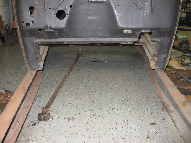

    I also snapped a couple pics of my body on the frame rails. Keep in mind that the body is merely placed approximately where I suspect it will end up. The cowl is ~46" from the leading edge of the frame. You can see how it doesn't look like it'll need much of a pinch to get the sides of the cowl to drop outside the frame. Maybe I should consider a pie cut of the cowl instead of a pinch? I'm open to suggestions here... I do plan on a "mini-channel" to get the cowl to sit flush with the frame rails.
    Passenger side:
    Driver side:
    And a profile shot mocked up approximately where I think it should go, but I need to verify this.

    I'm not sure what you mean. Keep in mind the body is merely placed on the rails right now. It's easily several inches "off" in its placement. I just mocked it up approximately where I thought it goes, but I'm sure it's off the mark. :) However, if you see something wrong with my frame rails, please let me know! I thought about following Moose's ides, but I'm not sure the effort is worth it to me. I think I would be content with just a slight pinch. Of course, exactly where and how much to pinch is what I need to determine.
    What I'm thinking about doing is use the stock rear axle location, but move the front crossmember forward maybe an inch or so to get more engine bay room. Wheelbase would be at 107" if I do that. Once the wheelbase is set and crossmembers are in place, I would pinch the rails.

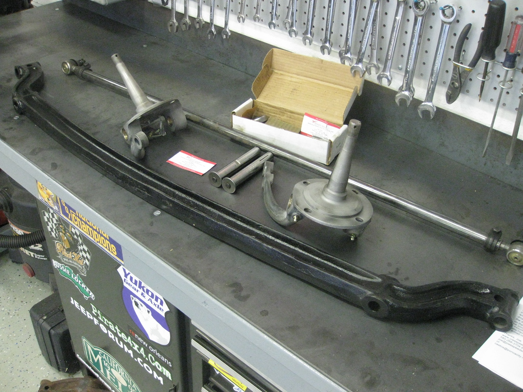

    Came home from work yesterday and had a nice package waiting on the front porch from Oklahoma.
    It's an orig. Model A axle that Joe Castro of Joe's Speed Shop worked over for me. It's a 4" drop and I sent him my spindles so he could bend the arms and also align the whole front end. He also installed new kingpins/bushings and I picked up one of his tie rods, too. Something tells me this may be the best money I've spent on the car yet...
