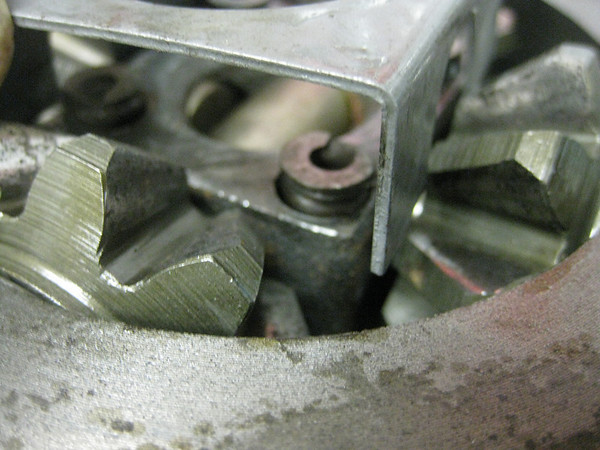

    Anyway I got some pictures of the diff this weekend. I haven't fully ***embled it 'cause I don't have my new ring gear bolts yet, but I did come across a question. Basically, on page 2 of the Trac Lok rebuild instruction (right here), it says to install shims of .050", but mine only measured .029". Later on in the procedure, they tell you to use a special tool to determine if you need to add or remove shims from the .050" to achieve the proper amount of preload. I ***ume the .029" shims worked for the old clutches/plates, but how can I determine if they'll work for the new ones?
    Anyway, here's the pics of the process. If anyone sees something out of the ordinary, please speak up!
    First, I installed the two shims that came out of the diff. They total .029" in thickness.
    New clutch pack going in.
    Clips going in.
    Side gear washer.
    Side gear.
    The other half. I did notice some pitting on the spider gears, but it was very minimal and I've seen way worse. I haven't yet dis***embled the pins to check for wear on them or the thrust washers.
    Preload springs.
    Looking close you can see two edges of the block are chamfered, the other are not.
    I put the plate over the chamfered corners.
    And here are the outer halves ready to be ***embled. I did a test fit and it seems like it'll take a fair amount of force to fully compress the two halves....which I ***ume is the way it ought to be. ;)

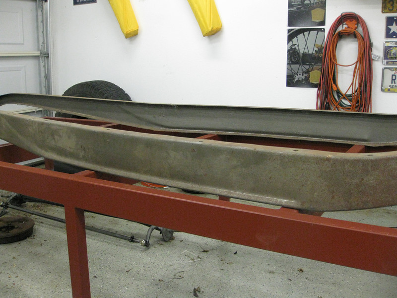

    Continuing with baby steps, but this was an important one today. I sourced a frame table and am pretty stoked about it. Now I can start squaring up the ch***is and making sparks!
    Looks like the flat portion of the ch***is rests on only two cross bars, but I suppose that's good enough?

    I could barely sleep last night trying to put together the gameplan for getting the ch***is work done. I think first of all I need to wire wheel the rear axle and gut it so I can put it on the table and start setting up my wheelbase and crossmember locations.
    But I've got a question about boxing the frame...
    I figured I'll weld in the front and rear crossmembers before boxing it, but should I box the frame before installing the K-member and ladder bar mount? Also, what thickness do most of y'all use for boxing the frame? I ***ume .120" or 1/8" sheet would do the trick since that's the thickness of the ch***is (I think). I'm planning to recess the boxing panels 1/2" inside the frame rails or is that not worth the extra labor? I figured it would be nice to clean up the underside when routing lines/hoses? But I'm obviously open to thoughts on this... ;)

    i used 10 ga or .134 grade 50 just because it was available and i cut them my self on the laser. as for when to box them i think your on the right track, i boxed them after the front and rear crossmembers were burnt in.
    what are your plans for the suspension? on my 32 truck im using a ch***is engineering 4" drop and reverse eye spring. in the rear i welded the model a crossmember as high as it would go and with my stock t spring it sits level. im sure my rear spring is fatigued because i didnt have to spread it to fit in the 35/36 bones. the tires and rims also all match on all 4 corners.
    hope this helps and keep up the progress!
