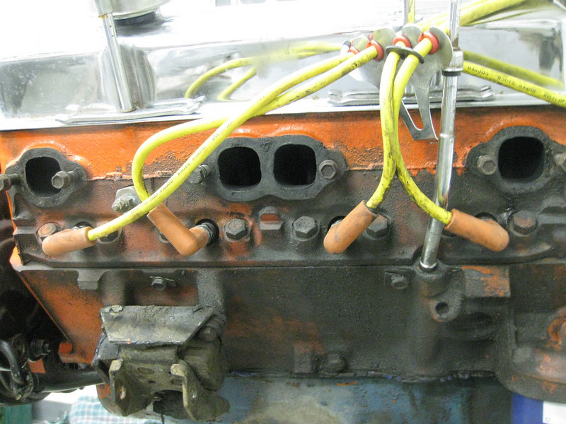

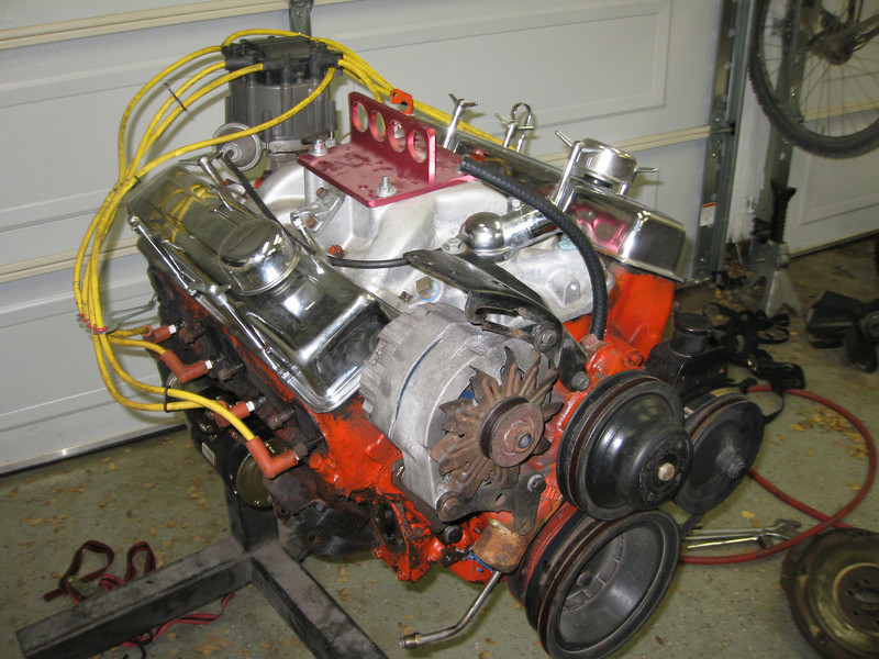

    Picked up the motor and trans tonight. It's got an Edelbrock Performer intake, fuel pump, accessories, distributor (HEI), and a pretty mild cam of unknown origin. The heads are 291 Camel Humps so they have 64cc combustion chambers and I assume 1.94/1.50 valves, but I can't confirm. Here's some pics of the heads.
    The ports are covered in carbon. The car's been running rich for a long time apparently.

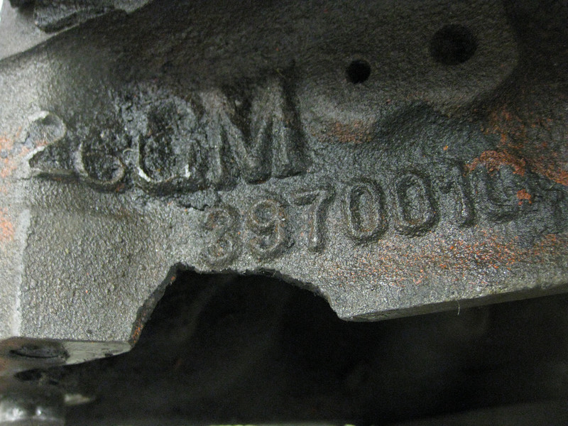

    Best I can tell, the block is a '73 truck 350. 2 or 4 bolt is unknown. Casting number is V0306TJZ. There's a small chunk broken off the back, but doesn't look structural.

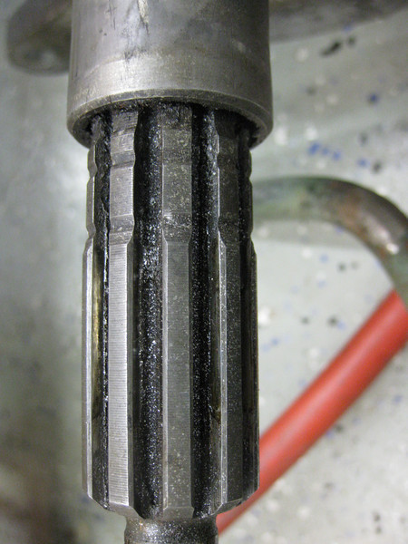

    The Saginaw came with a Hurst shifter for a 2nd gen F-Body, bellhousing, p-plate, clutch, etc.
    Looks like a 2 groove to me. If so, that would confirm the ratios I posted earlier (3.11, 2.20, 1.46, 1).

    Your block casting number,on the bellhousing flange(3970010),next to the break decodes as either;
    327cu. in. '68-'69 'vette,Camaro and other high perf applications.
    OR
    350 cu. in. '68-'79 Truck and high perf applications,4-bolt though some were machined for 2-bolt mains.
    Head casting number(3917291) comes up as '68-'69 350 & 327 and,'67-'70 302 & 327.
    Hope this helps.

    Thanks, Mark! That jives with the info. I've been coming up with, too. :)

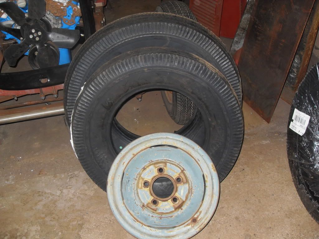

    I ordered my rear tires a few weeks ago. I knew I wanted 7.50-16s. But I was debating between 5.50's and 6.00's for the front. I finally went for the 5.50's and they arrived today. As you can see, they have a different tread pattern than the 7.50's. Is this normal? The sidewalls are the same and they're both Firestone "Deluxe Champion" or whatever they're called. Truth be told they look like the same tread pattern, but siped.

  17. The tires are perfectly normal. exact same tires im running on my a.

    Thanks, man. I was curious. I even asked the rep from Coker about it 'cause their site doesn't show any pictures of this tire at all....not even a whitewall version. I wonder if the 6.00 has the same pattern? If so, that likely would've been enough to push me over the edge to the 6.00 after all. It's not that big a deal, though... :)

    Hey Tommy,yes,the 6.00x16 Firestone has the same design tread as the 7.00 and 7.50.That's one of the reasons why I chose them over the 5.60.
    7.00x16 rear,6.00x16 front;
  23. Tommy R

  27. No problem. Ya the 600s are more like your 750s tread pattern. but they look good. assuming your putting them on 16" 1940 - 1948 ford wheels theyll look like this:

    I wish I'd known of the tread difference before I ordered. I may have gone with the 6.00s after all. But it's no big deal. At least the sidewall is the same and that's more important to me. I'm sure I'll be plenty happy with the 5.50s for awhile... :D

    Dude...the 5.50's are gonna look way better overall. Size difference between the two can still be seen when driving down the road....the tread pattern can't.....haha.
    Real hotrods have mismatched tires anyway........
