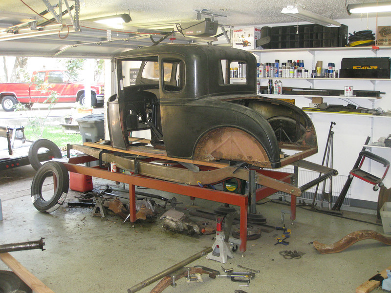

    Here's how things set right now. The body is on top of the chassis in a super duper high boy configuration. ;) We set it so body's rear axle centerline lines up with the orignal '32's rear axle. We placed the rear axle under the chassis (it barely fit), but I didn't get a pic of that.
    And here's the center chunk from the 9". Nasty....
    I've got a couple different options in front of me on exactly how to proceed from here, all of which were suggested by people whom I respect very much. Just trying to decide which way to go. As is typical, I'm suffering from analysis paralysis....as my friend Chris told me! :eek:

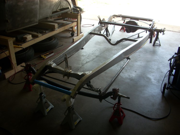

    No, Paul, it's not. The rails aren't boxed yet, either. But I was going to wait to put the trans crossmember in 'til the motor was mocked up. I'm always open to suggestions, though....

    I dont think you need to go over 106". If you get the crossmembers in, box it up then get your suspension together and in roller form, then you can drop the body on the frame where it's gonna be. At that point you can play with the motor position. I'm sure it'll fit, Mark shoehorned that god damn hemi in his and he didn't reverse or recess the firewall or anything like that. It sits high too. Which will be neat in yours cause you wont have to get any weird pump risers or anything. You will have to trim up the firewall and make a trans tunnel though..

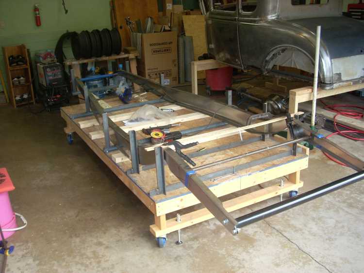

    Yeah, I'd prefer the motor to sit higher than lower! Fabbing up a tunnel and trimming the firewall isn't a big deal, though. I actually spoke to Mark on Saturday about it and he said the hemi is actually not that long, just wide (that what she said). Not sure how it compares to a SBC's length, though.
    Tell me if this plan is flawed thinking:
    Right now the frame is jigged up solid on the frame table. The width of the chassis looks like it'll match well with the body both front and rear, so I don't see any pinching that's needed. So why can't I just box the rails, weld in the front/rear crossmembers to set the wheelbase, and weld in the front ladder bar mount? Basically, everything would be in place except for the trans crossmember. This way I could have a solid roller.
    Then I would trim the body to get it to set on the chassis, place the motor/tranny in to make the motor/tranny mounts, and depending on how much clearance is needed for the motor I can either move the radiator forward a bit and/or recess the firewall.
    Mark's suggestion to me was basically the same thing, but only tack everything in place before test fitting the body on the rolling chassis. Then once everything is verified to work together, jig up the chassis again and do final burn in.
    That's obviously good logic, too....and I'm inclined to follow it. The only added hassle would be jigging up the chassis a second time, but that's really not that big a deal.

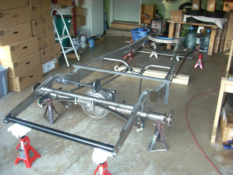

    Yessiree! So here's the short term plan. Let me know y'all's thoughts on it.....
    1. While in the jig, tack the boxing rails into place.
    2. Tack front/rear crossmembers into place with 106-107" WB and tack in front ladder bar mount.
    3. Tack in new temporary chassis supports and cut away current supports that prevent the body from sitting on the rails.
    4. Assemble tacked-together rolling chassis.
    5. Trim rear body subframe rails and place body onto rolling chassis to ensure proper fit and determine whether or not any pinching is needed front or rear.
    6. Attach motor to trans and move into position in the chassis to determine motor mount and trans mount locations.
    7. Re-jig chassis to frame table and do final weld for everything that was tacked into place.
    8. Assemble fully welded roller!
    Of course, to do this properly, I'll need to get the proper sized distributor and shorter water pump and accessories. If anyone has leads on this stuff, let me know. Other than the shorter water pump, I don't know what parts I need.

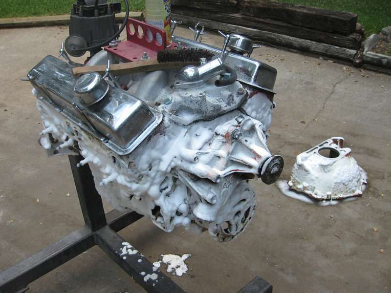

    First, I need to get jiggy with the oven cleaner to get the crud off the motor. Here it is soaking in the cheap stuff (which works better than the pricier stuff). Next to it you'll see a '55 Chevy bellhousing, which I decided to use in conjunction with the Hurst style motor mount. Unfortunately, the motor will need quite a bit more cleaning to be ready for primer/color.

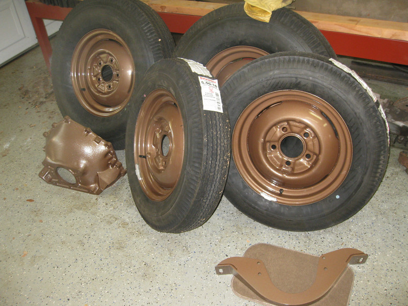

    So I got the paint mixed up and my buddy learned me how to use my new Eastwood paint gun. Things went really well! FYI, there is a huge blower (not pictured) pulling fumes away, but next time I'll wear a respirator anyway.
    Now I've got good news and bad news. The good news is that my wheels/tires are now mounted up. The first bad news is that the color is more brown than bronze. I'm not sure if it needs to be more gold or what, but it doesn't quite pop the way I'd hoped. No worries, though....I honestly didn't figure I'd get it right the first time anyway! Good thing I need to repaint 'cause the guy who mounted them for me put the tires on top of the wheels and scuffed them pretty badly. Whatever, these wheels are awfully pitted anyway and I think I'll need to replace them.
    Blah, blah, blah....here's some pics of the 5.50s and 7.50s in the garage. I also painted the bellhousing and motor mount.

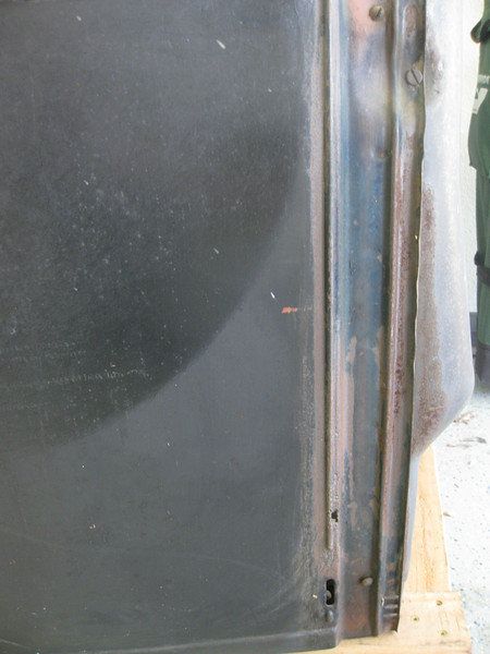

    And finally, this is something that caught me off guard. It took the light shining into the garage in just a way that I could see it, but take a look at the area at the front of the cowl. Looks blue, doesn't it?
    I guess there once was some welting in that area? So it would seem to be the car was originally blue, but was repainted black (with a brush) at some point in its history. But evidently, the welting wasn't removed so it kept the blue underneath. The funny thing is I've only seriously considered two colors for the body of this car: blue and black. Black had recently gotten the nod. But how in the hell have I owned this body for 2 years and never saw this until now...when I'm finally dealing with paint for the first time? Maybe the car's telling me something or maybe I'm just losing my mind.....but I've decided the car will now be blue.
    It won't be the original blue because that's way too light. I'm going to opt for a darker blue. And I think the wheels/etc. will definitely need a different color. Scott Miller's coupe (below) is an approximate example of what I'm thinking, color-wise. Dark blue (maybe not quite that dark), but I'm thinking of more of a gold accent color than the champagne on his.
