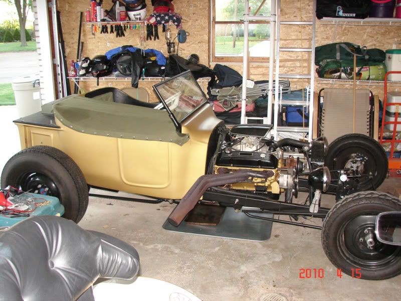

  1. So i use to have a tonneau on my bucket a couple years ago. Since i had taken it apart to paint the body, the snaps never went back on. Now finding out my girlfriend is going to be outa state for roller derby most weekends of the good shows, i figured id put the tonneau back on. Went and picked up some gold snaps this time and put it back together. Ill have to re-do it this year since this was the first version, and sitting around in the garage it got some stains. But canvas is cheap and i got a ton of snaps laying around.
    One thing i gotta figure out is getting some better bows for it. Right now it has some fiberglass rods but those ripped through the pockets i made for it. Im thinking i need to make a rod that will slide into the dash and over the rear lip of the body then snap it over it.
    Anyway, here is what i got so far.

    Eddie, Dynatech stock car headers ??
    Looks cool !
  3. Schoenfield but practically the same thing. They sound good but I think I might be swapping them for some lake headers when I get some money.

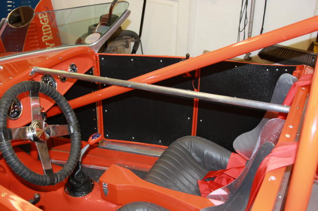

  6. I made a bolt in bar from the dash to the rear of the tub and installed the male snaps in it. The tonneau half for the pass. side snaps on to it and the body and it's tight with no other support required. There is a zipper on the center side which mates to a zipper for the drivers cover. Sorry, I don't have a pic with just the pass. side in place.
    It's nice and watertight for when it gets parked in the rain and with the pass cover I don't worry so much about exposed gear.

    good topic, its one of the things I have been thinking about but not sure how to accomplish. was wondering how they did split covers so you can have the passenger side covered while you drive (to keep some heat in)
  8. There is a flap on the pass. cover (towards the driver) that has a zipper sewed in it. The flap is to the left of the support bar. The other half of the zipper is on the driver's side cover. You can remove or reinstall the driver's side without removing the pass. side. The support bar is offset to the pass. side a couple inches to give me a little more shoulder room.
