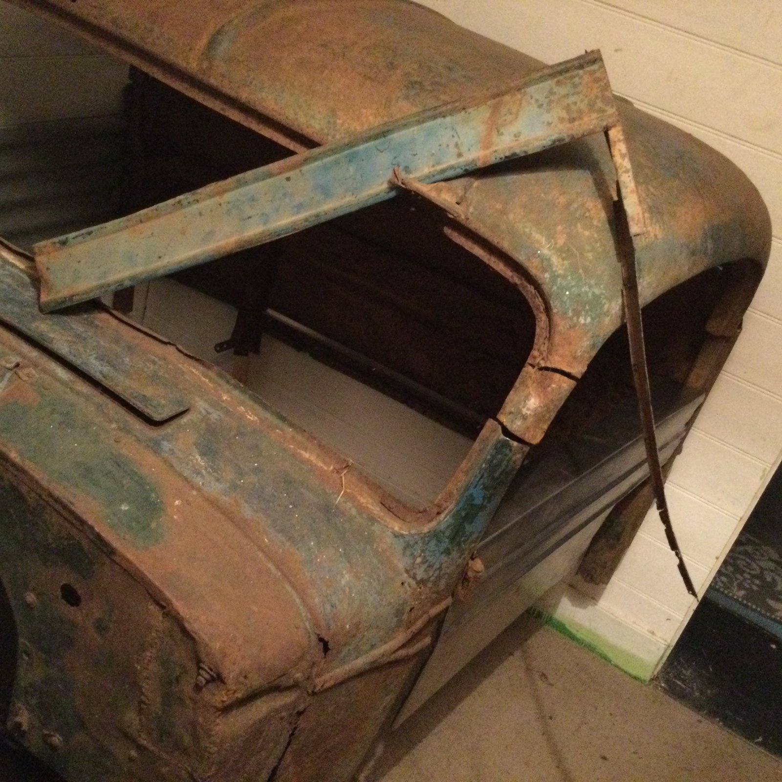

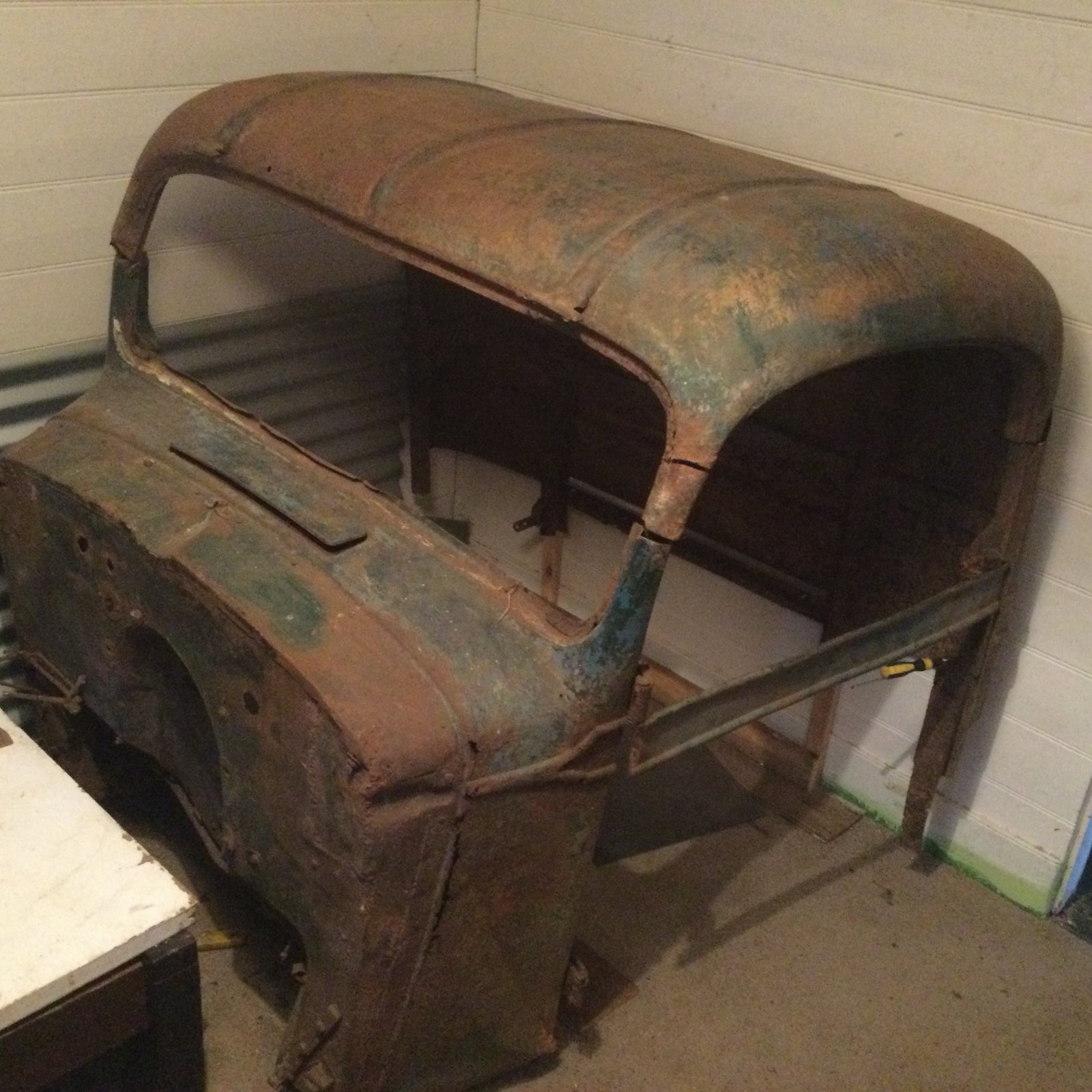

    I first discovered it when I was wondering through the bush above town nearly two decades ago. It had been cut up and dumped down a shallow mine shaft. At first I was going to leave it but decided that since it was cut up I might be able to drag the best bits of it home.
    One of the first things that I collected was the roof as it is the most solid out of all of it. Due to the isolated location, I had to drag it through the bush to my car.

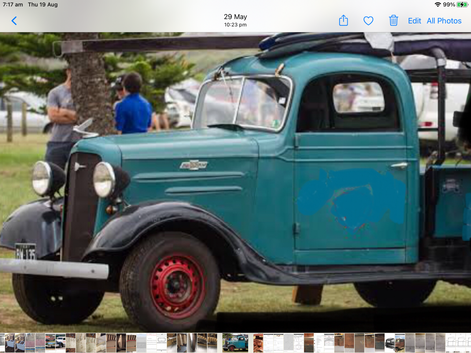

    I took my time collecting the bits and the cowl was the very last thing I collected in 2017. Due to its decrepit condition and weight, I was unsure if it was worth the effort, but decided in the end it was. I had a brain wave and purchased a trolley which made retrieving it a lot easier.

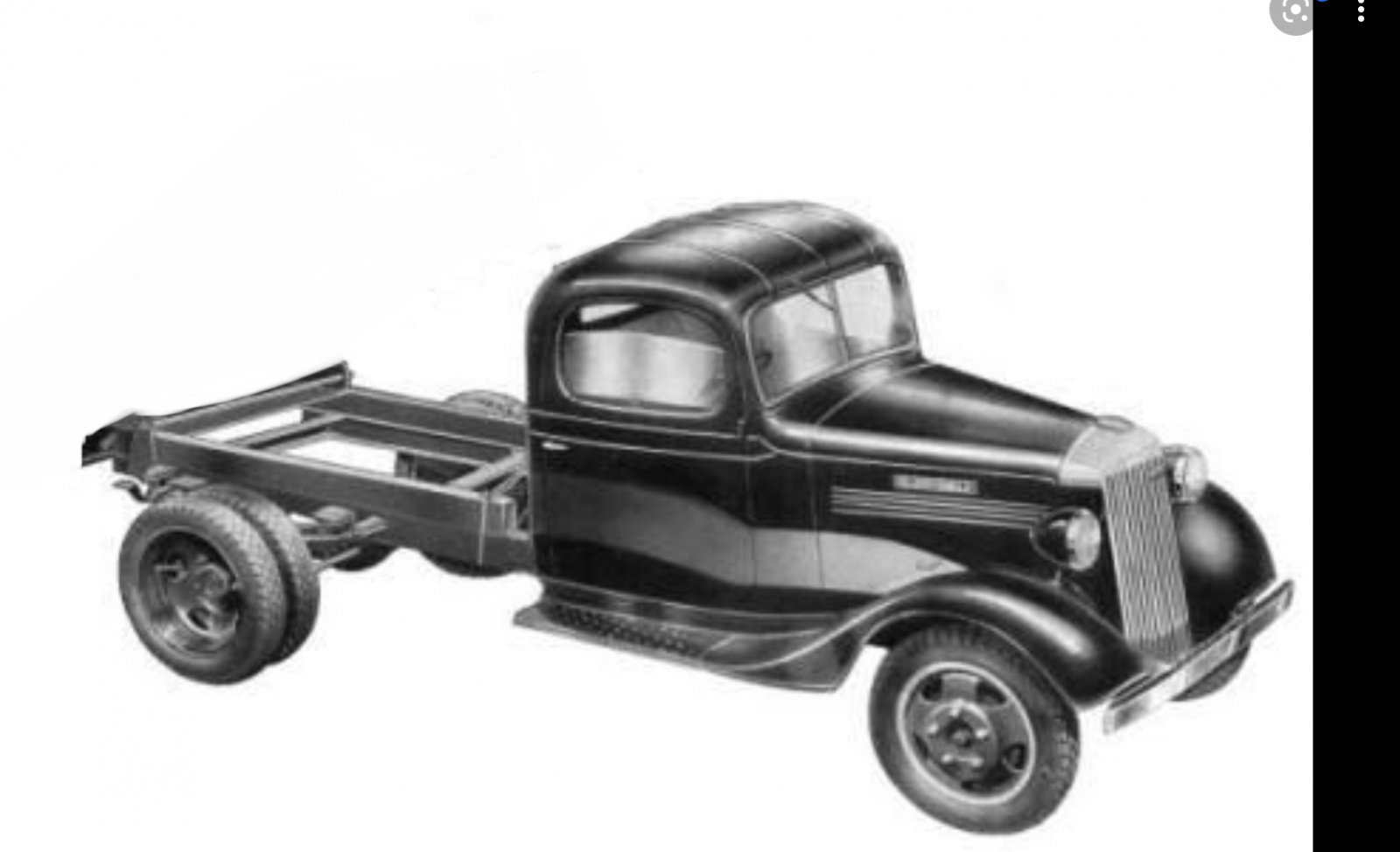

    This is what it would have looked like when it left the factory.

    What I salvaged was the cab cut into three sections, the top of the hood, one of the front fenders, and the p***enger side door, minus the window frame.

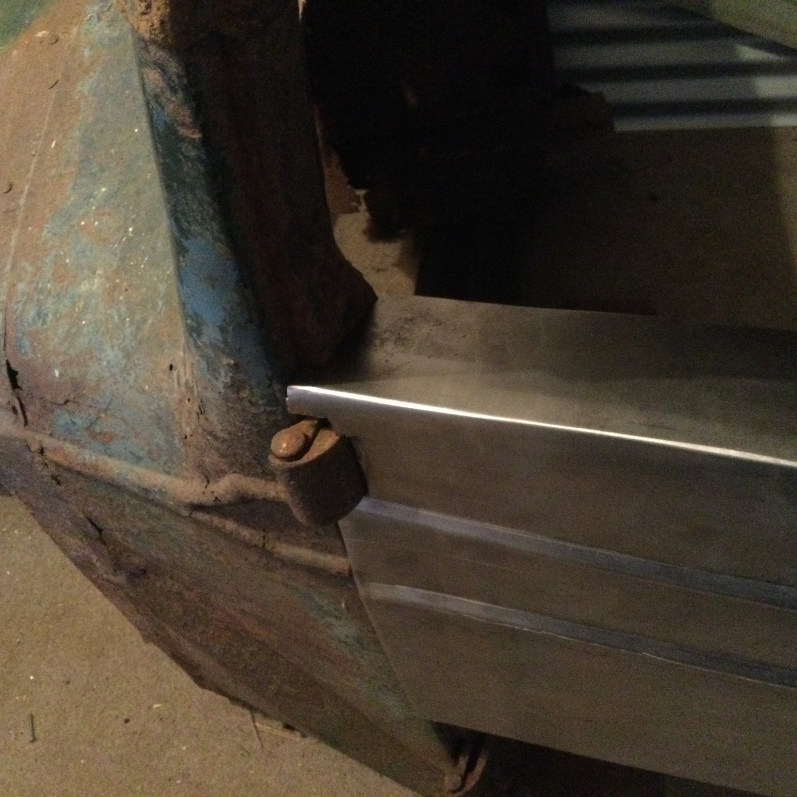

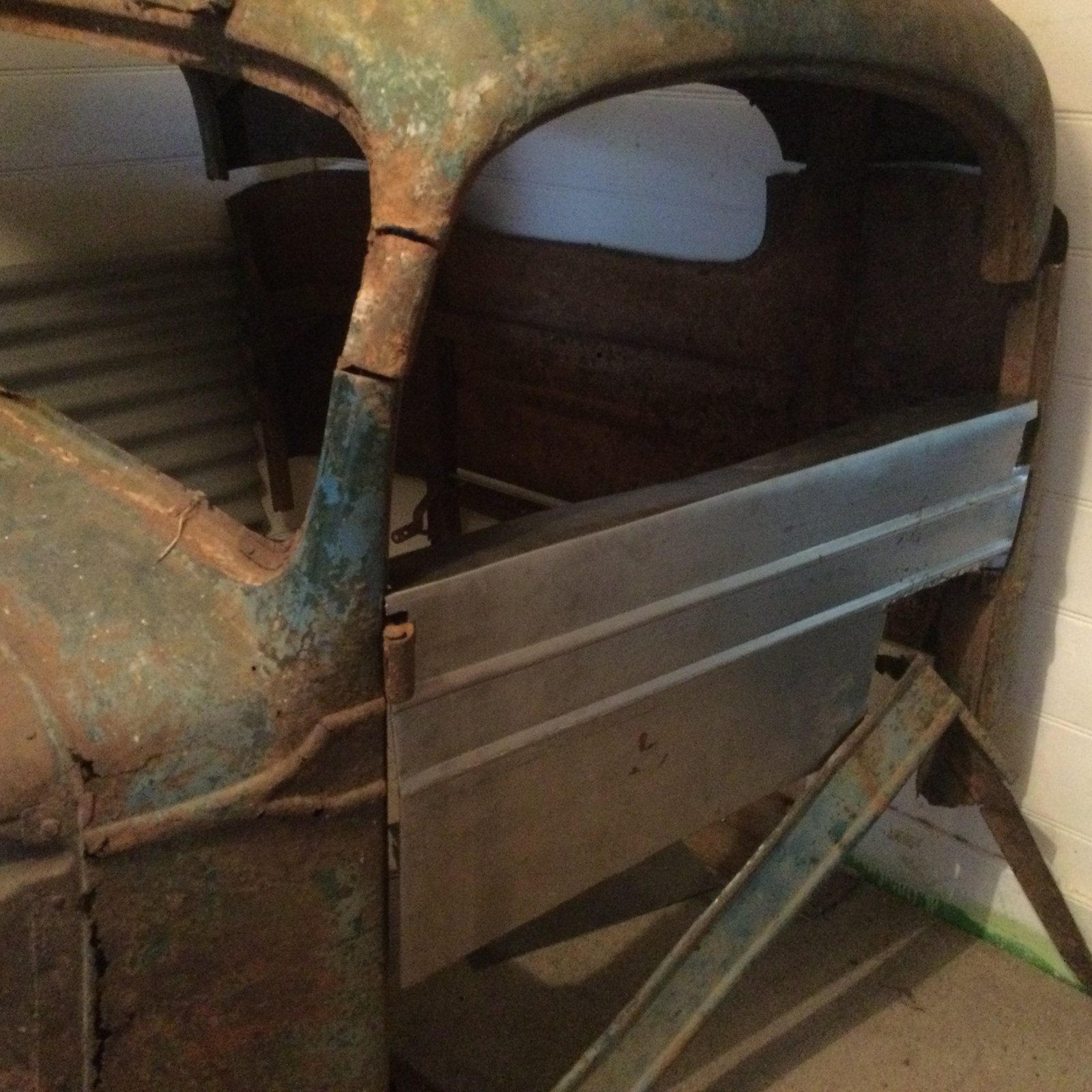

    Unfortunately I sold off the hood and the door got cut up for the lower part of what was left of the window frame and the lower skin, so I could finish building a 39 Willys Pickup Cab. I was careful however to save the double swage part of the door. The front of the swage is facing the cowl . 0F3062D1-2FA9-4285-9C13-0F27C57D8AAA.jpeg

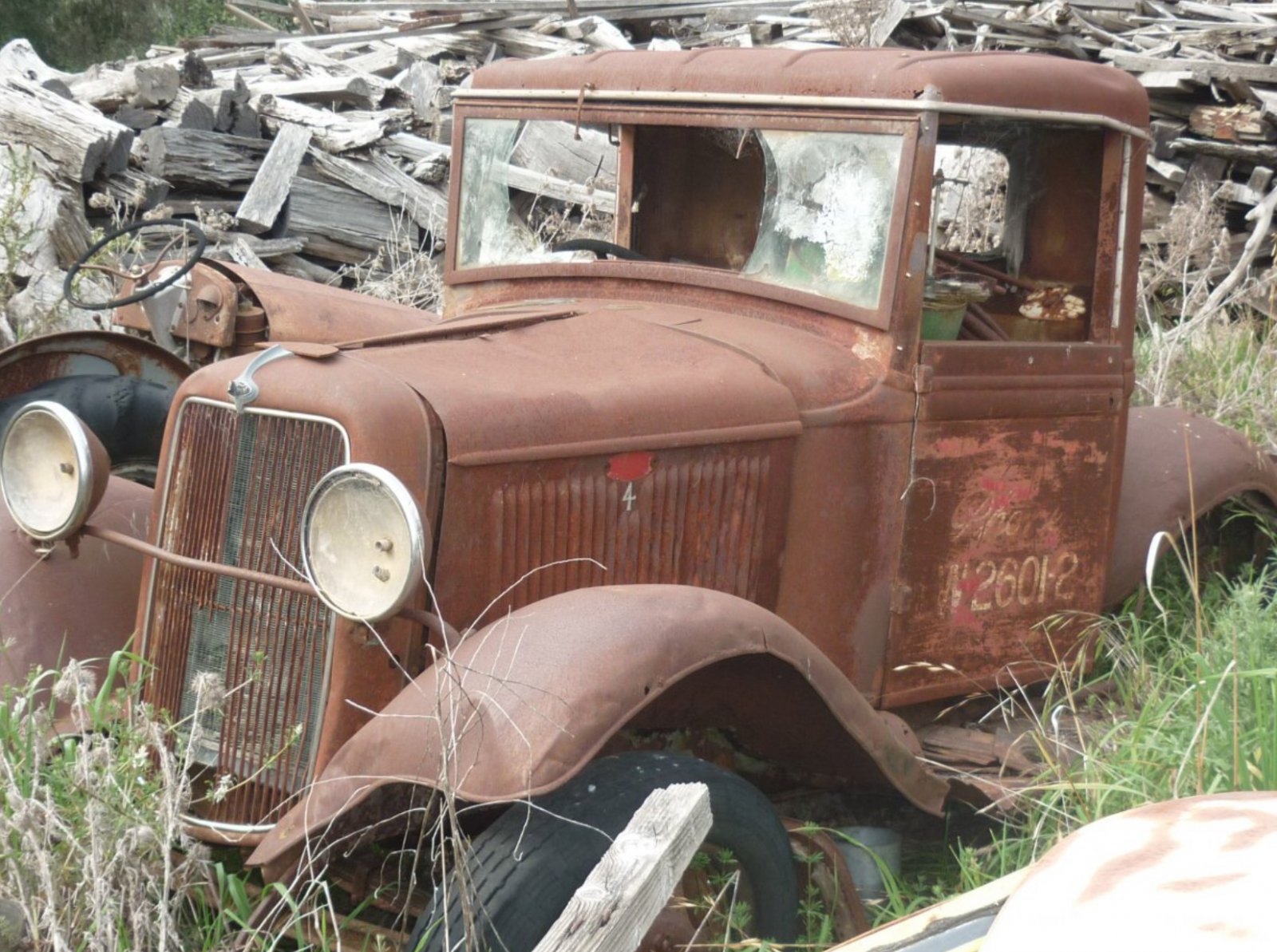

    Last year I picked up these.

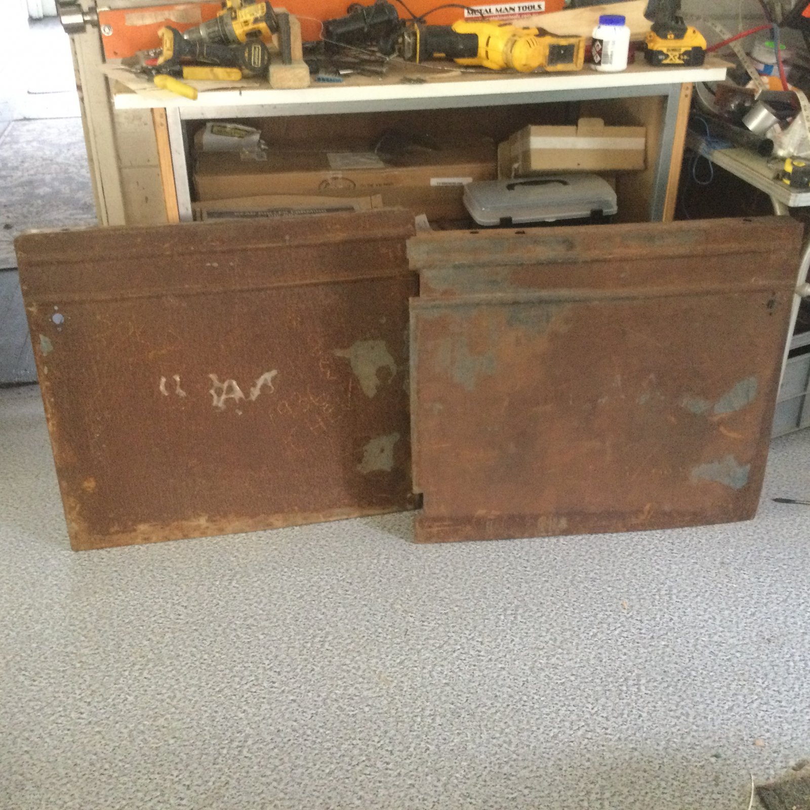

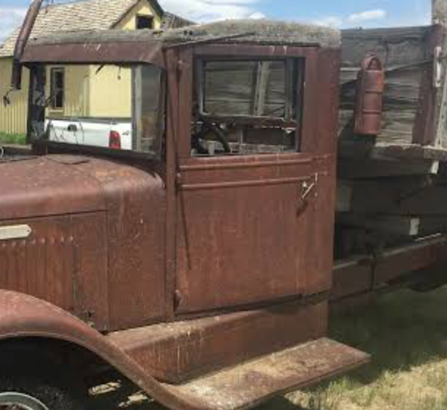

    Ford and Holden made these roadster style doors for their trucks right into the mid Thirties.

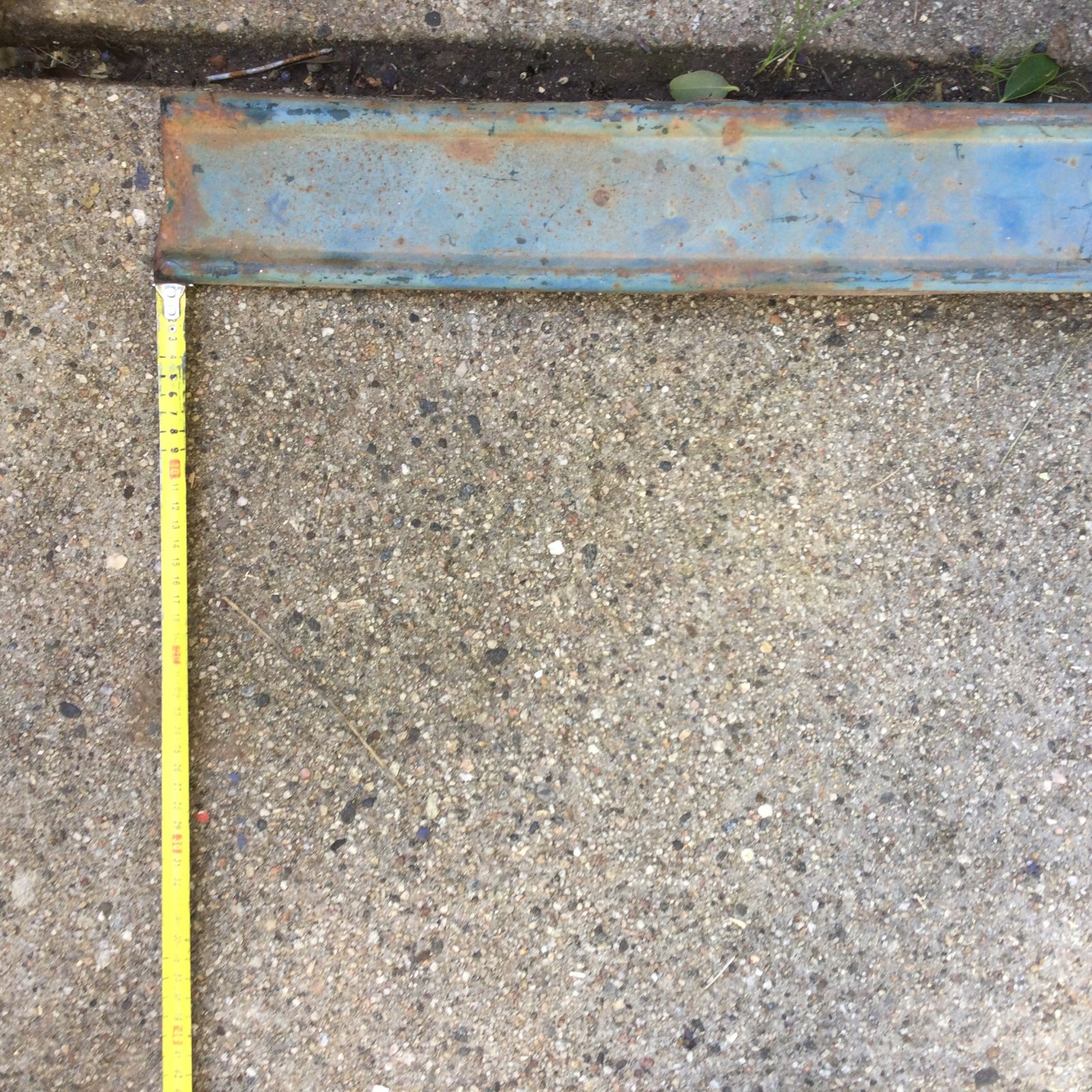

    Unfortunately it turned out the doors were a couple of inches to shorter than the remains of the old one so I can’t use them. I suspect they may be from a 1929 International Truck.

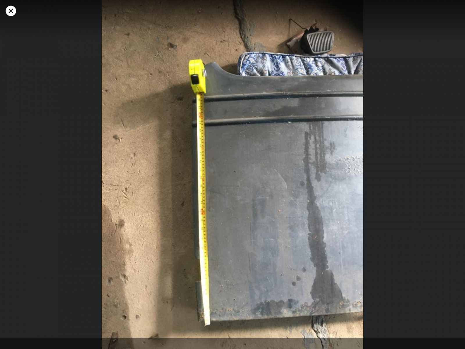

    I was able to get some basic measurements from one of the blokes on one of the Facebook Chevrolet groups to get me started. But the main thing I need are MDF cutouts of the doors so I can get the correct profile of the doors and the door gaps.

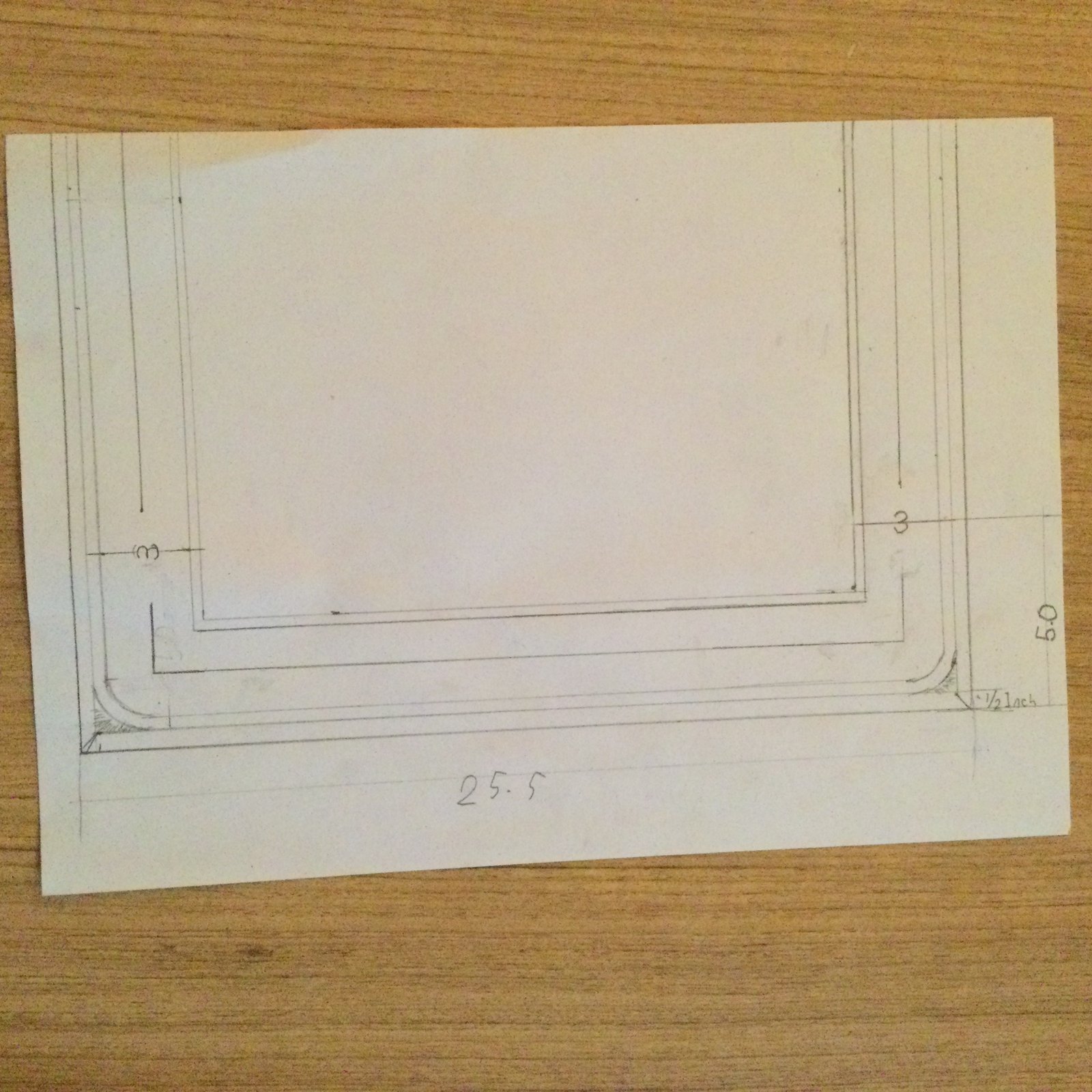

    Since it’s impossible to find any of these doors for sale I will be fabricating a new pair, and yes they will be full framed, once I have gotten enough information on their correct profile.
    Originally these doors were fastened to a timber inner frame but mine will have a full inner skin similar to the Fisher bodied ones.
    Once the doors are completed I will be fastening them to the cab so I can start fabricating the missing 19 inches of the lower cab then moving onto the floor.
    I have included a basic sketch of the inner skin but if anyone has access to a Fisher bodied 35/36 Chevrolet pickup cab that they can get photos of the inside of the doors that would be great.
