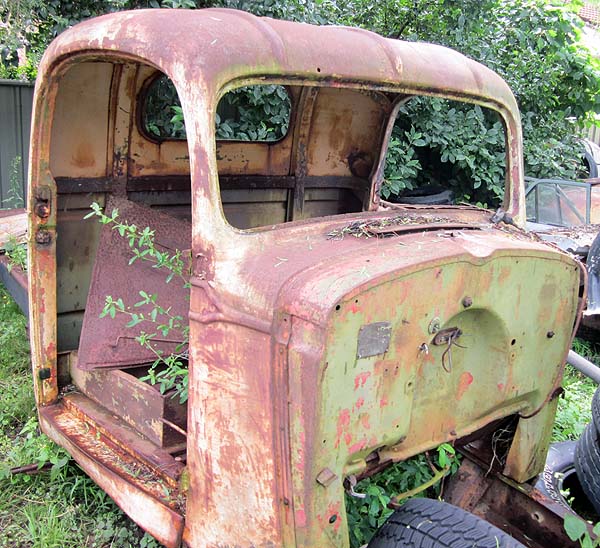

    I saw one of these in a junk yard full of old cars somewhere north west of Melbourne when I was visiting relatives a few years ago. My cousin lives in Ballarat, went on a road trip from Melbourne to visit her and somewhere on the way was the junkyard. The truck was pretty complete had a big flathead six , which actually turned over. Guy living there in a caravan said everything was for sale. I will see if I can find old pictures and dress. In the mean time, I dunno how old this website and adverts are but two cabs here one may well be a whole truck.
    https://www.ratrodtrucks.com.au/old-trucks-for-sale.php

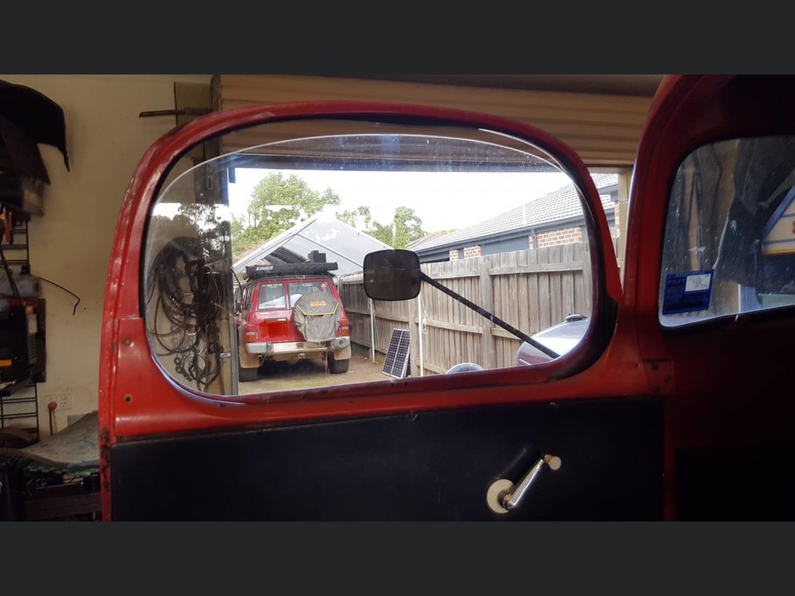

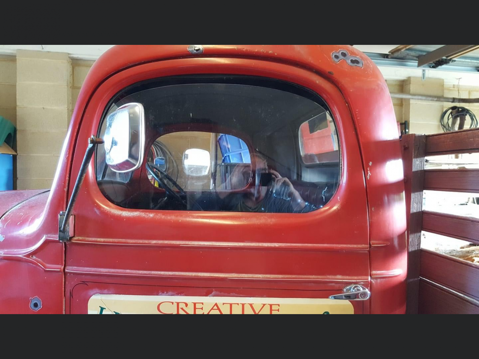

    60251C88-9556-4B33-A981-099B518D6105.jpeg 2B3708CF-FDBC-432F-82E1-174A5A339E56.png He also sent through some close up images of the of the window frame inside and in.
    1Nimrod likes this.
  14. chev34ute
    Joined: Nov 13, 2011
    Posts: 1,602
    chev34ute
    If you look closely you will notice the door is completely symmetrical. That will make making up the MDF templated a whole lot easier.

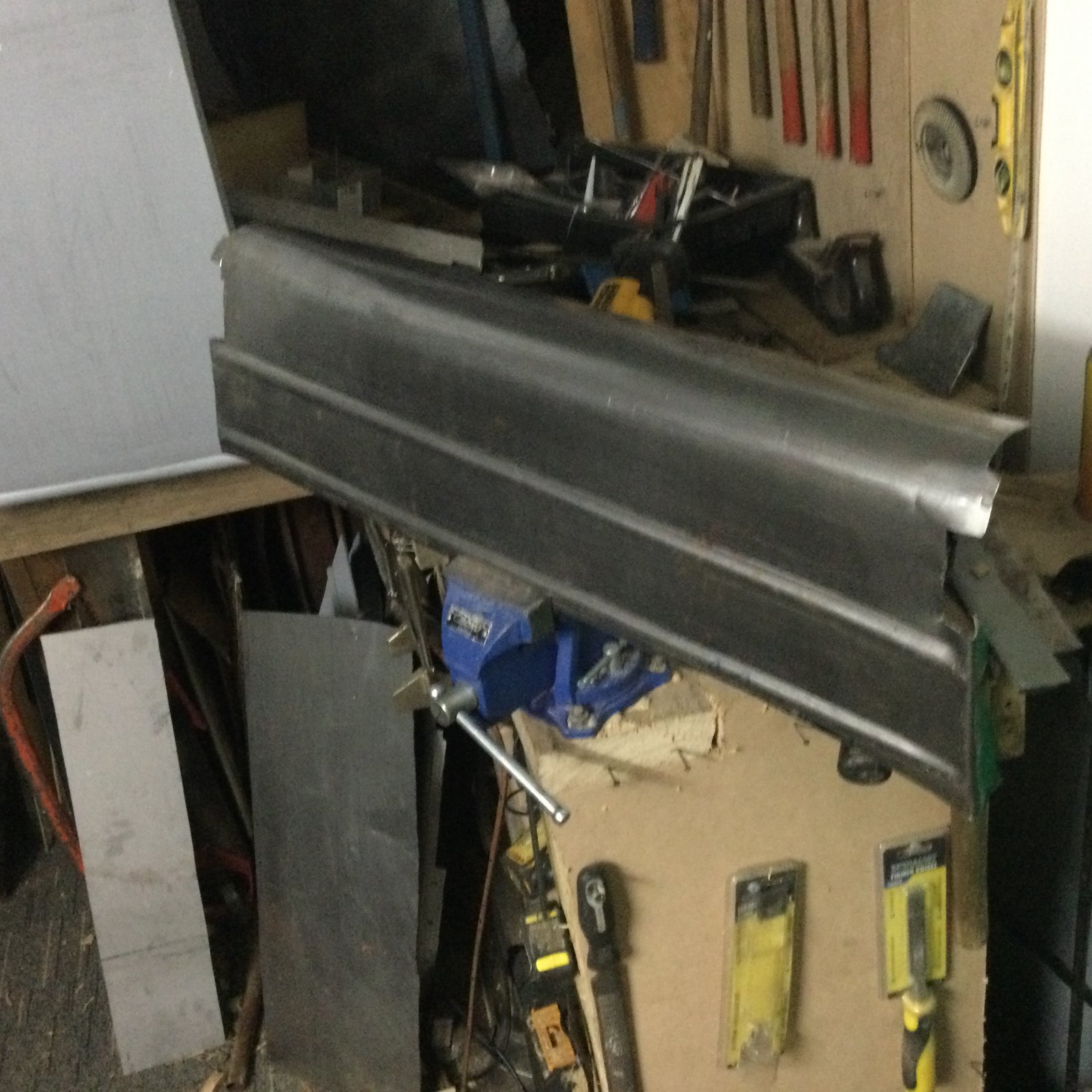

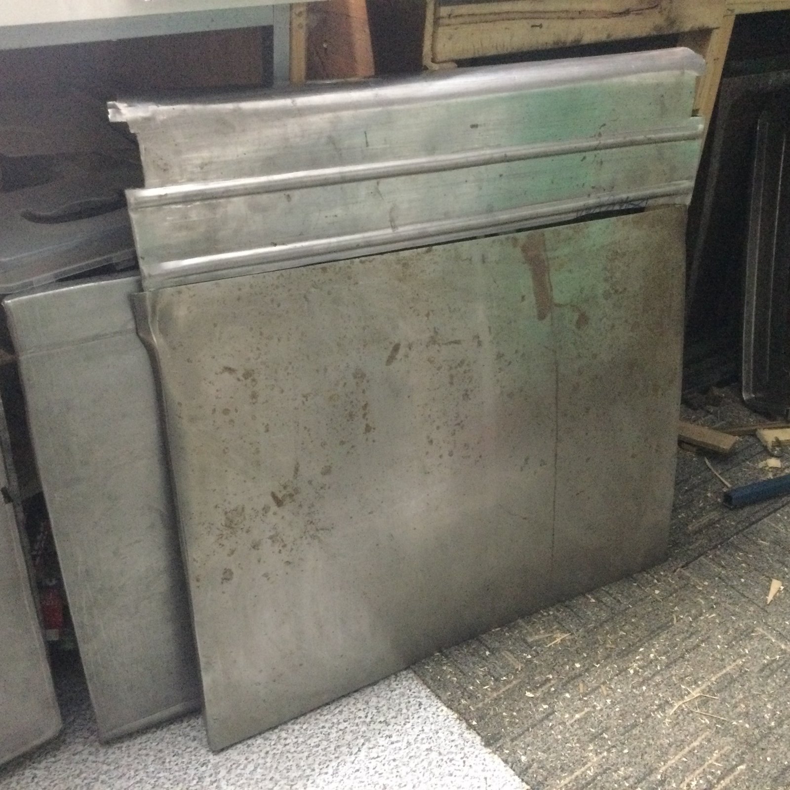

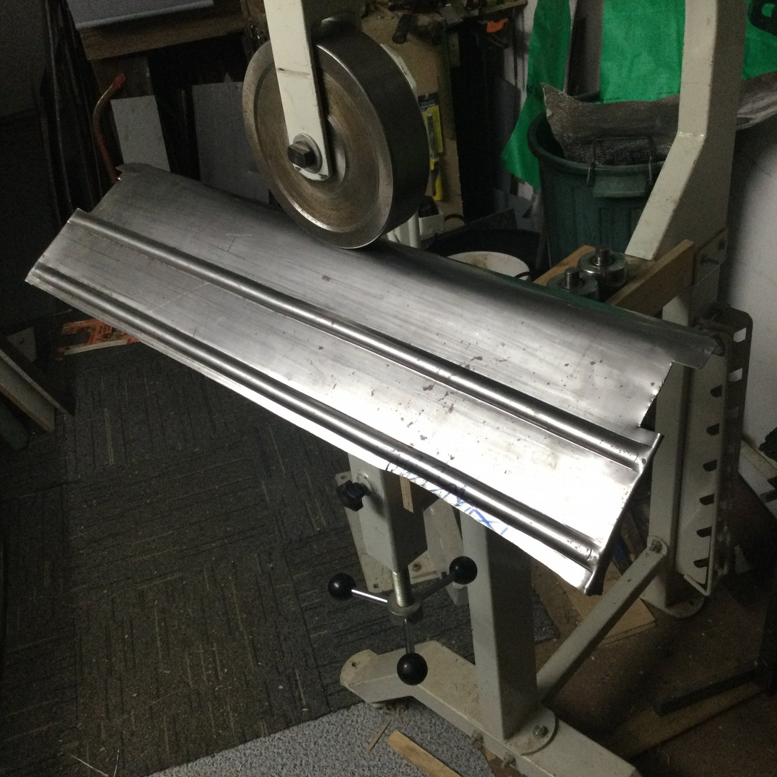

    Hey Guys.
    I finally found some more time to get a bit more done, the first thing I did was cut out and shape up the lower skin.
  17. chev34ute
    Posts: 1,602
    chev34ute

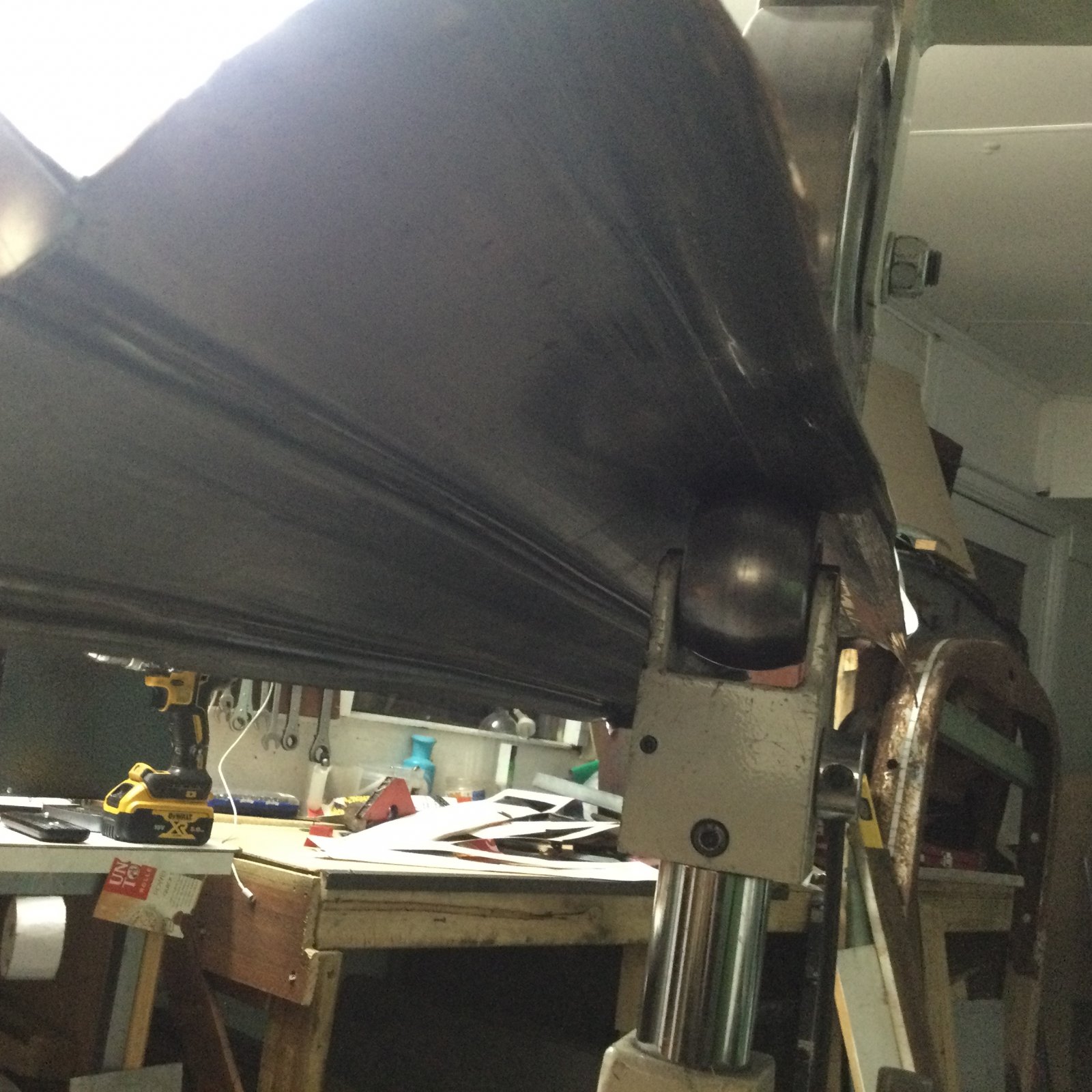

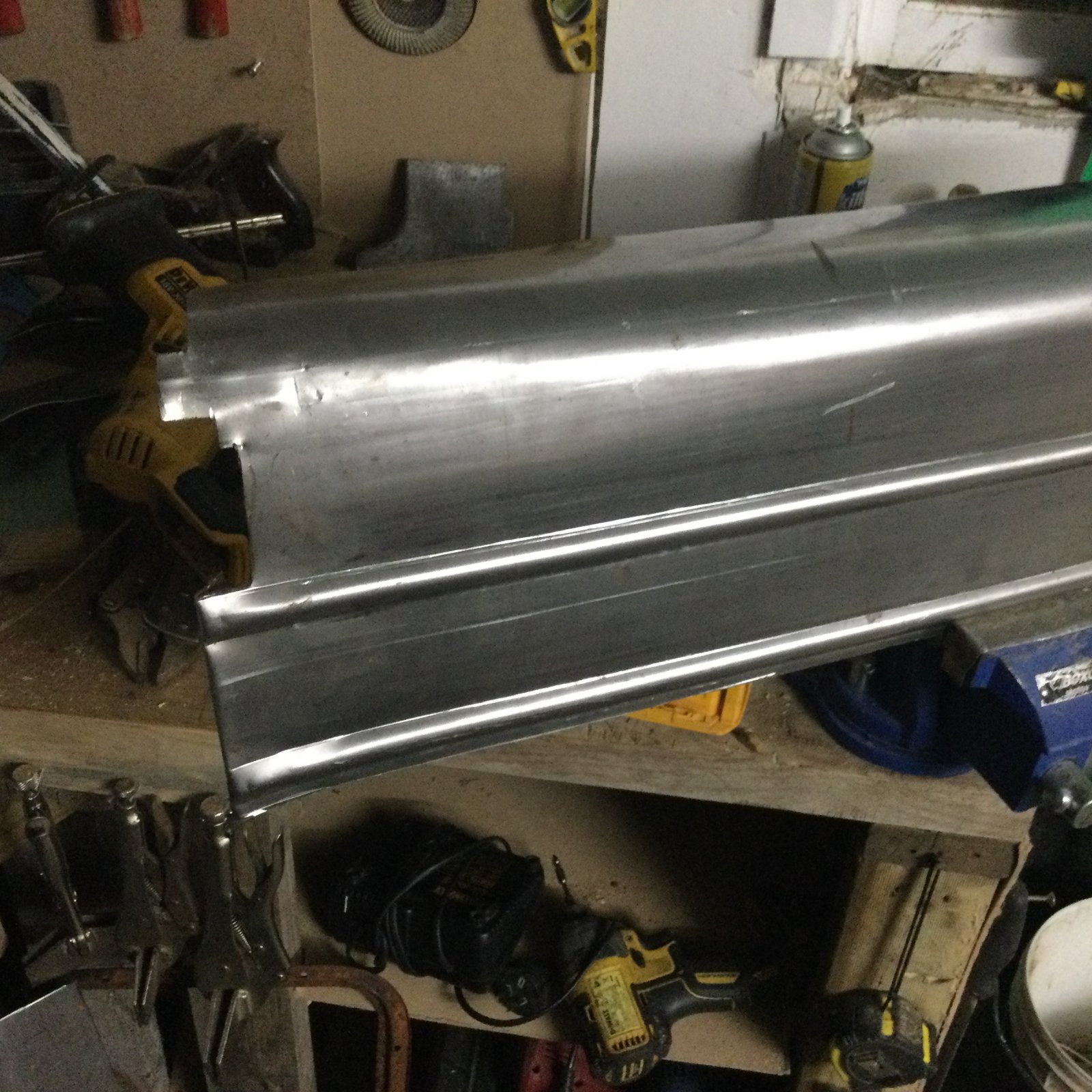

    The other thing I have been doing is rounding off the top section, this will fold down on the inside. 70BD6565-B4E7-42C3-8945-570D39F8C35D.jpeg 1EA2DAD5-0331-4D94-A195-357625ECACAB.jpeg
  18. chev34ute
    Posts: 1,602
    chev34ute
    There are different ways to get the bend, but I used a high crown anvil on my English Wheel to achieve the shape.
    57868B97-686C-41A6-B50C-960D78A03834.jpeg 81C52F9F-2606-4348-9A40-C53C0706425A.jpeg
  19. chev34ute
    Posts: 1,602
    chev34ute

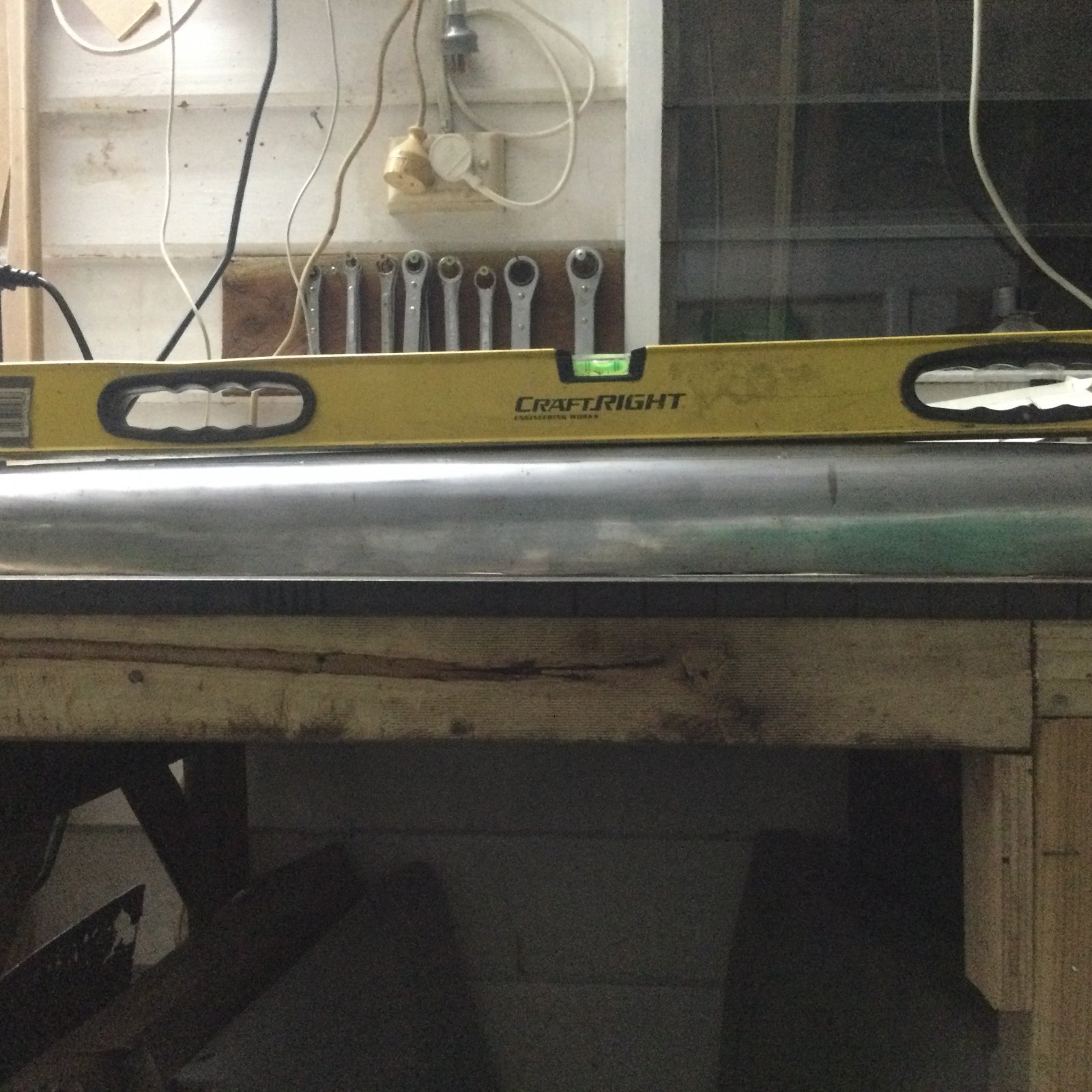

    The result is a gentle crown on either side.
    61653081-C1F1-44D0-A80B-1B1DE3F45B33.jpeg 821AB51E-A70E-45DB-8B6A-89DE6E62CB98.jpeg

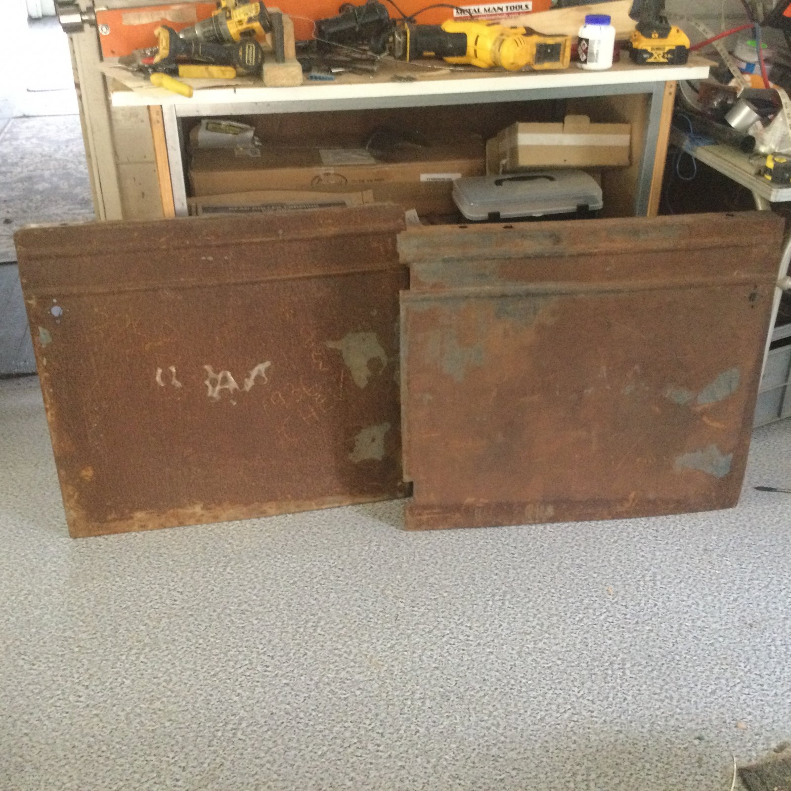

    chev34ute

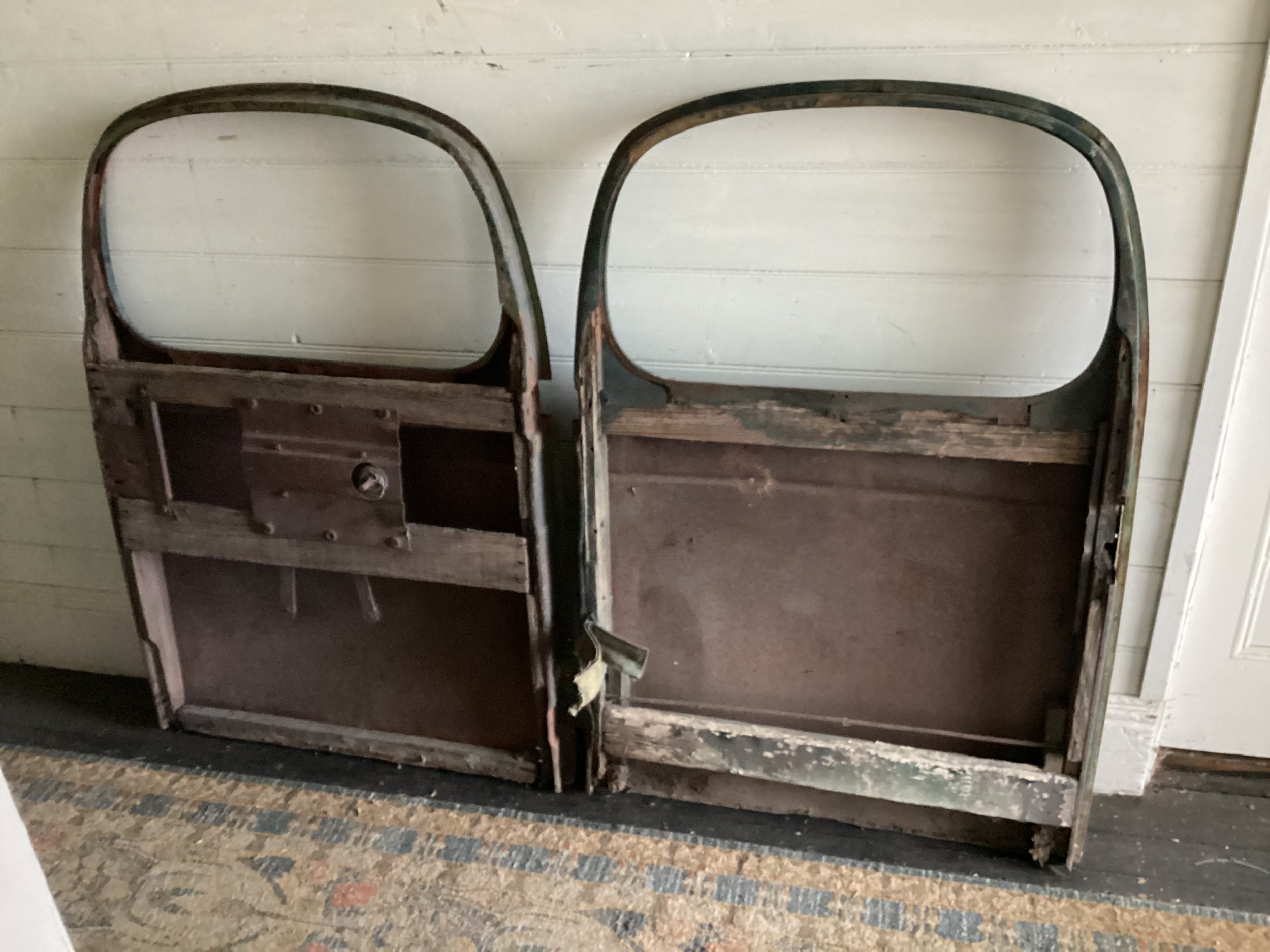

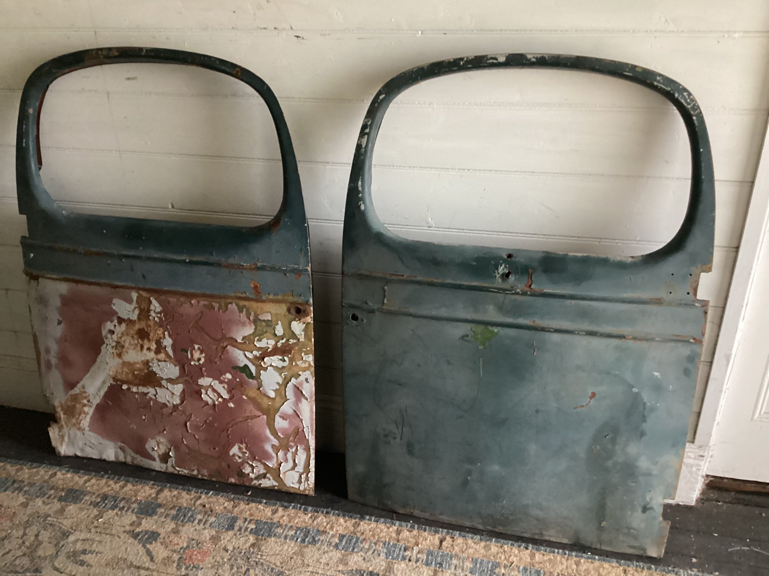

    After years of searching I was finally able to source a set of doors after posting up on Facebook Market Place a month ago. Not only that but they are a matching set as well.
    I just got back this afternoon after picking them up this morning. Luckily the seller was only 120 miles away, so that was also a bonus.
    I would have happily settled for just a single buckled door, but getting the pair will make things so much easier. The game plan now is to focus on welding the cab back together and using the doors as a guide for getting the correct spacing.
