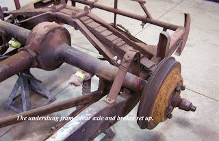

  8. Mart
    Posts: 4,989
    Mart
    Here in the UK Neil Bennet's Batten special has the rear part of the 32 frame flipped and the spring arranged like the Edsel Ford car. It is more sports special than hot rod. It makes for a very low rear.
    Hnstray likes this.

    Here is another pic of the Batten Special and its bare chassis.
    The big difference with my plan was the spring ahead, which will likely be slightly different because of the shorter distance between springs, but nothing that would make it not work just fine.
    Thanks again!

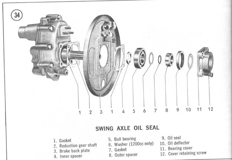

  10. Mimilan
    Joined: Jun 13, 2019
    Posts: 1,232
    Mimilan
    Use your imagination ! you can go way lower than that with a conventional frame over the top.
    Use inverted "Portal Axles" from a VW Kombi on the end of your axle tubes.
    Because you've already got a Banjo rear-end you need to flip the crown wheel to the other side so the axles turn backwards, Then the portal axles reverse the direction.
    The Kombi portal axles [also called reduction hubs] lower the ratio by 1.26, so you need a 3.25 C&P to end up with an overall ratio of 4.10:1
    Ned Ludd and 62rebel like this.
