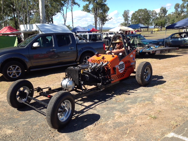

    IMG_0012.JPG I don't know if the headers on my HA/GR are classed as too short. In 8 years of racing it I haven't warped a valve. Can't say the same for the driver.
