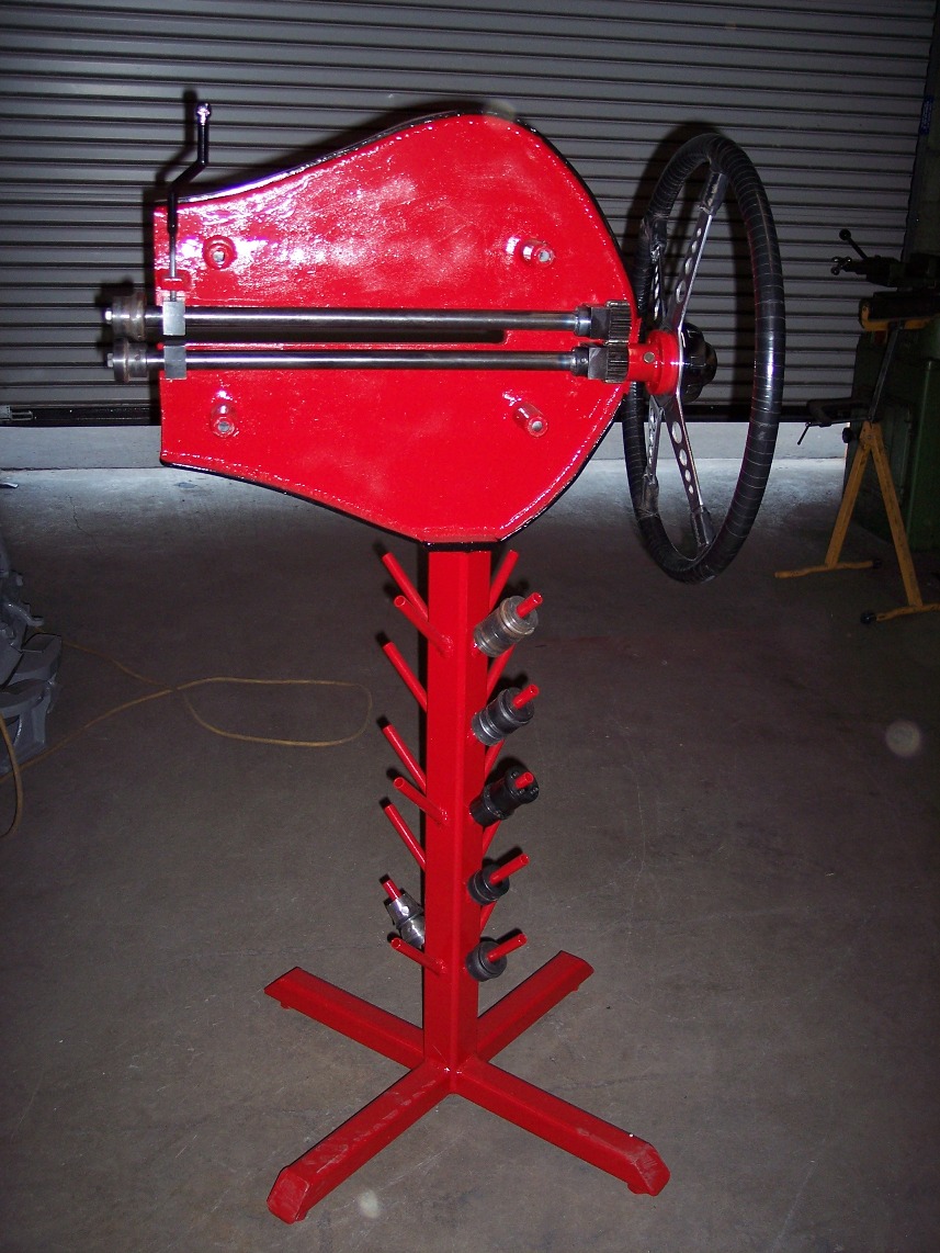

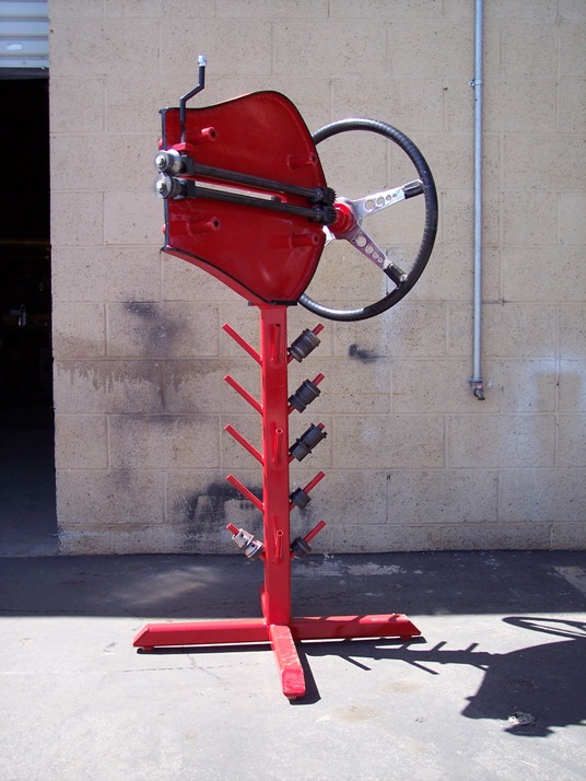

    So I have this job to do that is going to require some work on a bead roller. I have an old HF sitting in the corner colecting dust. I knew that it would need a lot of work to get it in shape to do the job so I started poking around to get some ideas and found them here on this site. I think it's obvious where I gained inspiration from, so I hope thats ok.
    I picked up some custom dies from Hoosier Profiles and got to work modifying my machine. I don't have alot to add, pretty much the same story as a lot of you. Most of the materials I already had. I spent way too much time on it but had a lot of fun with as I think you can see. The truck wheel came "thrown in" with a '49 ford project. The lugs on the side are for a guide rail that I'm working on now. The machine works, still flexes too much, but I think it will do the job it's intended for.

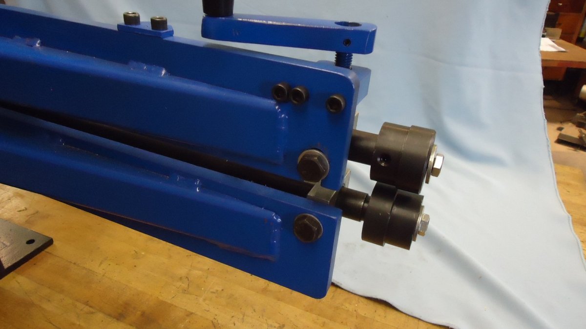

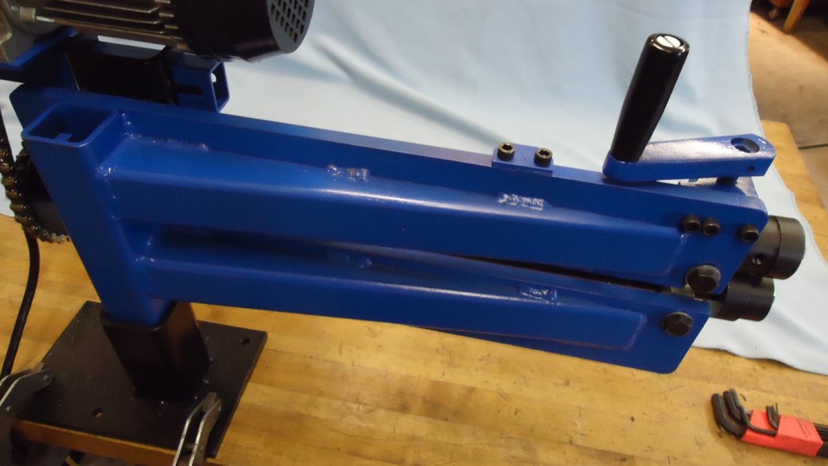

    Here's my bead roller made from an Eastwood BR & using the 440/880 winch.
    Eastwood's is much the same as HF.
    Maybe useful info for other HAMBers.
    I added the tapered square tubing pieces to the "back-side" and another piece vertically.
    The vertical piece slides into a bigger square tube that's welded to a base plate for mounting to a table.
    The frame doesn't flex now, but the motor just doesn't have the guts to roll 16ga.
    I may get the 1500lb motor and adapt it.
    Added this torsion spring to lift the upper roller and shaft back up when the hand crank releases the pressure on it. The spring is out of a spring clamp, and is strong enough to do the job. Eastwood BR mods_5.JPG
