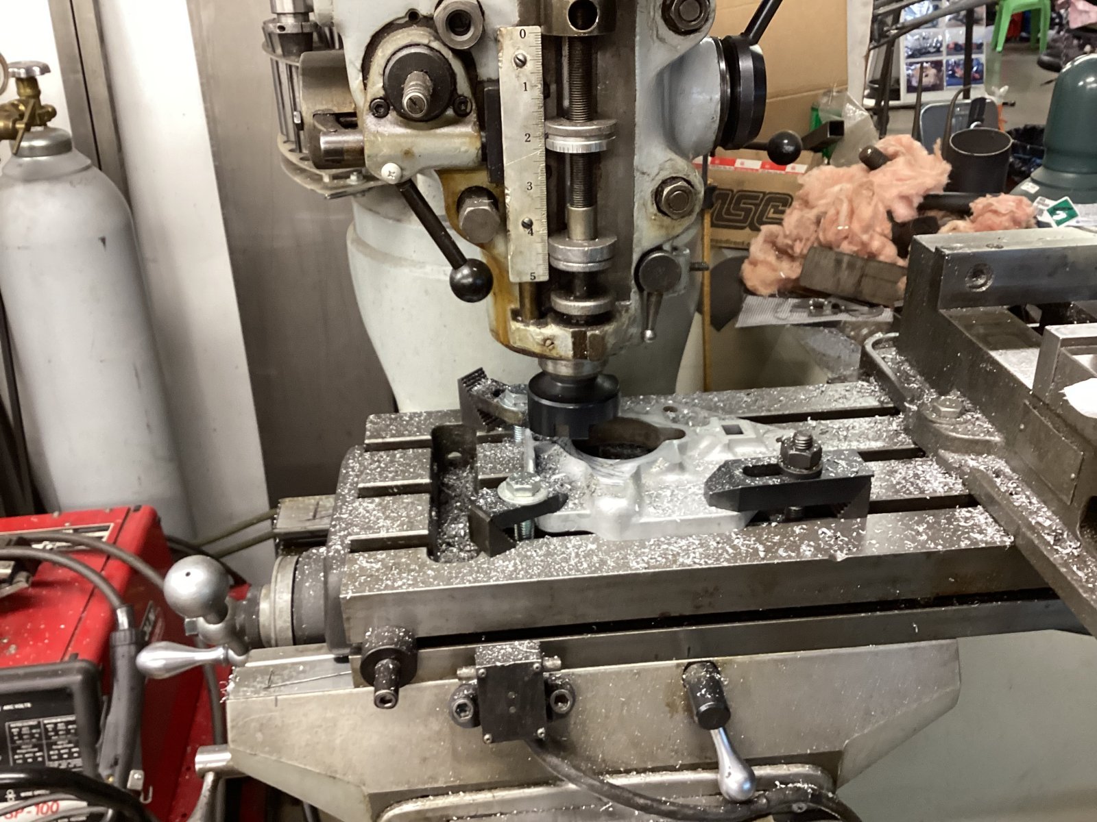

    I pulled the engine to trim the motorplate and do some welding on the bottom side. I had been thinking about machining a plate out of thick aluminum to replace the tail housing, now that the tail shaft is shortened and splined for the coupler. I decided to bandsaw the flange off and mill it flat. It will be much easier to machine and weld a plug in the flange, and bore it out for a seal at the coupler. IMG_0642.jpg IMG_0645.jpg IMG_0643(1).jpg IMG_0644.jpg IMG_0646.jpg IMG_0648.jpg IMG_0650.jpg

    Yes, using the stock bearing, another reason for using part of the stock housing to support the bearing. IMG_0651.jpg

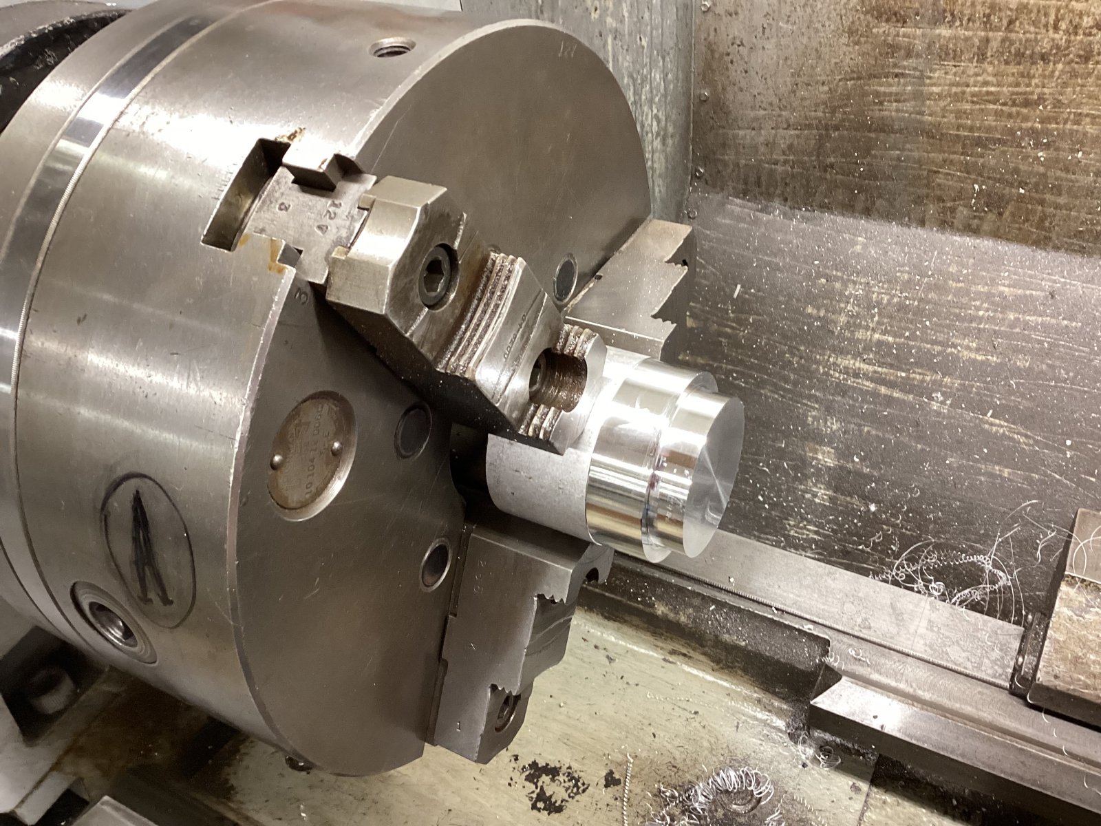

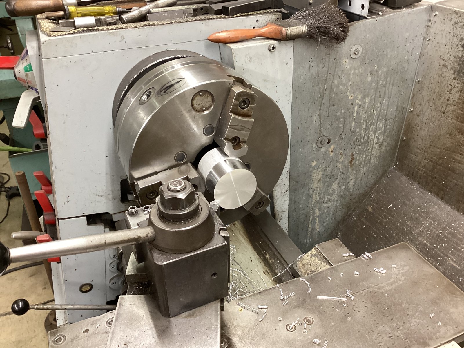

    I have been finishing some welding, and decided to machine the piece for the seal at the coupler. I had a stick of 3" aluminum that was 12 feet long out under my carport area. I couldn't carry it, so I sawed off a 5 foot piece using a sawsall, and went to work. Now I need to tack weld it, heat it up to around 250 in a toaster oven, and weld it up. Then I will take it to a buddy that is a pro, and he will lock it down, with the bearing bore up. Then he will sweep the bearing bore with an indicator, and bore it to size, and step bore it for the seal. IMG_0652.jpg IMG_0655.jpg IMG_0656.jpg IMG_0657.jpg IMG_0659.jpg IMG_0660.jpg IMG_0661.jpg IMG_0662.jpg IMG_0662.jpg

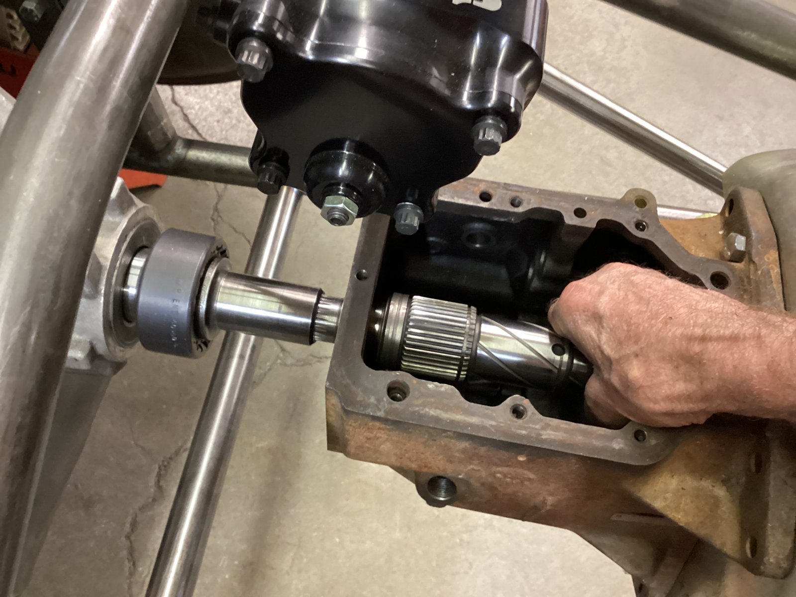

  13. Marty Strode
    Joined: Apr 28, 2011
    Posts: 9,710
    Marty Strode

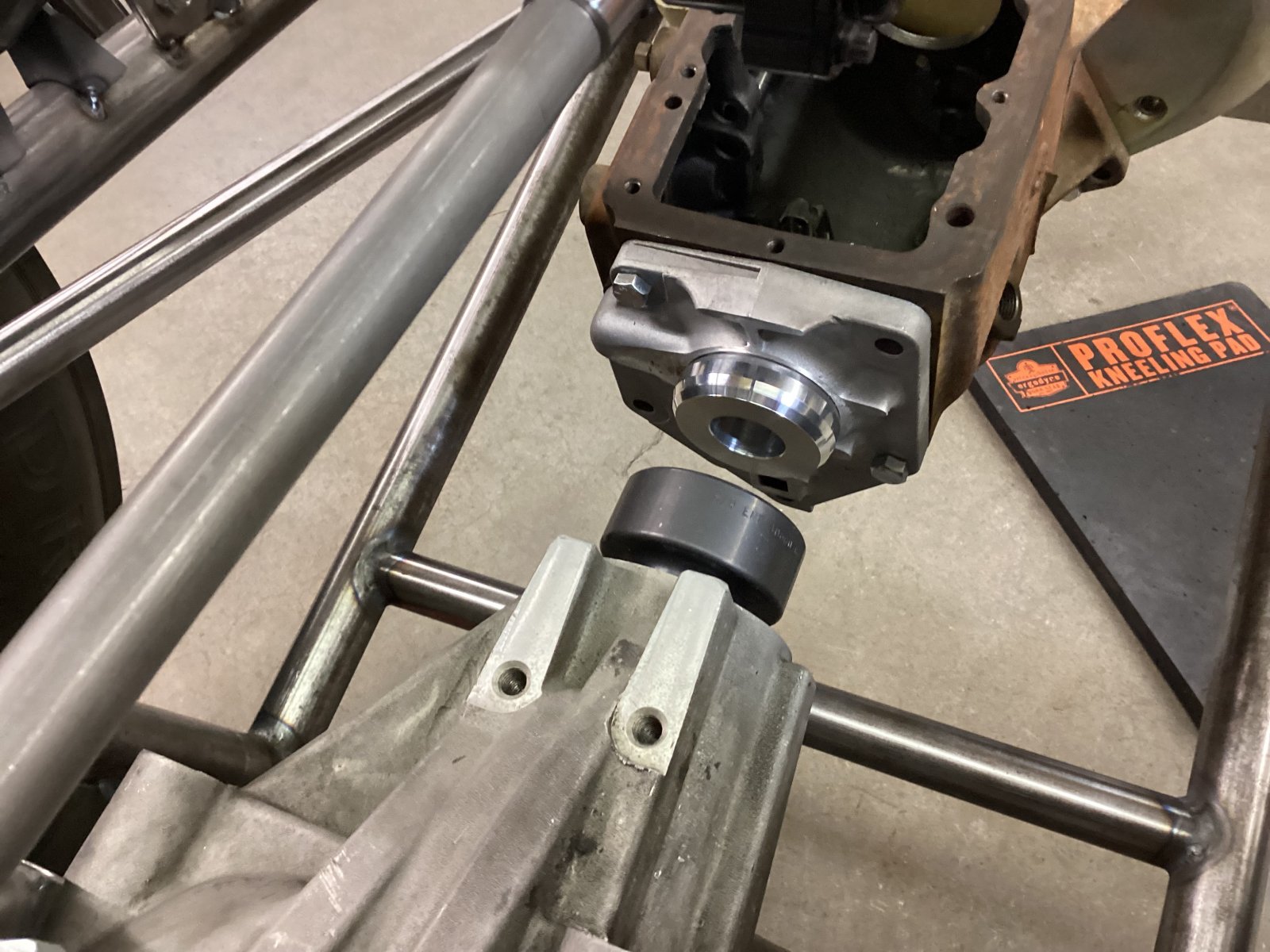

    This shows how the output shaft mates to the rearend. It can be tough to take pictures one handed with an ipad, I had to push the ****on with my nose ! IMG_0665.jpg

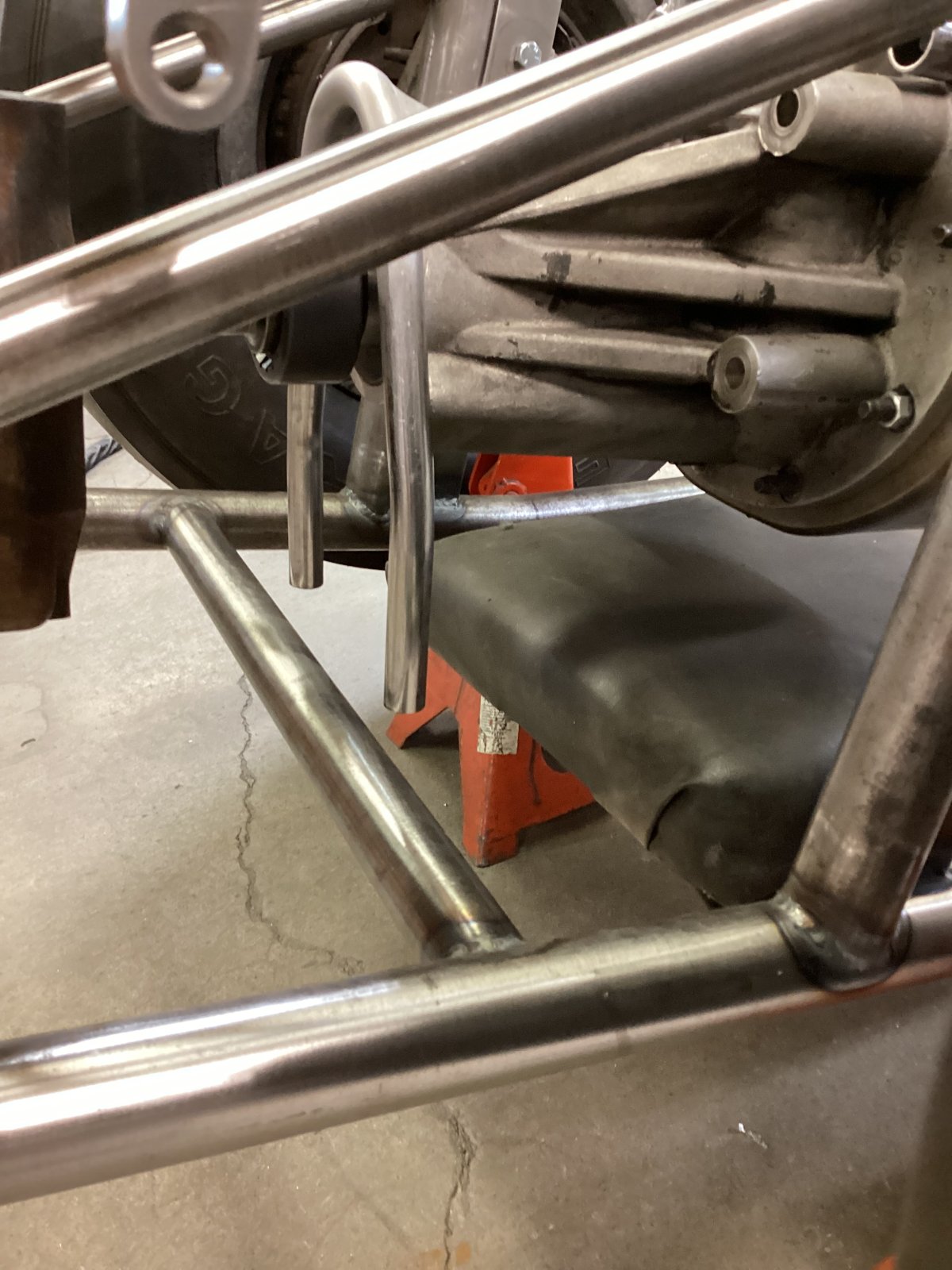

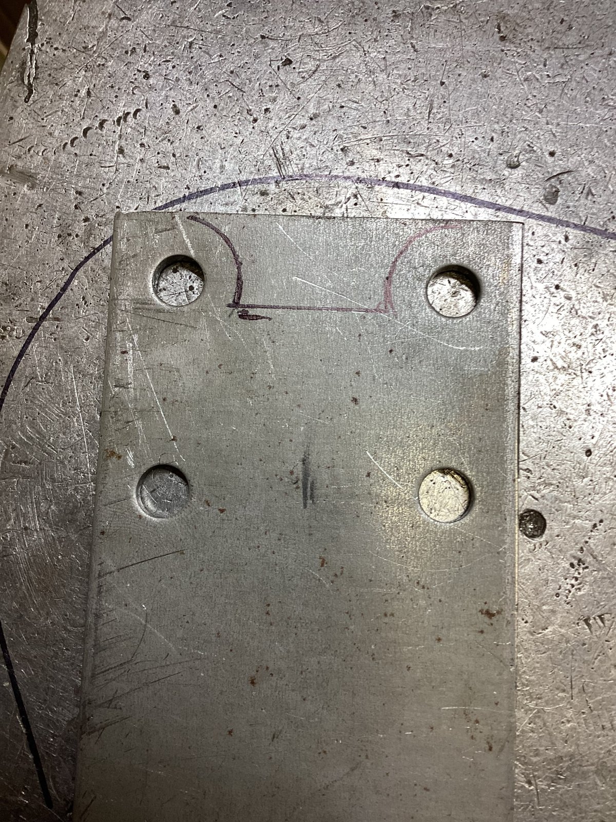

    Trying to get as much of the loose ends taken care of before I take it to Chris, so he can start on the body. Today, I worked on the anti-rotation device on the nose of the rearend. Got the top done, now need to make some weld bungs for the legs, and some weld tabs. IMG_0666.jpg IMG_0667.jpg IMG_0668.jpg IMG_0669.jpg IMG_0670.jpg IMG_0673.jpg IMG_0675.jpg

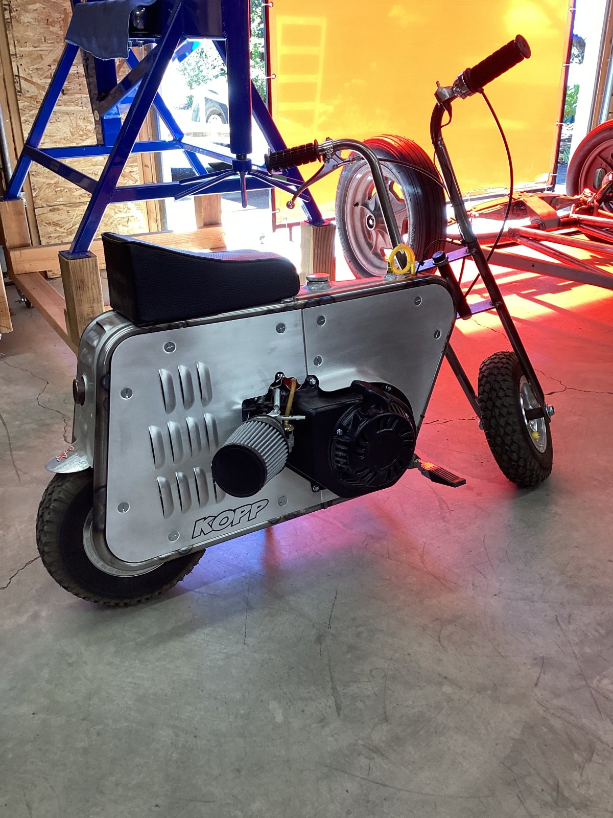

    Got it to Chris, and thought some of you might like his Pit Bike ! IMG_0685.jpg IMG_0687.jpg IMG_0688.jpg IMG_0689.jpg

  30. chriskopp
    Joined: Apr 21, 2014
    Posts: 17
    chriskopp
    Marty and I will discuss his basic wants. I'll look at photos to get locations of panel seams and fastener locations. If there isn’t any photo evidence I’ll put them in a location that makes sense to the period and this build.
