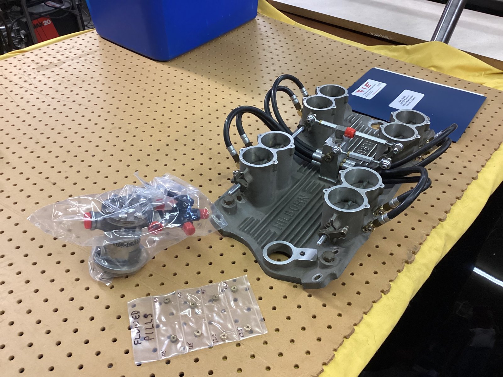

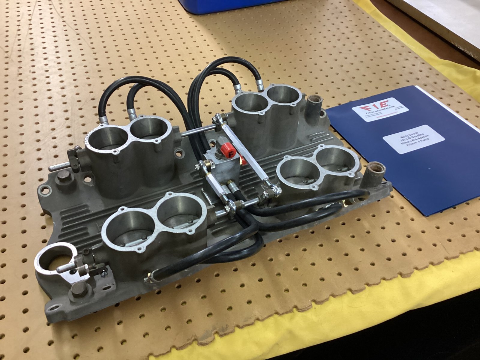

    On a more serious note, I dropped the injector off with Spud Miller (FIE) and he went through it. Since I will be running it on the RPU until the Banana is ready, I decided to run it on gas for the time being. So, now I need to order a low mount version of belt drive for the fuel pump. When we switch the engine to the dragster it will run alcohol and perhaps some Nitro. IMG_0703.jpg IMG_0704.jpg

    That is a thing of beauty even without the stacks.
    I can't imagine someone seeing that shot and not be ever so slightly stimulated:oops:.

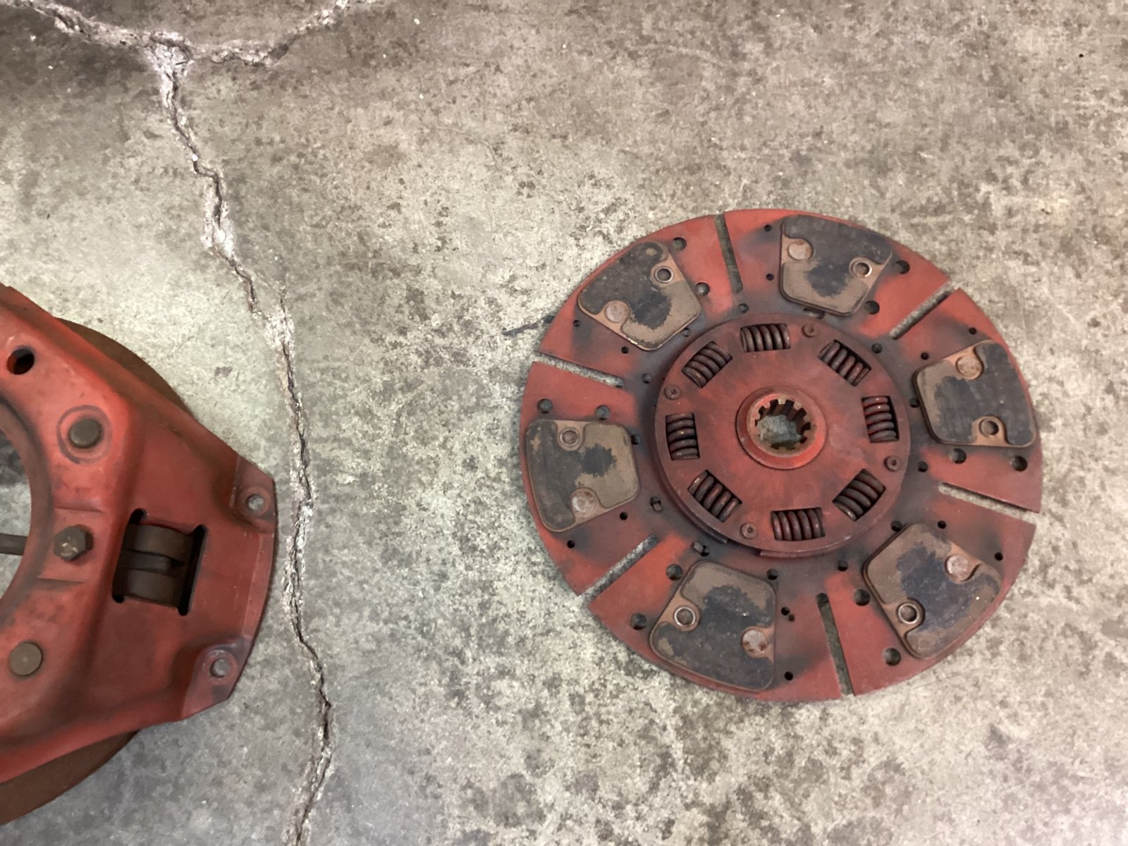

    I need to go up in the attic more often. Lately I have been looking into flywheel-clutch-and pressure plates, and need to fit the Ford input that I have. Well, back in 1980 I built an OT Chevy Luv pickup Pro/Super Gas for a friend. It had a healthy SBC backed by a Lenco 4 speed. After a couple years racing, the owner parked it, and in the later 90's he decided to put it on the street. He had me pull the engine and trans, and sell the Lenco, and install an aluminum head crate engine and 400 Turbo. For the last 26 years, this 40 pound billet flywheel, clutch and Ram style disc, with the correct spline has been overhead. It only needs a mild surface job and some cleanup on the PP. It's almost like my birthday ! IMG_0709.jpg IMG_0710.jpg IMG_0711.jpg IMG_0712.jpg

    U going to put that 40 pound flywheel in the rail? The old fashion way to launch heavy weight. Will it blow tires off rail?

    With a 4.30 gear and a 1.75 second makes a 7.58 ratio on launch. Using a new 9” wide tire on a somewhat prepped surface and around 500 hp, I think I will need the inertia of the heavy wheel. If it smokes the tires, that will be more like the period. Besides, I trained on a tire smoker. In this photo, I am in the left lane with the great Jim Davis in the right. I wish it was more clear, but notice how high the left rear is off the ground and we were dead even. View attachment 6112363
