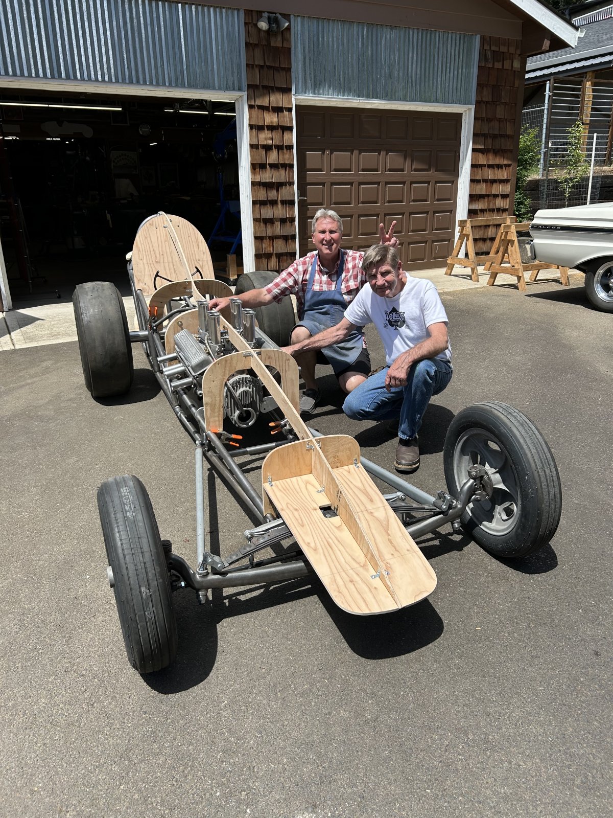

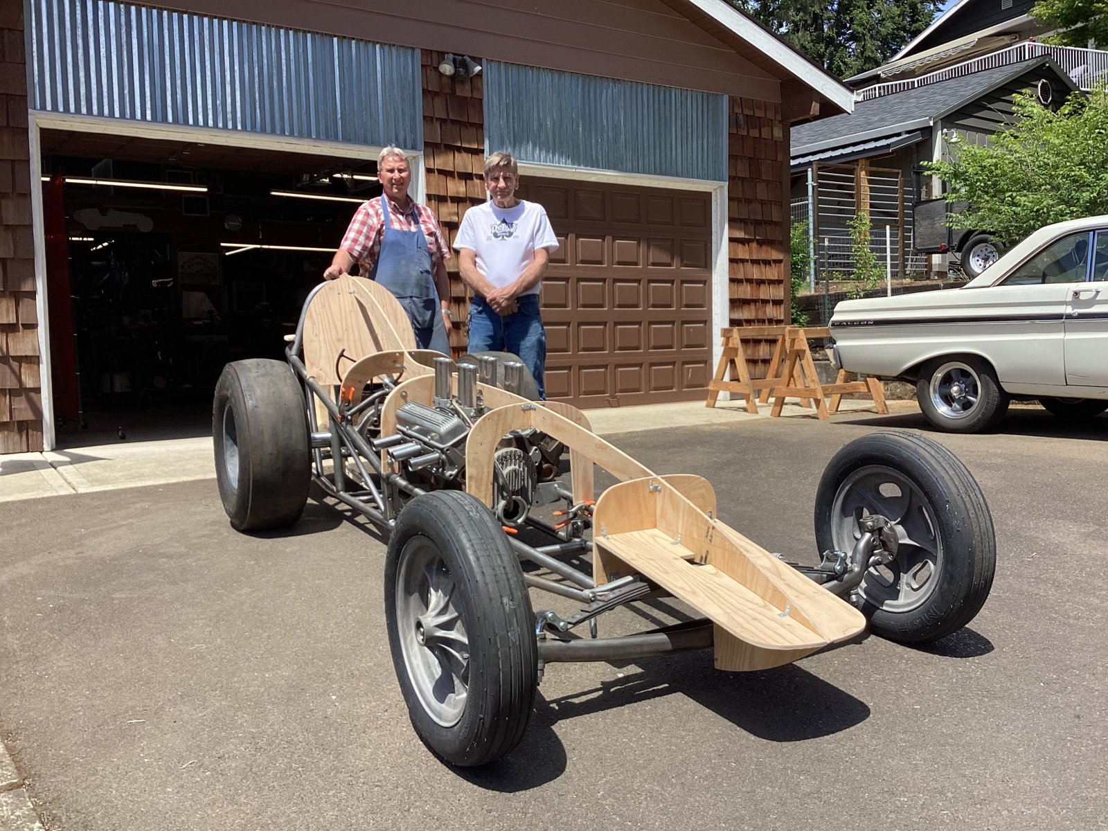

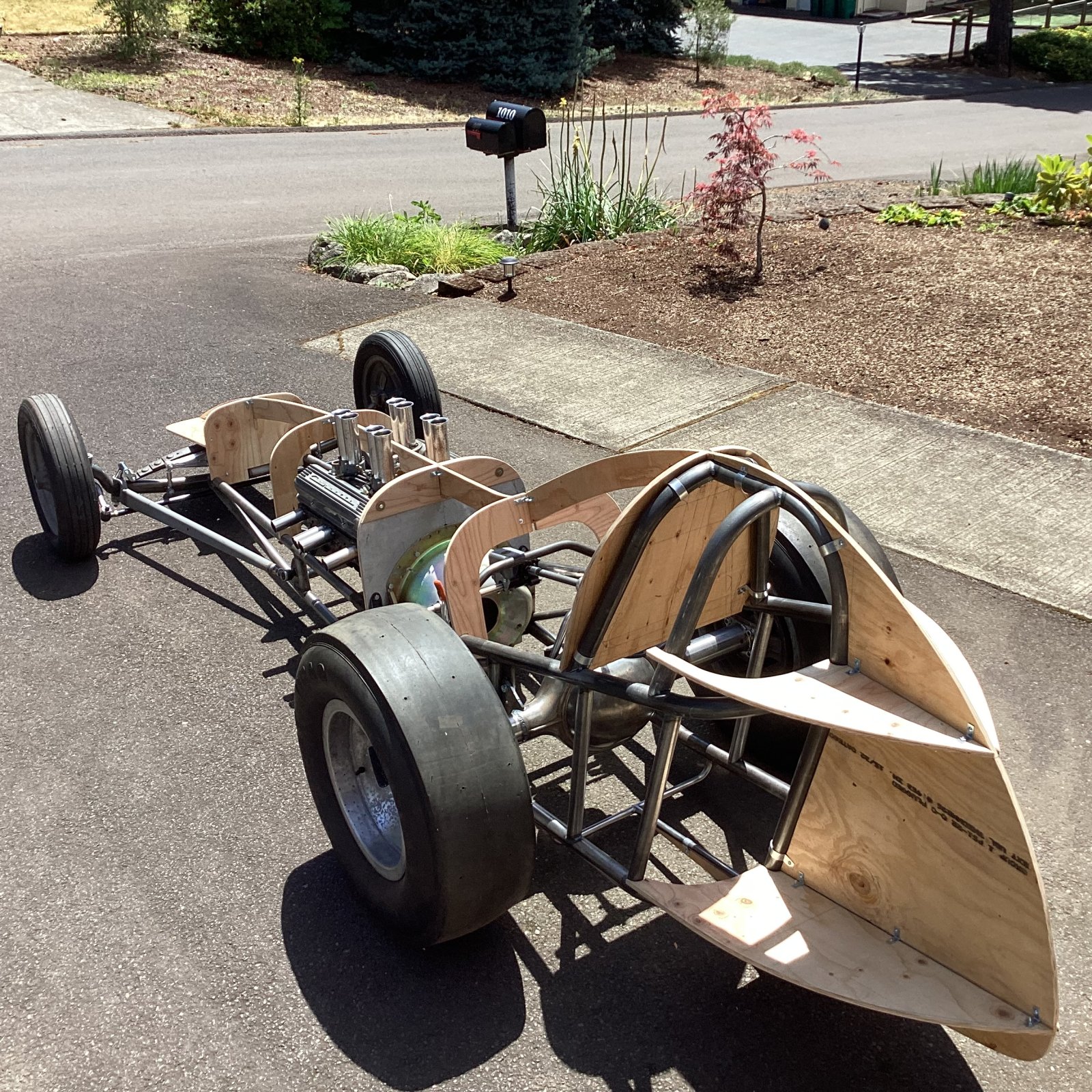

    Today, I traveled down to Chris's place, to see all the work he has put into this job. After he got finished with some radiuses on the mockup, he ***embled it, and got it mounted to the ch***is. There will be more ribs before he starts shaping metal, but it certainly gives you an idea of the final shape. IMG_0713.jpg IMG_0714.jpg IMG_0717.jpg IMG_0723.jpg IMG_0728.jpg [/ATTACH] IMG_0732.jpg IMG_0733.jpg

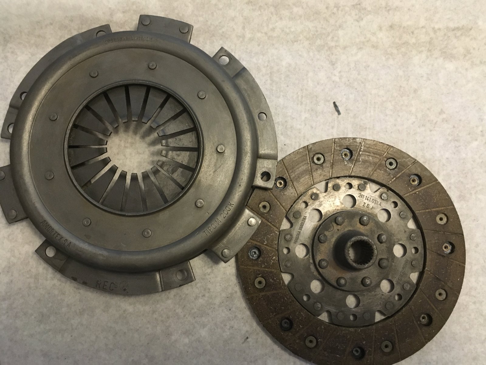

    Yes citric acid will etch aluminum. I would not try to clean any polished aluminum. It tends to turn aluminum a gray/dark gray surface. It does an amazing job on steel/cast iron and other ferrous alloys. This clutch pressure plate and disc were covered with surface rust on all internal and external surfaces. I made a bath of 1/4 to 1/2 cup citric acid to a gallon of water until parts were covered with solution and soaked for 48 hours in a plastic container from Lowe’s. Powdered citric acid can be purchased from Amazon fairly inexpensively. IMG_2184.jpeg

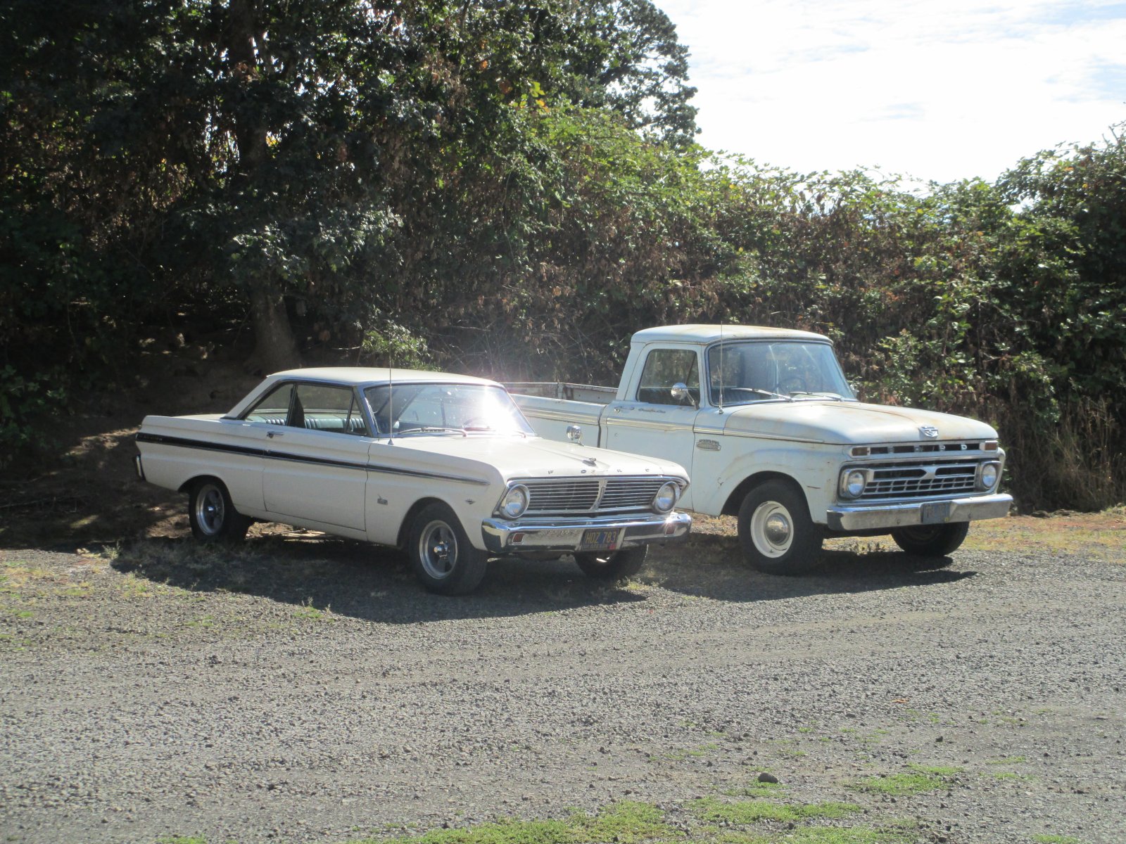

    That's my 65 Futura, factory 4 speed, came with a 289. I bought it in Aug '71, and it has 269,000 miles. I also have a 65 F100 that I bought in April '73 that has over 400,00 miles. I refer to the Falcon as an "old white car, for an old white man". 2014-01-25 093201.jpg IMG_0688.JPG

    Just when I thought I could trust Chris, he sends me this picture !

    I've always enjoyed studying these types of photos before the skin is installed, it's a lot like seeing a hot rod or drag cars' new ch***is and suspension before the body goes on, always a bonus for me.
    Something a lot of people don't realize is that having this kind of metalforming skill is only part of the picture, a guy needs to be pretty good with the wood buck building aspect too.
    porkshop and chriskopp like this.
  11. Marty Strode
    Joined: Apr 28, 2011
    Posts: 9,686
    Marty Strode
    Chris is the whole package, and a practical joker to boot !

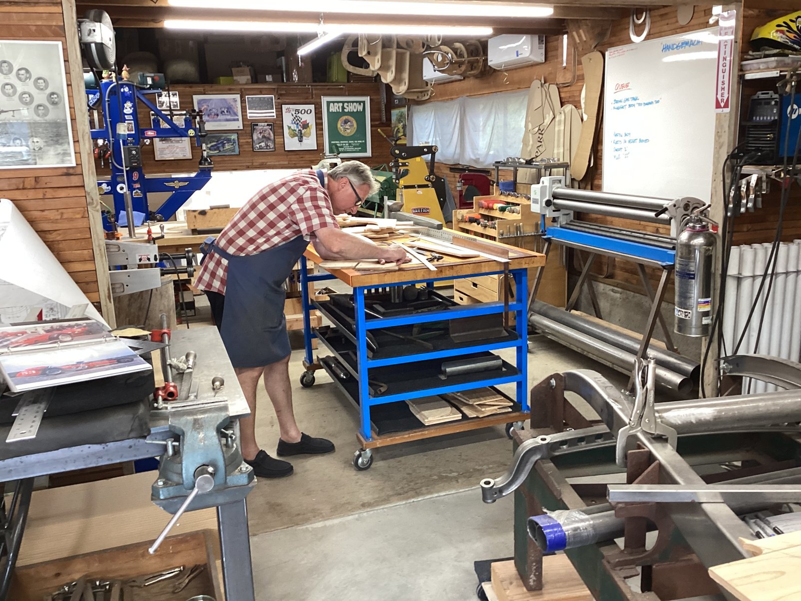

    Do not know how far u are from body builder but would love to see more pictures of work in progress. Sheets of aluminum cut, bend in place, welded up small pieces. Love your projects
  29. RodStRace
    Joined: Dec 7, 2007
    Posts: 8,836
    RodStRace
    @AmishMike , the body builder is here on the thread too. It's @chriskopp. I don't know how willing he is to stop and take pics and share all his secrets, but judging from his replies so far, he's a craftsman and a gentleman. Just don't let him get behind you.

    Chris is about 40 miles from me, it takes me about an hour to get there. Never any traffic, just a twisty road over a mountain, and a scenic drive. He will be taking pictures, and I will try to get some video, as it would be great to see him operate his big two headed hammer, and other machines. It would also be fun to capture the banter we have during the build process.
