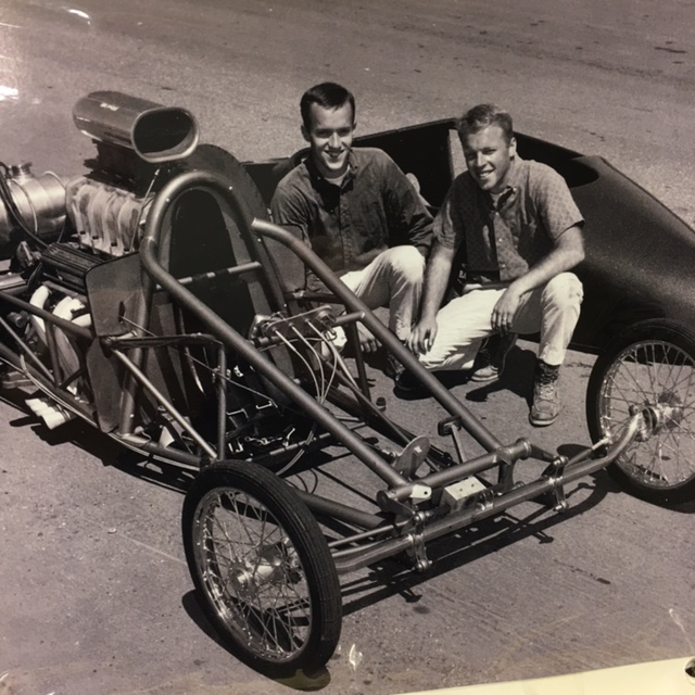

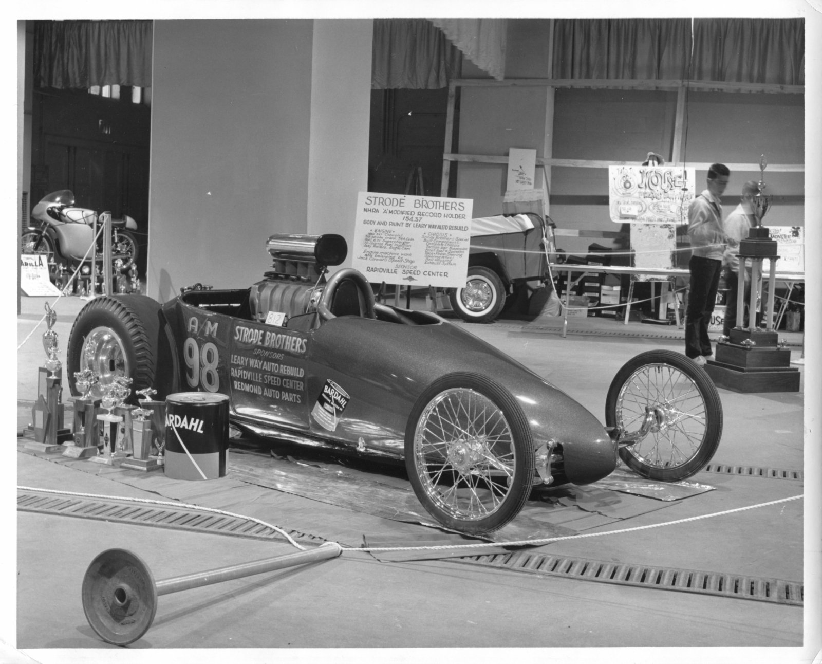

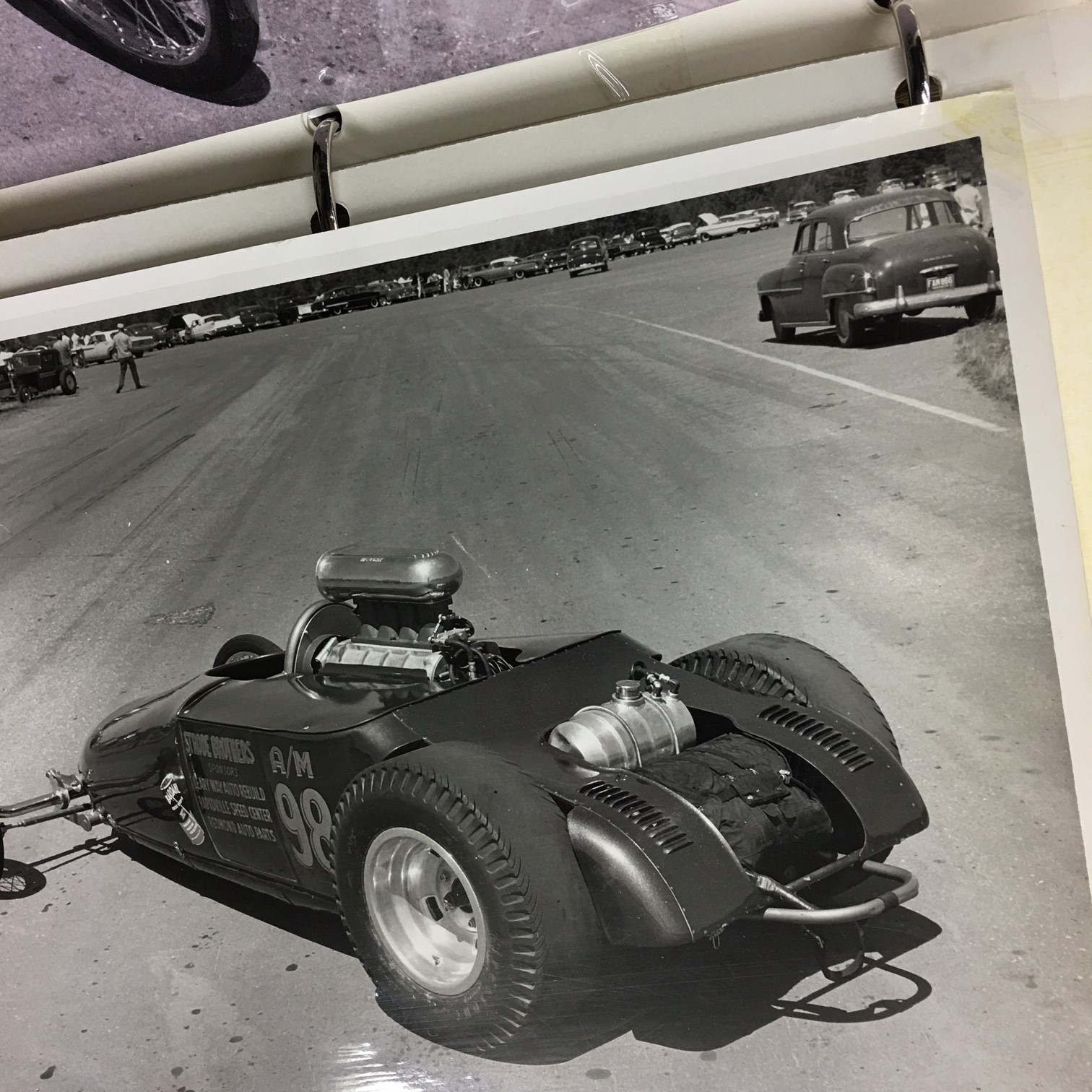

    I sent some photos out to a bunch of folks, heard back from Jim Strode, (no relation) just someone I had looked up to since I was in Junior High, reading Hot Rod Magazine. Jim and his brother Bob built this National Record Holding A/MR in the very early 60's, and set the record around 62-0r 3, are from Washington State, two amazing craftsmen, and very nice guys. They both drove, Jim went 174 with this 96" car, on gasoline ! Jim seemed to remember the Top Banana had an aluminum frame ! If you look at the first photo, you will notice the bolt on front spring perch, and radius rod brackets. Check out the Strode Brothers Roadster ! IMG_0207.jpg Strode Bros 2.JPG Strode Bros 1.JPG SB2.jpg

    Jim built the nose section out of a 50 Olds hood !

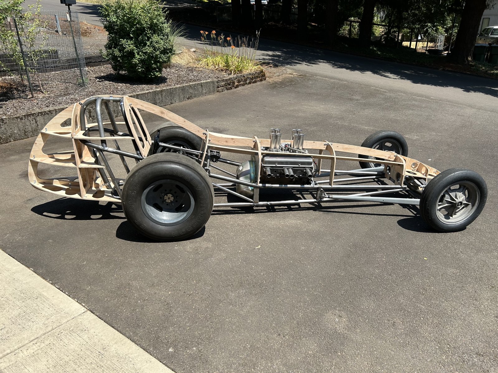

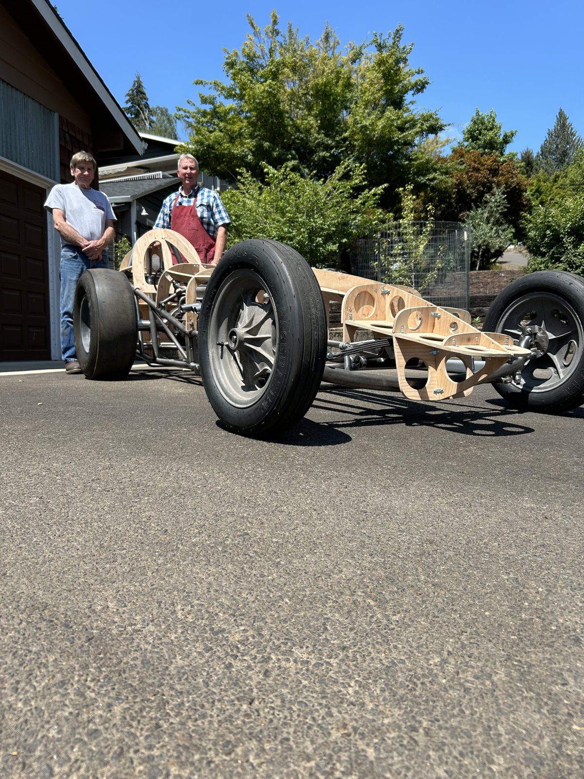

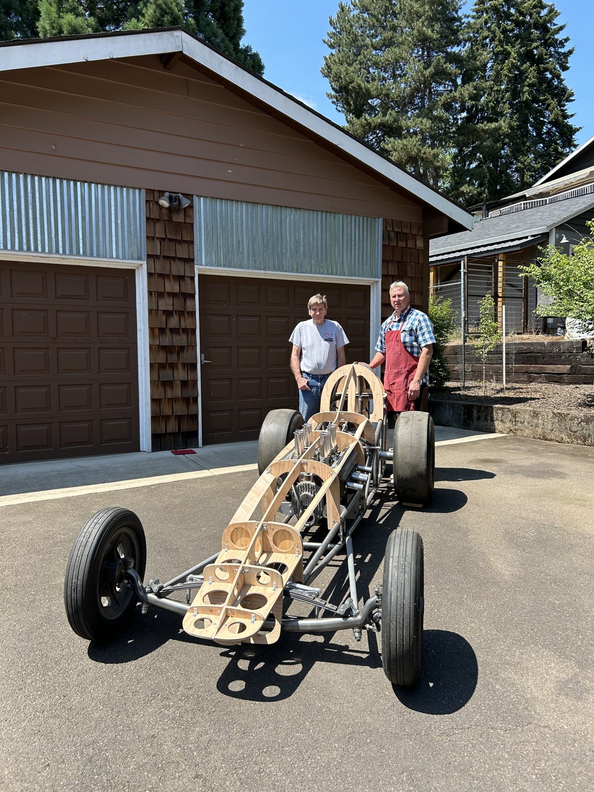

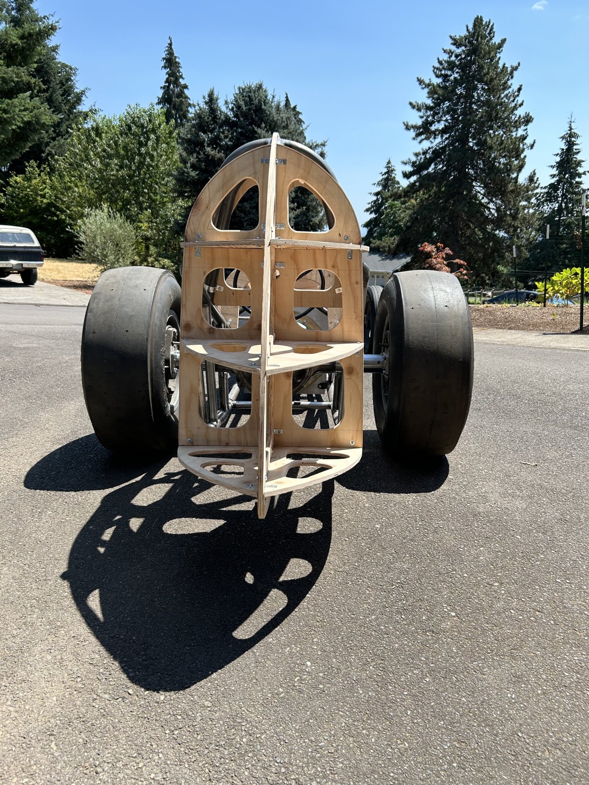

    I went to Chris's place today to see the final mockup. I shot lots of photos, but am having problems with my photo program. I will show these 3 shots for now, more later. BTW @chriskopp if you are watching, you could post some of the ones you took. I am more than pleased with the shape ! image1(5).jpeg image0(14).jpeg image2.jpeg

    That’s looking very cool!

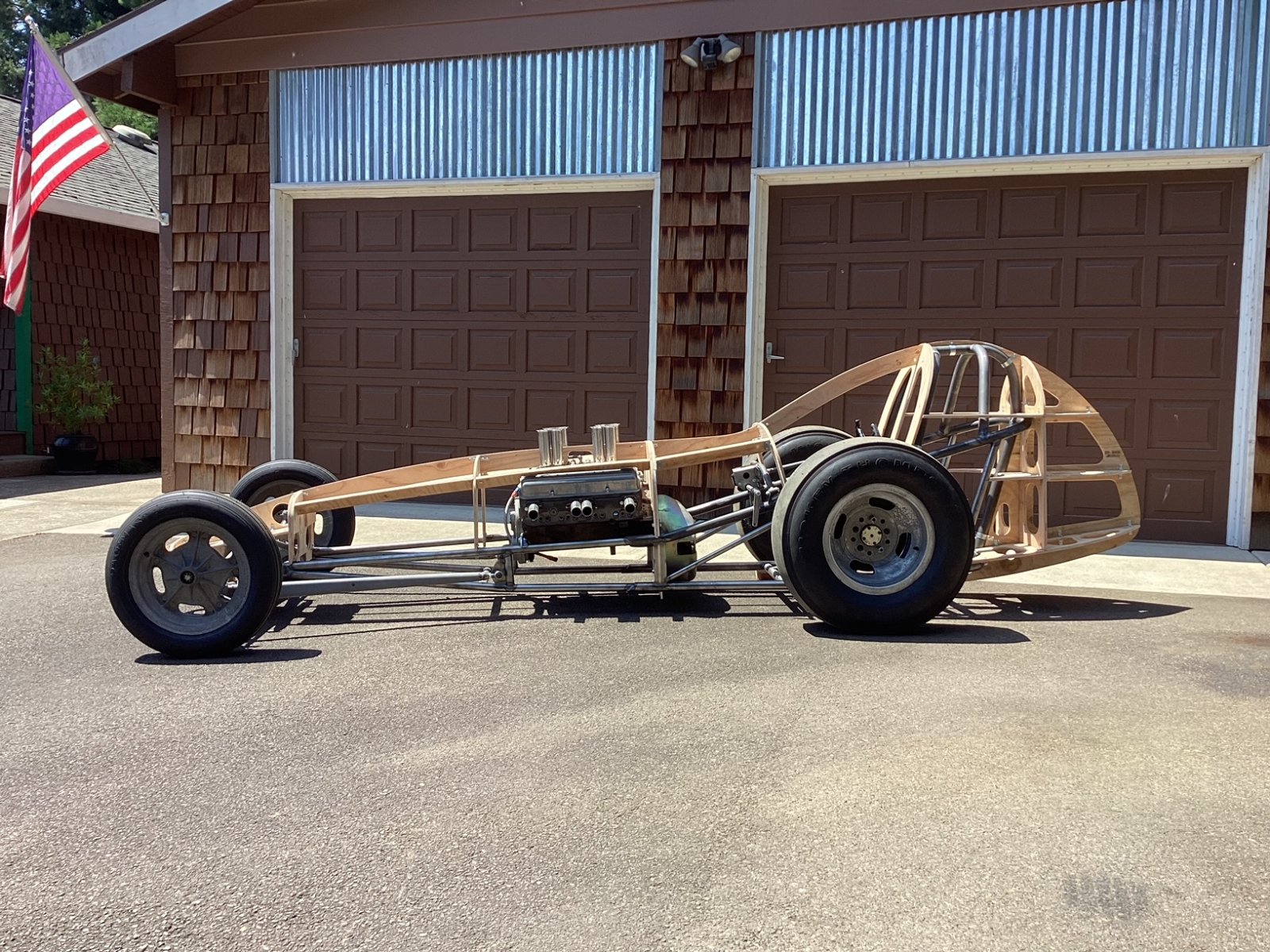

    I’m coughing up saw dust, but in a couple days will be ready to start shaping aluminum.

    Sweet looking rail ( covered )

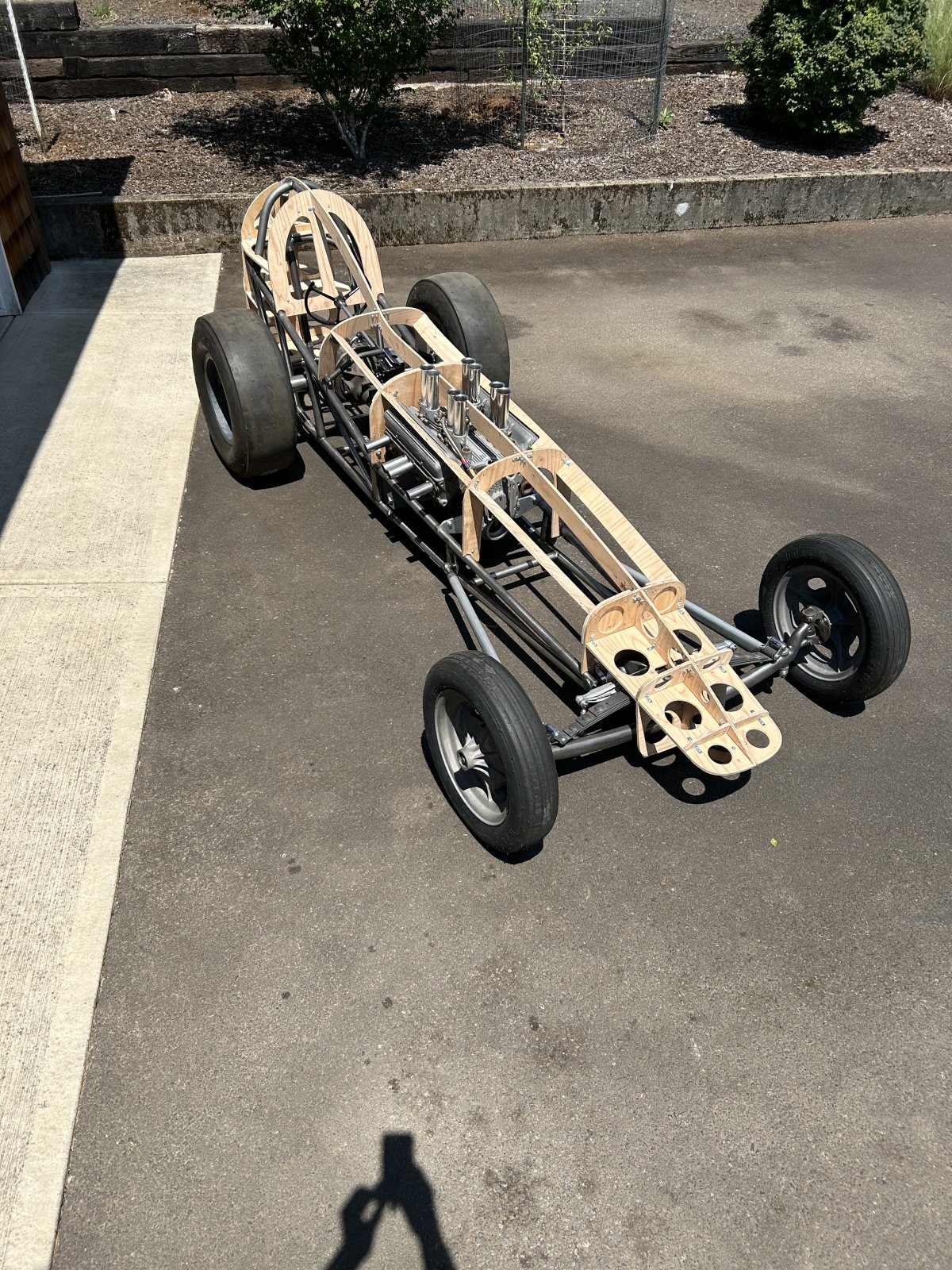

    Chris is taking a few days off, so I thought I would add a few shots. IMG_0918.jpg IMG_0930.jpg IMG_0941.jpg IMG_0944.jpg IMG_0928.jpg

    Took a few minutes to admire Chris’s wood work. See smoothed edges on plywood & all those lighting holes. Tail pieces lightening holes even follow shape of wood. & all those little metal brackets all bolted together. Obvious takes pride in his work does beautiful work

    I agree! It's one thing to make a throw away pattern, but this shows that he likes to have function - rounded edges for his own handling and to keep from marring the aluminum, plus holes to reach in and hold the parts in different areas PLUS form - make the stuff to a high visual standard too.
    Those bucks could easily be stained and sealed to display next to the completed dragster!

    Chris, I have a question. Do you save your wooden bucks on the slight chance that duplicate parts will be needed in the unforseeable future, or are they one-and-done then dispose of? Or does the customer get them?
    EDIT: I see they are going with the car. Is that common?
    All those holes are not just for lightening. They allow metal skins to be clamped to the buck while the part is being made. Very useful with large DeStaco clamps or equivalent.

    Depends on the project and customer. Most of the time they’re mine and get hung from the rafters (15’ ceiling). A few customers want them and display them with the car. I have a Kurtis midget set that I’ve used multiple times.
    This mockup is a little nicer than most because we’re going to show it with the car and I knew that going into the project. However 90% of my mockups get routered and sealed.

    When the individual panels/pieces are shaped I clamp them to the mockup using hand spring clamps to check fit using the cutouts / lightening holes. Before final trim clecos are used.

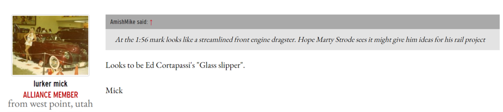

    Marty, have you looked at Bonneville 1954 video posted by jivebomber? At about 1:50 mark looks like streamline dragster making a high speed p***. Should give you some ideas

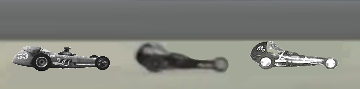

  30. jnaki
    Joined: Jan 1, 2015
    Posts: 11,426
    jnaki
    Hello,
    Here is the clip of the streamliner. It is the "Gl*** Slipper" if anything. It has been modified to accommodate the latest post.
    Jnaki
    Hello,
    @lurker mick has it right. If it was not taken in 8mm and for having that useless printing ruining the whole archive, it may have been easier to get better overall view of the race car. As it was, adding in popular old “Gl*** Slipper” photos into the overall comparison photo proves it to be the “Gl*** Slipper” during perhaps the Flathead stage, not the SBC stage.
    Jnaki
    I was able to find a similar photograph and in the insert comparison, my eyes accept the “Gl*** Slipper” version over any other streamlined racer at the time. (including the "Top Banana")
    note:
    I could not get through the whole thing due to the intrusive lettering... not good. But, as usual… YRMV
