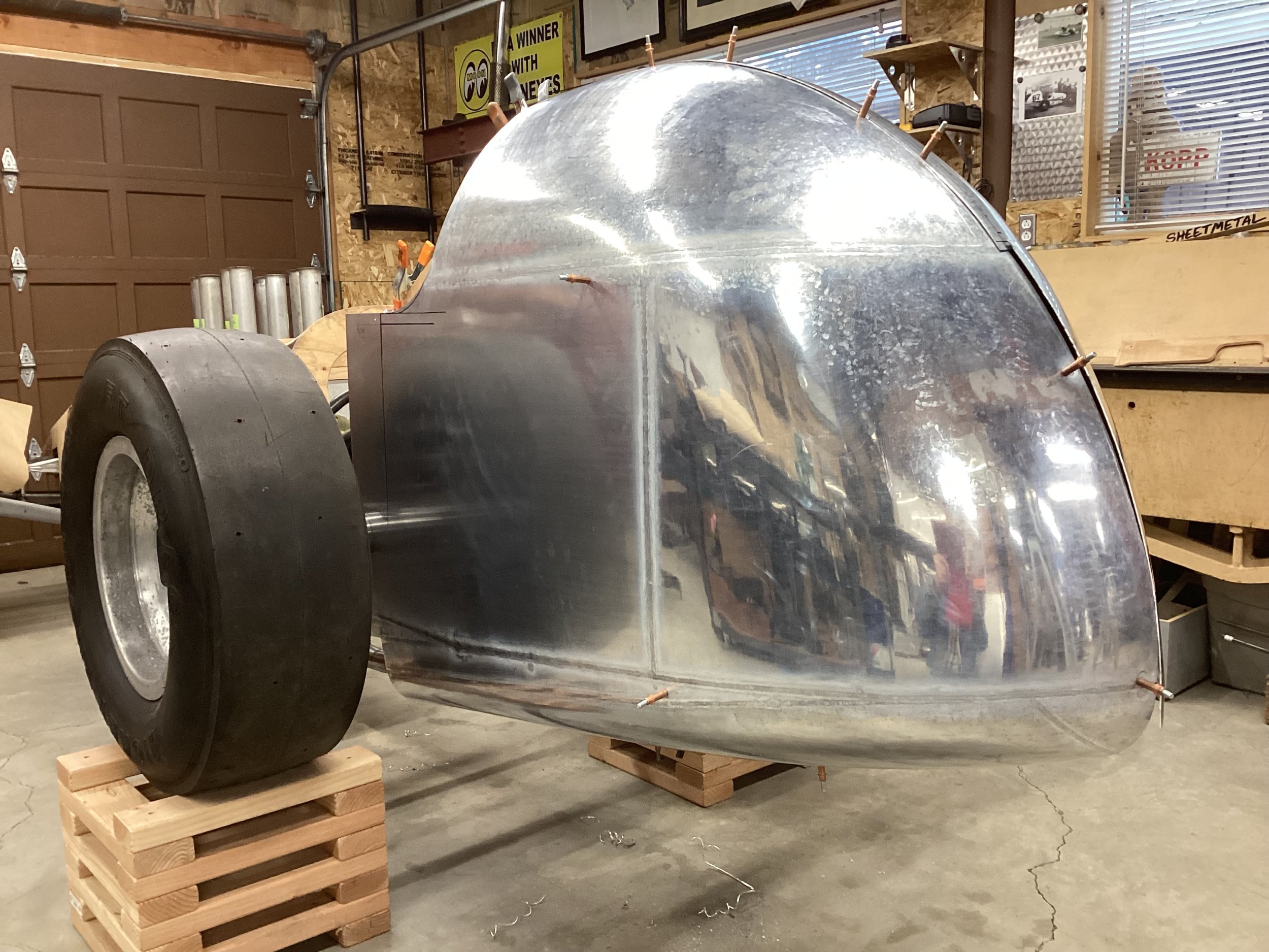

    Just 2 be clear Marty,
    Chris is Gas (Oxy-Fuel) welding these Aluminum panels ???

    Oxy- Nitrogen to be exact.

    Oxygen-Nitrogen ?? Please teach us all here on the hamb ... My understanding is Nitrogen is "neither flammable nor explosive". In fact I have 2 Nitrogen charged fire extinguishers in my little shop.
    Are you sure it's not Oxygen-Hydrogen ?? :)

    I probably shouldn’t have answered that. You are no doubt correct, with Hydrogen.

    Hey, I was half right, they both end in gen.

    By the way I was taught to Gas Weld Aluminum with Oxygen and Acetylene, 1st by GM in the 80's when the smaller GM A Bodies (Monte Carlo/Regal/Cutl***) came with Aluminum Deck lids. Then a second cl*** by the late great Kent White. In both cases we used "Dodileum" Blue tinted Goggles to see what going on.

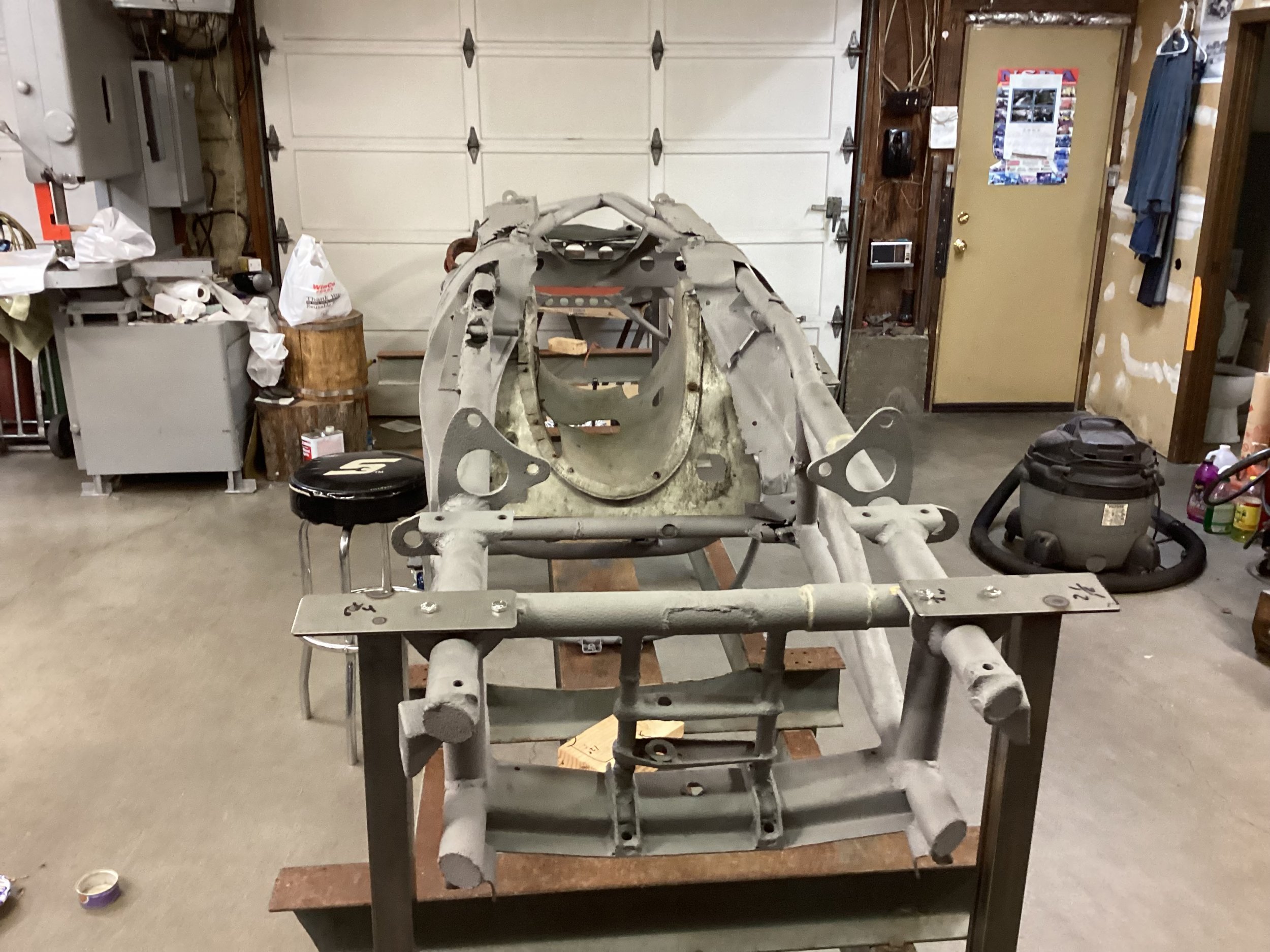

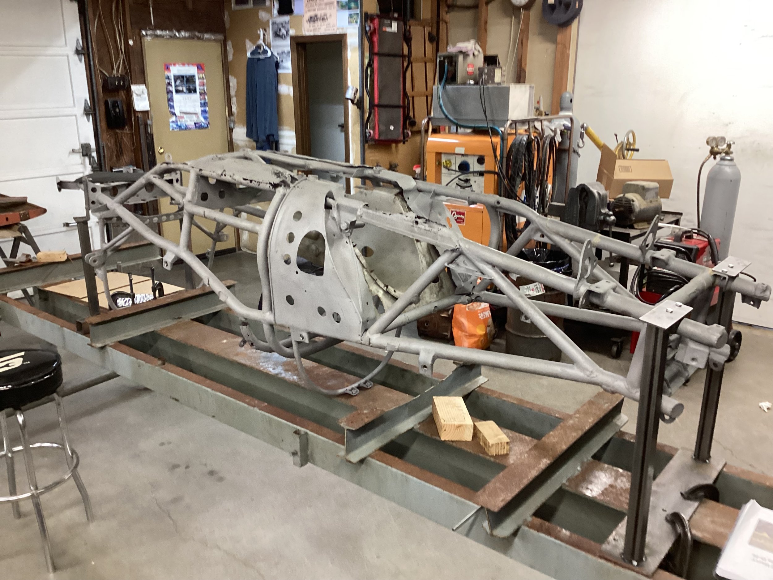

    I had mentioned earlier about the 1946 Gran Prix ch***is that needs tube replacement. This car was driven by Zora Arkus Duntov in 1948. IMG_1131.jpg IMG_1128.jpg IMG_1129.jpg IMG_1127.jpg

    That’s an impressive car to work on Marty, and with Duntov history too!
    Will you be duplicating the welds when you do the repair?

    I am going to gas weld it .

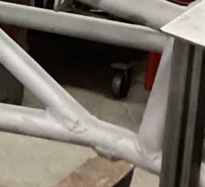

    krazee
    Is that a gas fusion weld, it looks like "steel braze" which was a high temp bronze that we used through the late 50's through to ally monocoque construction. I still do a number of repairs each year on mainly English space frame ch***is' that are mostly "steel braze". To me it's pretty cool working on this old stuff that all has history. I have repaired a pre war Alfa ch***is the was some sort of steel braze, but lower heat than what I have. I purchased my rods in the mid 1970's and use a Eutectic flux powder that I mix with water to make a paste. I have hopefully enough left to see me out. I purchased the rods from the manufacturer and had to buy in bulk.

    The only brazing that I can see, is on the repairs.
