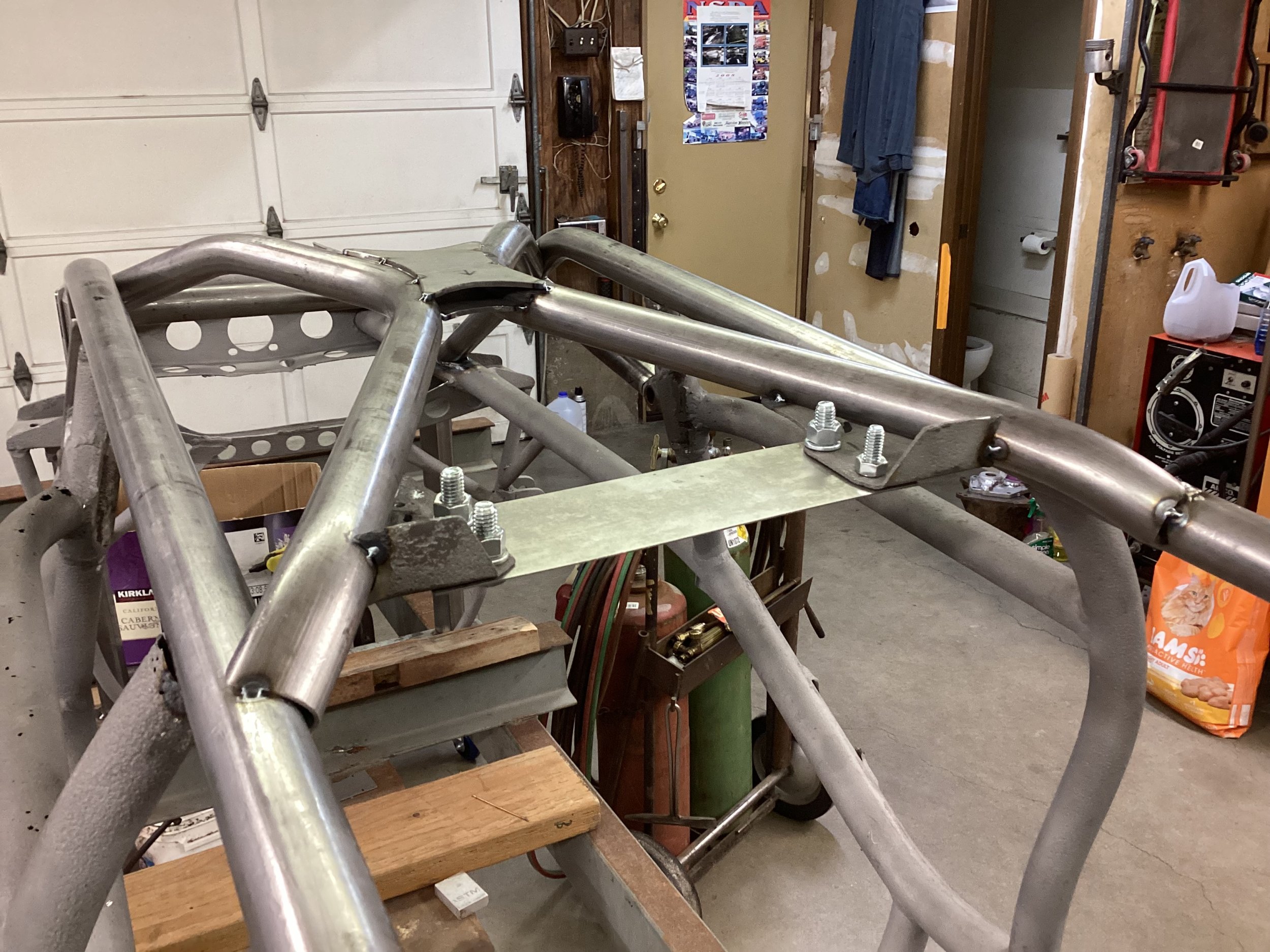

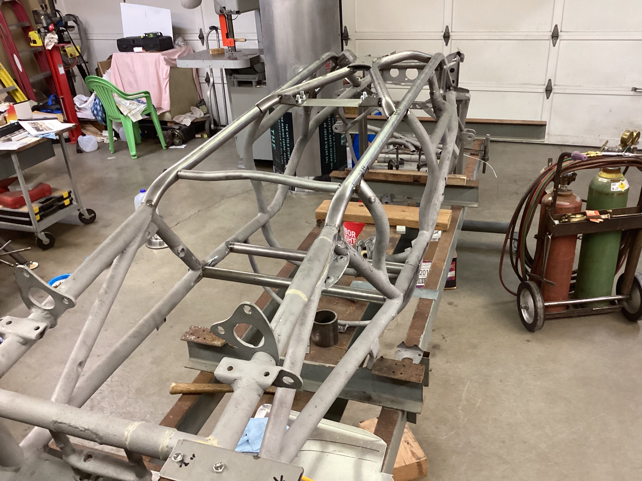

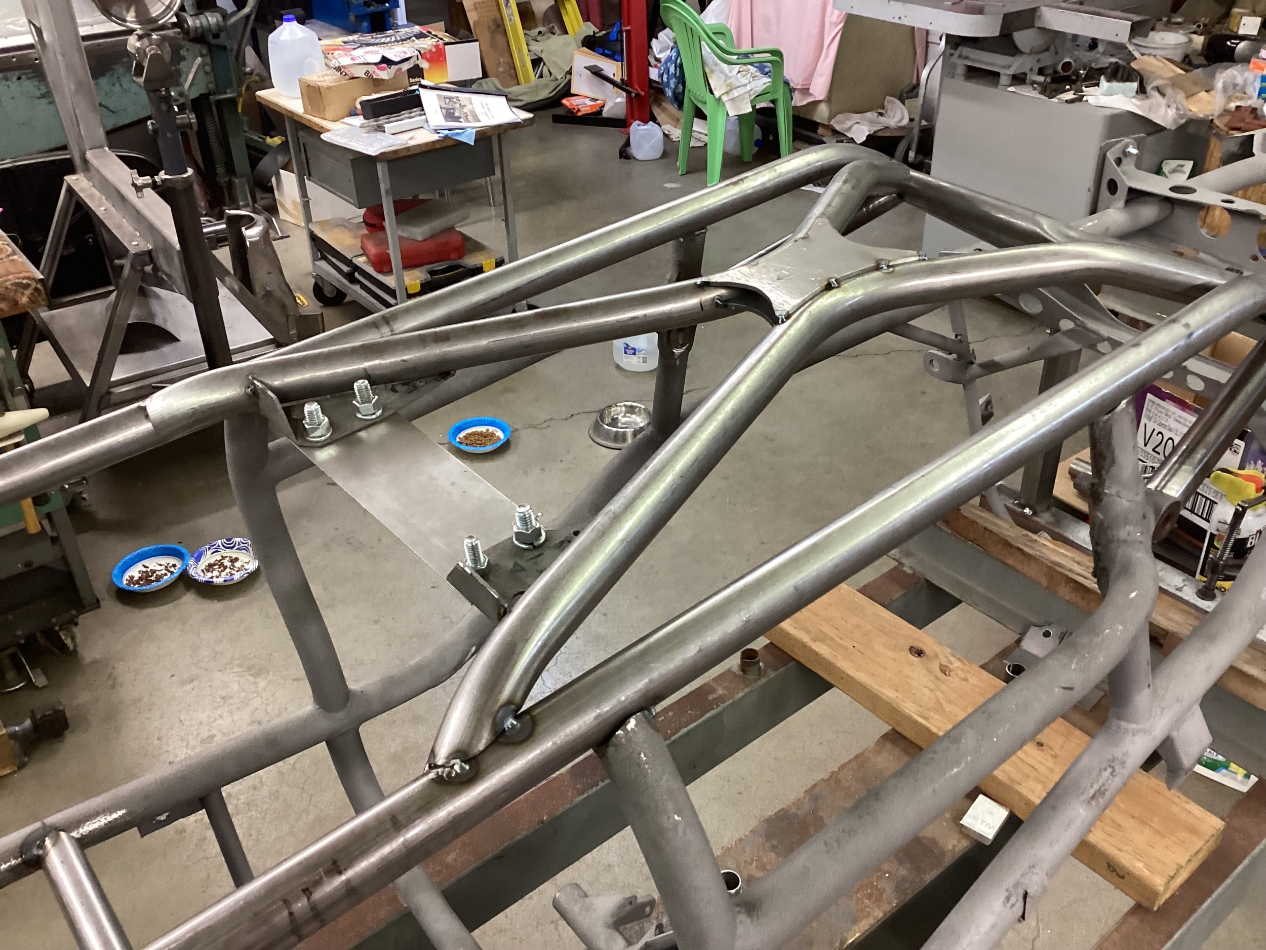

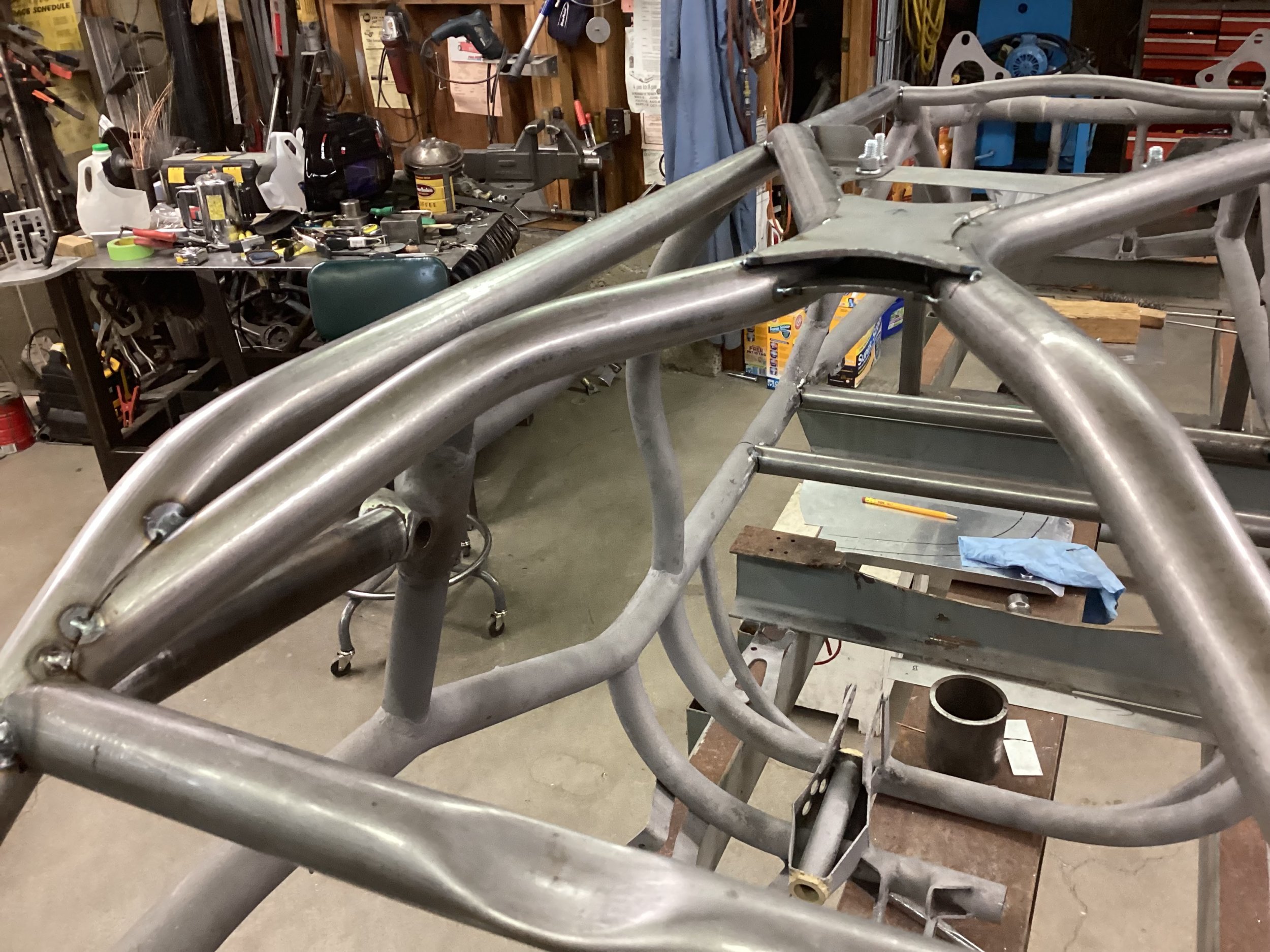

    Getting to the end on this one, perhaps this coming week. IMG_1227.jpg IMG_1228.jpg IMG_1229.jpg IMG_1230.jpg IMG_1226.jpg

    Got it upright and a few more brackets tacked on. Better view of what it looks like with steering in place. IMG_1231.jpg IMG_1232.jpg IMG_1233(1).jpg IMG_1234.jpg

    Do you remove the remainders of the cutoff tubes from previous versions? Try to make it look exactly like the original? Or leave those stubs as a reminder of the life it lead?

    The 2 stubs at the front, are the base of a front hoop to support the nose. Once the car is together, and the nose mounted, I will install a new hoop. There are other places on the ch***is, where brackets to hold the side fuel tanks,
    will stay as part of the car's history. Ed is really sharp at what needs to stay and go.
