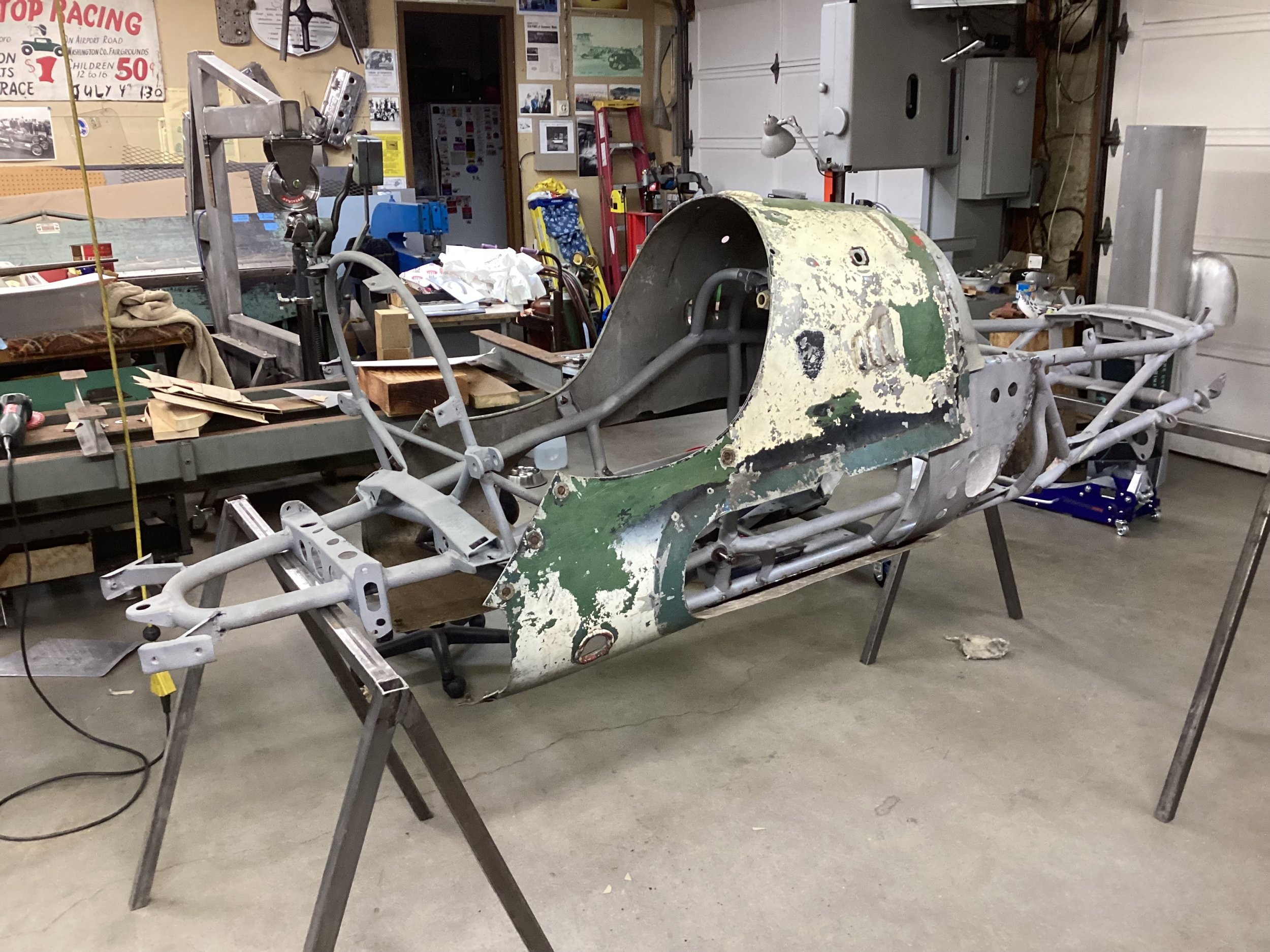

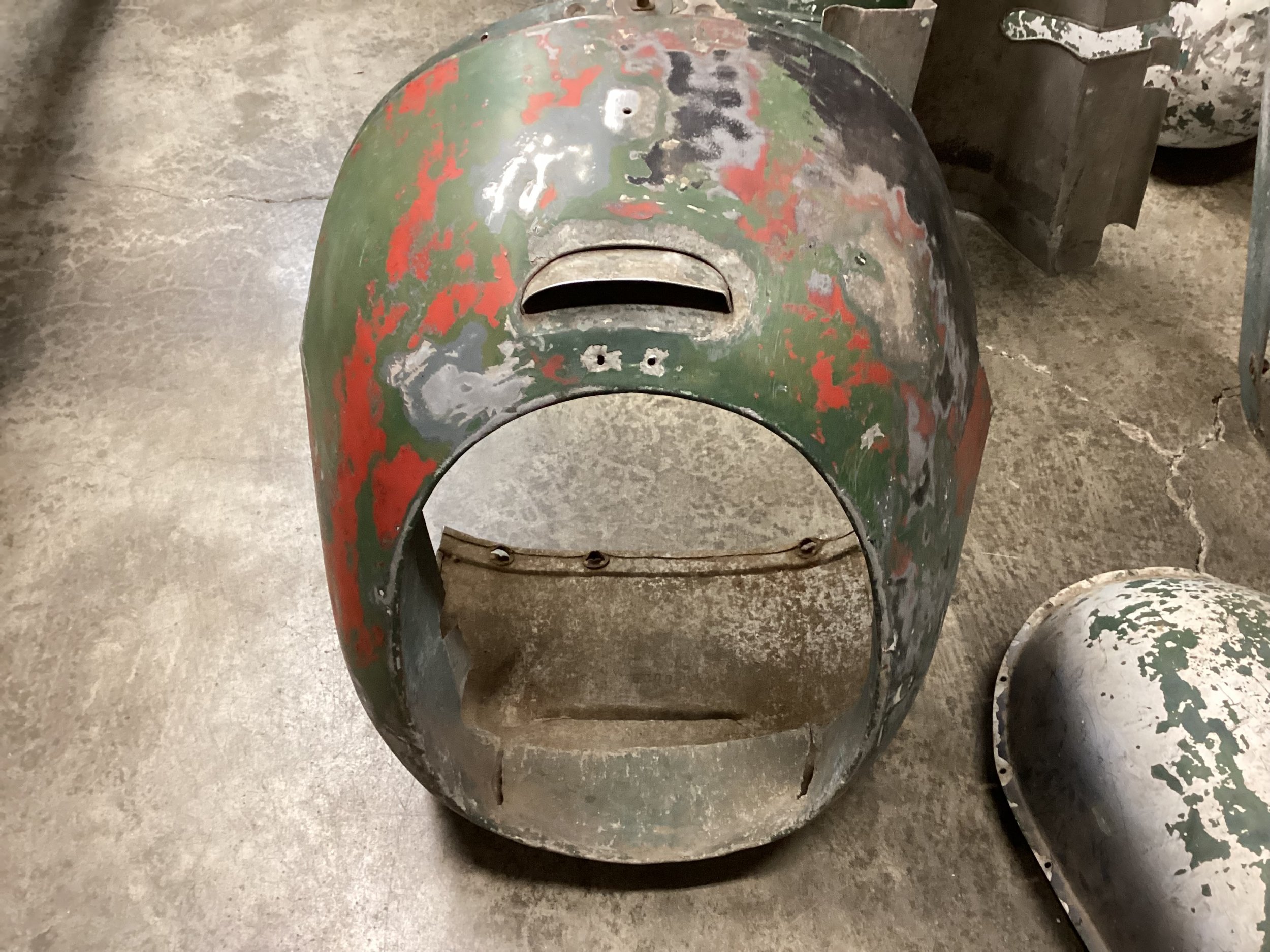

  1. And this is all being Oxy-Acetylene welded like originally? I thought I saw a joint that was brazed. I have read that Colin Chapman brazed all his race ch***is because it allowed post race damage repairs to be made easier. Just another amazing project you are helping to come back to life!
    porkshop and chryslerfan55 like this.
  2. Marty Strode
    Joined: Apr 28, 2011
    Posts: 9,685
    Marty Strode
    There are some brazed repair joints. I gave the gas welding a try, and was concerned about ruining this ch***is. So I used larger filler rod and washed it around with a Tig. Just couldn’t take a chance. It’s going out for sandblasting tomorrow, to nib up the new steel, for paint.
  3. Marty Strode
    Posts: 9,685
    Marty Strode
    Got it all s***ched together, and checked the dry sump oil tank for fit. WOW, what a piece it is, haven't counted all the rivets yet ! Firewall and ch***is tin will be installed tomorrow, and then IMG_1245.jpg IMG_1242.jpg IMG_1243.jpg IMG_1244.jpg IMG_1241.jpg IMG_1237.jpg IMG_1239.jpg IMG_1240.jpg IMG_1236.jpg IMG_1238.jpg back on the '29 !
  4. Weedburner 40
    Joined: Jan 26, 2006
    Posts: 1,121
    Weedburner 40
    Wow, that's a lot of rivets. What a work of art though. Looks like something from an older aircraft, they riveted everything on airplanes.

  6. 1971BB427
    Joined: Mar 6, 2010
    Posts: 9,816
    1971BB427
    from Oregon
    That is indeed a true show of craftsmanship by whoever built that tank! Simply amazing, and so cool!

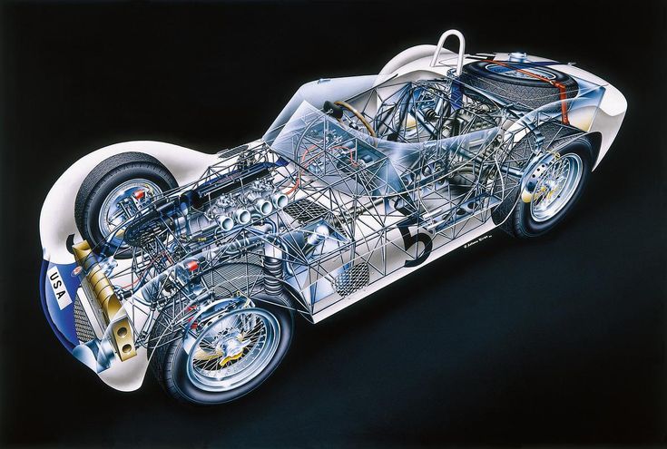

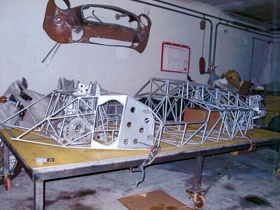

    Now you're primed for a "Bird Cage" Maserati

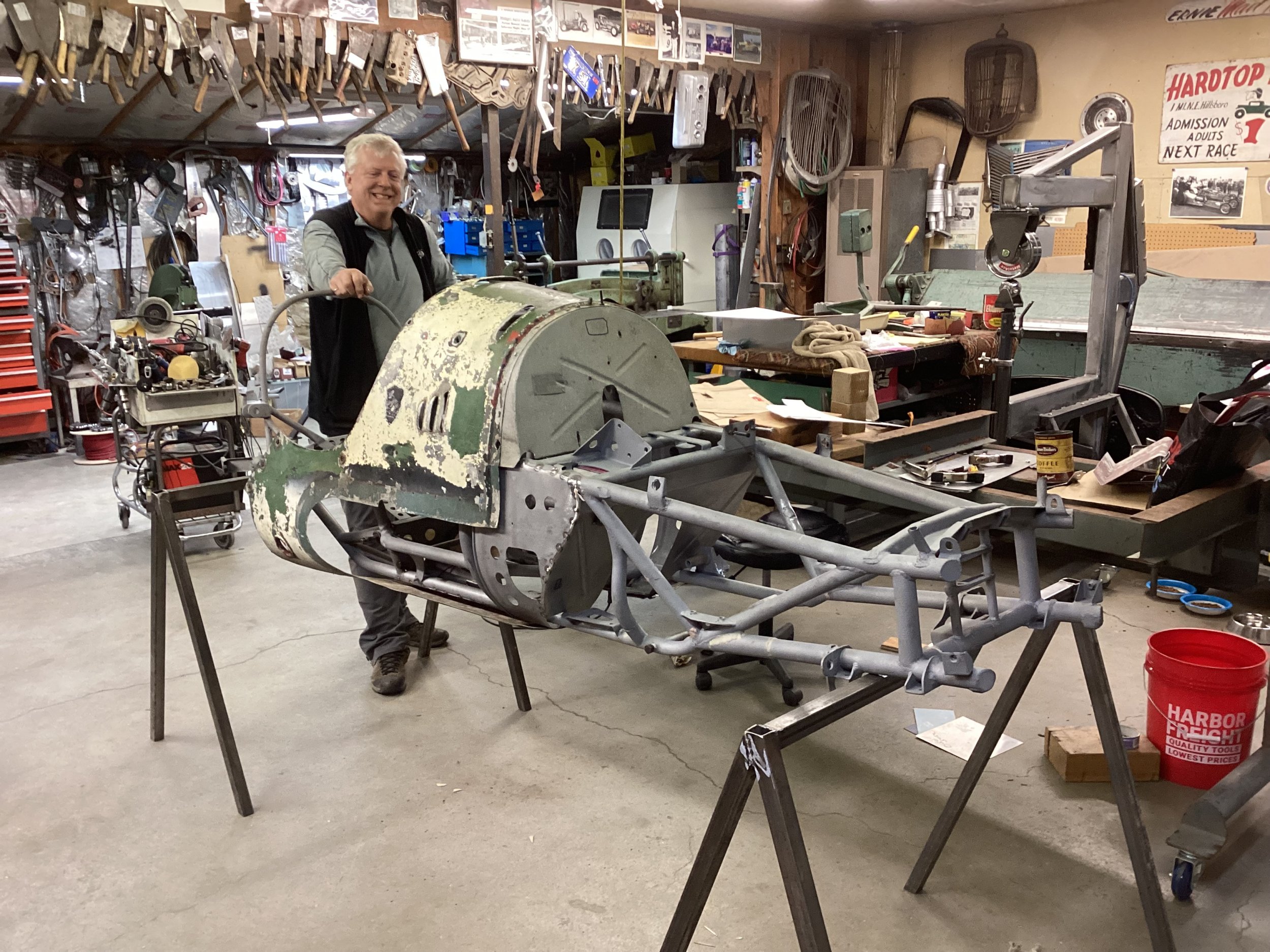

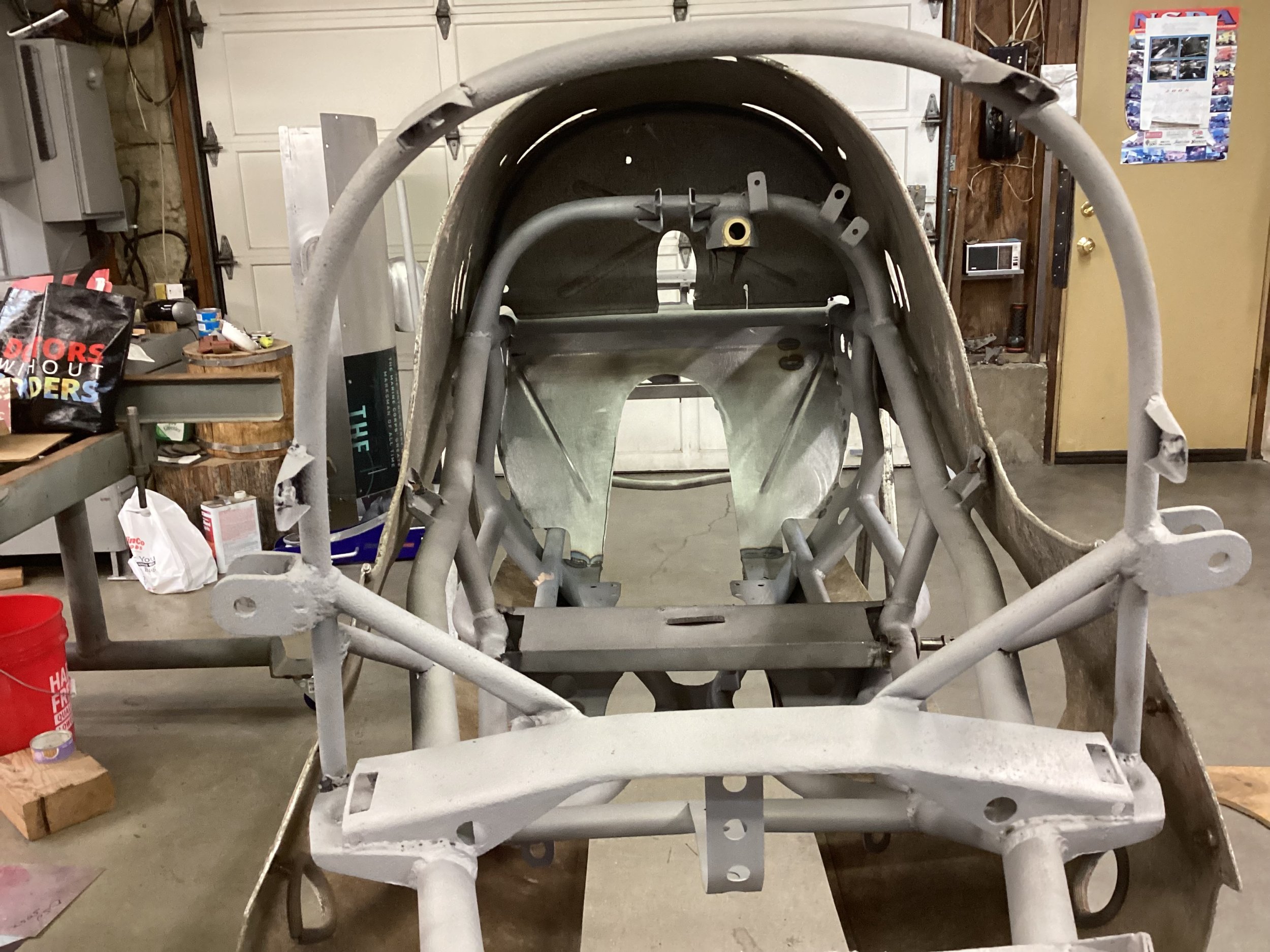

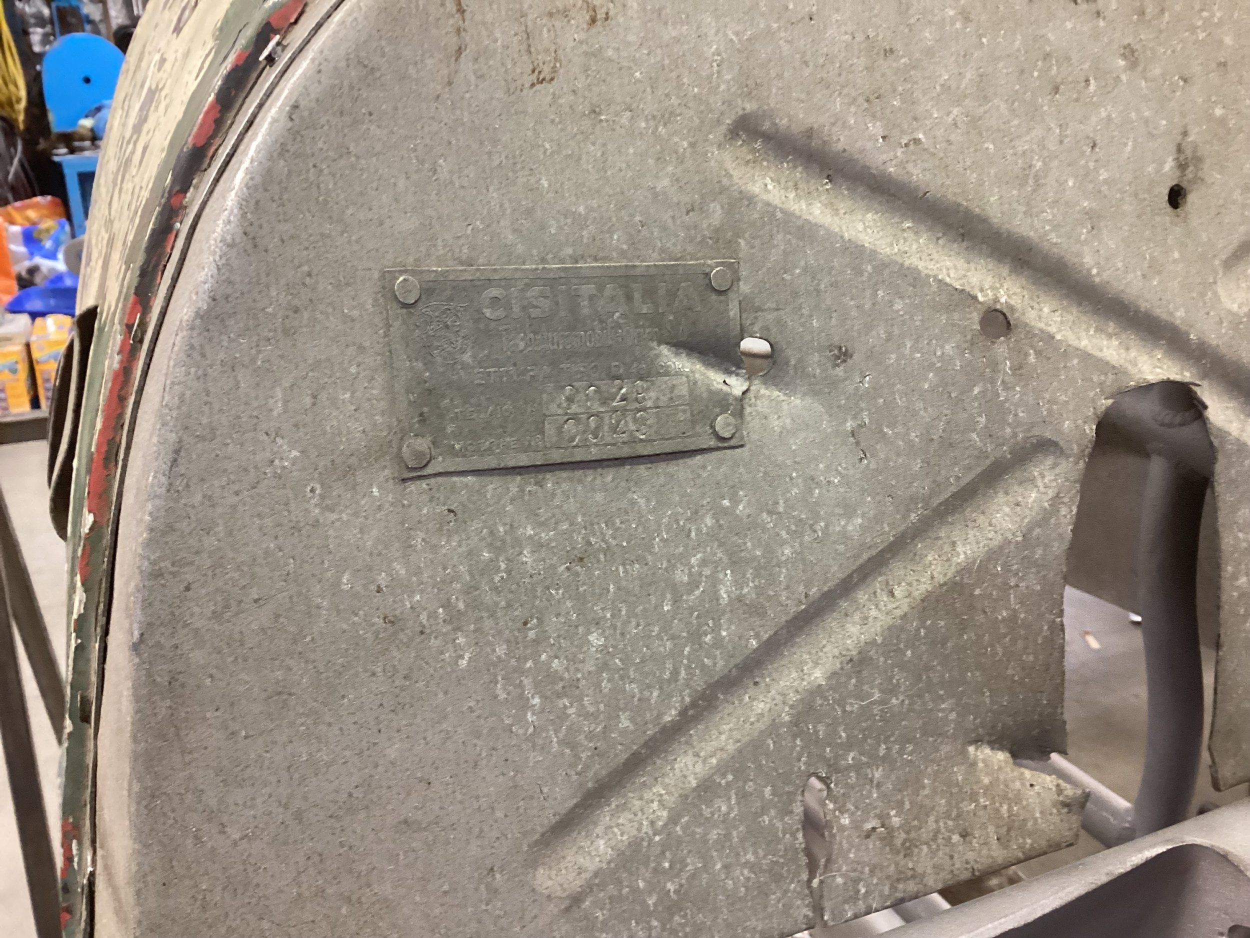

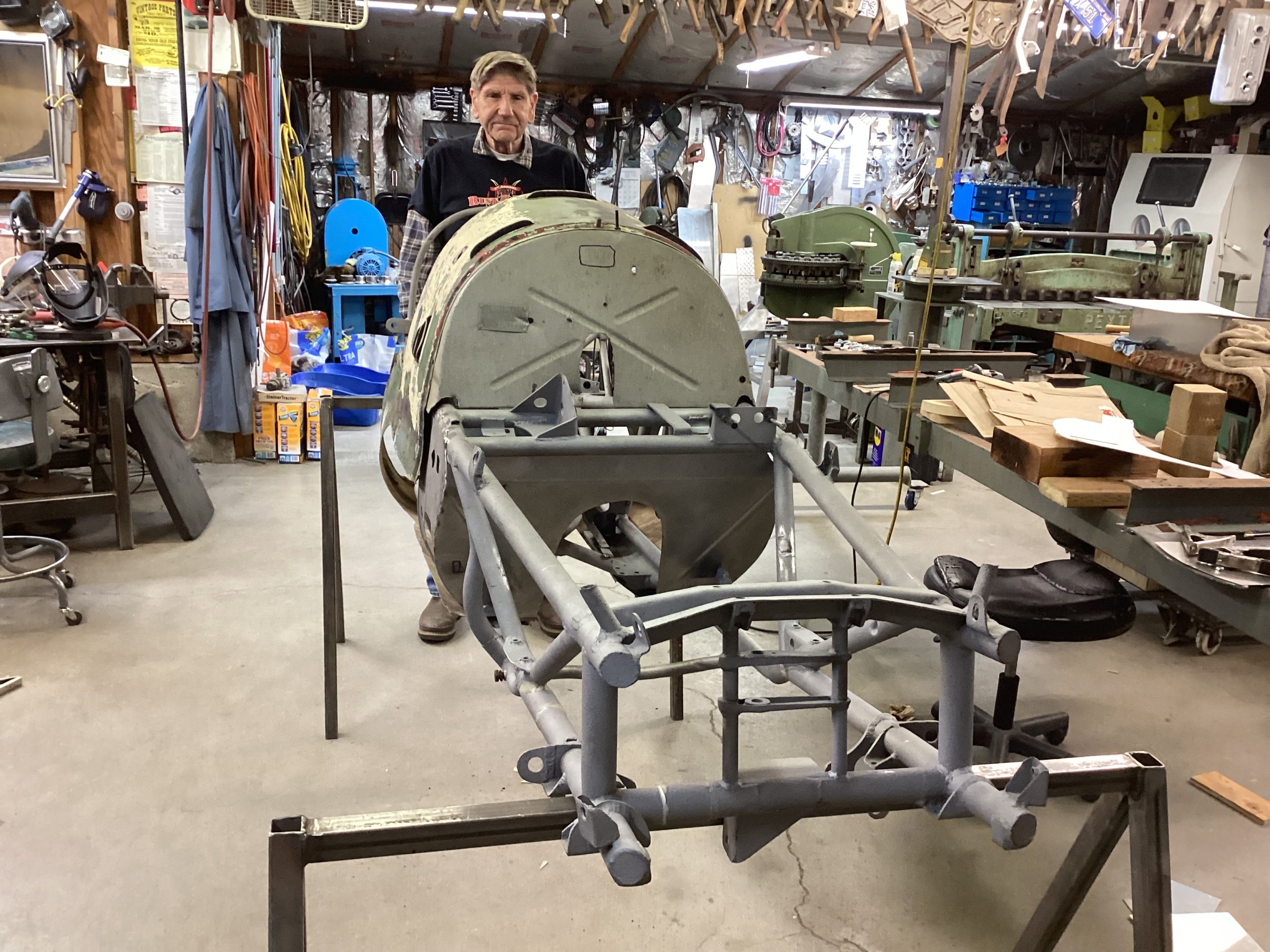

    I got my part of the Cisitalia done, the body still fits ! Tomorrow it's back on the '29RPU. IMG_1123.jpg IMG_1248.jpg IMG_1249.jpg IMG_1250.jpg IMG_1252.jpg IMG_1257.jpg IMG_1259.jpg IMG_1122.jpg

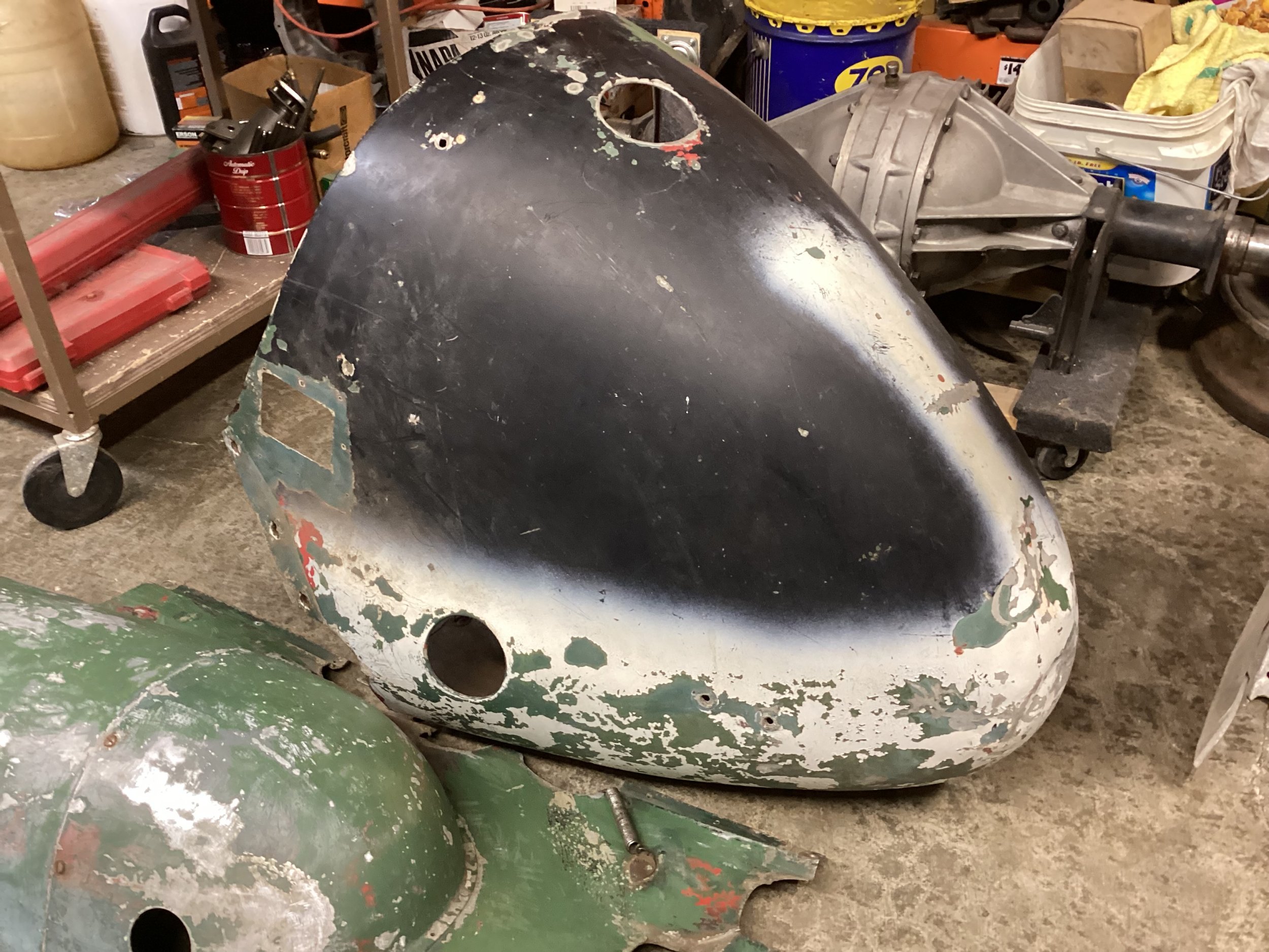

    I went down to Chris Kopp's place to help him tack weld the halves of the tail section together, and got to see the wonderful progress he is making on the body. I will be picking it up next Thursday to take to the Portland Transmission Show. Hope to see some of you there ! IMG_1455.jpg IMG_1465.jpg IMG_1467.jpg IMG_1470.jpg IMG_1473.jpg IMG_1475.jpg IMG_1496.jpg IMG_1510.jpg IMG_1514.jpg

  28. 1971BB427
    Joined: Mar 6, 2010
    Posts: 9,816
    1971BB427
    from Oregon
    Wow Marty! Chris is really moving on the metal work! Love seeing his torch welding on the aluminum body!
