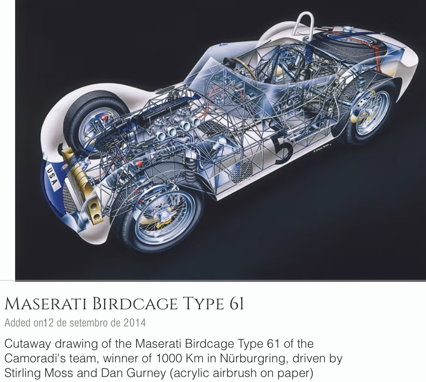

    I sure don't. I have always loved cut-away illustrations but this is one of the best showing so much detail and never losing proportion or perspective.

    Skärmavbild 2025-05-04 kl. 14.21.33.png Skärmavbild 2025-05-04 kl. 14.20.15.png Skärmavbild 2025-05-04 kl. 14.18.57.png
    https://www.antonioeiras.com/gallery

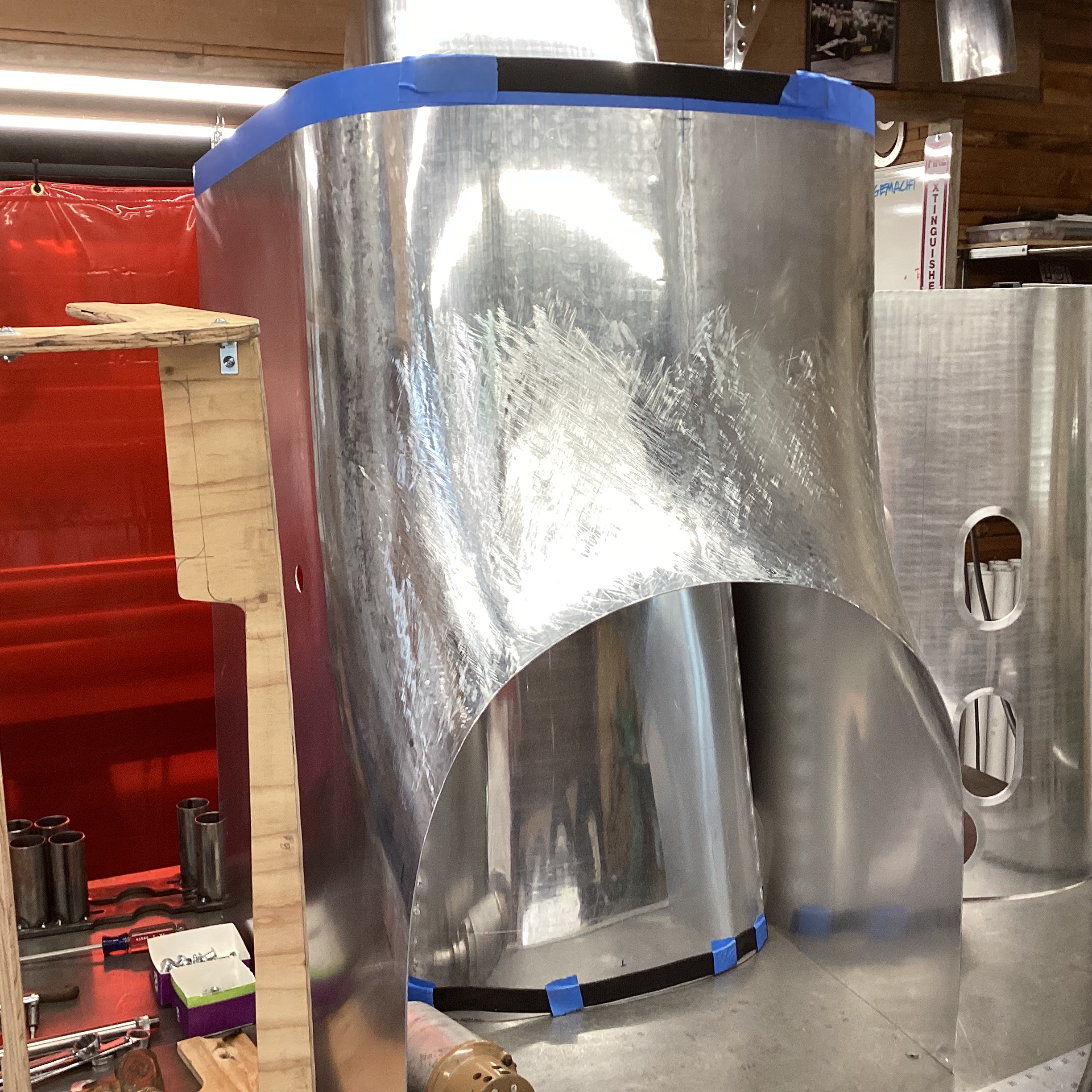

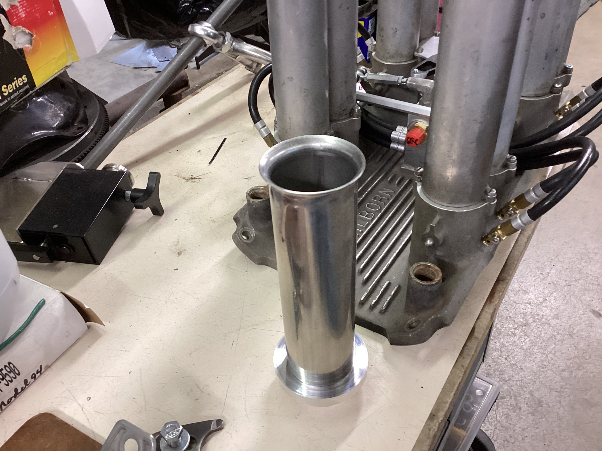

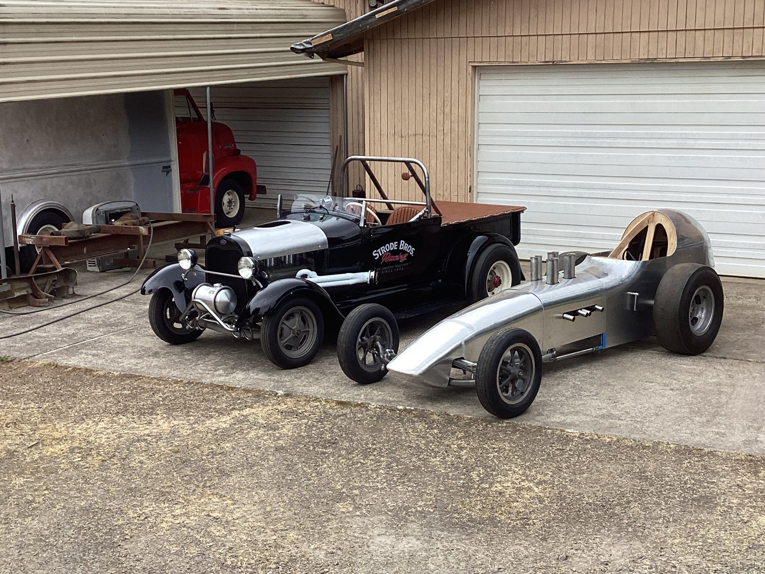

    I stopped at Chris Kopp's place to check out the belly pan plans, he is making progress. Picked up the injector, to shorten the stacks from 10 to 7". IMG_1627.jpg IMG_1623.jpg IMG_1624.jpg IMG_1625.jpg IMG_1626.jpg IMG_1620.jpg IMG_1622.jpg IMG_1621.jpg

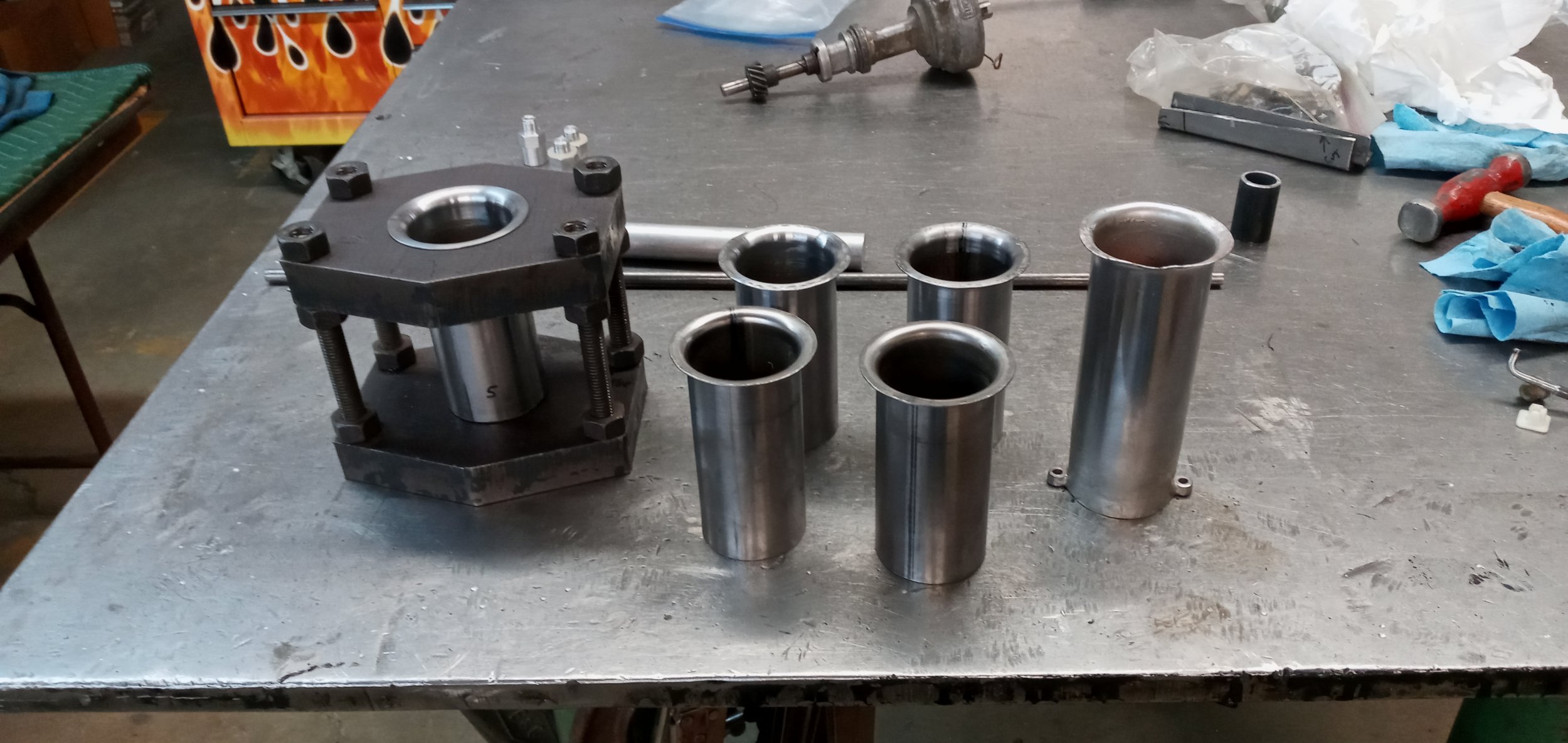

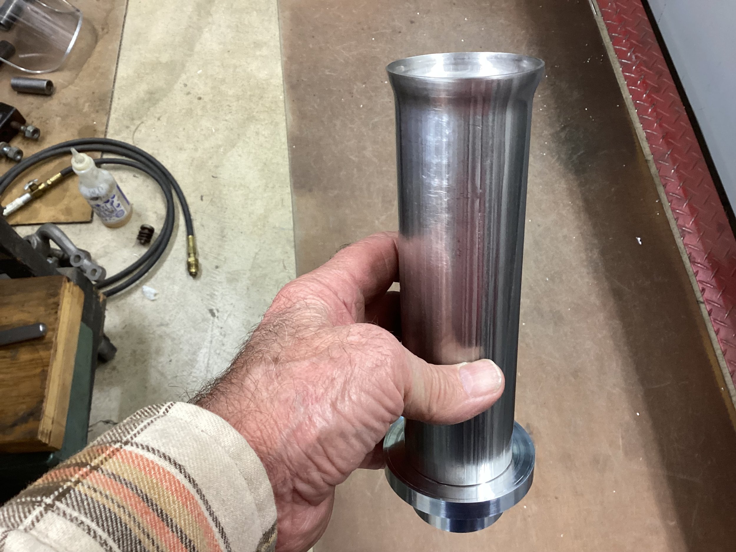

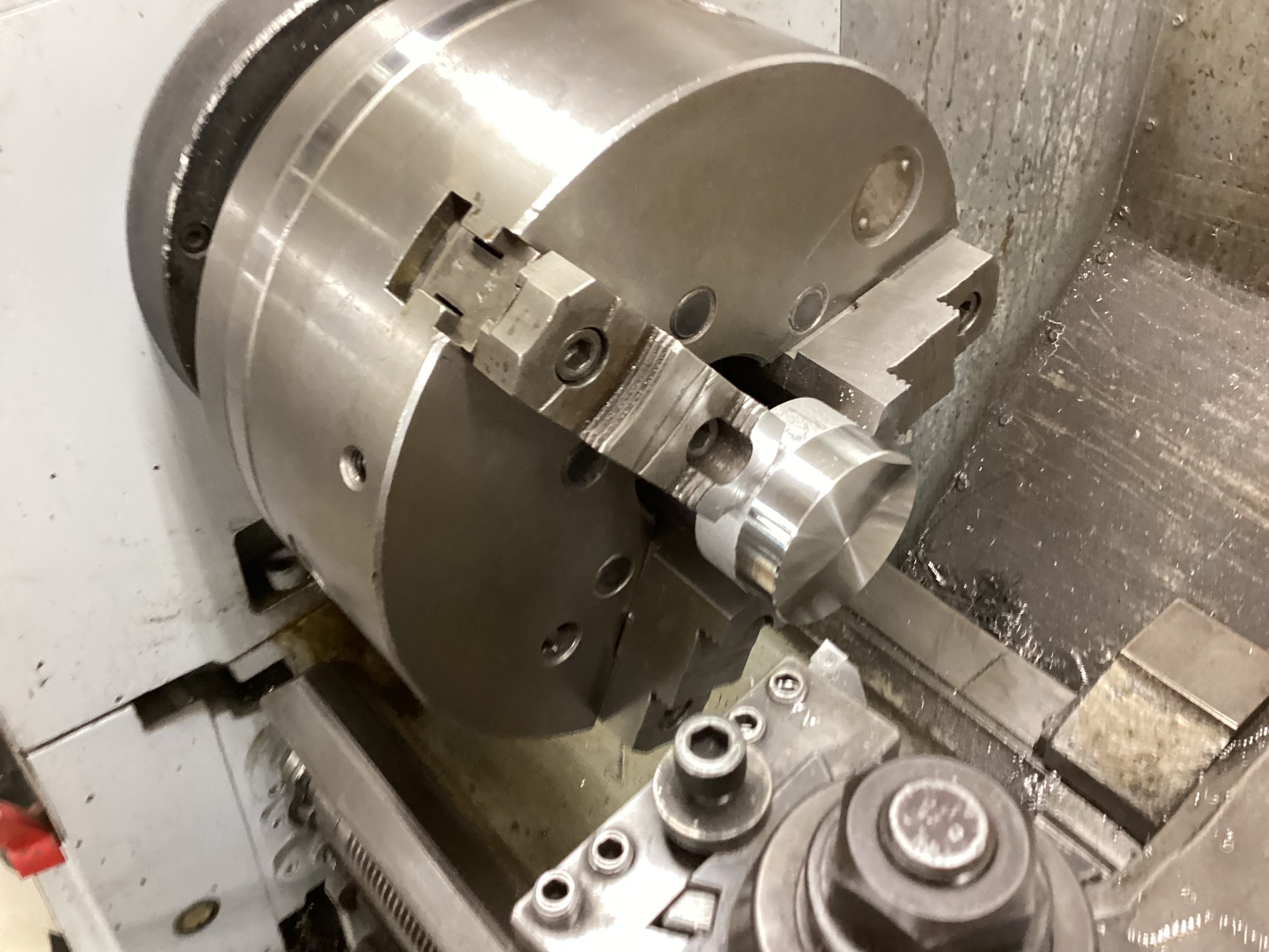

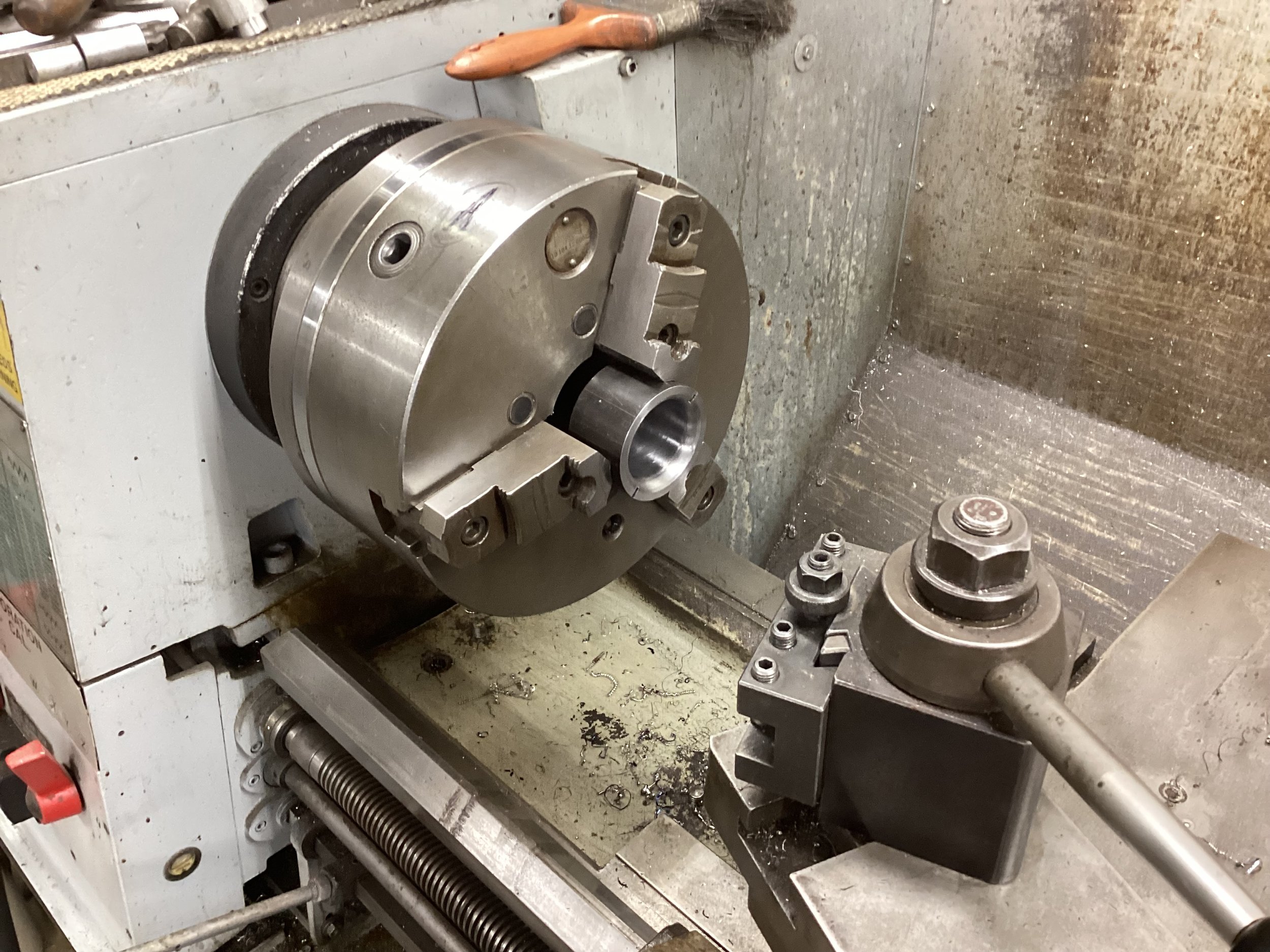

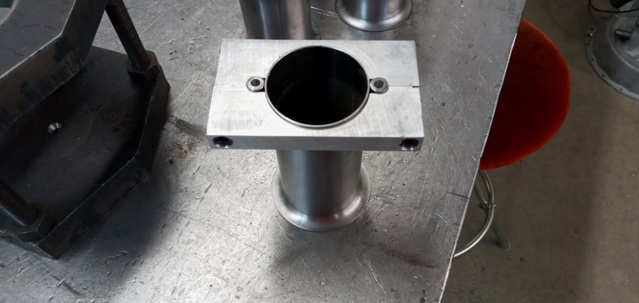

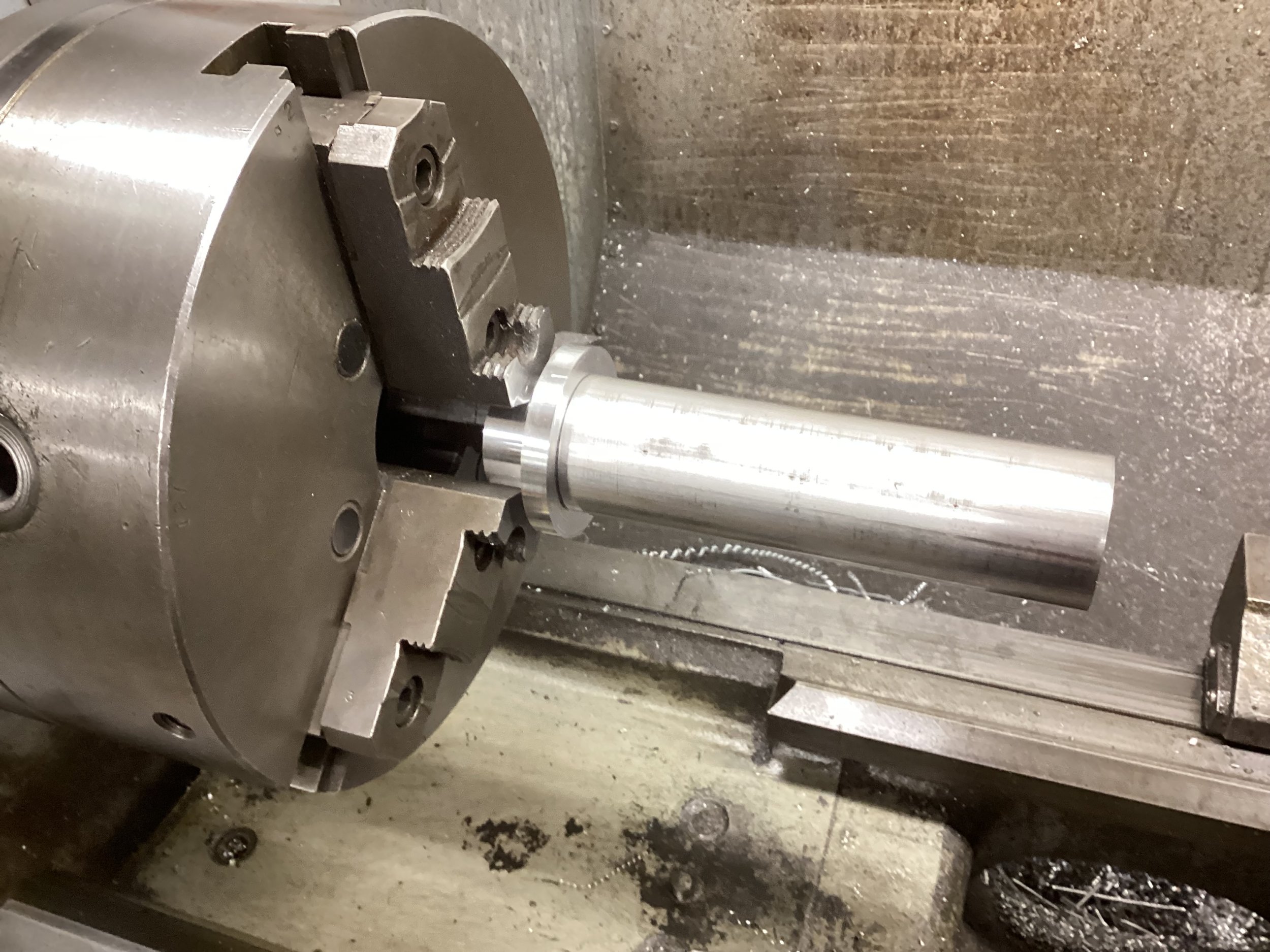

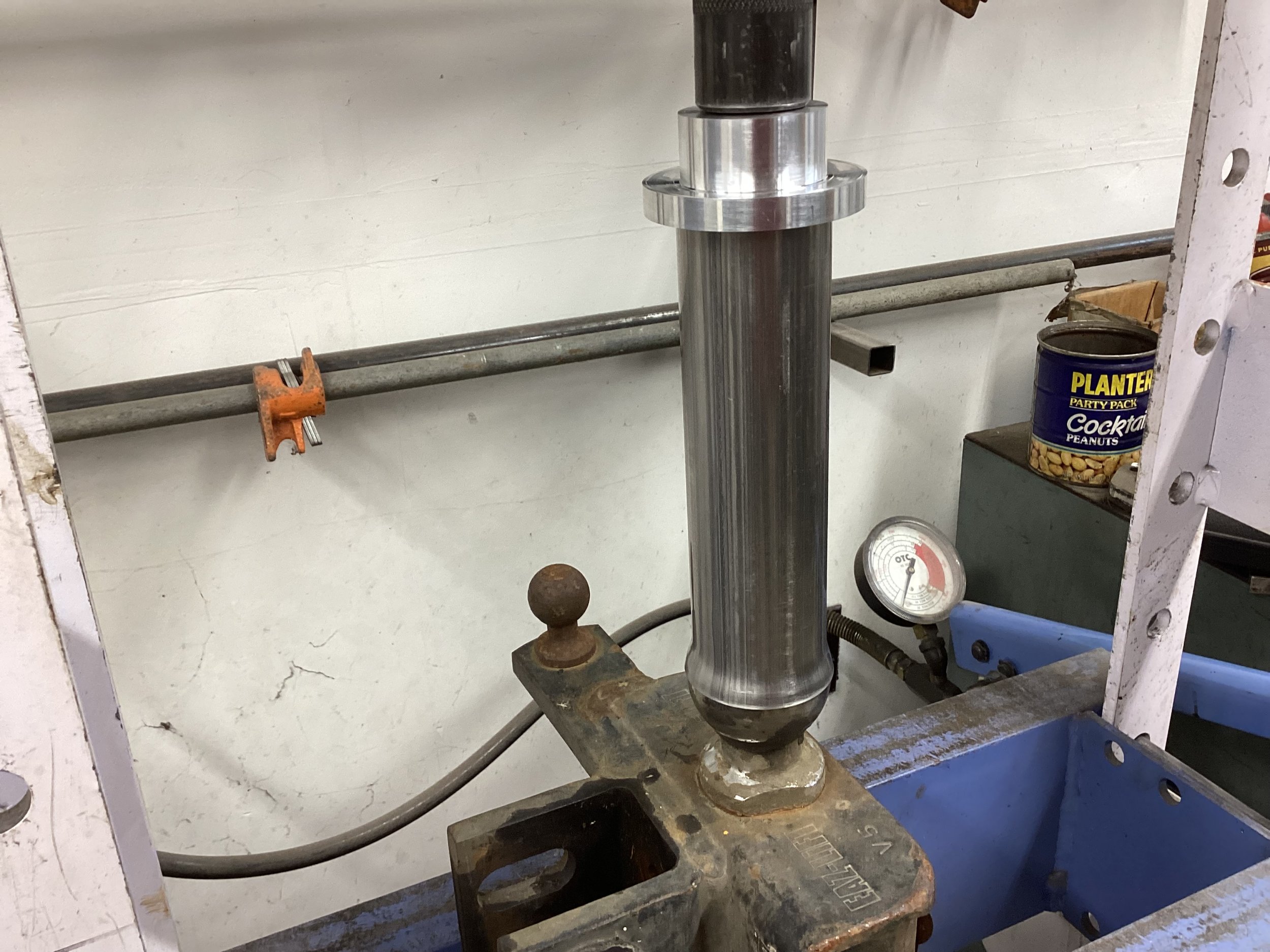

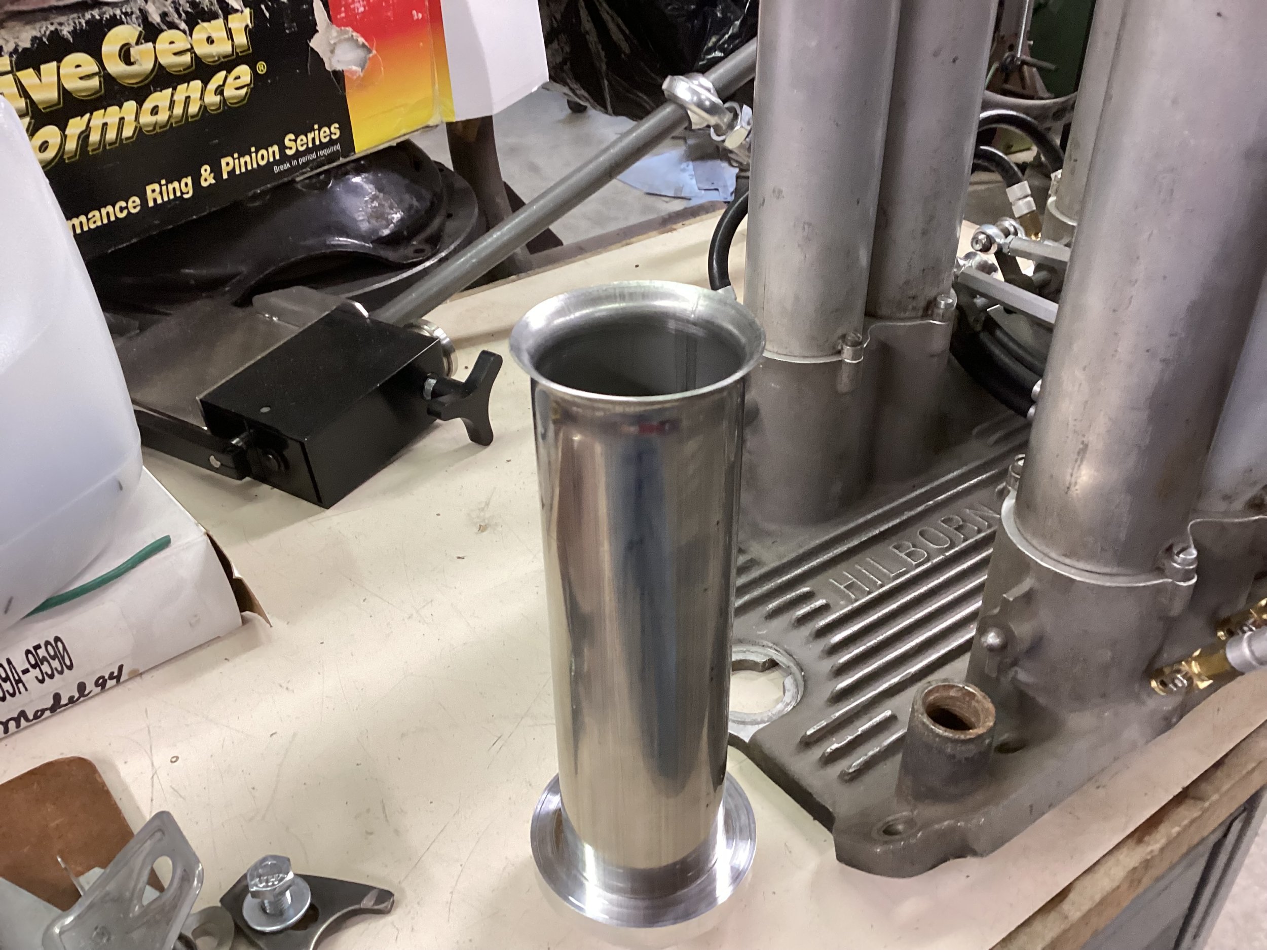

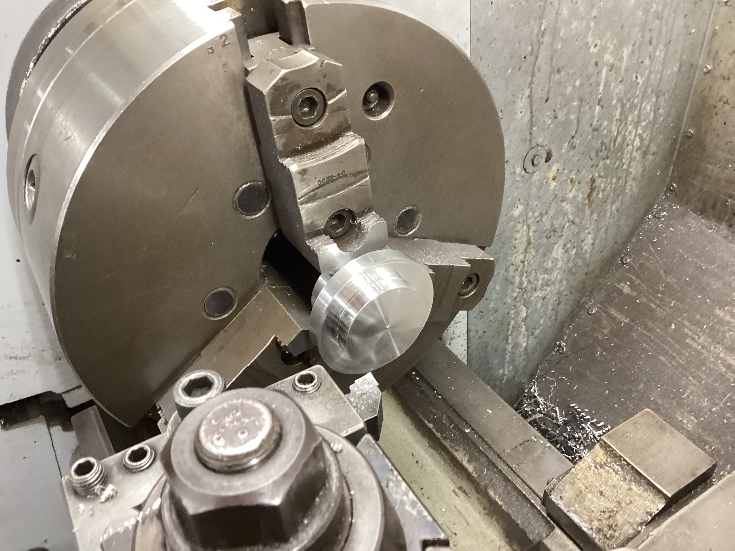

    I have been toying with the idea of shortening the 10" stacks on the Hilborn. So instead, I ordered a 6' piece of 2-1/8"- .049 wall stainless from Burns Stainless. After machining some tooling to support and keep the tube round during the flaring process, I am making some 6-1/2" long ones. It works well to first push one end over a 2-5/16 hitch ball, then install the support collar, and use the top of an Argon bottle to finish the flare. Next I will be making a fixture to hold the pieces while tack welding the mounting bosses on the bottom, of the tubes. IMG_1697.jpg IMG_1560.jpg IMG_1639.jpg IMG_1641.jpg IMG_1643.jpg IMG_1685.jpg IMG_1687.jpg IMG_1688.jpg IMG_1690.jpg IMG_1691.jpg IMG_1696.jpg

    So much cleaner than my feeble attempts, Marty. Maybe I’ll send you some $$$ and have you make some more for me…

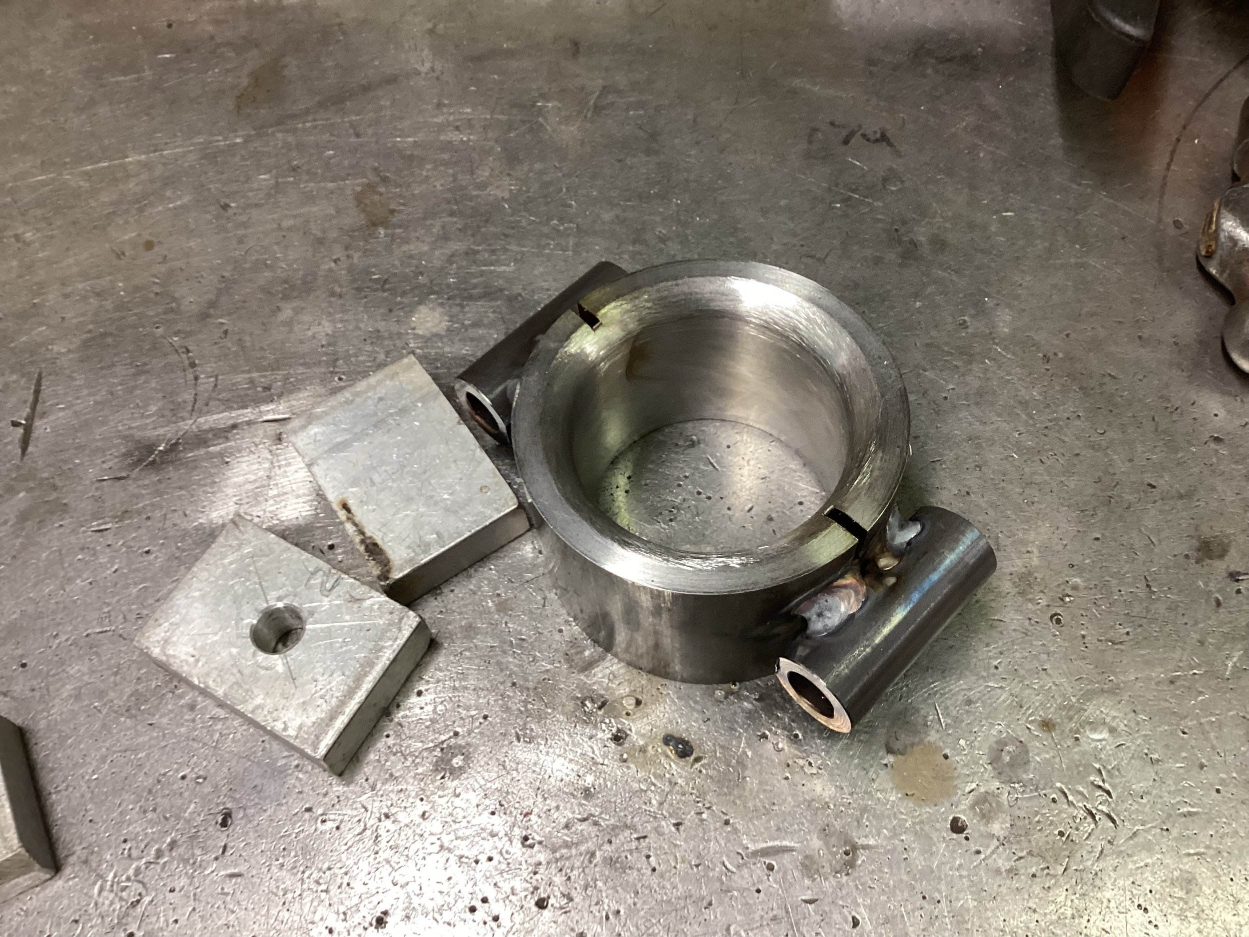

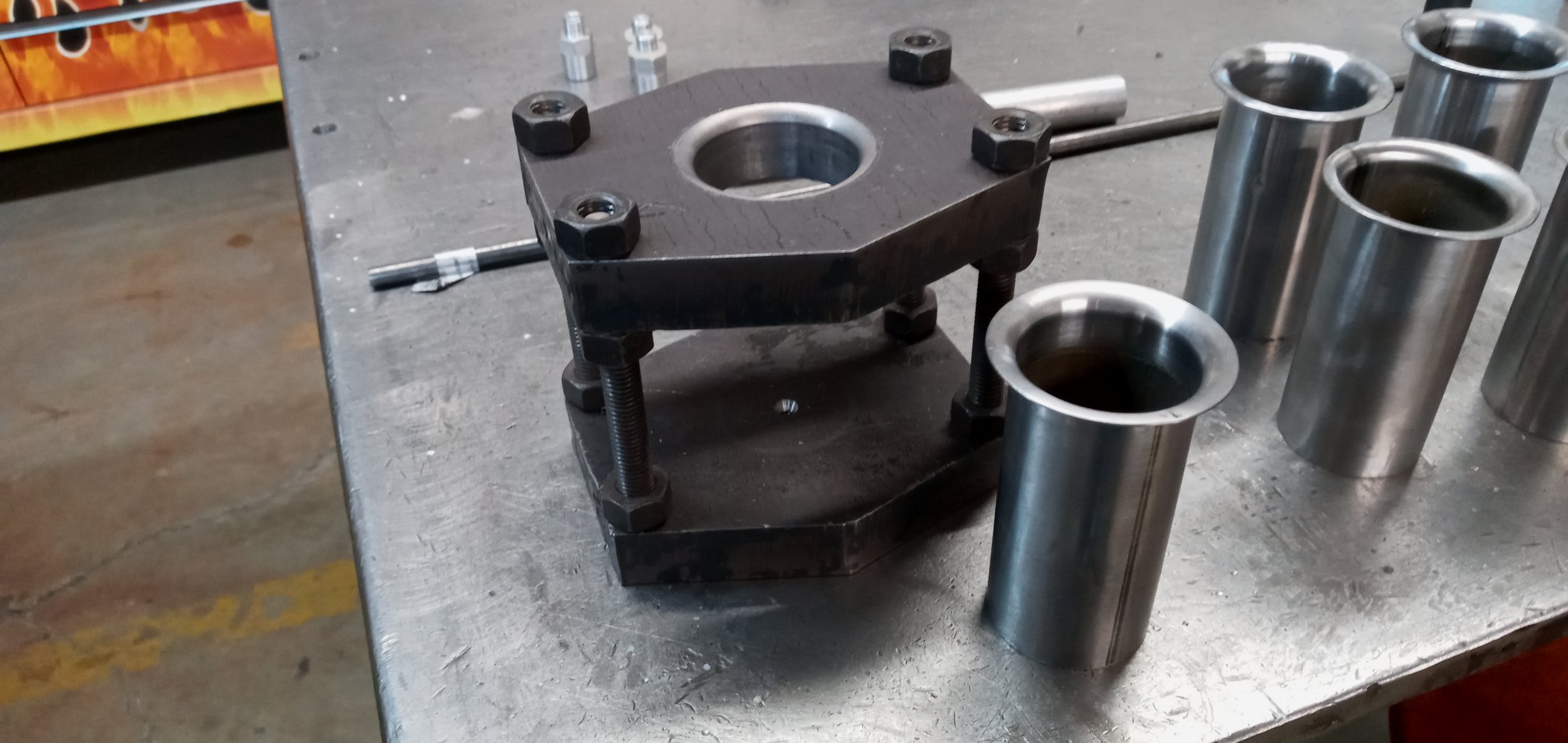

    Marty, this is what I just made up the last two nights. I needed 2 1/16 4.5 long stacks for my Olds engine. It is adjustable for different lengths and the aluminum piece (jig) to hold the ears to weld them on. Now if I could just weld! I also used a trailer hitch ball to start and a welding bottle cap to finish.

    I'm a rank dufus next to you guys, but if you have access to a lathe, why not have a center support dowel, the tubing and an outer collar with the bell shape (or a forcing cone in the tail), then turn or spin it like the moon tank halfs?
    Is Stainless too hard?

    Well now, that's how it's done ! It would have taken me a month to make anything close to that. Yours are closer to original Hilborn. Are yours mild steel, or stainless ? I think there is a market for those !
  22. Flatrod17
    Joined: Apr 25, 2017
    Posts: 688
    Flatrod17
    Marty, they are just some exhaust pipe I had laying around, but pretty much the same specs as your stainless tube. I was just trying to see if I could do it and if repeatable. I did have one bent up original Hilborn tube, straighten it as best I could to try and copy it. I am happy with what I got so far, but I do see room for improvements. And yes there has to be a market, as nobody can find 2 1/16 tubes as far as I can tell.

    Let me know when you get it perfected.Its head and shoulders above any set I have or have purchased.

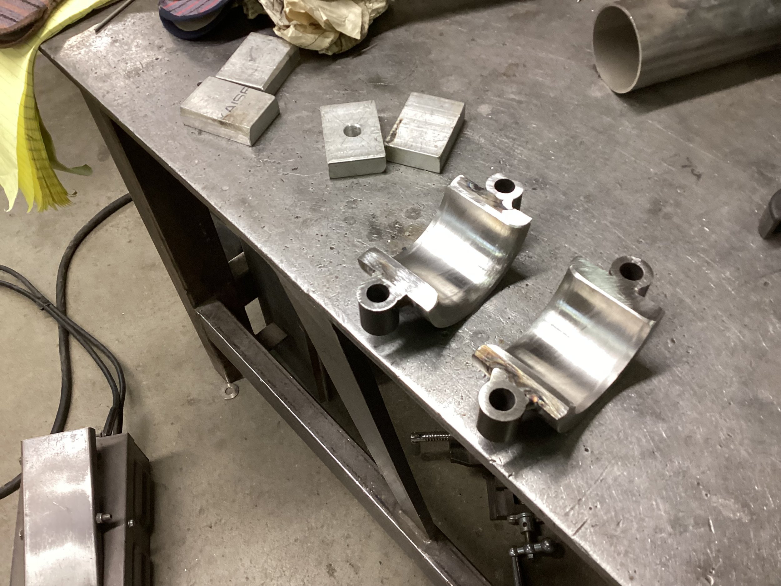

    I have not looked around to see if I can get stainless up here, I am sure I can at least order it from somewhere. This is my first attempt at anything like this. Probably made the fixture over kill but I didn't know what it was going to take to flare it. It went very easy! The fixture for welding the ears on is another thought to see if it will work. I think it will and be reuseable and repeatable. The original tube I have shows they were brazed on, not sure I want to try that or Tig them, either way I am likely to burn something up!

    I would Tig the bosses with Silicone Bronze 1/16 rod, and a 1/16 Tungsten, for the mild steel. It flows great, with low heat. If you do use Stainless, I would brush the inside with Solar Flux, it prevents the run through you get when welding Stainless. I used it on this Airplane exhaust. IMG_9862.JPG
