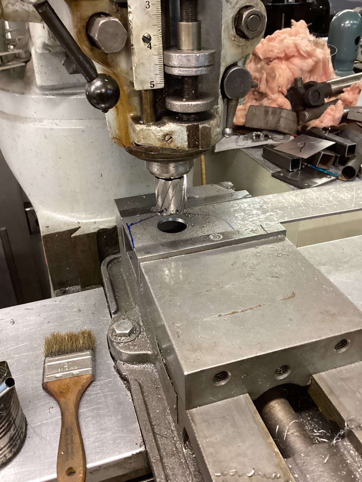

    I always forget to put down the cardboard until AFTER I drip cutting oil and chips all over the floor!
    What is that hole spacing gadget called? I'm going to need one shortly but can't remember the name.
    chryslerfan55 and Tim_with_a_T like this.

  5. Just Google Aircraft tool supply and then search rivet layout tool. There's several different styles and they are very inexpensive.
  6. Sandcrab
    Joined: Jul 25, 2022
    Posts: 164
    Sandcrab
    Adjustable rivet spacer. Try aircraftspruce.com, they are a reliable source for specialty sheet metal tools and supplies.

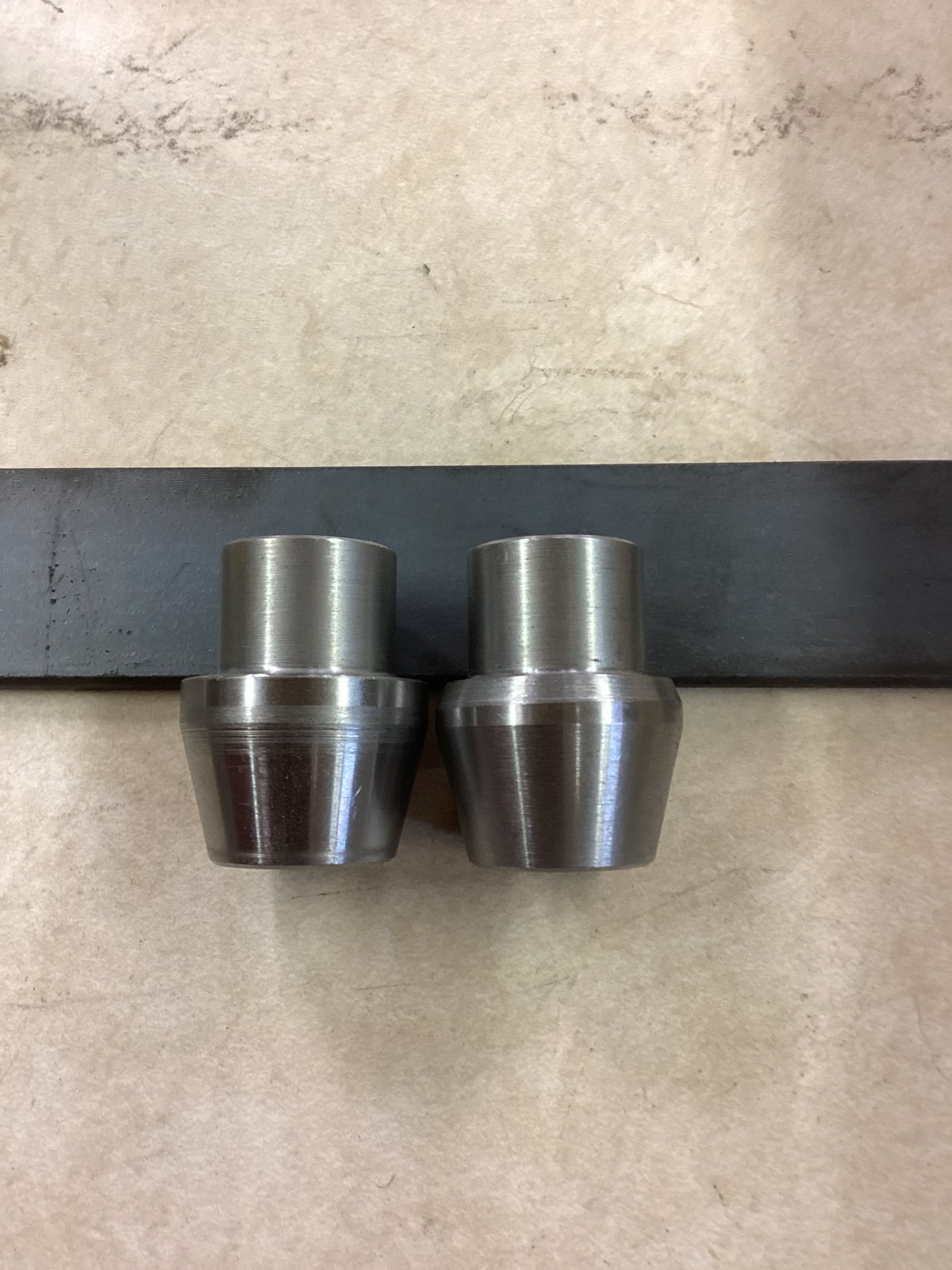

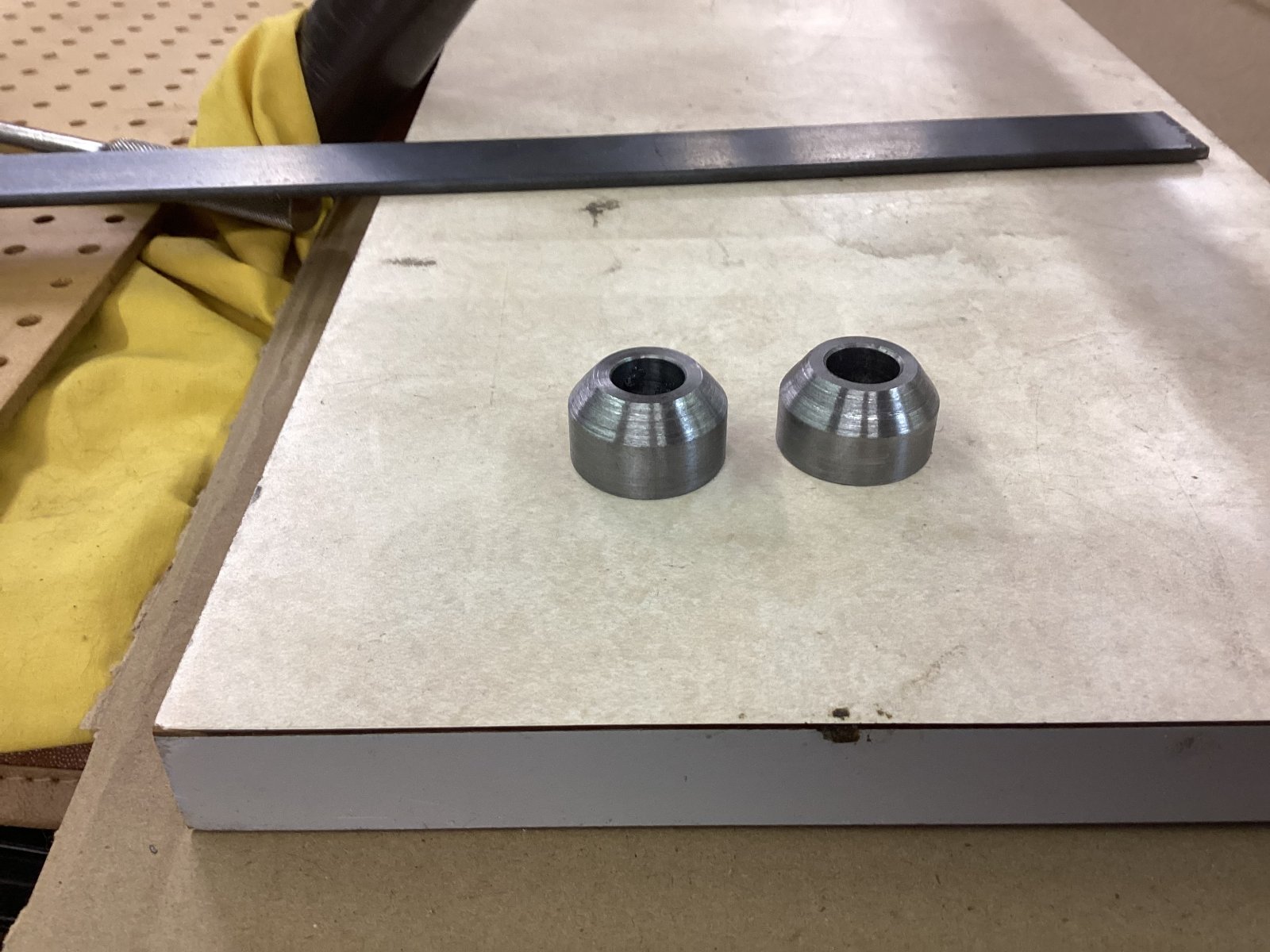

    On a project like this, there is always a wait for parts, to see if you are going the right direction before moving on to the phase. The wishbone bungs, header flanges and tire rod came today. So I turned a small weld prep on the bungs and machined some stainless pieces to fit the lower wishbones. I also took a few minutes to slick up one of the header flanges. Now I can cut and fit the upright posts, and brackets at the rear wishbone mountings. IMG_0293.jpg IMG_0294.jpg IMG_0295.jpg IMG_0296.jpg

    What is your method for 'slicking up' the header flange? Flap Wheel?

    Bruce, I have a co**** and fine belt sanders side by side. A quick trip around with both, followed with a 320 DA on the both surfaces, they come around. Flap wheels would do it, just not as fast.

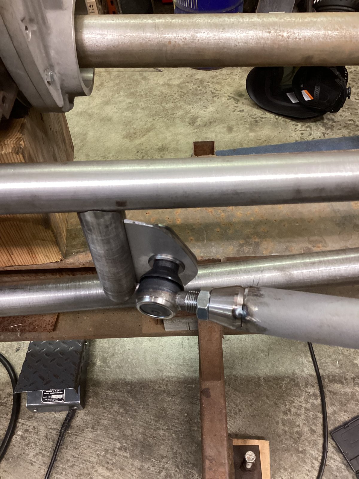

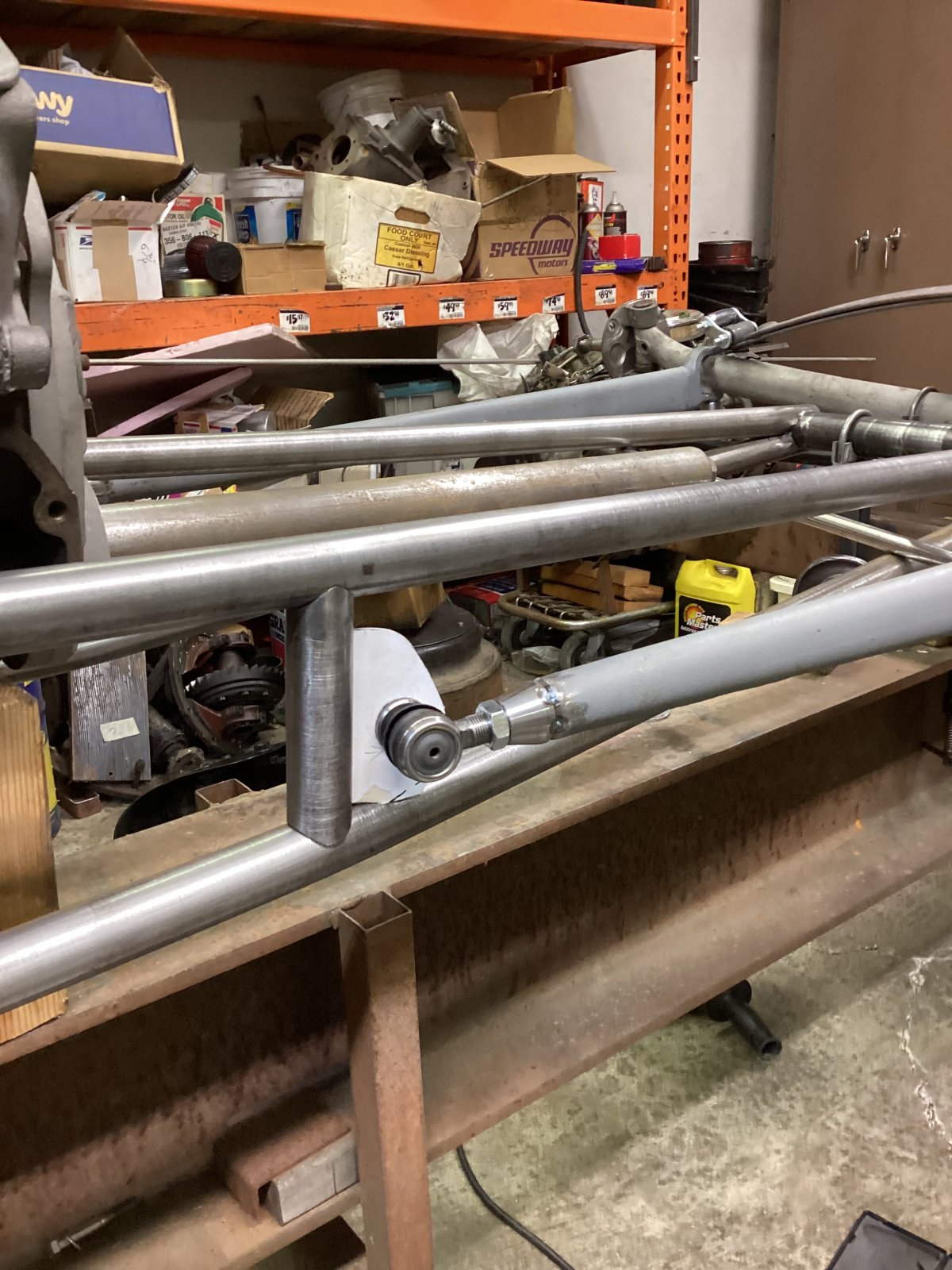

    IMG_0313.jpg I got up with the chickens, and was able to get the rear radius rod brackets tacked in place. I bought some tapered bungs from Speedway, and they worked out great. IMG_0297.jpg IMG_0298.jpg IMG_0302.jpg IMG_0304.jpg IMG_0305.jpg IMG_0306.jpg IMG_0309.jpg IMG_0310.jpg IMG_0311.jpg

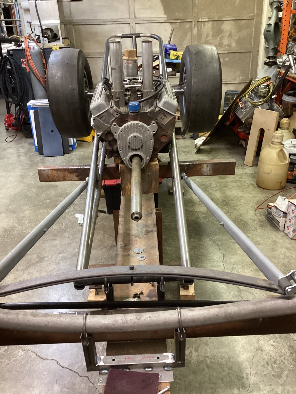

    I got the tubes in the seat area, fit and in place, this will allow me to sit lower. I had a sample front roll bar hoop that I have used for years. It's exhaust tubing, and works very well, to determine the final product. IMG_0314.jpg IMG_0316.jpg IMG_0318.jpg IMG_0319.jpg IMG_0320.jpg IMG_0321.jpg IMG_0323.jpg IMG_0324.jpg IMG_0325.jpg

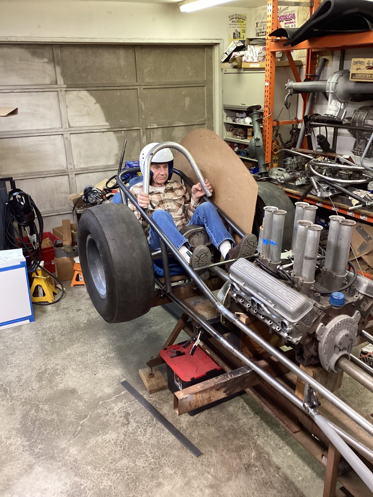

    Did a check on roll bar height. I still have a 1" thick board, and some padding under me, and without the sheet metal liner wrapped around the inside, it looks like I can fit the cage within the ****pit cover. IMG_0327.jpg IMG_0328.jpg IMG_0333.jpg IMG_0339.jpg

    One picture shows the hoop on the right side about 6 inches from the tire. Another shows it about 2 inches. What gives? I guess it's the angle of the dangle.
  22. Marty Strode
    Joined: Apr 28, 2011
    Posts: 9,686
    Marty Strode
    It's got to be the angle, as I held it steady and didn't move much.

    Marty, just curious why you tied the rear radius rod brackets to only the upright and bottom frame rail as opposed to making the brackets a little taller with a bend at the top back toward the upper frame rail and welding them on 3 sides instead of 2. Would that not make the pick up point stronger? Or was that how the original was built?
  24. Marty Strode
    Posts: 9,686
    Marty Strode
    Without any braking forces, and no chuckholes in the pavement, strength is not an issue. Notice how lightweight, things got by the late 60's, on an old Fuller Car, I used to race. The original TB, was totally different, in that the ch***is was rectangle tube, with the radius rod bracket, hanging below the rail. 2012-09-14 164046.jpg
