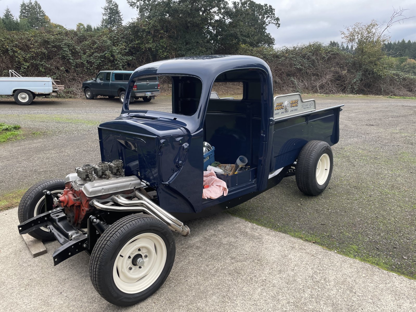

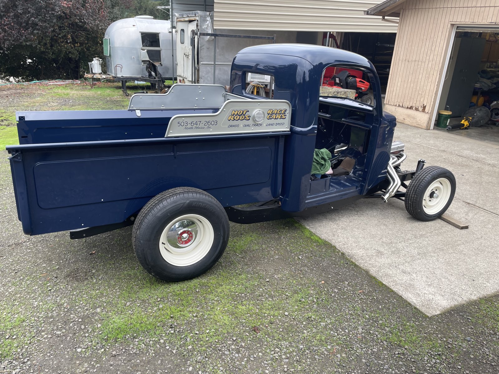

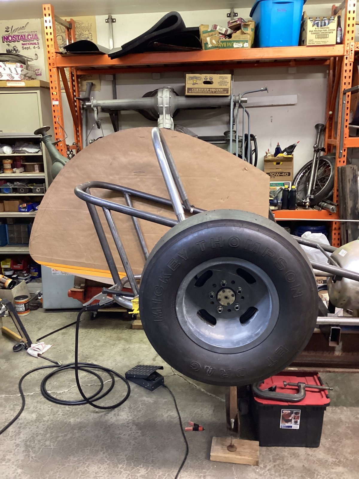

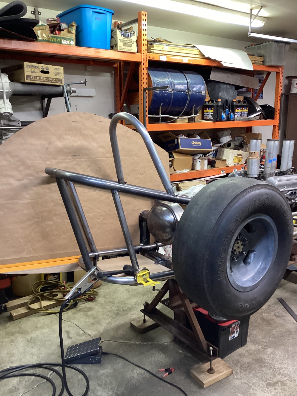

    Another buddy that has done body work for me for 30 years is moving back closer to me. He will do the final ***embly of my 40 pickup. I can’t wait to see it push starting the Dragster. Just another reason to have a clutch and transmission, instead of a Powerglide. IMG_3872.jpeg IMG_3869.jpeg

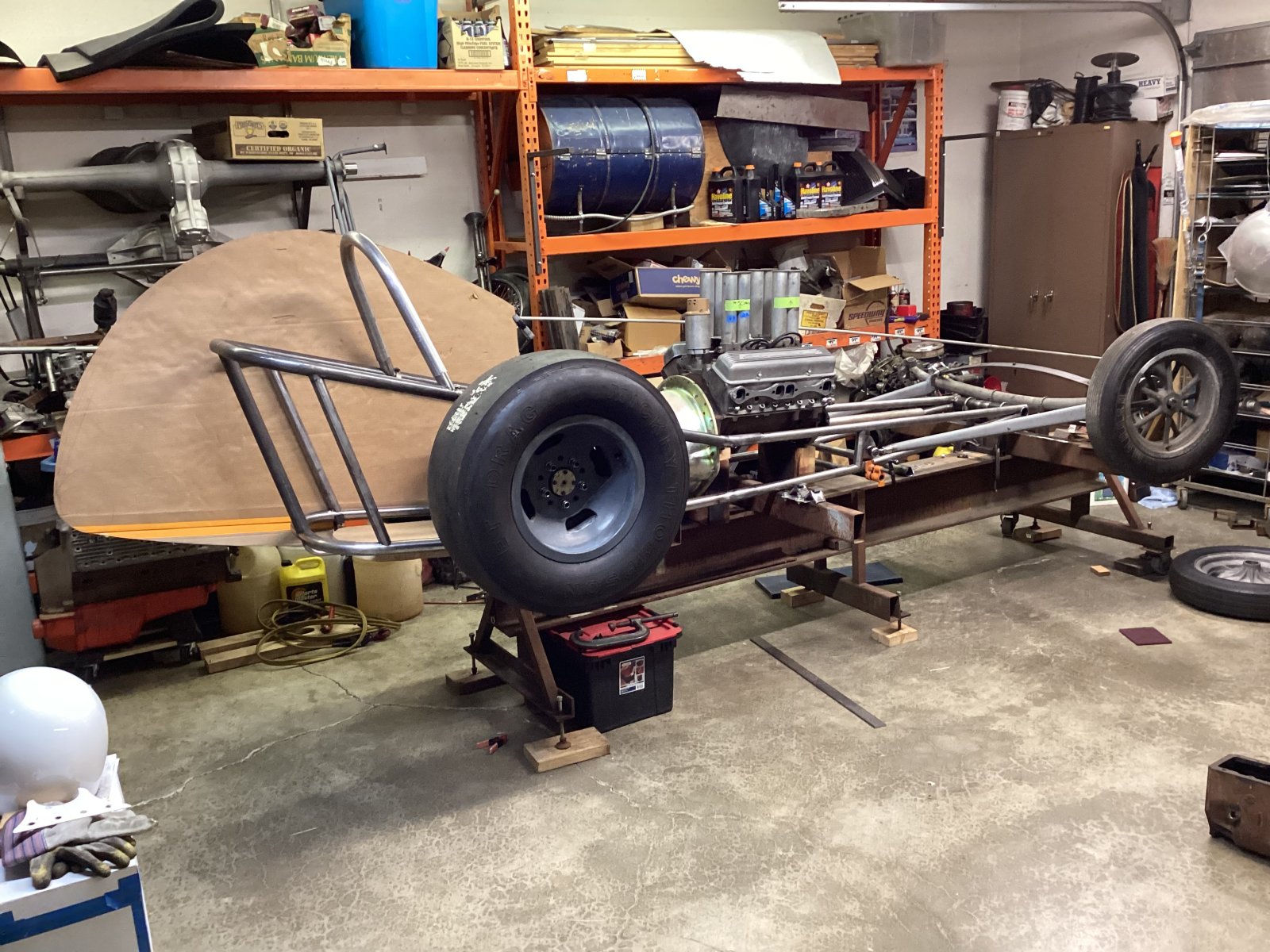

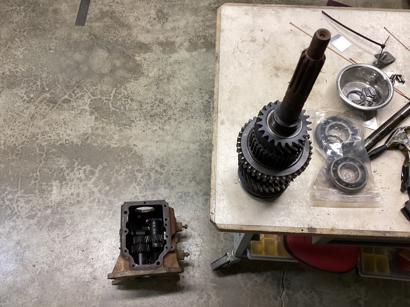

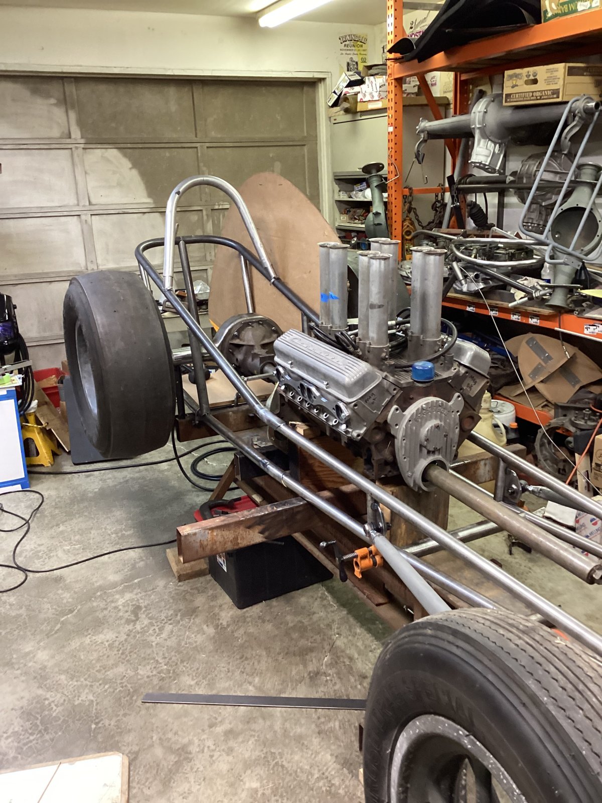

    y'sguy

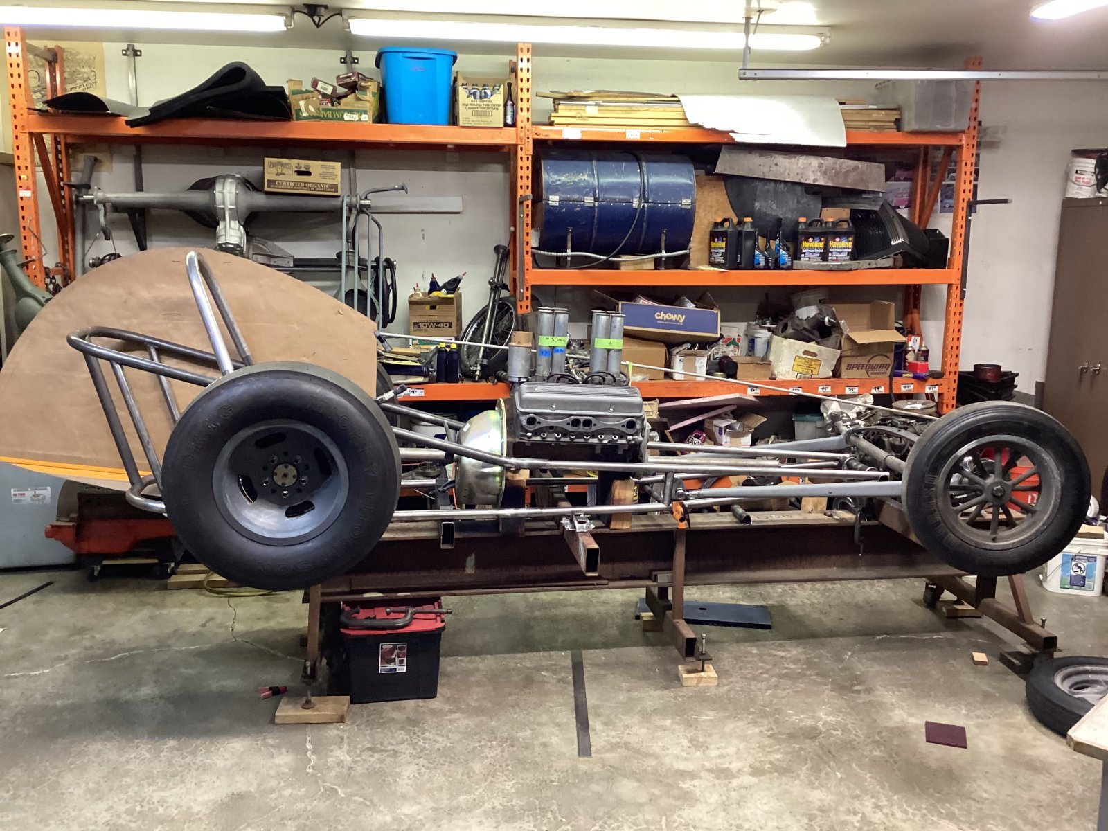

    Today, Tim @Blown Red Ram brought me the parts to set up the 3rd member, a new set of 4.30 gears, a lightweight 30 spline spool, and a bearing set. He also brought an NOS set of American 12 spokes. It turns out the wheels were for Anglia/P&S spindles. My first thought was to profile and shorten a set of 37-41 Ford spindles, so they would work. I remembered a set of Fords I took of a front axle, that had 6 hole Chevy hubs and drum brakes. I don't how many times I nearly threw them in the s**** pile. It turns out the machine work that was done, has me half way there. The rear bearing from the 12 spokes fits perfect on the modified spindles. It will require, running the threads back about 3/8 of an inch, sweating on a sleeve, and turning it down to fit the new outer bearing on the snout. I will also polish the the outside lip, front and back on the 21 spokes. Also, the NHRA Tech Inspector dropped by yesterday, and said everything so far will meet the SFI Specs. So now I can go forward with confidence. I will be running the smaller M&H's from before. IMG_0344.jpg IMG_0345.jpg

  10. wrenchbender
    Joined: Sep 5, 2007
    Posts: 2,490
    wrenchbender
    Marty the spindles I have on the 40 ford front axle in my dragster have been turned down and modified for the 19” motorcycle wheels I use on it so don’t worry about doin that my car has pulled many wheelstands even a great big one at the meltdown years ago that rocky phillips photographer posted up on the internet years ago they have never bent or fractured or anything I inspect them along with the rest of the car quite frequently so my thoughts on machining the spindles is go for it

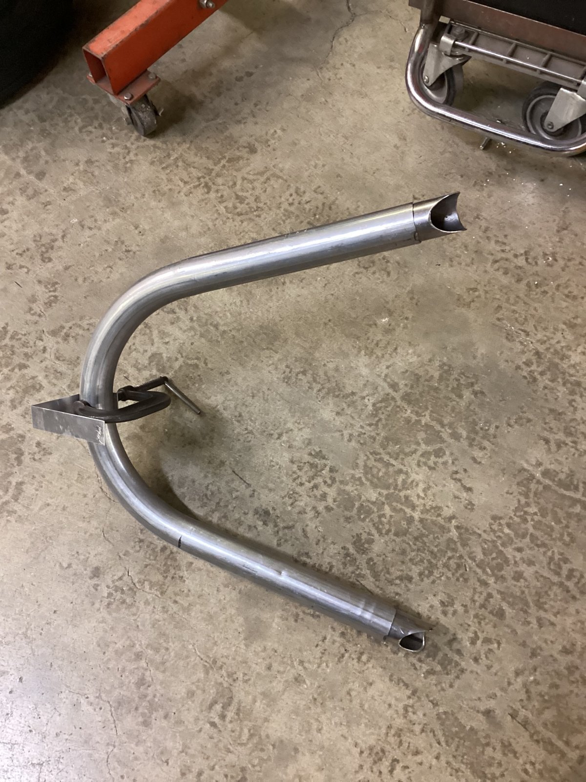

    Of the simple methods that I, along with my Brother Tom have devised to make things easier, especially when working alone, this is the one I treasure the most. When I was doing the cage on Jim Lindsay's Bonneville Roadster, the most difficult part is always coping and getting a good fit on the front hoop, with the angles and heights to maintain. Since his cage was 1-3/4", one size over the specified 1/5/8", I decided to bend a hoop out of exhaust tube, and make it fit, for a pattern, being thin it is easy to work with. When re-using the hoop for another application, that was shorter, we simply cut the ends off at 5", then removed a short section on each end, and held the 5" pieces on with hose camps, so we could rotate the ends to get a perfect fit at the merge. Well this time I made end pieces out of 1-5/8- .065 that slide inside the main hoop. It allows me to not only, rotate to fit, I can telescope the hoop up and down to vary the height. When the hoop is at the desired height and angle, I lightly tack the ends in place, and remove it to slide into the joint jigger against the side of the hole saw. I then check and record the angle with a digital level, to make fitting the real hoop a breeze. I tacked the temp on, and found I can move it back an inch, and still maintain the 4" from the front of the cage to the front of the helmet. IMG_0347.jpg IMG_0348.jpg IMG_0349.jpg IMG_0350.jpg IMG_0352.jpg

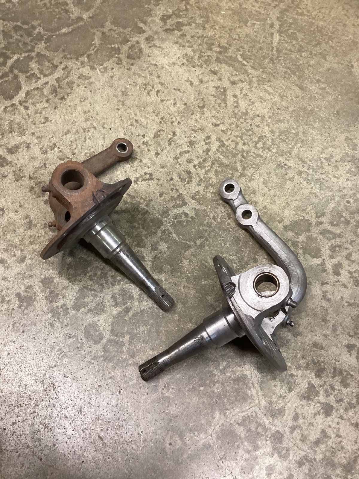

    I got the spindles cleaned up, and the the notches someone had cut to clear brake hoses, welded up an slicked down. In able to machine the areas needed, I made a barrel to screw onto the spindle nut thread. It will give me the hole necessary to index the live center, to complete the process. In order to hold the spindle on the other end, I needed long jaws for the lathe. My old buddy Lonnie Gilbertson stopped by to have me bend some tubing for him, and offered to loan me the proper jaws, to machine the spindles, and some for holding the outside if the wheels. That way I can lightly sand and polish the wheel outer lips, in the lathe. If I can find the proper outer wheel bearings, I will only need to machine the flat area of the spindles, instead of machining them down, sweating on sleeves and turning them back to .750". The outer bearings in the wheels are Timken LM 12749, and have a bore of .863". I need the same bearing with a .750" bore. IMG_0357.jpg IMG_0356.jpg IMG_0354.jpg IMG_0355.jpg

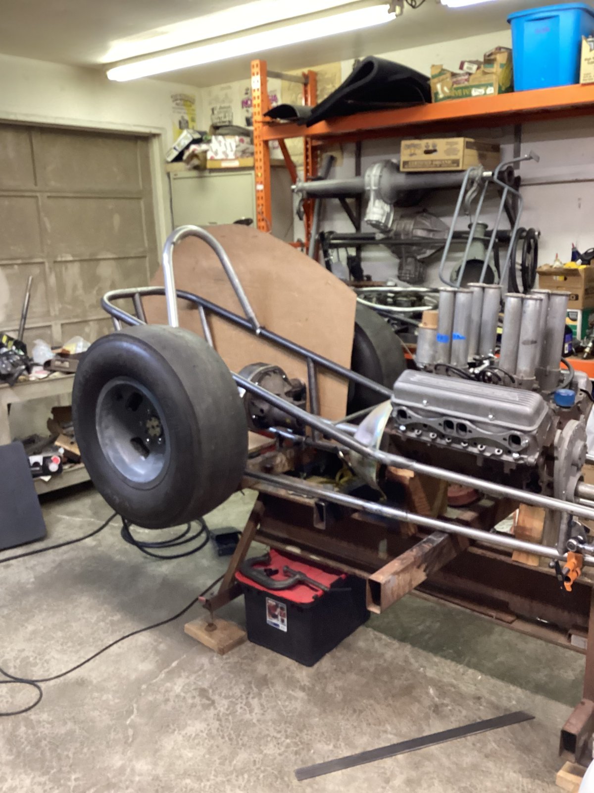

  29. Marty Strode
    Joined: Apr 28, 2011
    Posts: 9,710
    Marty Strode
    We got the transmission apart and the tail shaft is out getting shortened and re-splined, if my friend can do it, depending on the hardness. Meanwhile, I am looking to make some 6" Injector stacks, or shorten the 10" ones I have. Then thinnest 2-1/8" plain steel tube I can find is .049, the Hilborn ones are .035. I found some .035 steel, but it is galvanized. The thinner the metal, the easier the flares will be to make. The side shot shows the top of the green tape is 6", about even with the top of the mag. Also, the long aluminum tube shows close to what the profile of the body will be. IMG_0362.jpg IMG_0363.jpg IMG_0364.jpg
