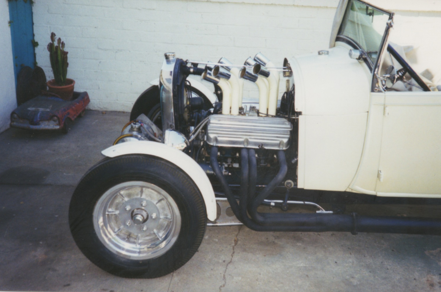

    What about aluminium (Australian spelling) for the injector stacks? Should able to get it in the required thickness (or thinness (if there's such a word).

    The steel Hilborn stacks that I've owned were zinc plated, so using the galvanized 0.035" wall stuff would be pretty similar to the originals I had.

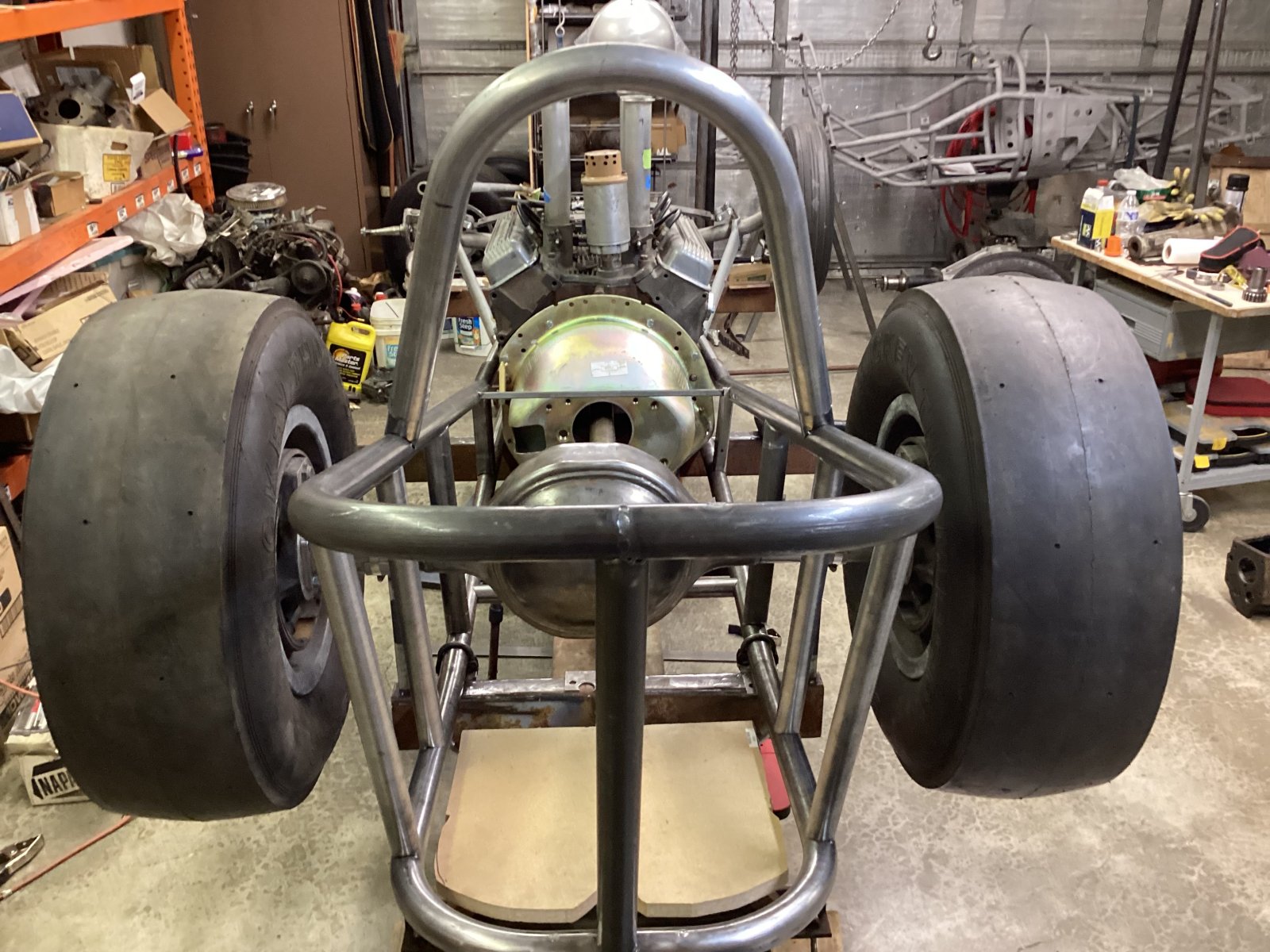

  7. Looking awesome Marty! I saw an Algon fuel injection set up for sale recently, I can't remember where though. I have a question, what size rear rim and what size M/T slick do you have there? I like how they are tall and skinny...
    porkshop and chryslerfan55 like this.
  8. Marty Strode
    Joined: Apr 28, 2011
    Posts: 9,689
    Marty Strode
    Sam, the wheels are 15X8-1/2, the tires are 9.0 X 29.5. The tires still have the stickers, but are very old. When I was young and more stupid, I ran 16 year old tires on this one. 2012-09-14 163626.jpg 2012-09-14 163525.jpg

    Graham, galvanizing can look different, depending on the application, and the need to tack weld the small bosses on the bottom, might be difficult. I talked to Nick Smithberg this morning, and have been thinking about shortening mine, by cutting 6" off the top, and welding new bosses on. That way I will have a set of 4" ones as well. I have a .040 tungsten that should work. IMG_0365.jpg

    They only have one hold-down screw -- I guess that what's the Enderles had (it was 25 years or so ago). I figured you'd cut off the bells where they join your tops' diameters. Maybe easier than stretching the tubes out.

    Marty the stacks I had on my afx car are made of aluminum and came with the injector from hilborn however the injector was designed to slip the stacks in the injector and has a Allen bolt that clamps around the stack I would think that if they bolted down like yours does that eventually it would crack and break the mints off

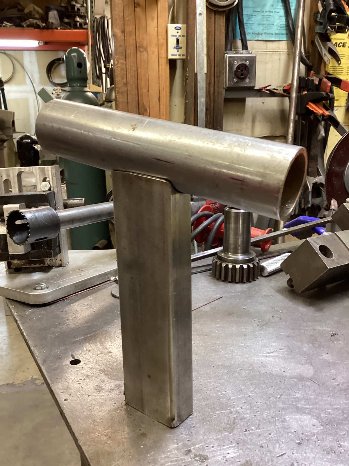

    I was able to figure out how to machine the spindles, by making a bracket that bolts to the tie rod eye, and to one of the bolts that hold the jaw to the chuck, so since it is between centers, it needed a way to drive the piece. That will happen later. Another decision I made was to use rectangular tube uprights at the motor plate, as it gives me a little la***ude on the location of the engine fore and aft, along with a better seal, ****pit to engine. I bought a Rotobroch to fit the uprights, and it got me close, with some grinding. IMG_0372.jpg IMG_0373.jpg IMG_0374.jpg IMG_0376.jpg IMG_0377.jpg IMG_0378.jpg IMG_0379.jpg IMG_0382.jpg IMG_0383.jpg

    As much as I can 'hear' the hemi pics, I 'felt' that broach from the back of my teeth to my toes!

    Those are nice cutters, you won't find them at HF!

    That one came from Amazon, works slick !

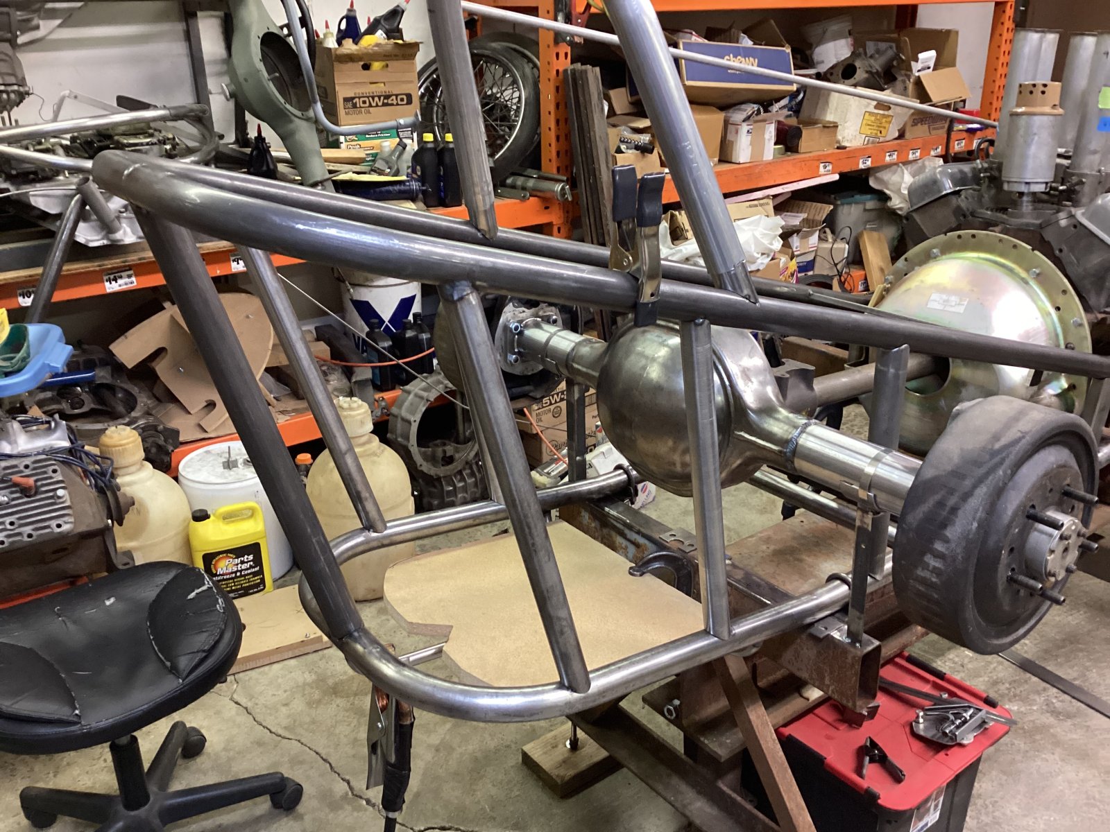

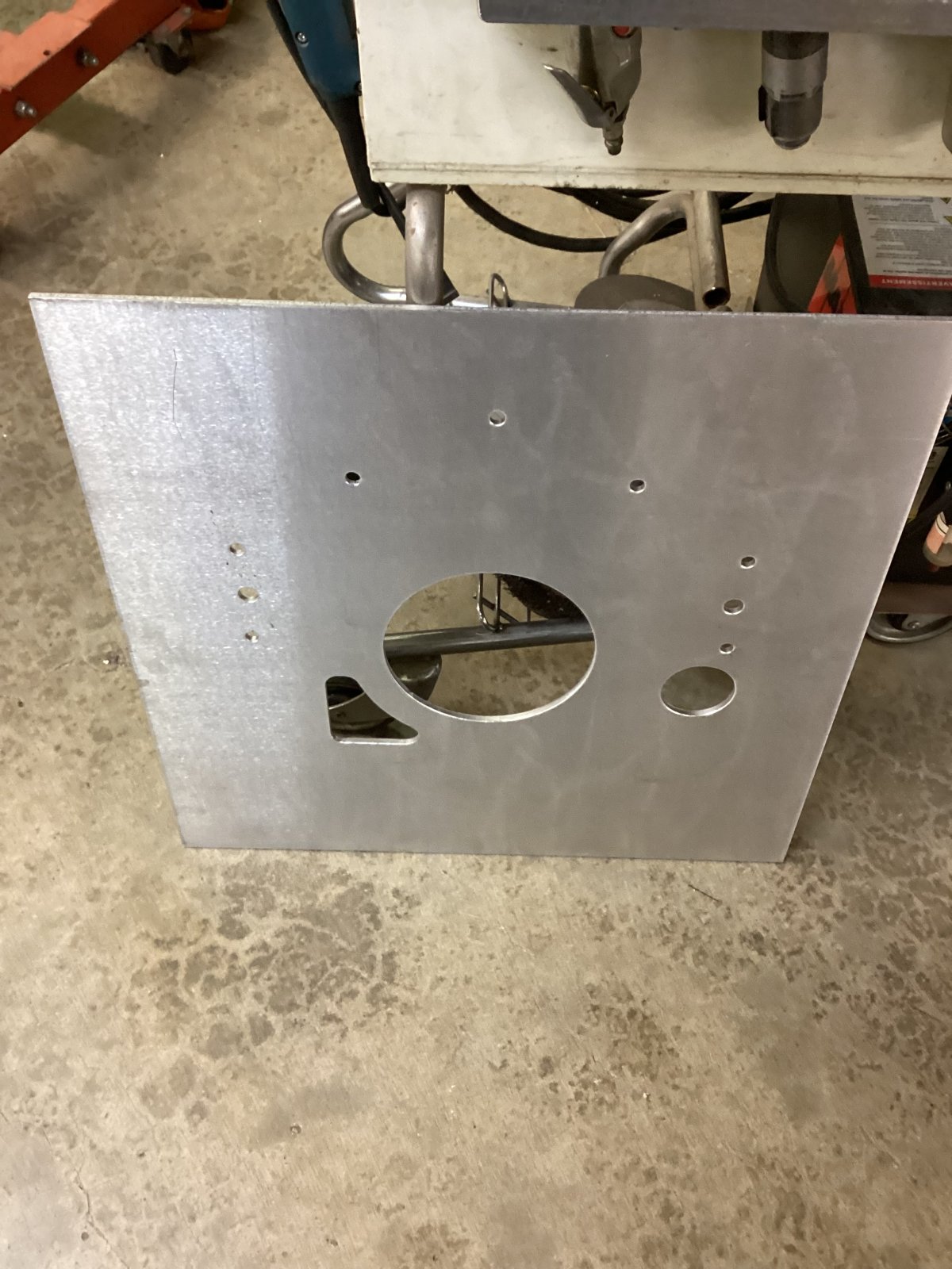

    I added a couple more uprights in the ****pit area, and one crossmember ahead of the rear axle. It will serve as the mounting point for the anti-rotation device required on the nose of the rearend. It will also support some aluminum plates for the driver to step on, getting in and out. IMG_0384.jpg IMG_0385.jpg IMG_0387.jpg IMG_0388.jpg

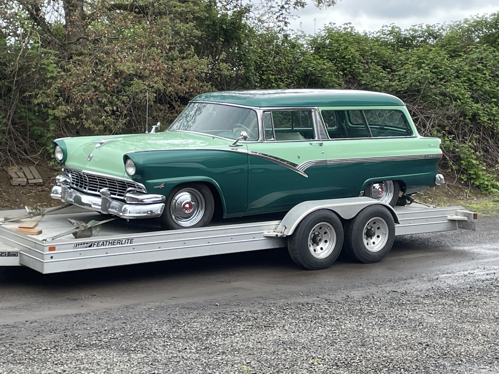

    I am storing this’56 for a friend, would make great push car, but it’s going on the block later this year. IMG_4602.jpeg

    Love 55, 56 fords not so much 57, all rusted away on east coast while everyone saved shoebox Chevy ( love them also). Dad had 56 ranch wagon 3 on tree older brother & I beat on, ate exhaust pipes extra flow from 4 barrel & our driving. Would be great push car.

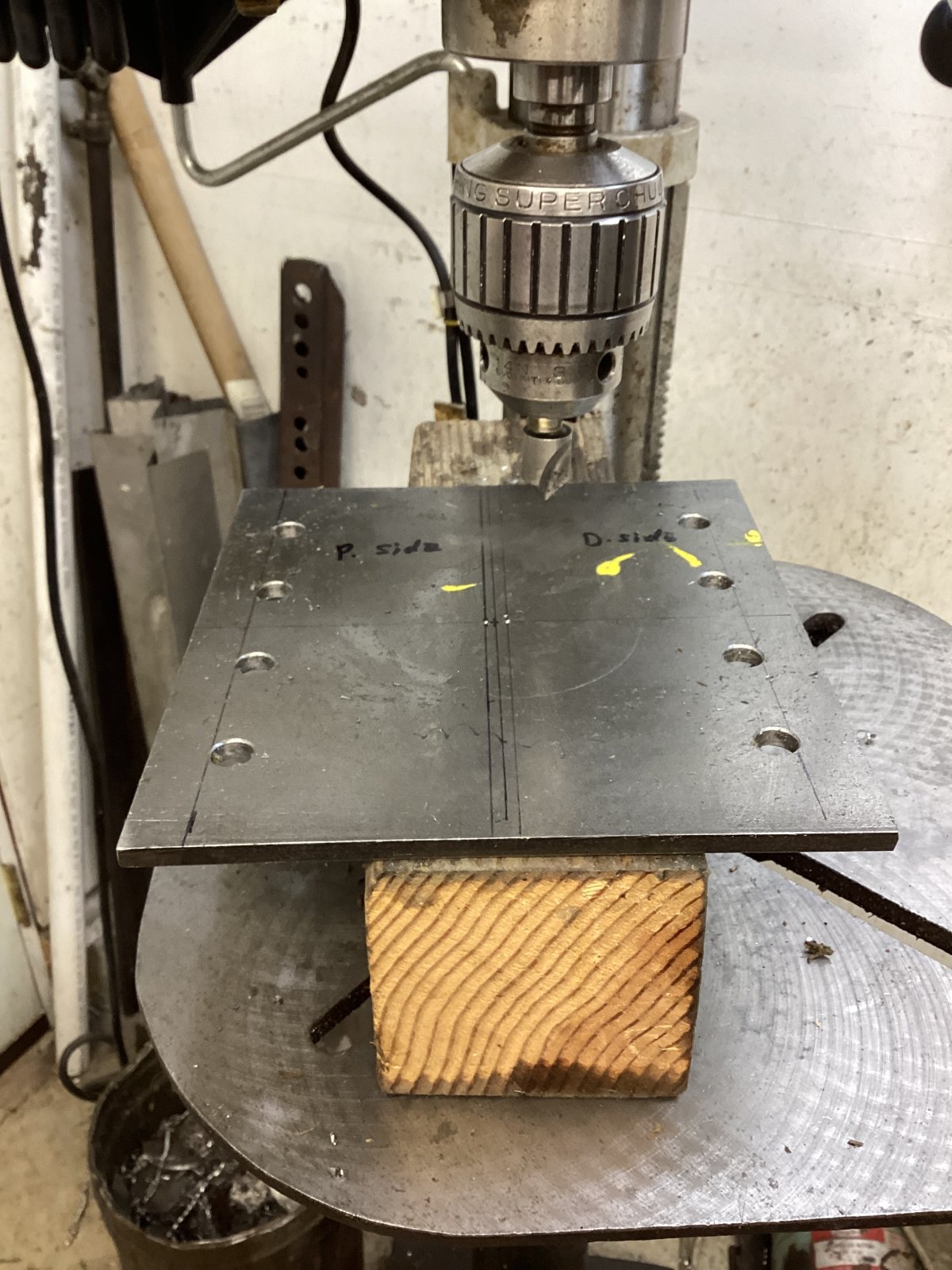

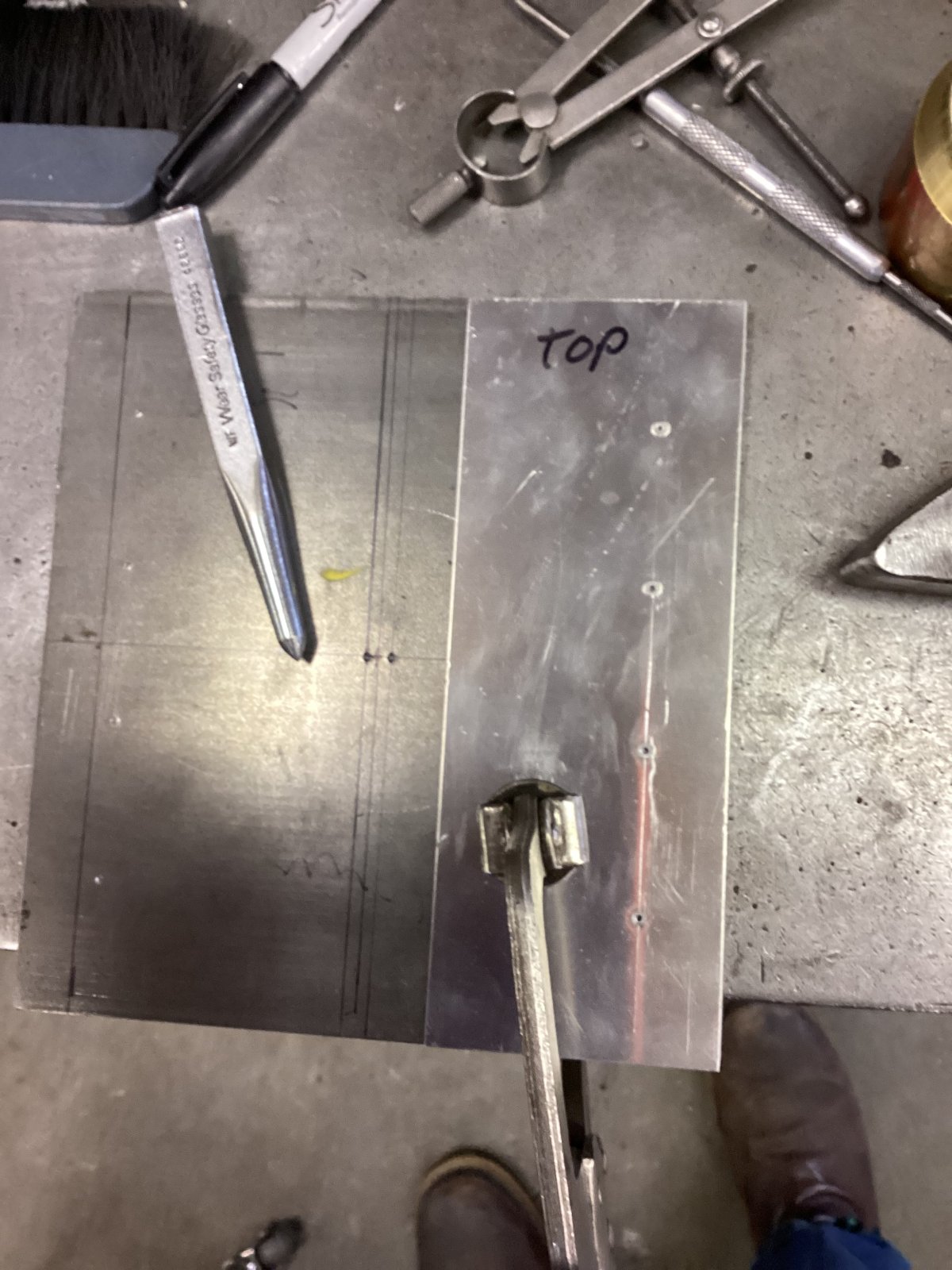

    I laid out and drilled the rear end housing brackets last night, and torched the centers out today. I am a little rusty with my home made circle cutter. The brackets needed two different radius, because of placement on the housing. A little bandsaw, belt sander, and a DA to finish them off. Next will be cutting and fitting the corresponding plates that weld to the uprights. IMG_0389.jpg IMG_0390.jpg IMG_0392.jpg IMG_0393.jpg IMG_0397.jpg IMG_0398.jpg IMG_0401.jpg IMG_0403.jpg
