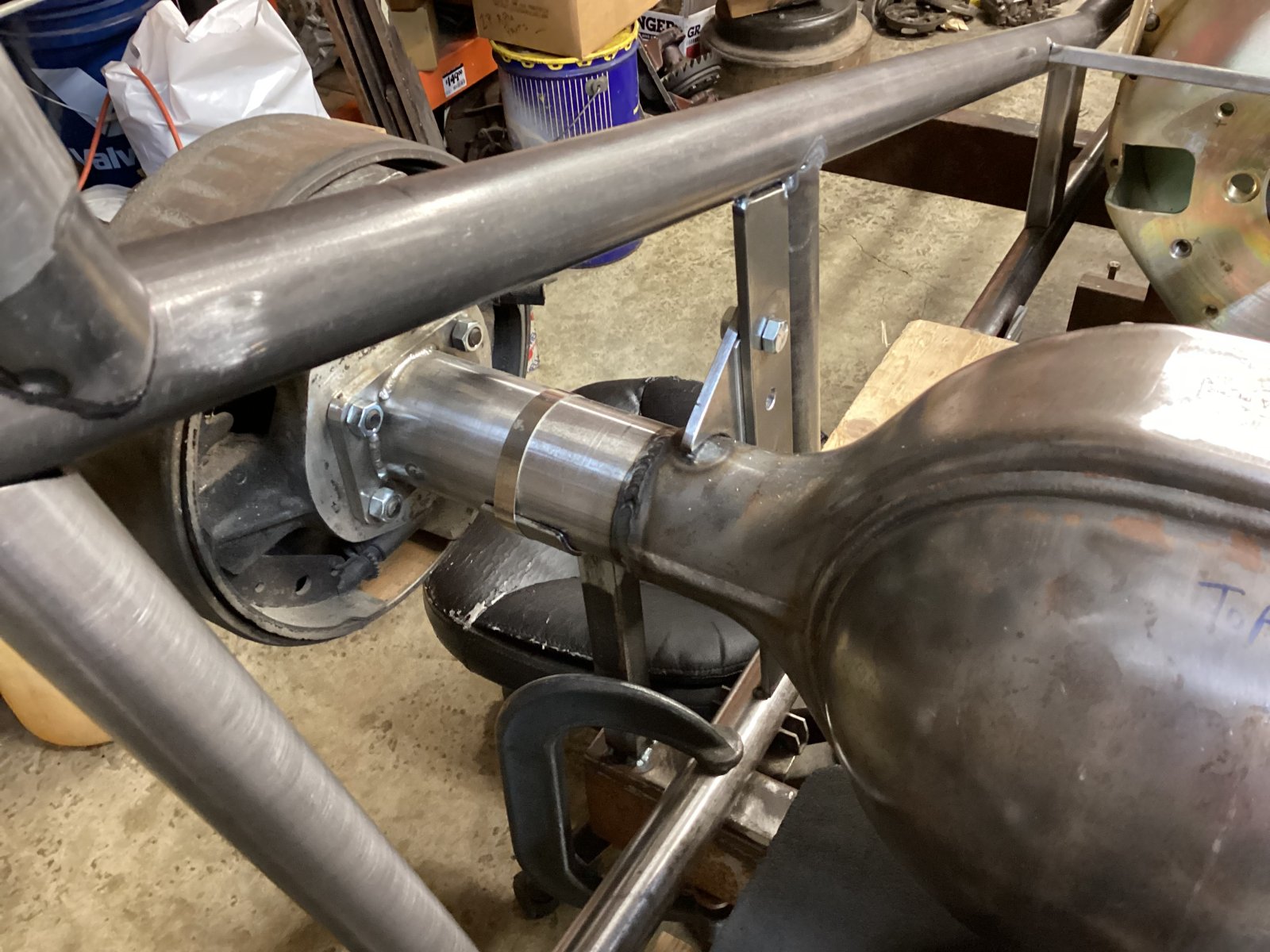

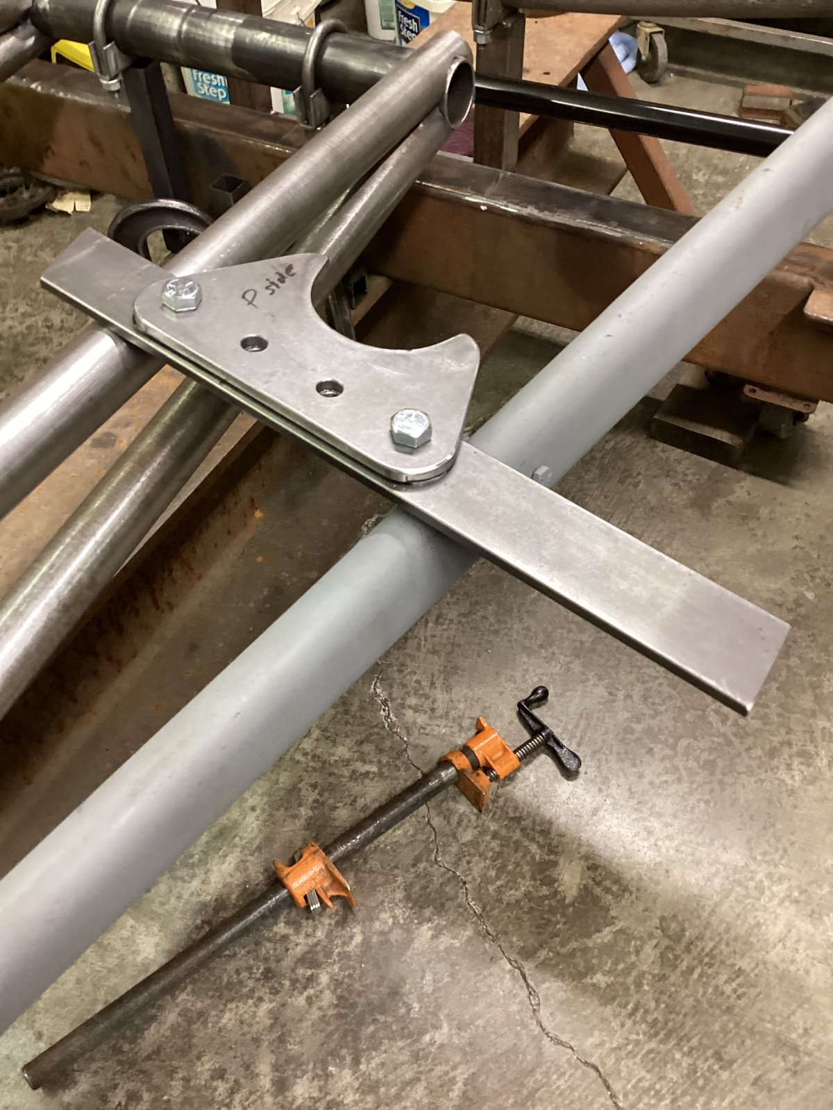

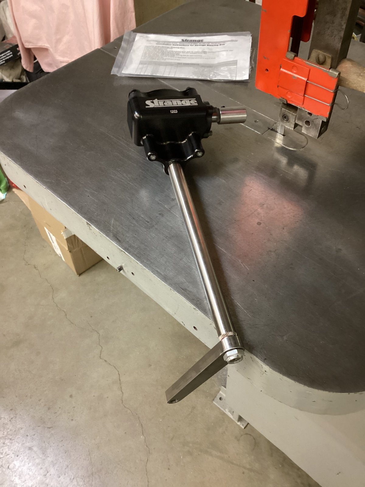

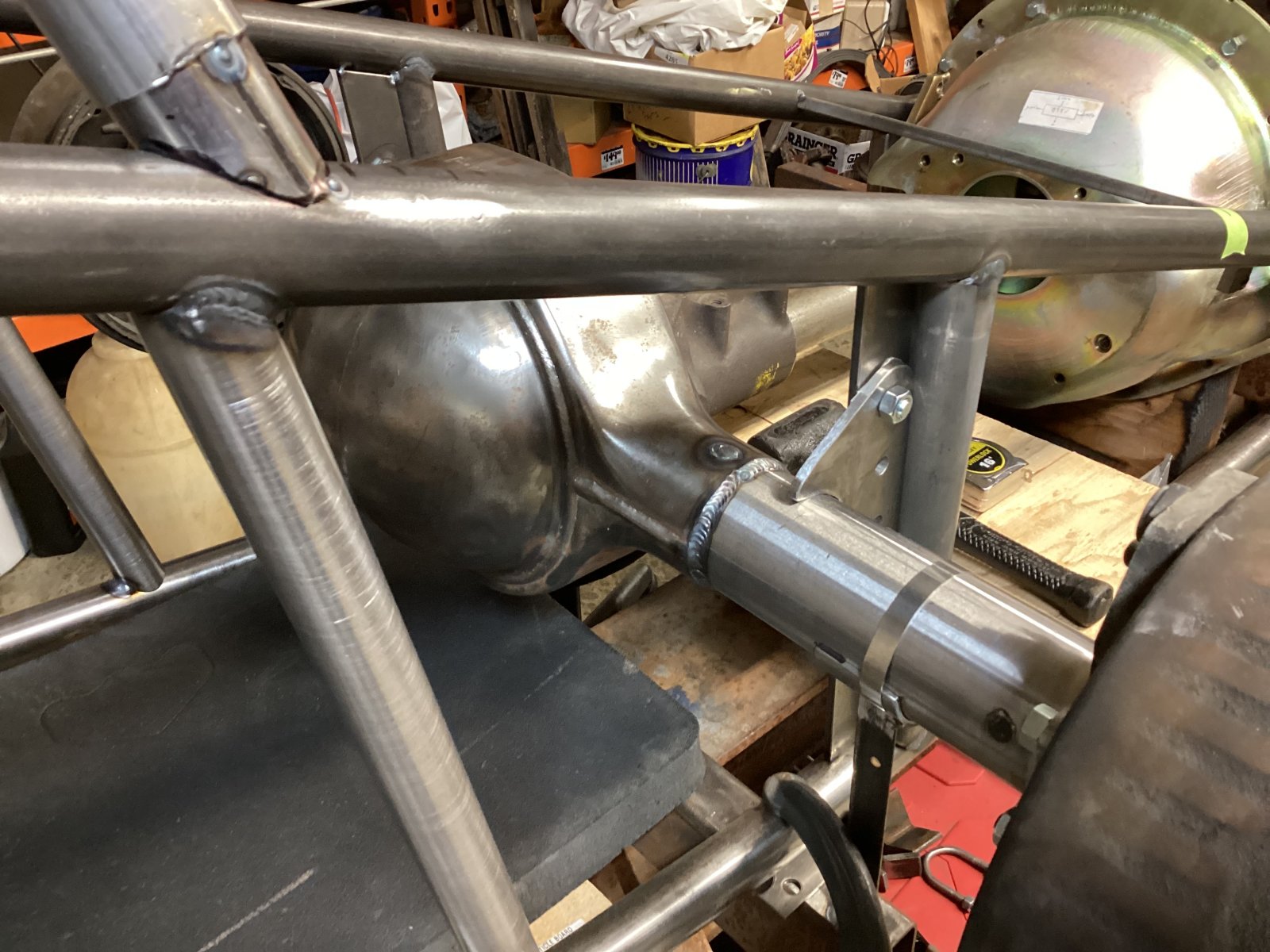

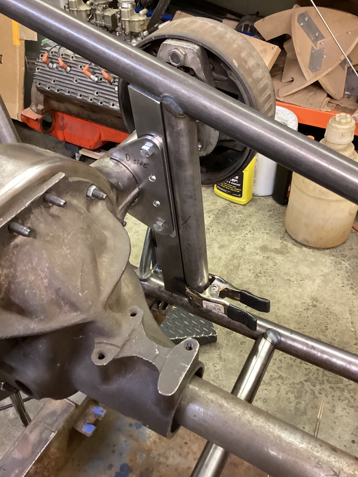

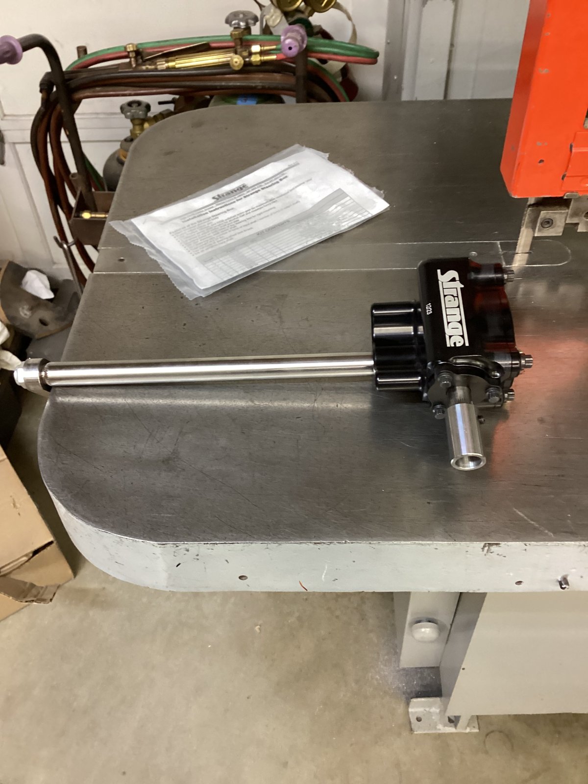

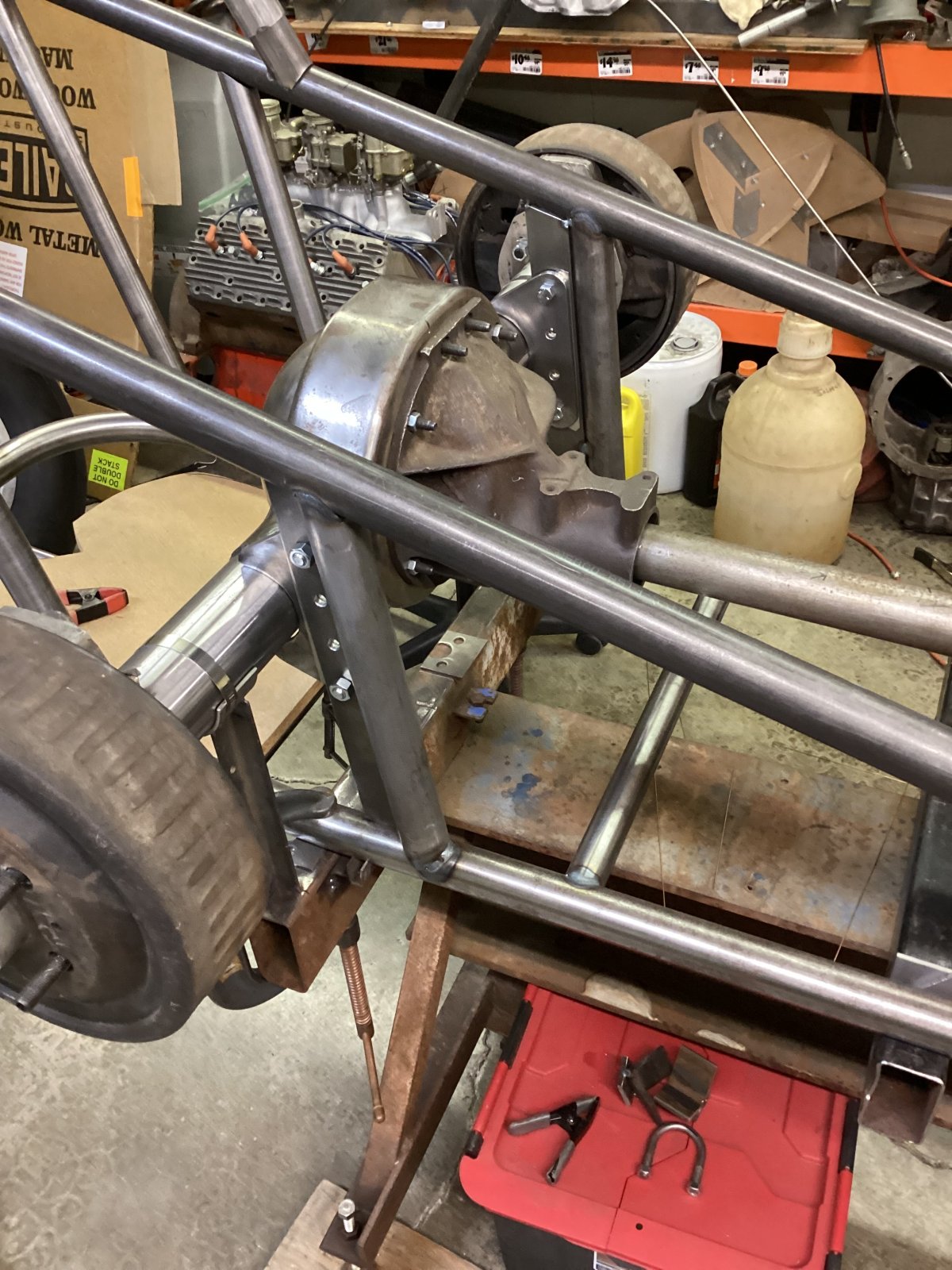

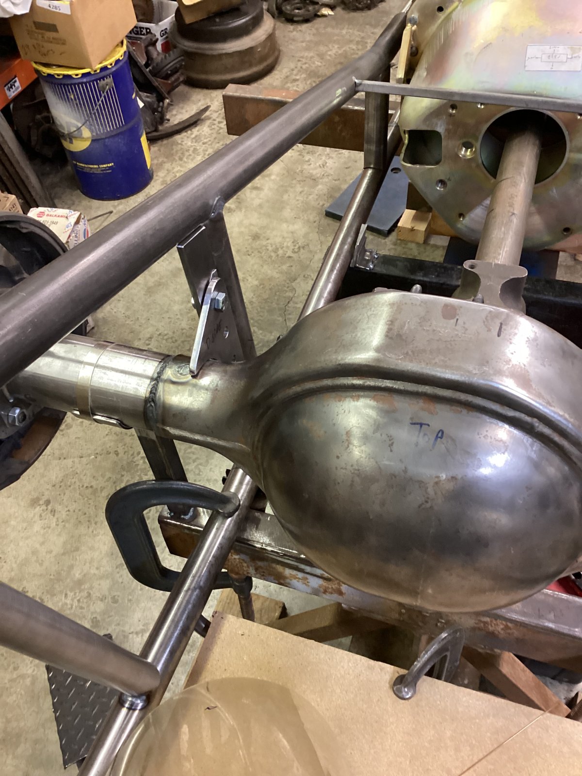

    I got the rear end mounting brackets and frame plates fit and tack welded. I make it a point to sandwich a thin .050 spacer between the brackets, to allow for paint, and ease of ***embly. The new steering box from Strange showed up, and tomorrow, Chris and I will define it's location and mounting. I have 8 days to have it on the ground and rolling, so I can take it to the Portland Transmission Spring Cl***ic, the best local show anywhere ! IMG_0408.jpg IMG_0409.jpg IMG_0410.jpg IMG_0411.jpg IMG_0412.jpg IMG_0413.jpg IMG_0414.jpg IMG_0415.jpg IMG_0416.jpg

    patsurf
    nice tip on that spacer!--beautiful

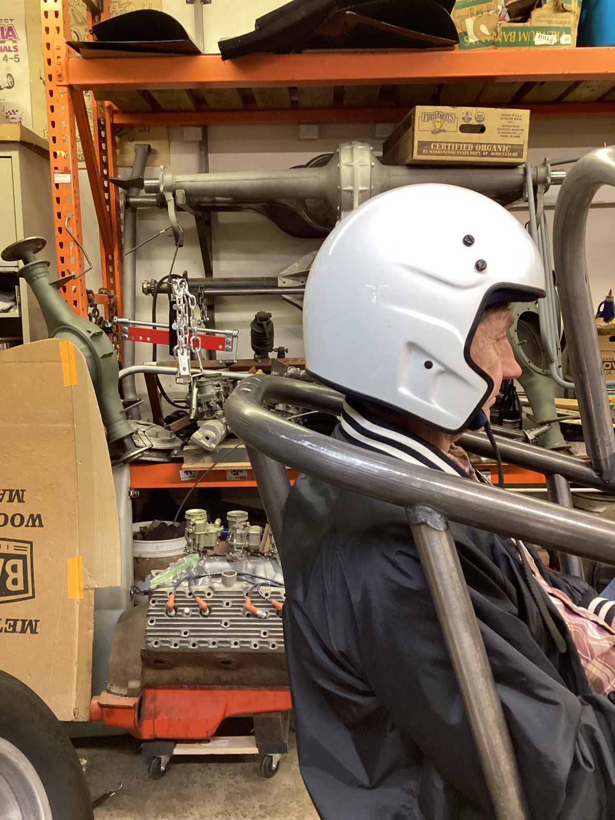

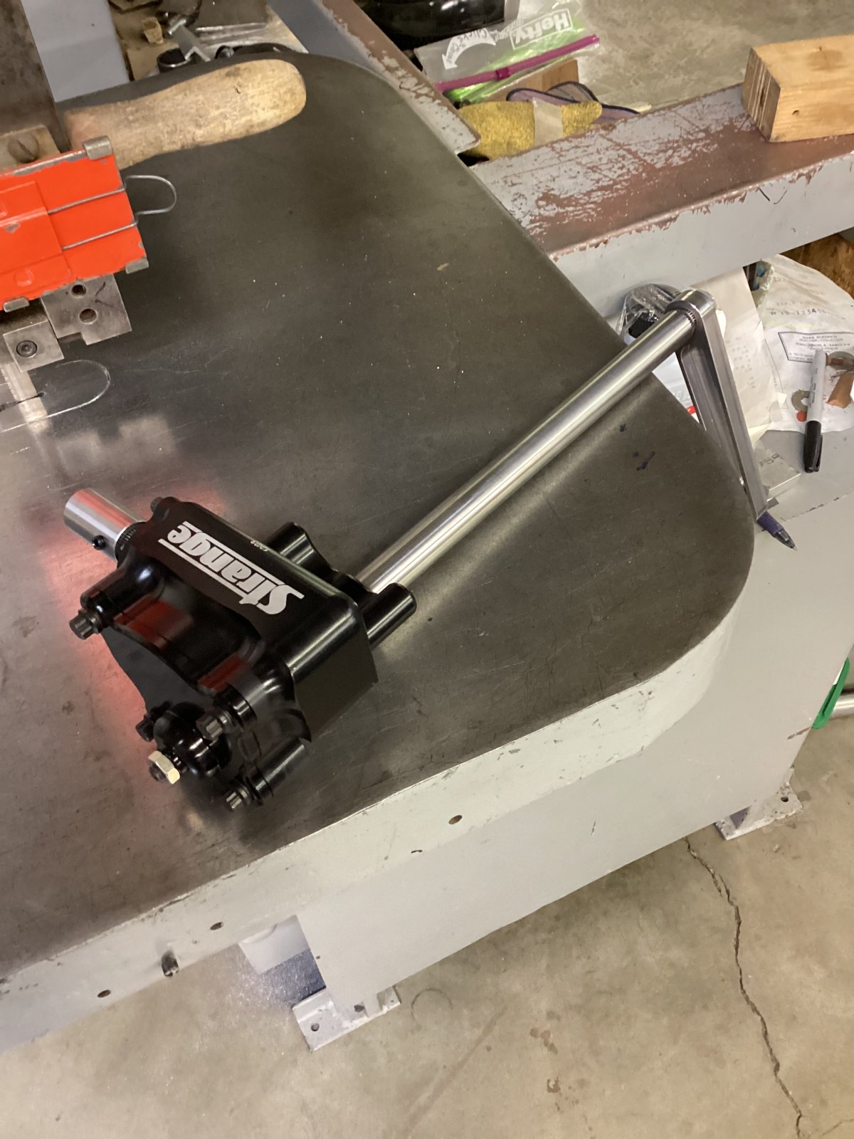

    I moved the axle plates to the outside, and I think it looks better. We settled on the location and mounting of the steering box. We also moved the roll cage test hoop back an inch and a half, that should making entry and exit a little easier. The area along side the left side of the transmission is tight for my foot, so we decided on removing the Low-Reverse shift fork, and remove the boss from the side. I don't need those gears anyhow. Busy this weekend on the front spring perch, and other items. IMG_0419.jpg IMG_0424.jpg IMG_0425.jpg IMG_0426.jpg

    Are you doing any sort of funny car cage work above your head. That’s a lot of noggin exposed dude. I’ve clanged mine a few times and went through concussion recovery. I think I recovered just fine, my ex wife has a different opinion.

    It will have a 5 point, SFI spec roll cage, on the order of this. IMG_0430.jpg

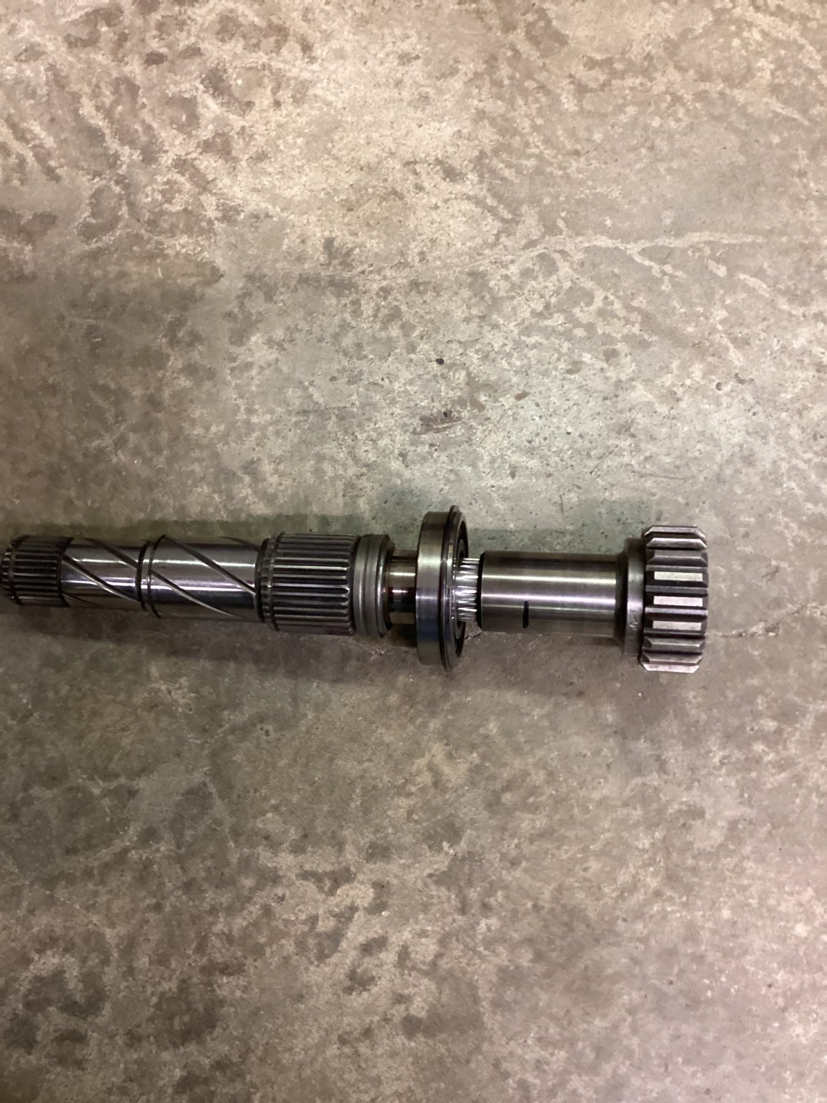

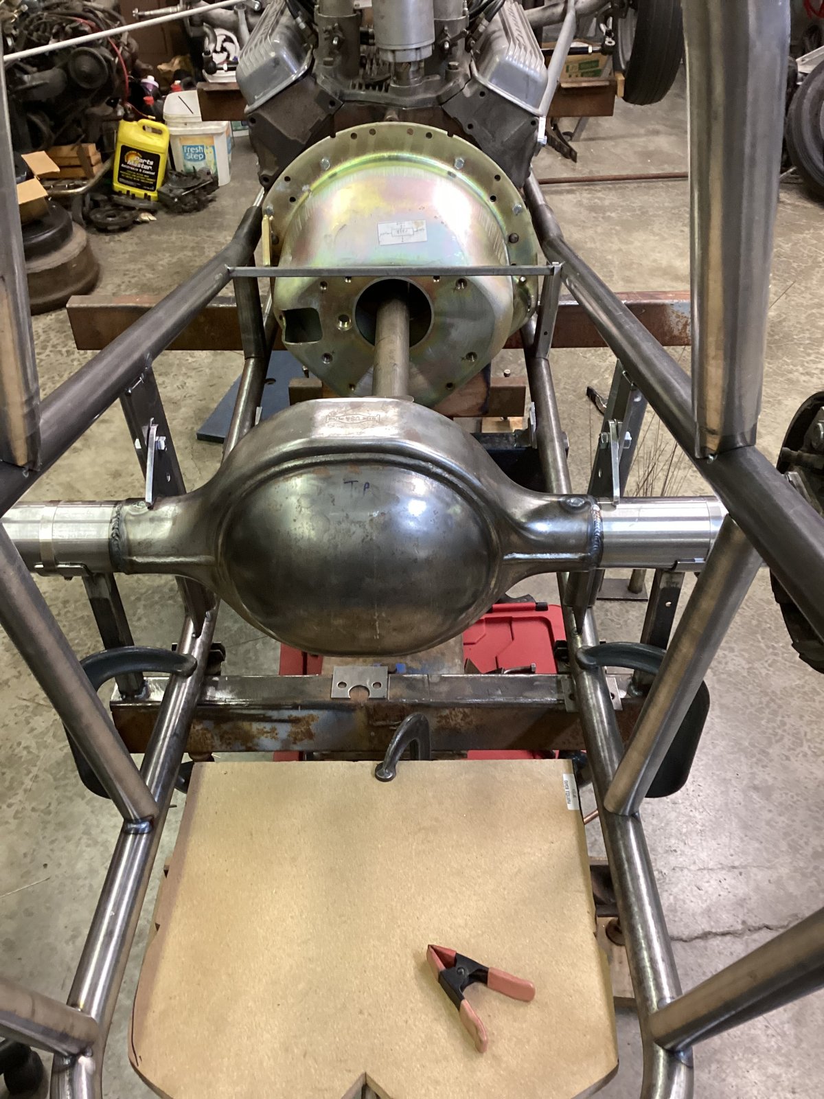

    IMG_0431.jpg IMG_0432.jpg I have been sweating bullets, wondering if my friend would be able to shorten and re-spline the transmission tail shaft, due to the hardness. He did a masterful job, so now I can finalize the engine location in respect to the rear end coupler.

    Did he, or does he need to re-harden? Should you have a spare just in case? Getting closer & look forward to some test p***es. Will you be ready by summer end?
    porkshop likes this.
  15. Marty Strode
    Joined: Apr 28, 2011
    Posts: 9,682
    Marty Strode
    Thats the goal.

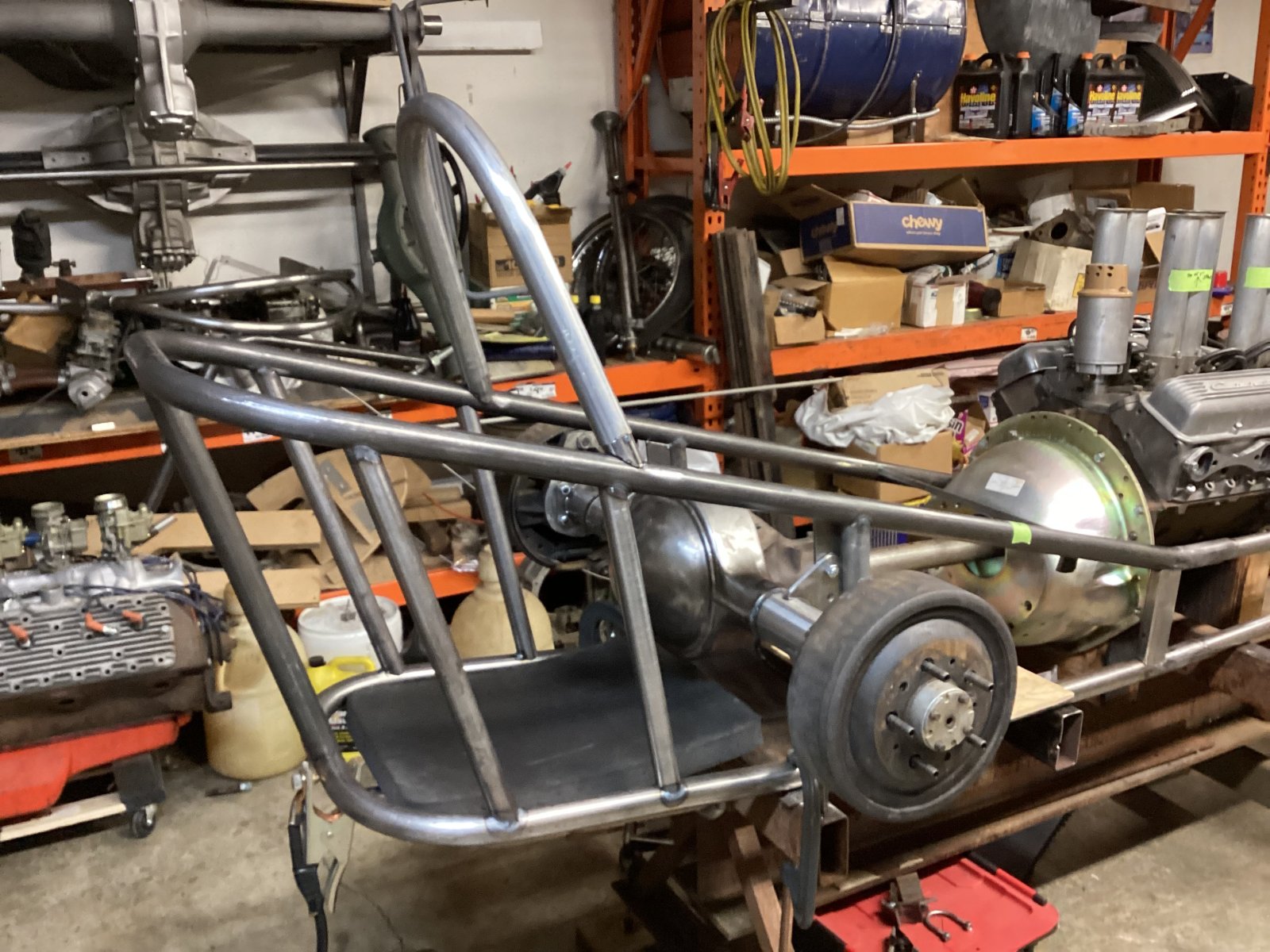

    My friend Dean came today and after we measured the tail shaft and did a mock up, we decided to move the engine another inch forward. On final ***embly I can shorten the coupler a little for a perfect fit. After that, I made some front engine mounts out of 1/4" aluminum. I can now tack weld the brackets to the rear axle housing, and finish the front spring perch I started on yesterday. IMG_0433.jpg IMG_0434.jpg IMG_0435.jpg

    Shades of the SPE box, little jewels for sure.

    I never had one of Roy's boxes, but had and steered a few with a P&S boxes. In all reality I should have modified a Crosley gear that would be more appropriate, and I have a couple of those. The good part is, it's a bolt on item, and I could change it anytime.

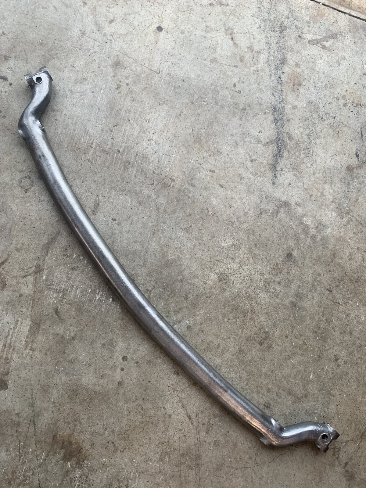

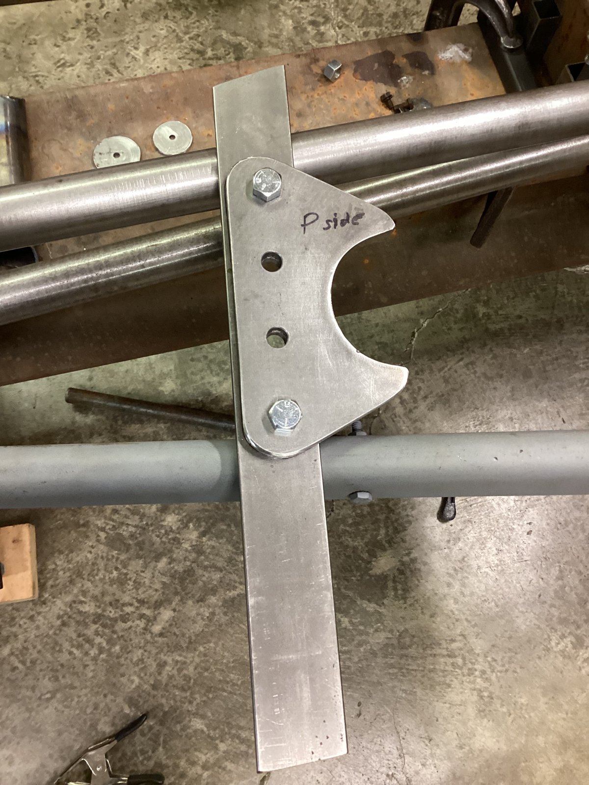

    Got the adjustable front spring perch done, with the exception of the gussets on the front . IMG_0447.jpg IMG_0448.jpg IMG_0452.jpg IMG_0453.jpg IMG_0455.jpg IMG_0457.jpg IMG_0461.jpg IMG_0462.jpg

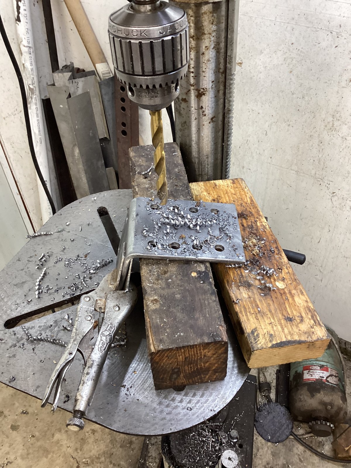

    I finally got around to fitting the rear motor plate. Rather than trust measurements, I made a sample plate out of .050 aluminum. That way I could get it to fit, by t******* here and there, and transfer it to the actual plate, as one slip could cause a 220 dollar loss and a weeks wait. It went well, and I was able to get the majority of the ch***is welding done, so I can pull it out of the fixture tomorrow. Still want to get the roll cage and steering box mounted before the show on Sat. IMG_0470.jpg IMG_0464.jpg IMG_0465.jpg IMG_0467.jpg IMG_0469.jpg

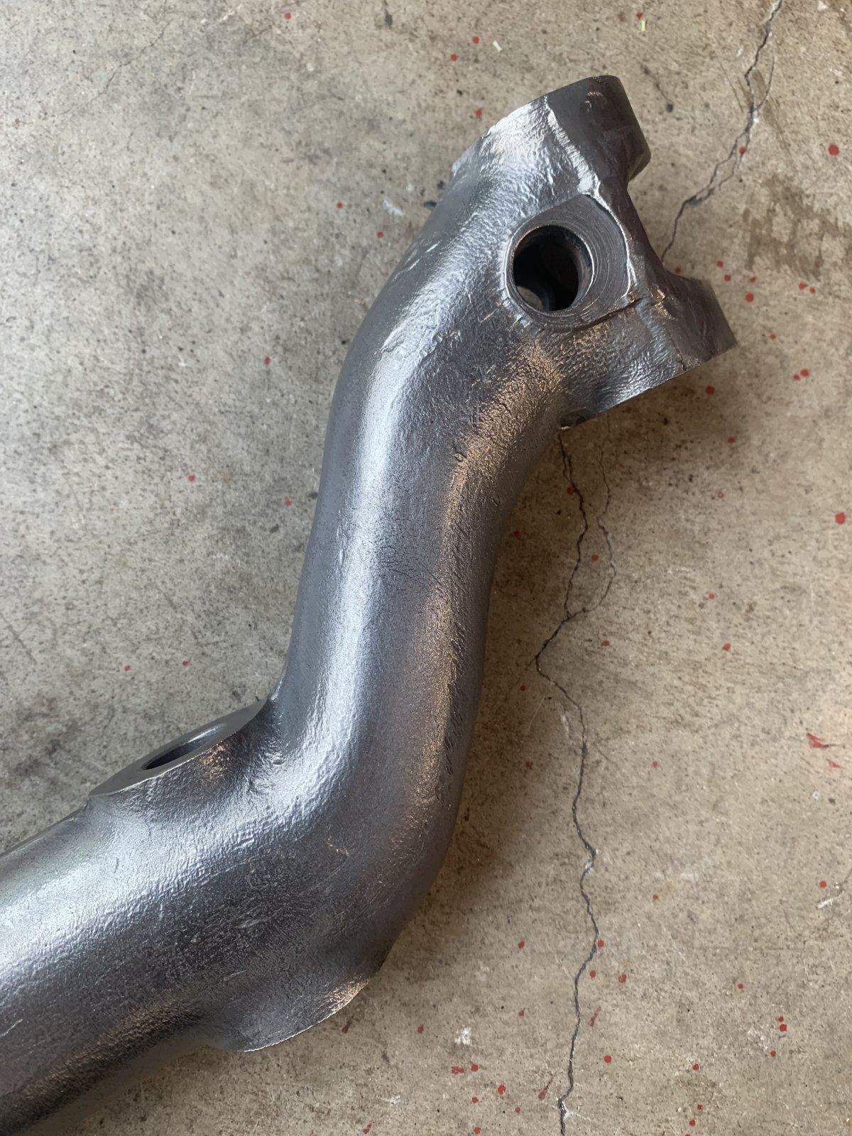

    The front axle is dropped and it should arrive next week, can’t wait to see it installed . IMG_5778.jpeg IMG_5775.jpeg

    Are you gonna drill it?

    Na, I can’t bring myself to do that.
