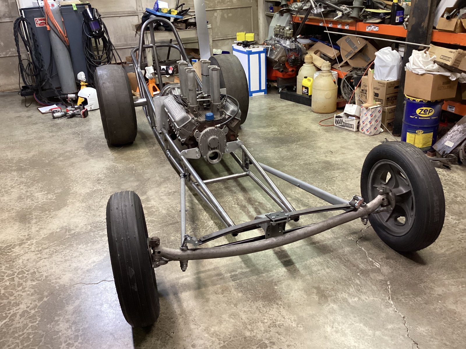

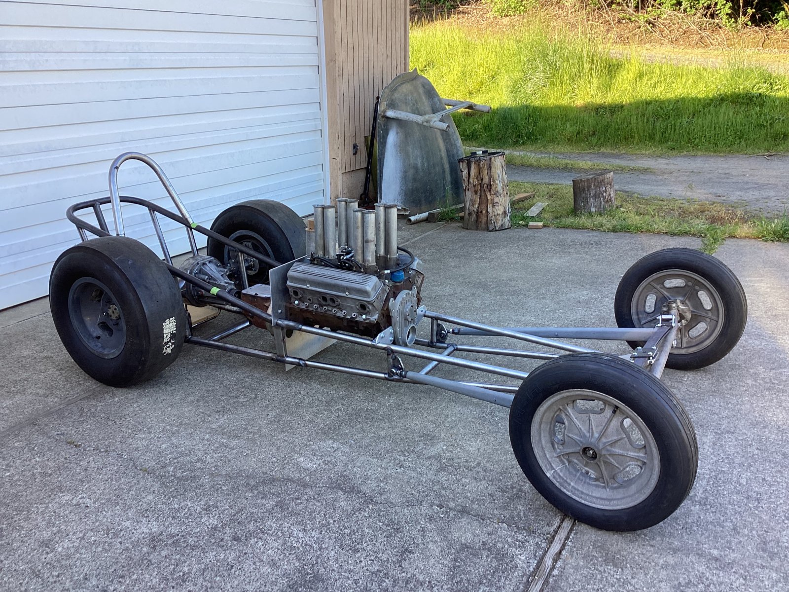

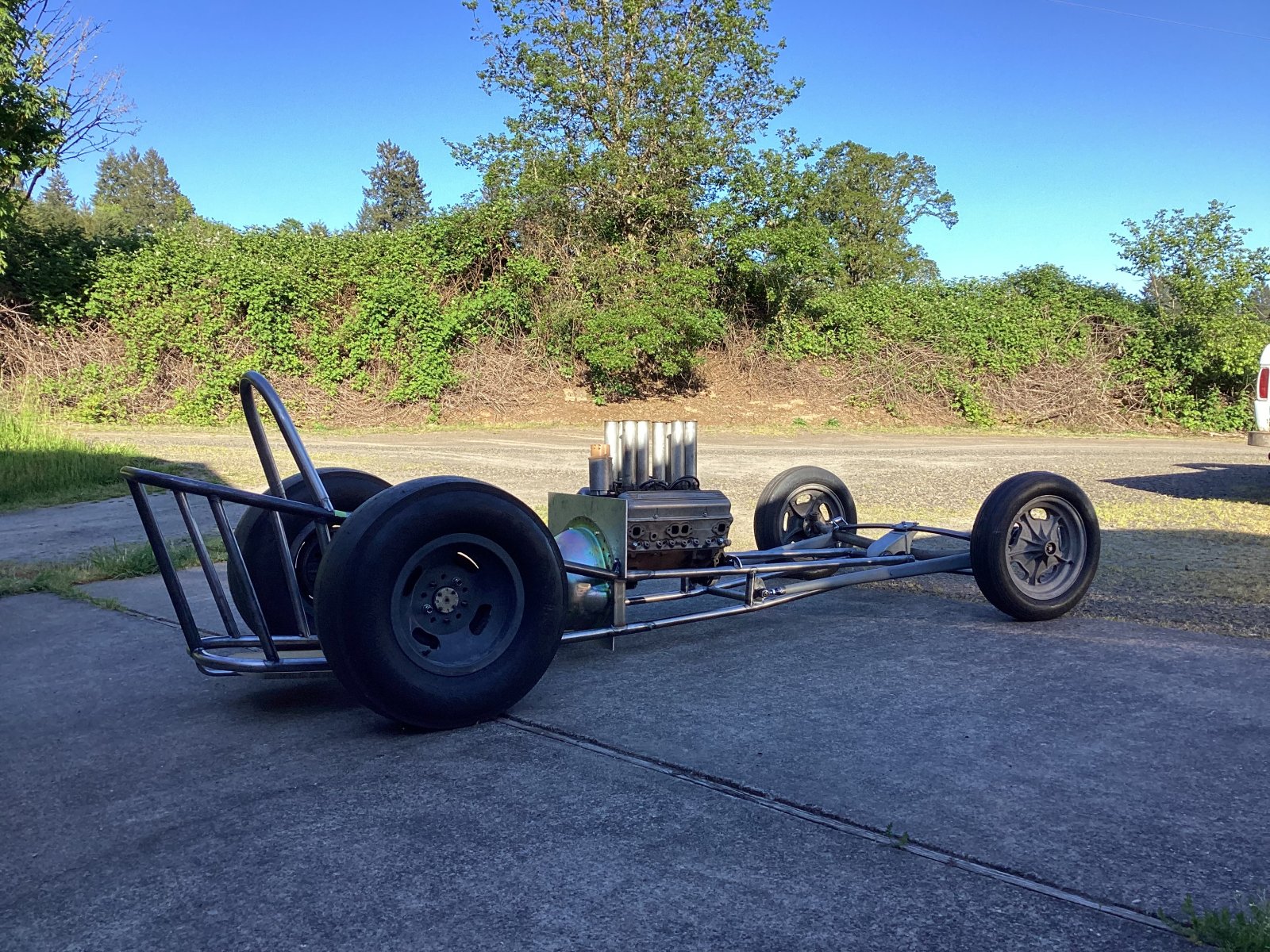

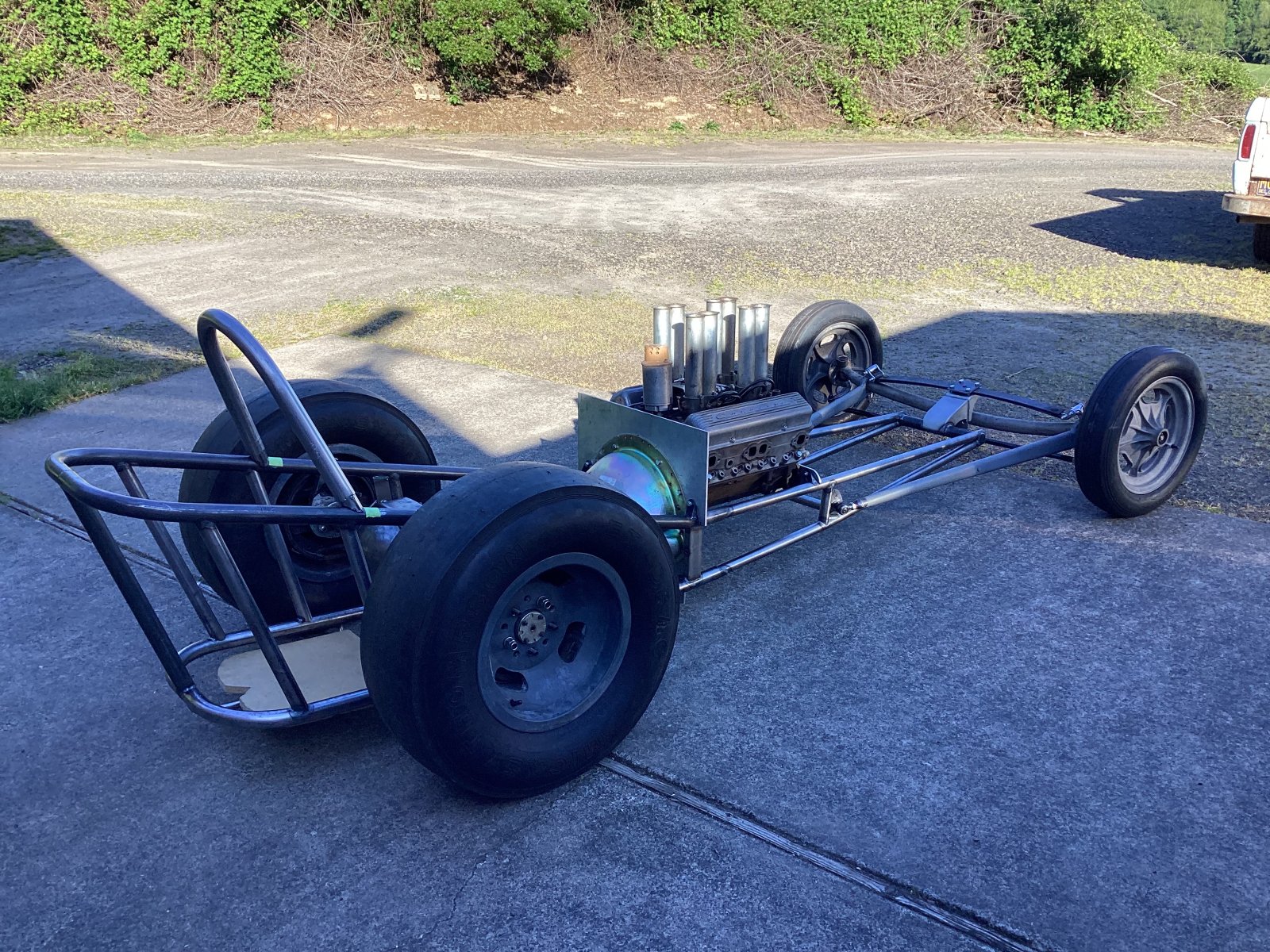

    I pulled it from the jig today and rolled it outside. Going to install the cage tomorrow, with luck. IMG_0471.jpg IMG_0473.jpg IMG_0474.jpg IMG_0475.jpg IMG_0476.jpg IMG_0477.jpg IMG_0479.jpg

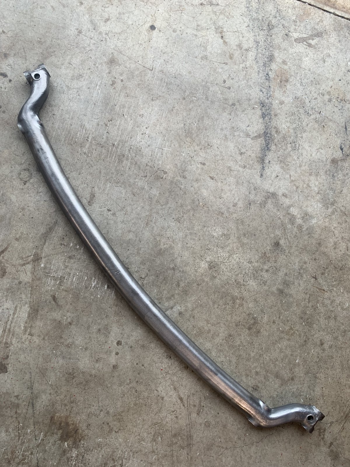

    Marty, do you have the unique king pin retainers/steering stops for your axle or was it drilled 9/16’s for the typical wedge type retainers? The tube axle kingpins had a radiused notch rather than the angular one.

    Larry, I am going to contact the guy on here, that makes them in stainless and steel, and order a set.

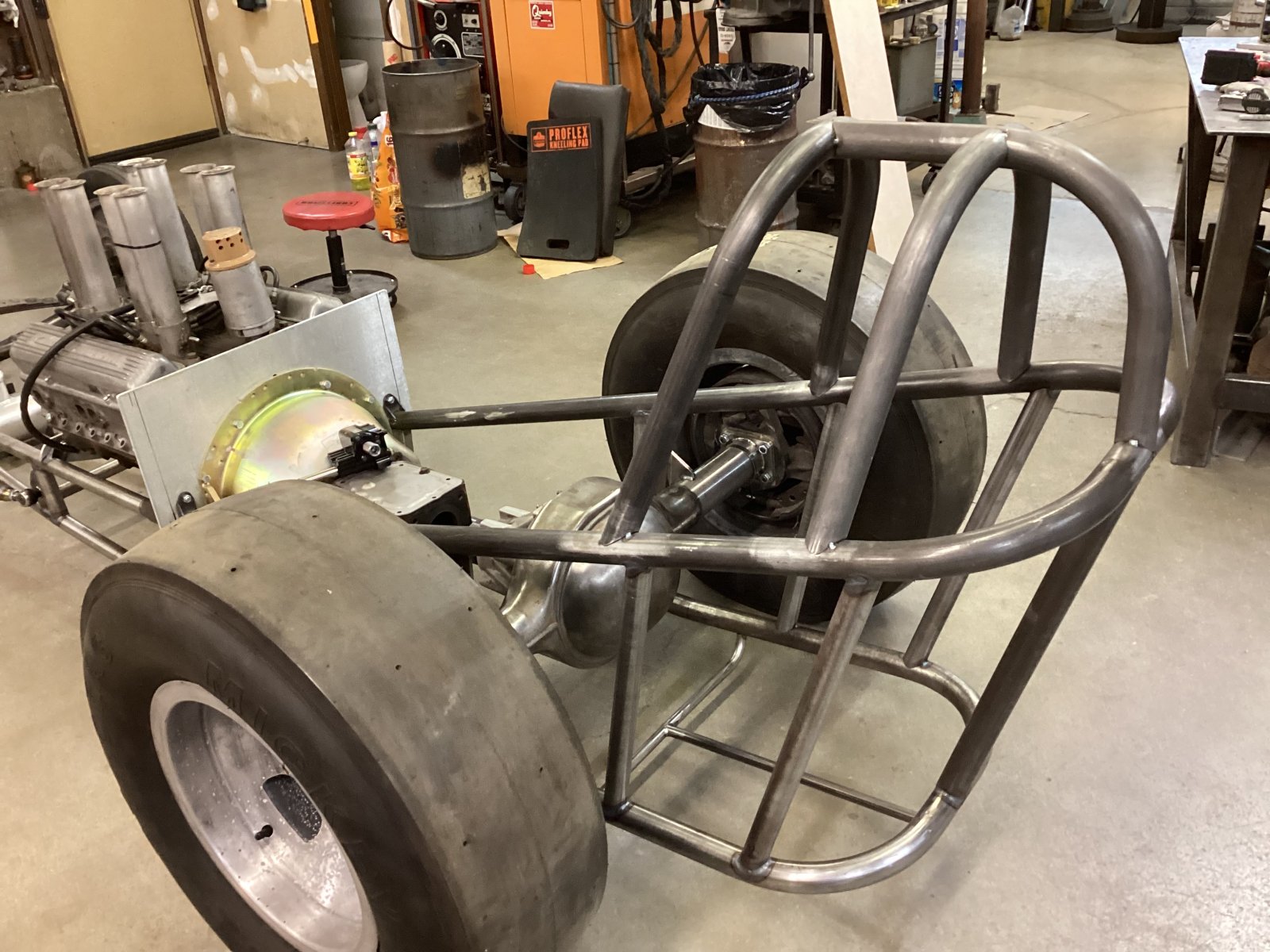

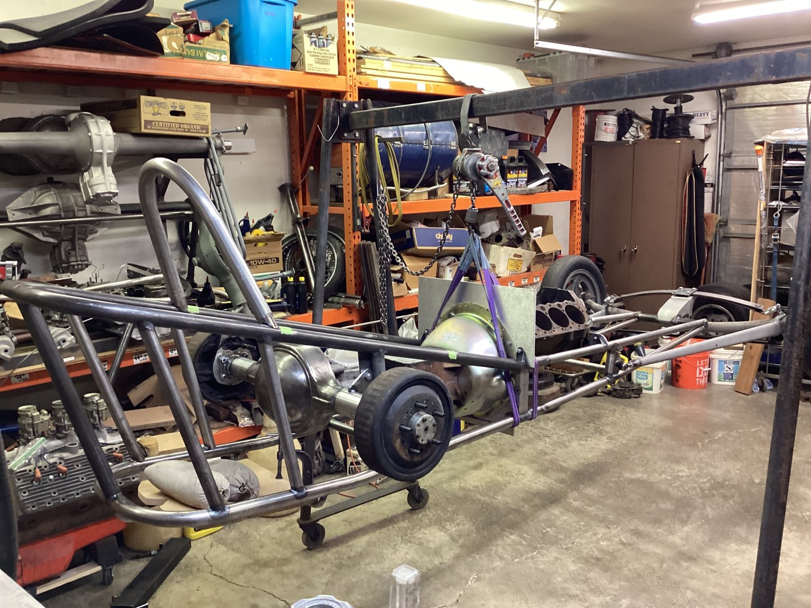

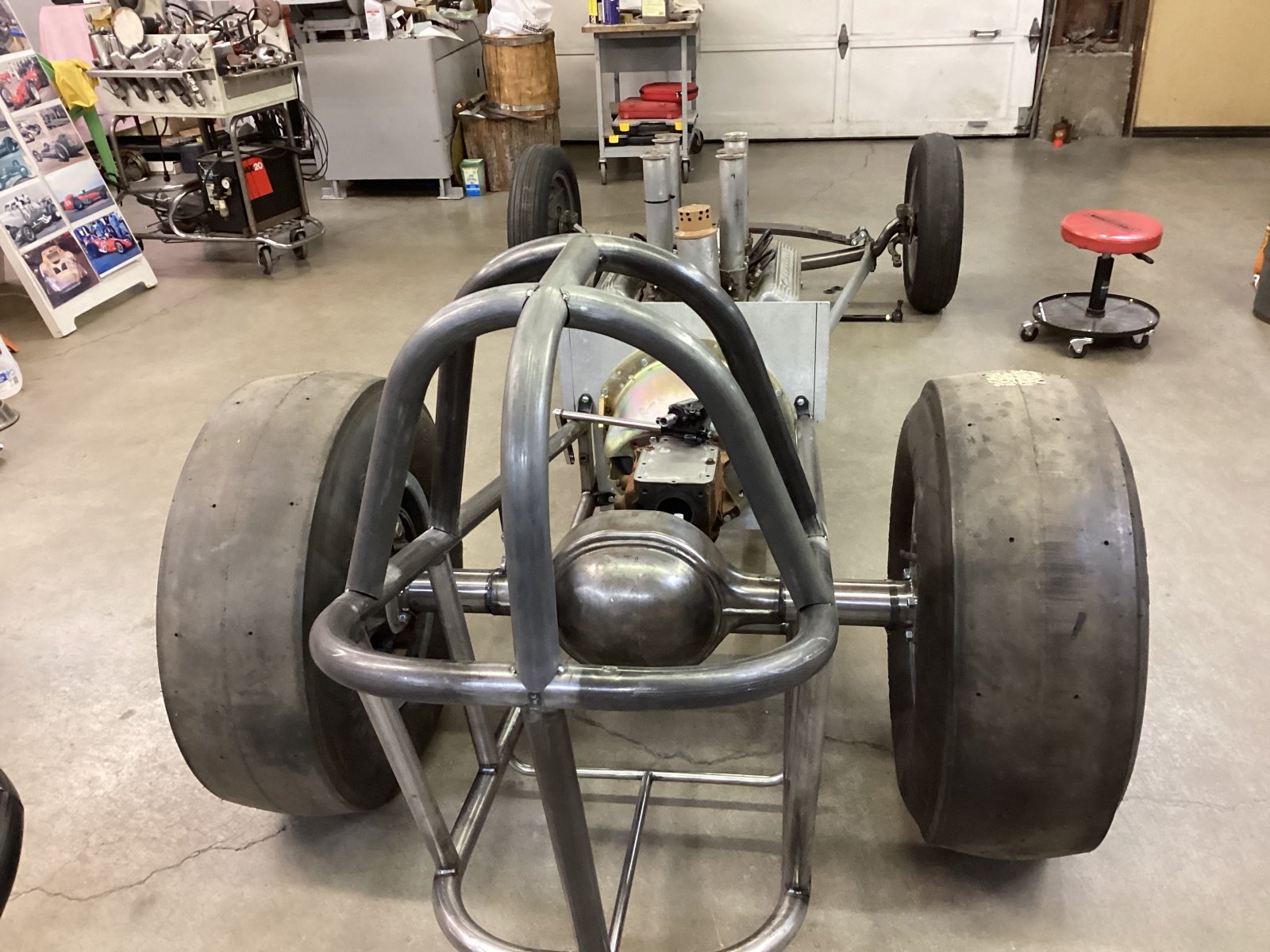

    Chris came today and we got the basic roll cage bent, fit and tacked. There will be 2 more bars and the light tube helmet surround . Hope to see some of you tomorrow ! And thanks @wrenchbender !

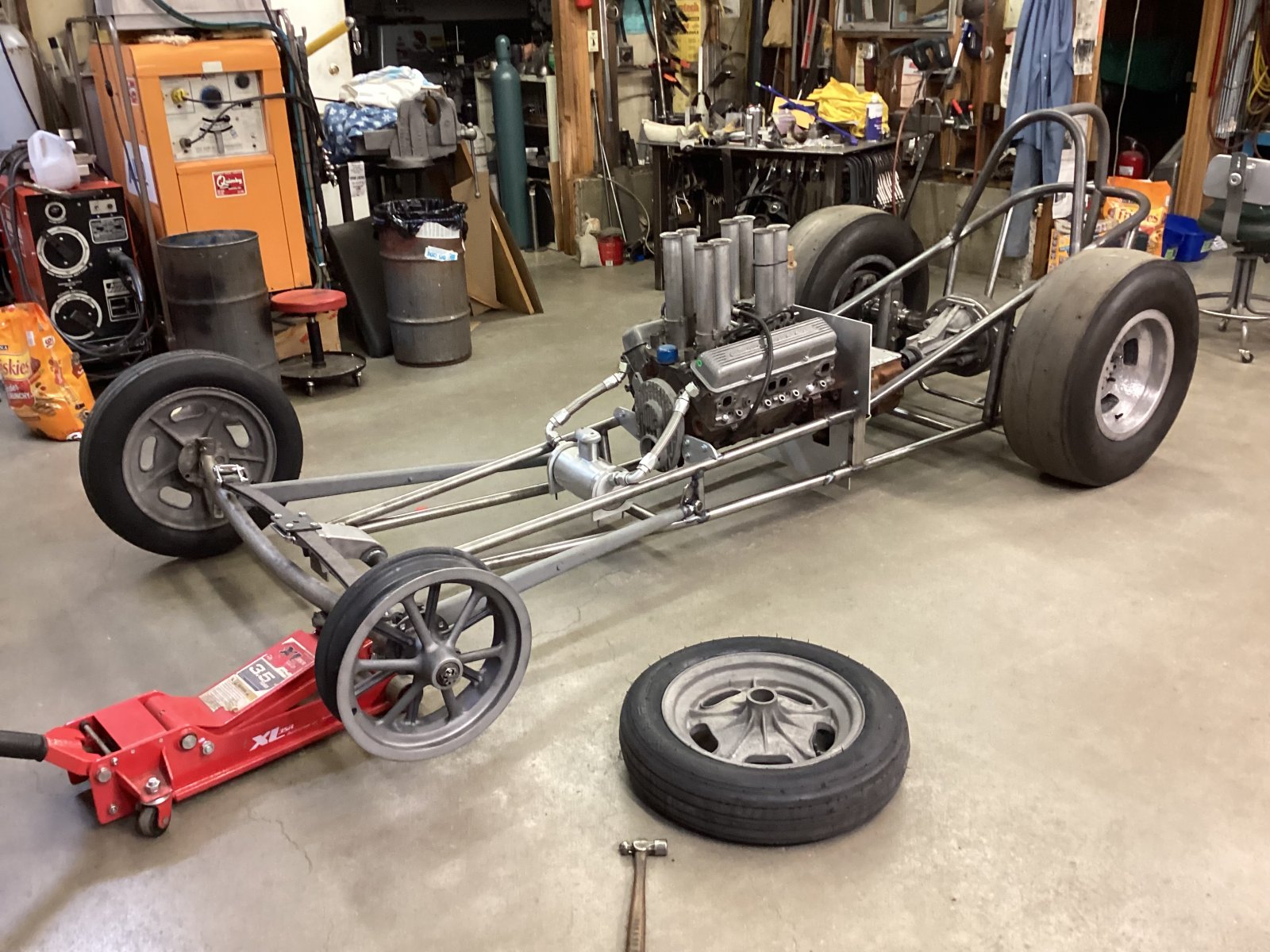

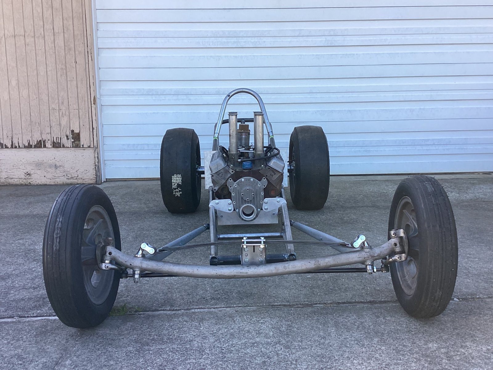

    A couple of things happened. First of all @SamIyam has been looking over my shoulder, and noticed the snout that pooched out on the front wheels of the original car, and quickly located a set near me. I have acquired them, and after I polish the outer faces, and install 1 inner race, I will get the front tires swapped. Also, I have been thinking about a breather/vent system for the car and remembered there was a nice tank and hoses in a bunch of stuff that another member @Alan Davis gave me a couple years back. It is nice to have friends ! Thank you both. Oh yeah, the dropped '60 axle will be here tomorrow. IMG_0529.jpg IMG_0530.jpg IMG_0532.jpg IMG_0531.jpg

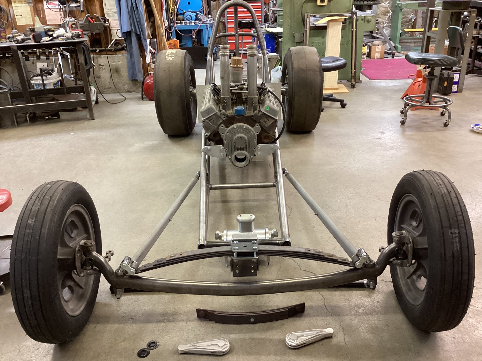

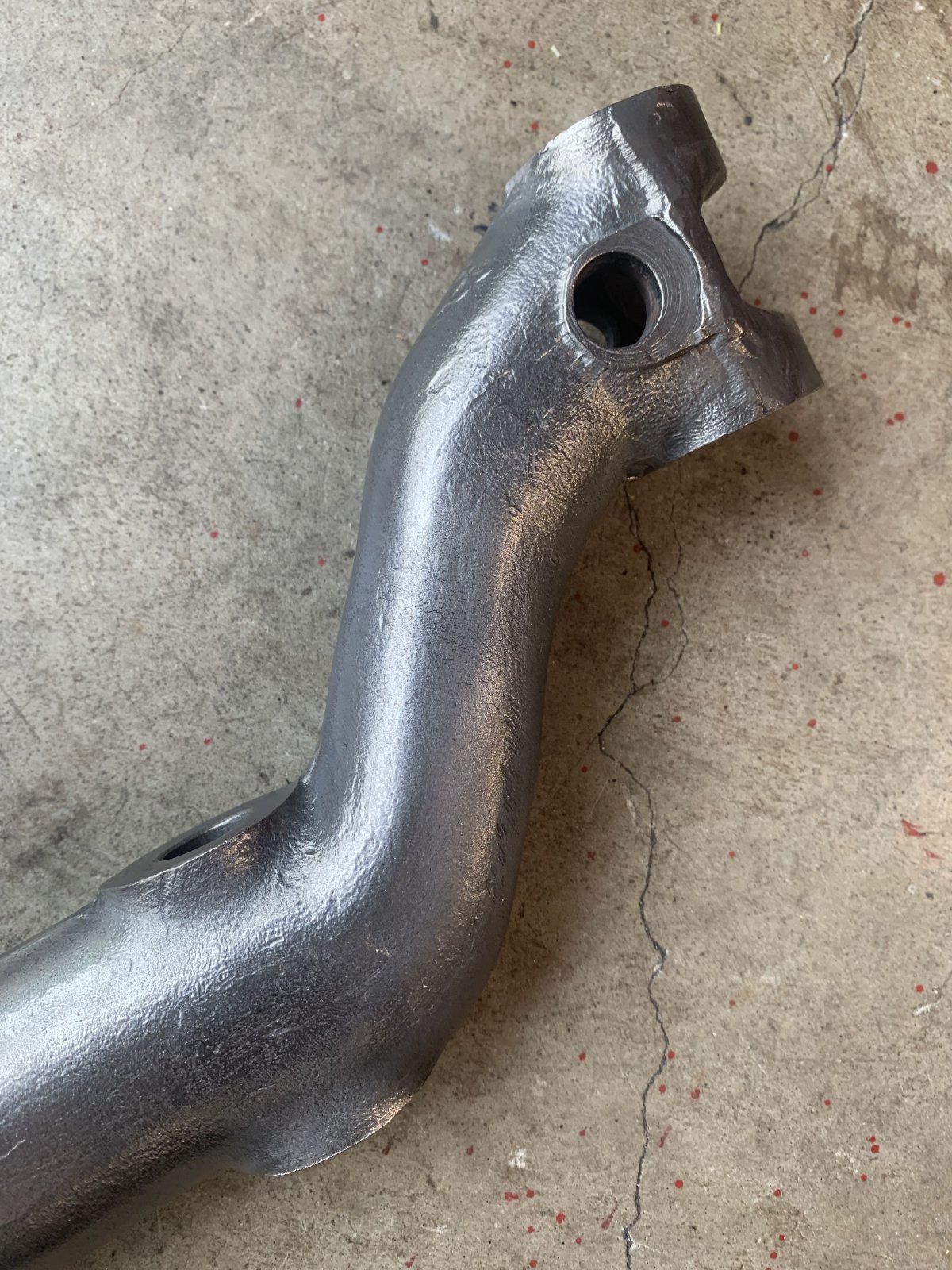

    I got the axle bolted in, and now I need to bend the steering arms down, so it will turn and the tie rod will p*** under the wishbones. Also, I might be in trouble with the front perch height. That's what I have a cutting torch for IMG_0534.jpg IMG_0535.jpg IMG_0536.jpg !

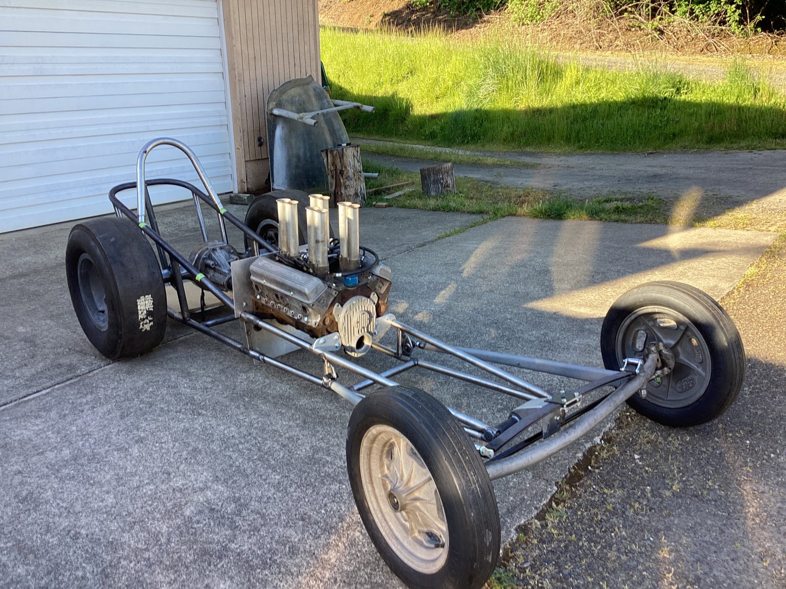

    I think I have resolved the front ch***is height problem, by adding more leaves, ( that I knew it would need anyway) and with a little re-work on the removable perch, it should be fine. I also got the 2 extra bars added to the roll cage today. Steering box will get mounted tomorrow. IMG_0539.jpg IMG_0537.jpg IMG_0540.jpg IMG_0541.jpg

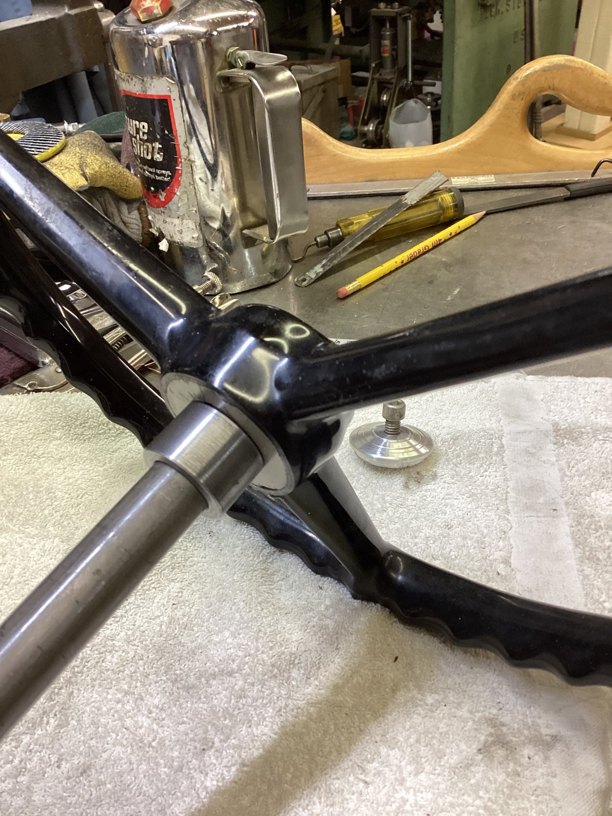

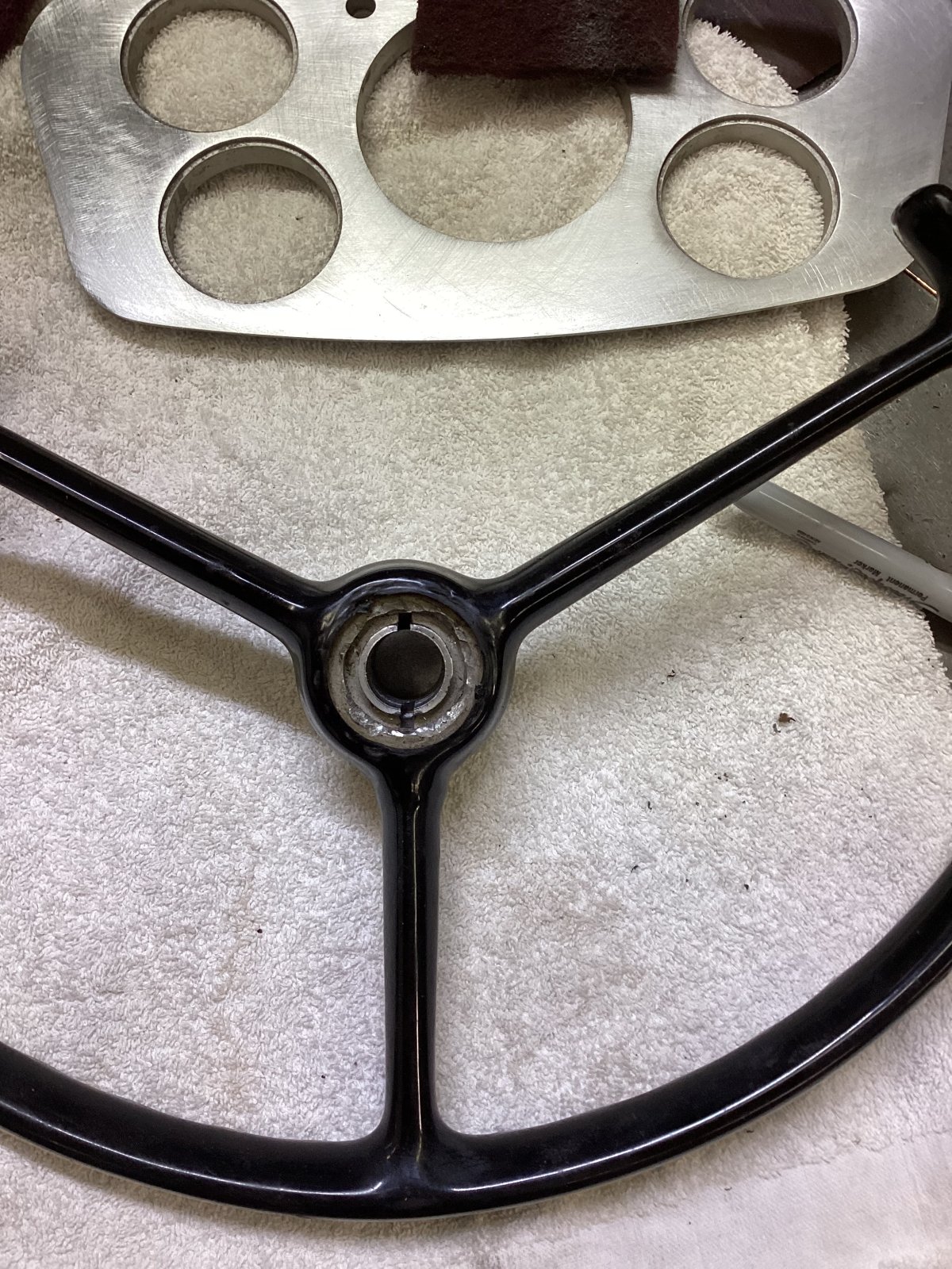

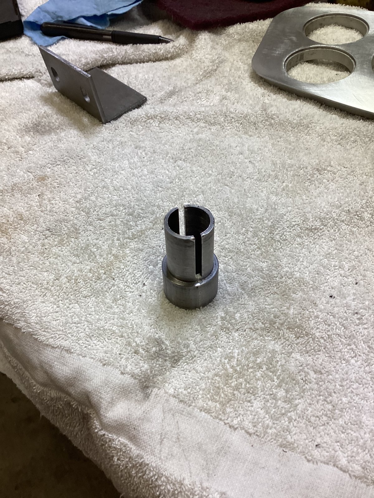

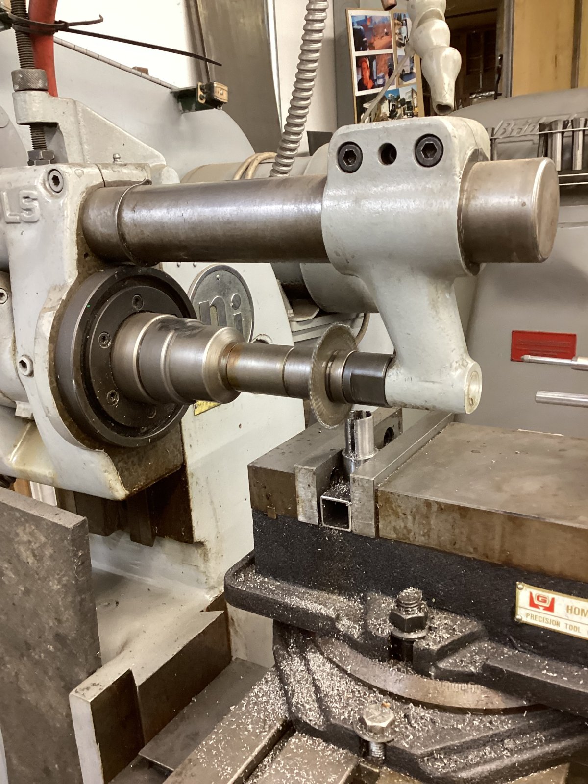

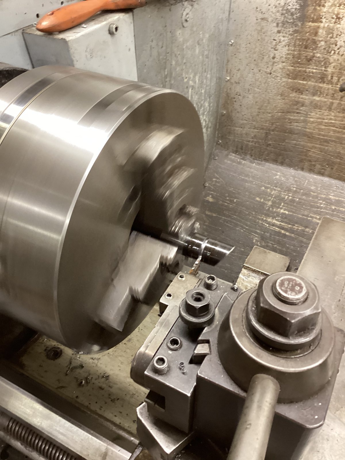

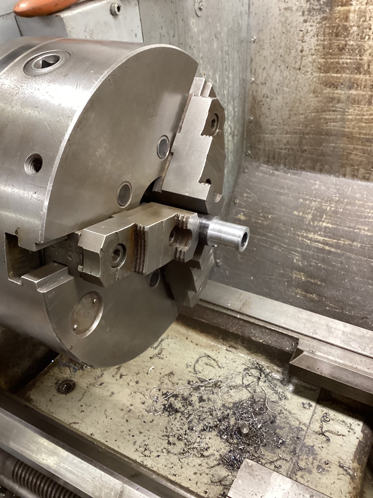

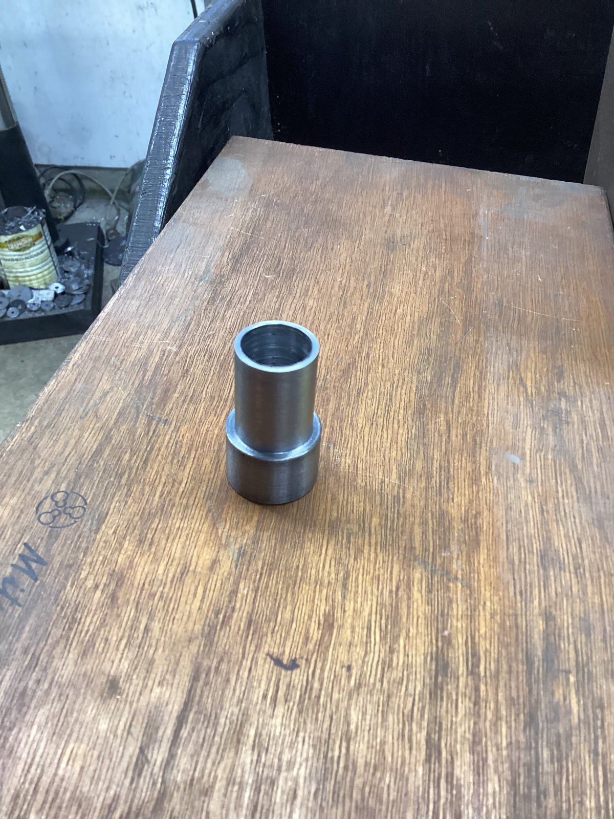

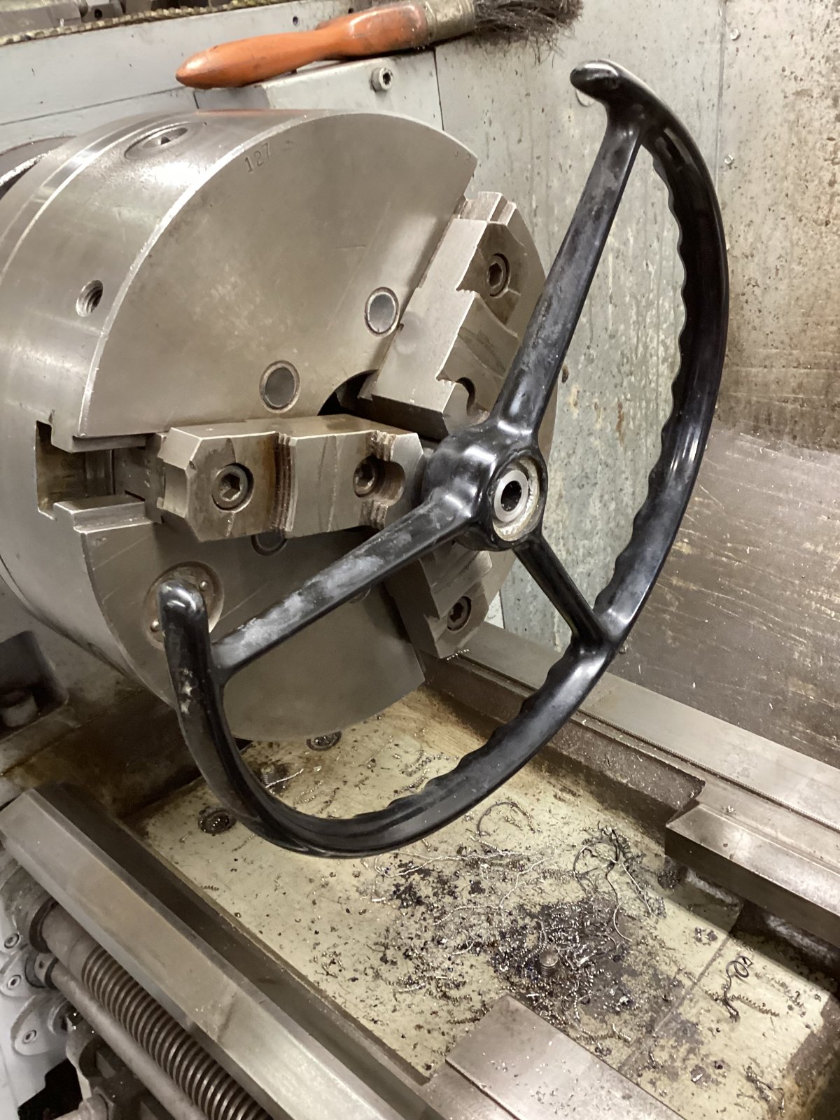

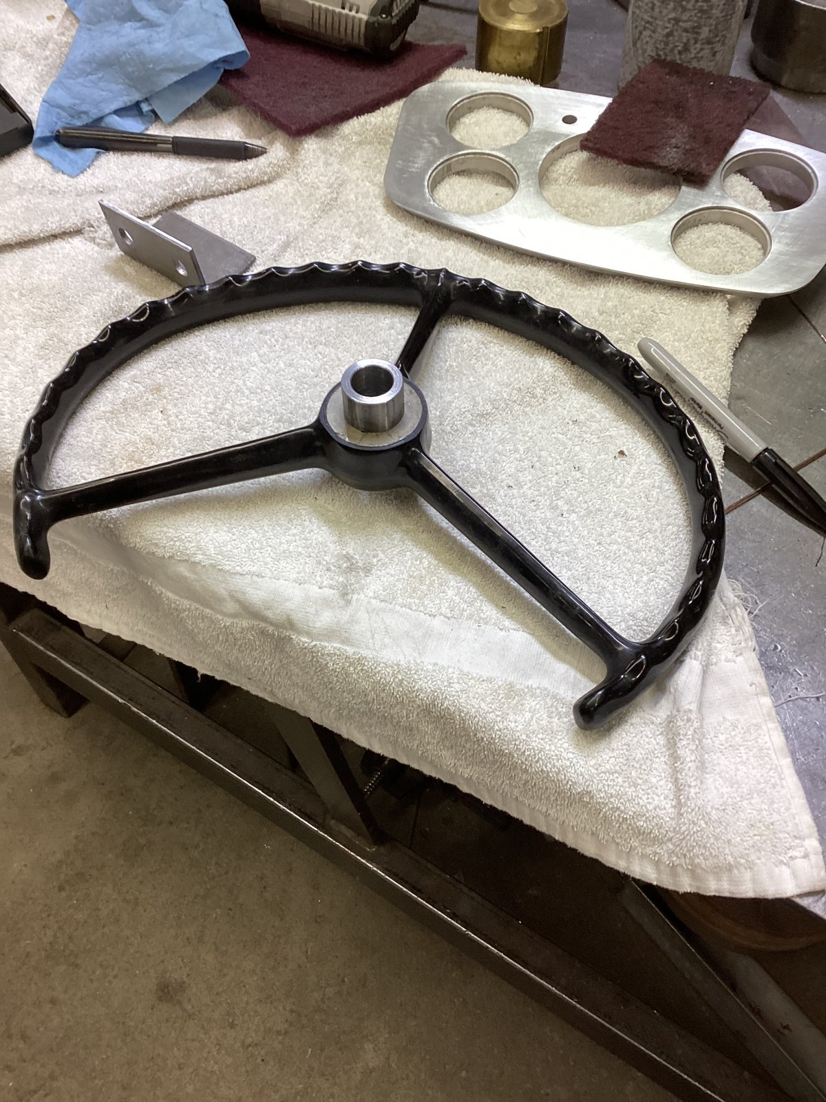

    Mounting the steering box and the DC3 Control Yoke (steering wheel) was a little machine work, but worth it. I started by machining a sleeve to fit the wheel with a 3/4" bore to fit the shaft, then cutting the slots. I will machine the keys next. IMG_0543.jpg IMG_0544.jpg IMG_0545.jpg IMG_0546.jpg IMG_0542.jpg IMG_0547.jpg IMG_0548.jpg IMG_0549.jpg IMG_0550.jpg IMG_0551.jpg

    Larry Anderson
    What’s that gauge cluster bezel looking thing for. Obviously I don’t get out much
  23. Marty Strode
    Joined: Apr 28, 2011
    Posts: 9,710
    Marty Strode
    It just happens to be on my table, I milled the surface to remove ball mill grooves for a buddy.

    Got the keys machined, and turned out a ****on for the center. There will be a threaded bung welded in the end of the steering shaft, to hold it together, and a cross bolt ahead of the wheel. The quick disconnect will be forward of the wheel around 6", to give the driver more room getting in and out, and allowing the DC3 wheel. IMG_0552.jpg IMG_0553.jpg IMG_0554.jpg IMG_0556.jpg

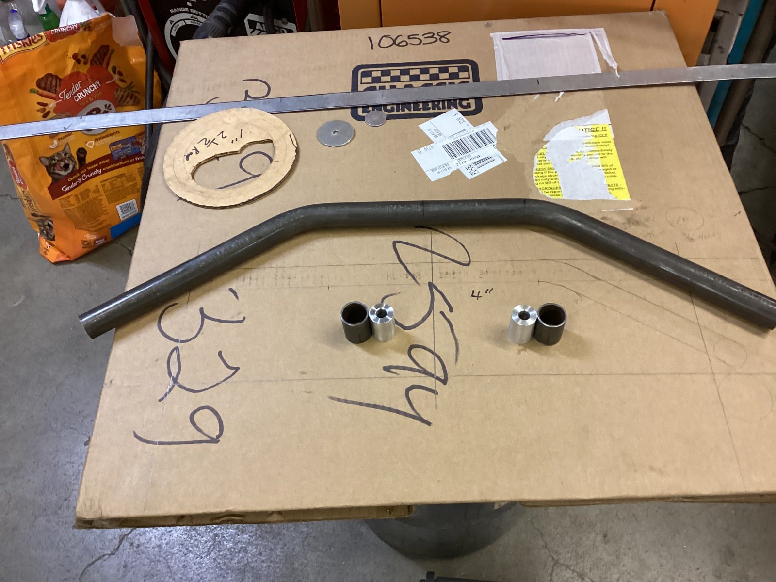

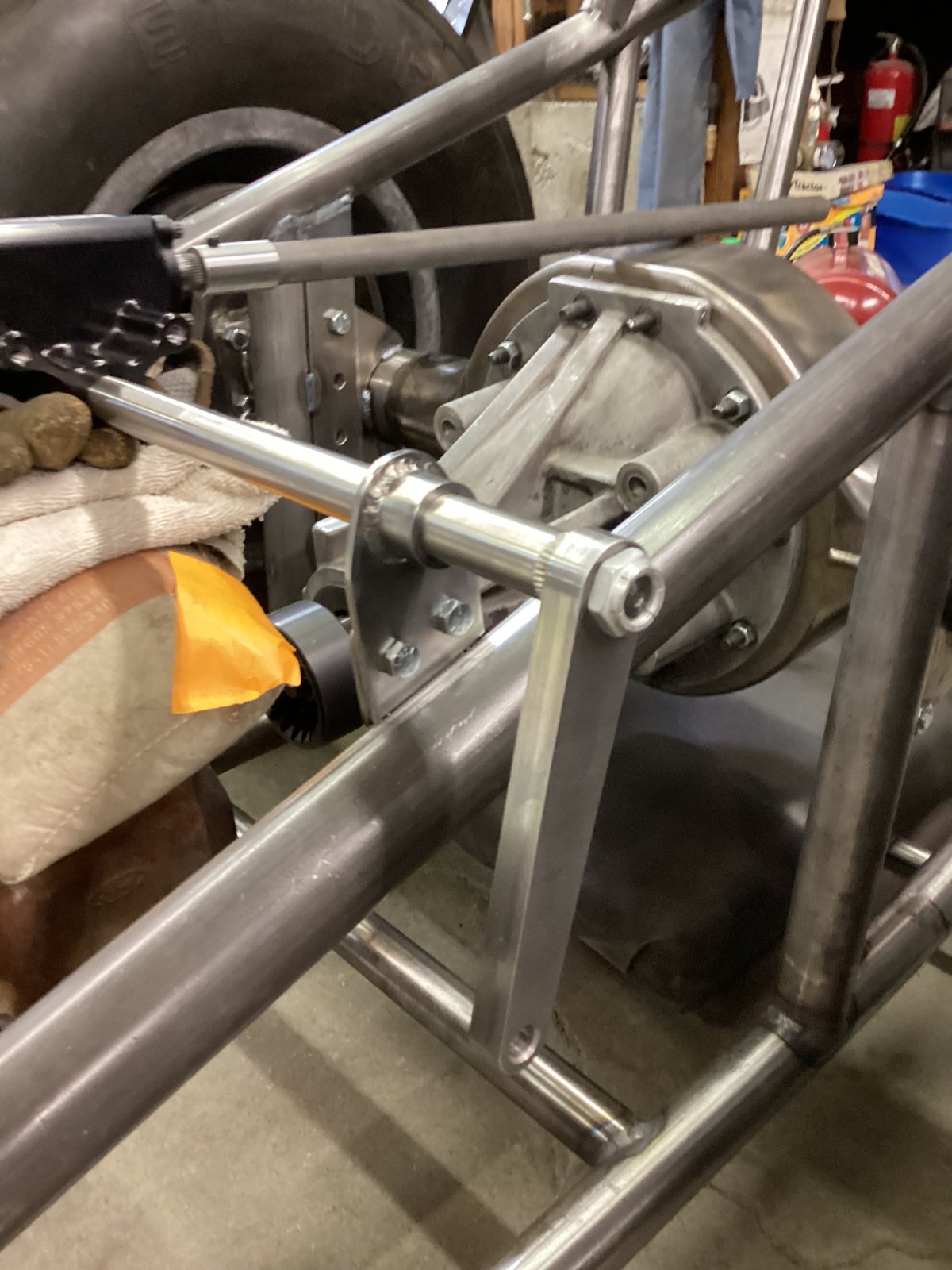

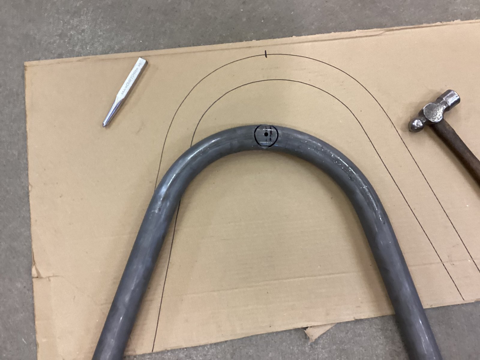

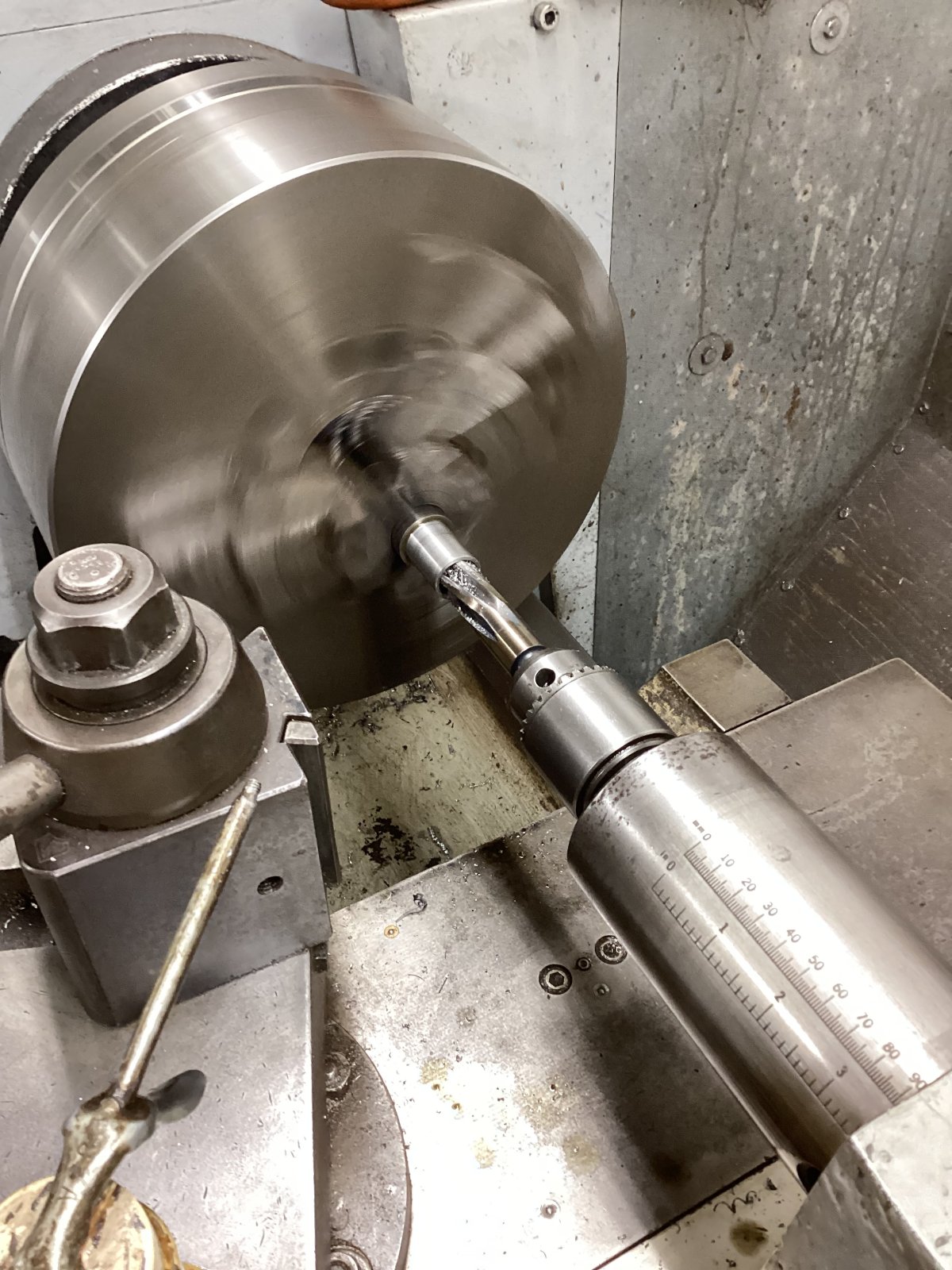

    Today I worked on the steering mount/leg hoop. After bending up a piece of 1" 4130 tube, and cutting a couple stubs for the ends, I machined a couple of aluminum sleeves. Now that it is tacked in, tomorrow I will make the angle plate to attach the box, then on to the a-frame sleeved riser to support the shaft. The steering disconnect is on it's way, along with a Girling style Willwood master cyl for the brakes. IMG_0563.jpg IMG_0564.jpg IMG_0565.jpg IMG_0566.jpg IMG_0567.jpg
