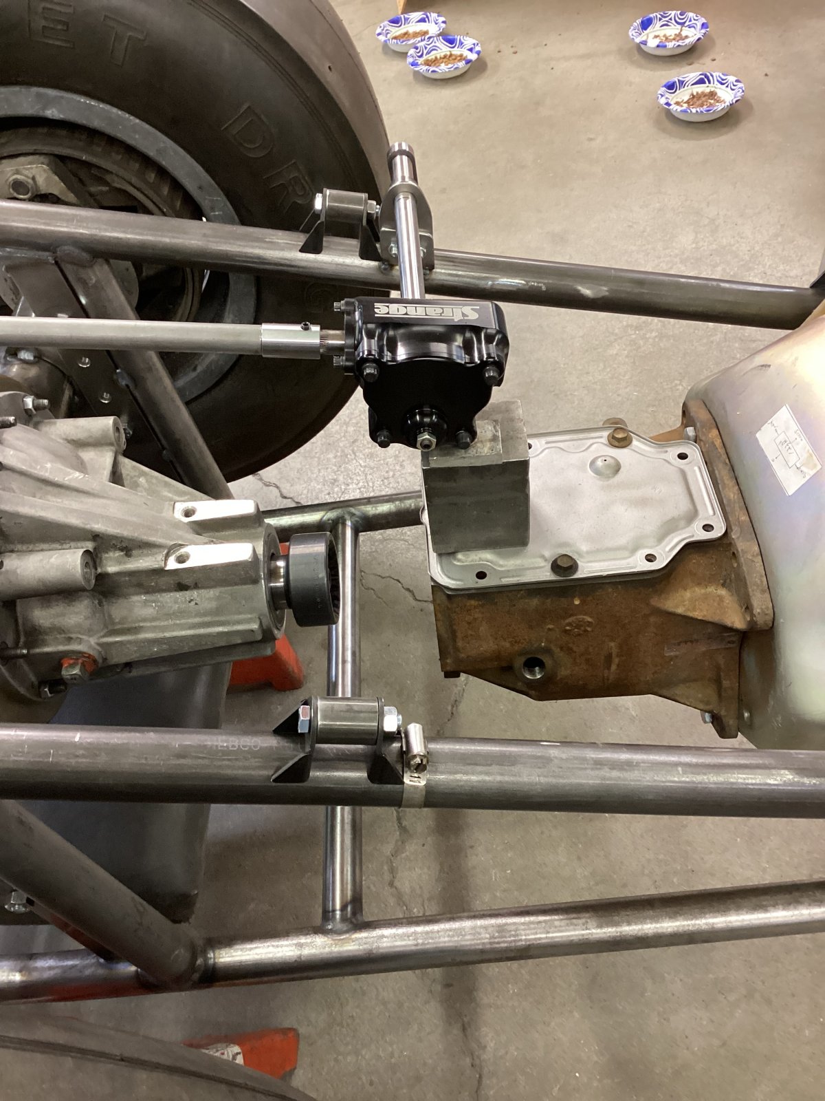

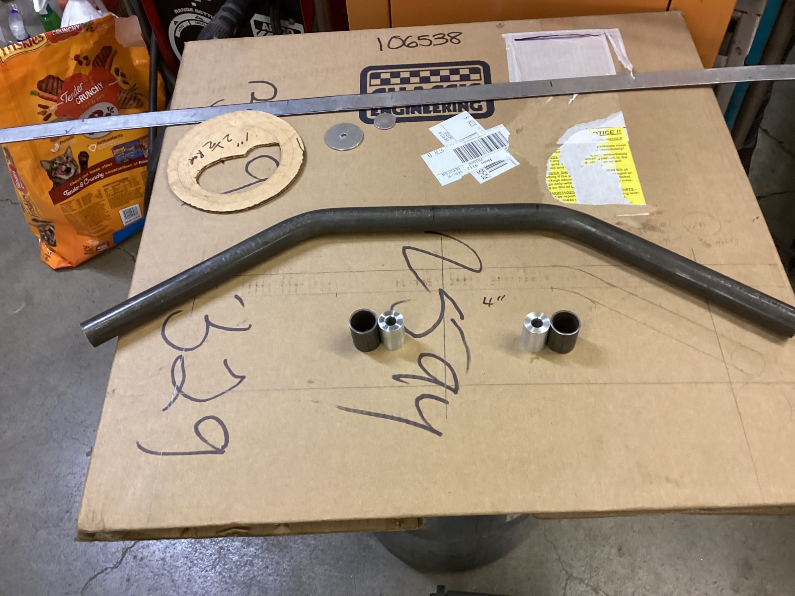

    Mike, you are full of questions, and that’s a good thing. When working on any car, in critical areas, I prefer to have the least amount of things in the way, and that is why it will be removable. Also, since I am setting the car up for me at 5'10" and 175 lbs, it will be far easier to convert it for another driver, by making another crossmember. IMG_20240521_135125277.jpg

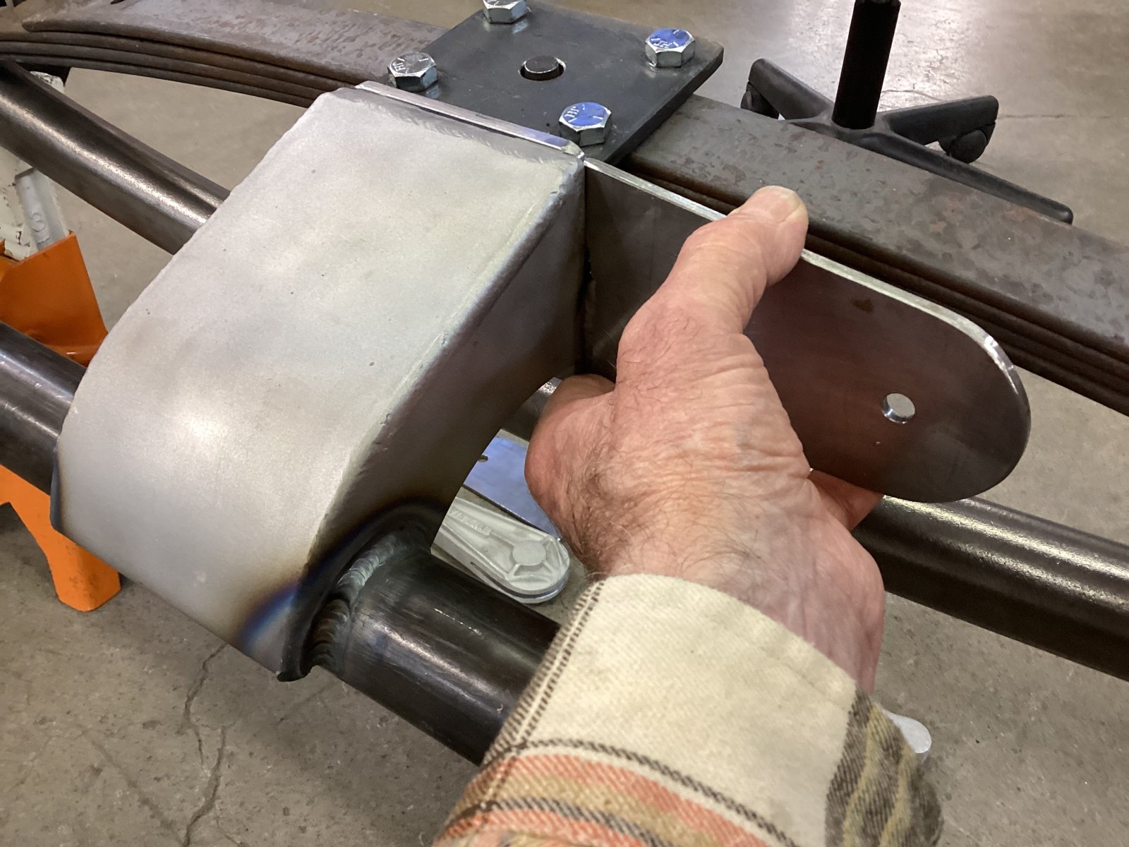

    Got the bracket fabbed and in place, after a final fit, I will tack it to the cross tube and add 2 gussets. But for now I am going to work on getting the front real wheels and tires ready. IMG_0569.jpg IMG_0568.jpg

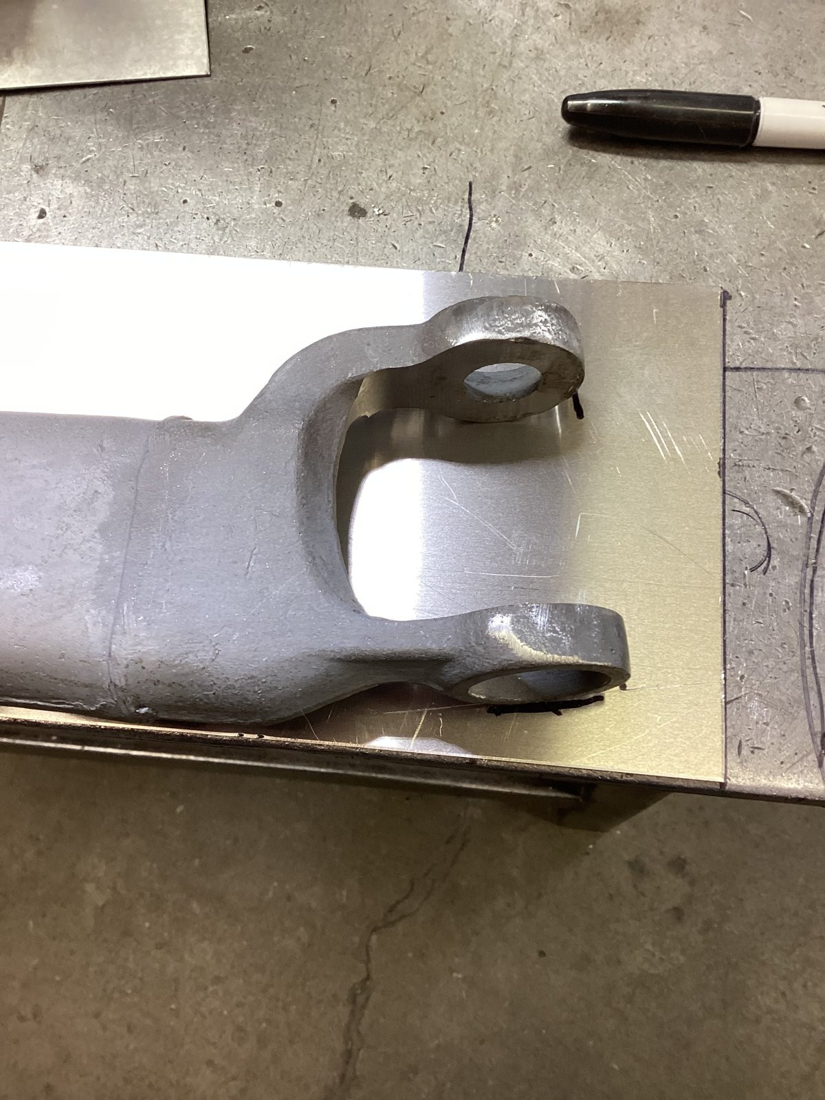

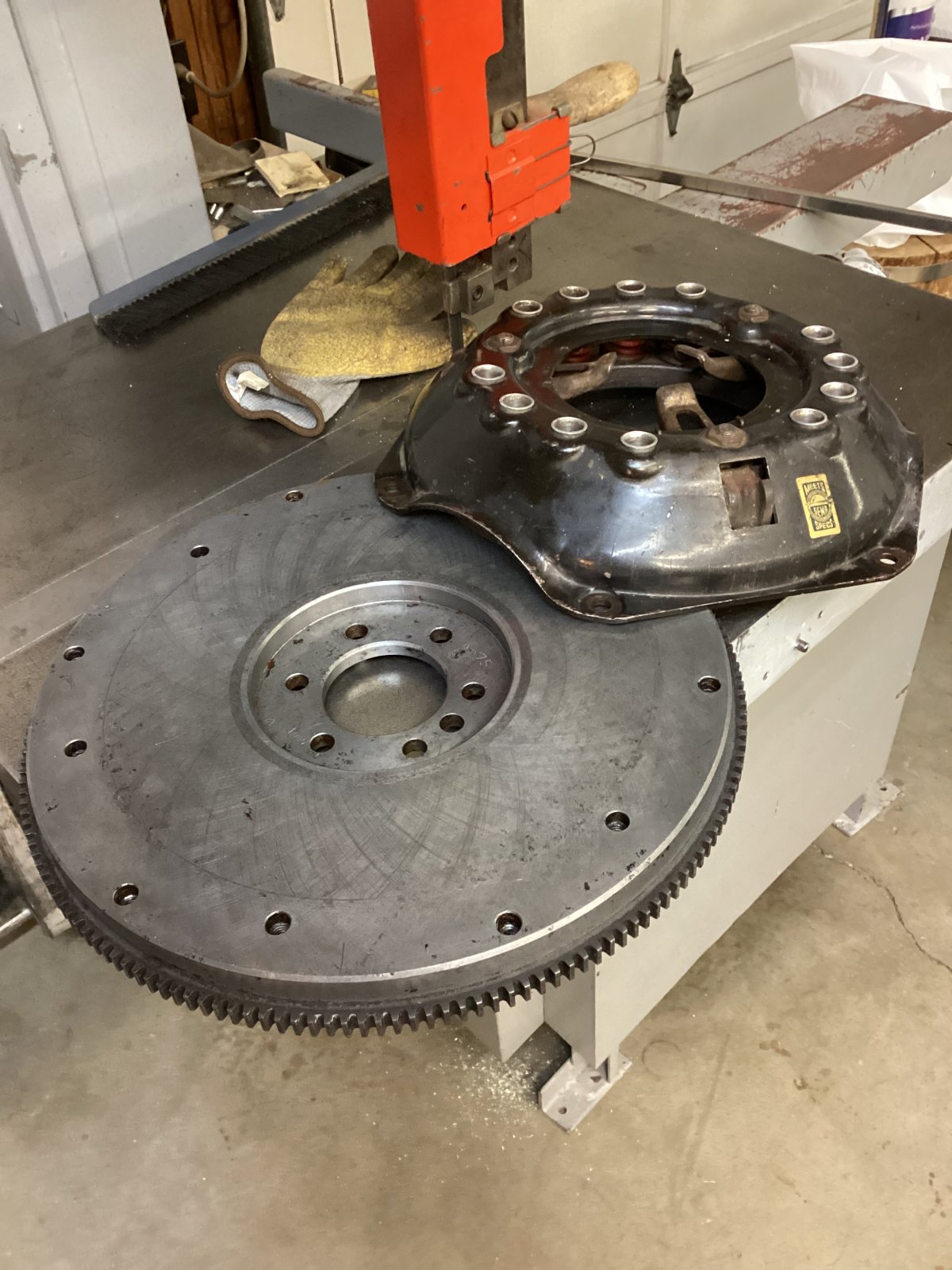

    A friend of mine for 50 years was looking for a Chevy engine to Ford toploader trans bellhousing and his search led him to the HAMB, and he found out that I had a couple Lakewood ****ter shields. I was ready to give him one, and mentioned I was going to run a 40 lb wheel in the Dragster. He just happened to have a nice one and a pressure plate to match, so it ended up a swap. It should be simple to add some thick tapped pads to pick up the Ford trans pattern inside, for his application. IMG_0574.jpg

    Inspect the windows of the clutch fingers closely as some makes are prone to developing cracks in the cover. A fix was to add "window frame" reinforcing plates around the windows.

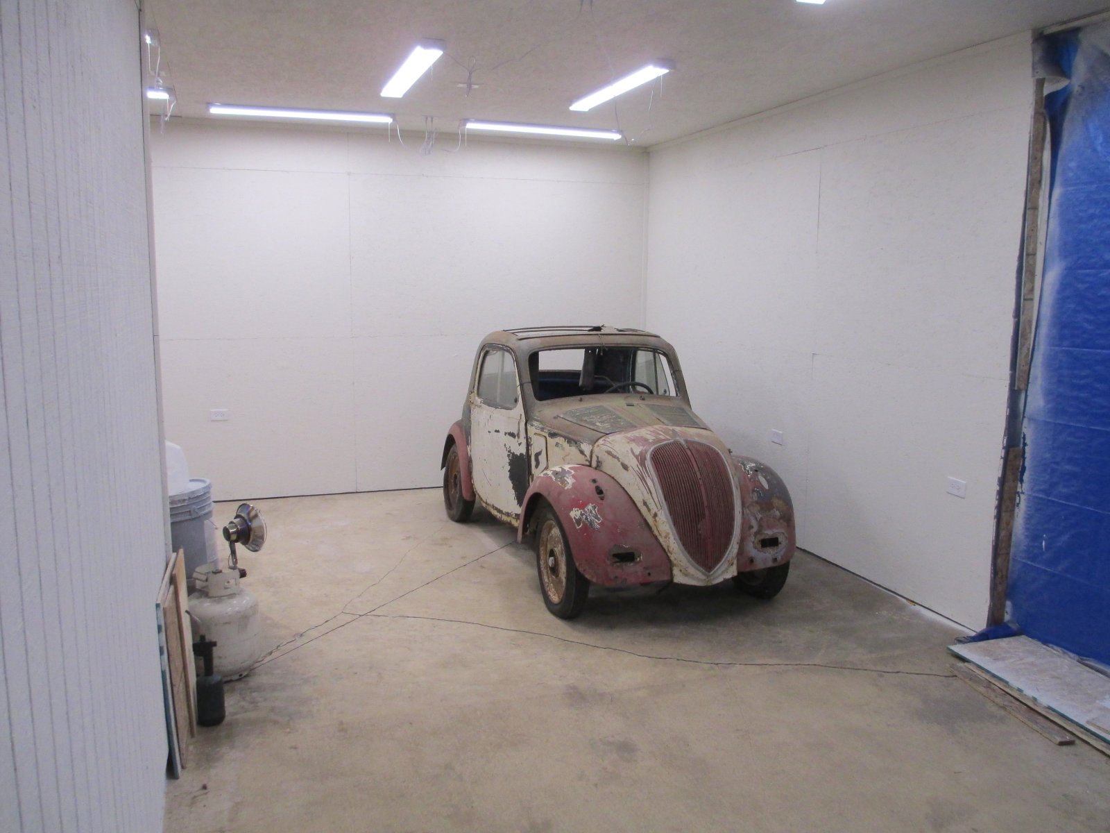

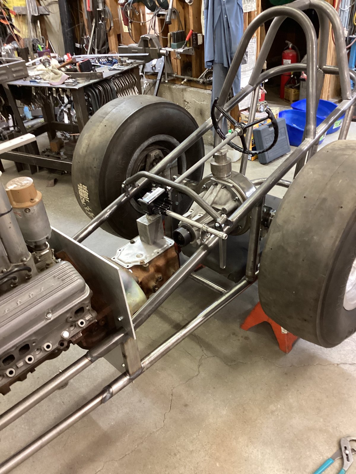

    So, If I want something to drive, I had better get started on this one ! IMG_3518.JPG Simca 2.jpg

    Do you mean the 57 Silver Hawk ? It belonged to my buddy Dave Wallace that was riding along. My brother Jerry painted it RED for him, and he drove it a couple years when we were in Hi-School.

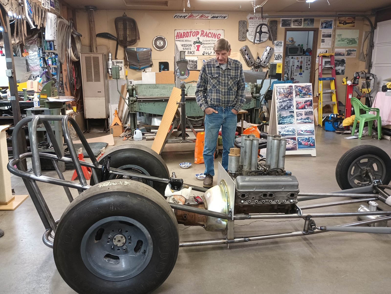

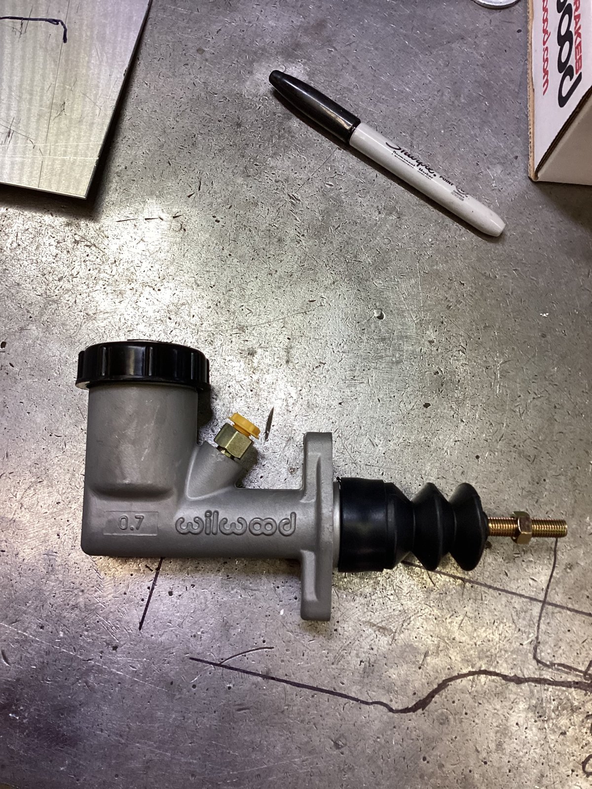

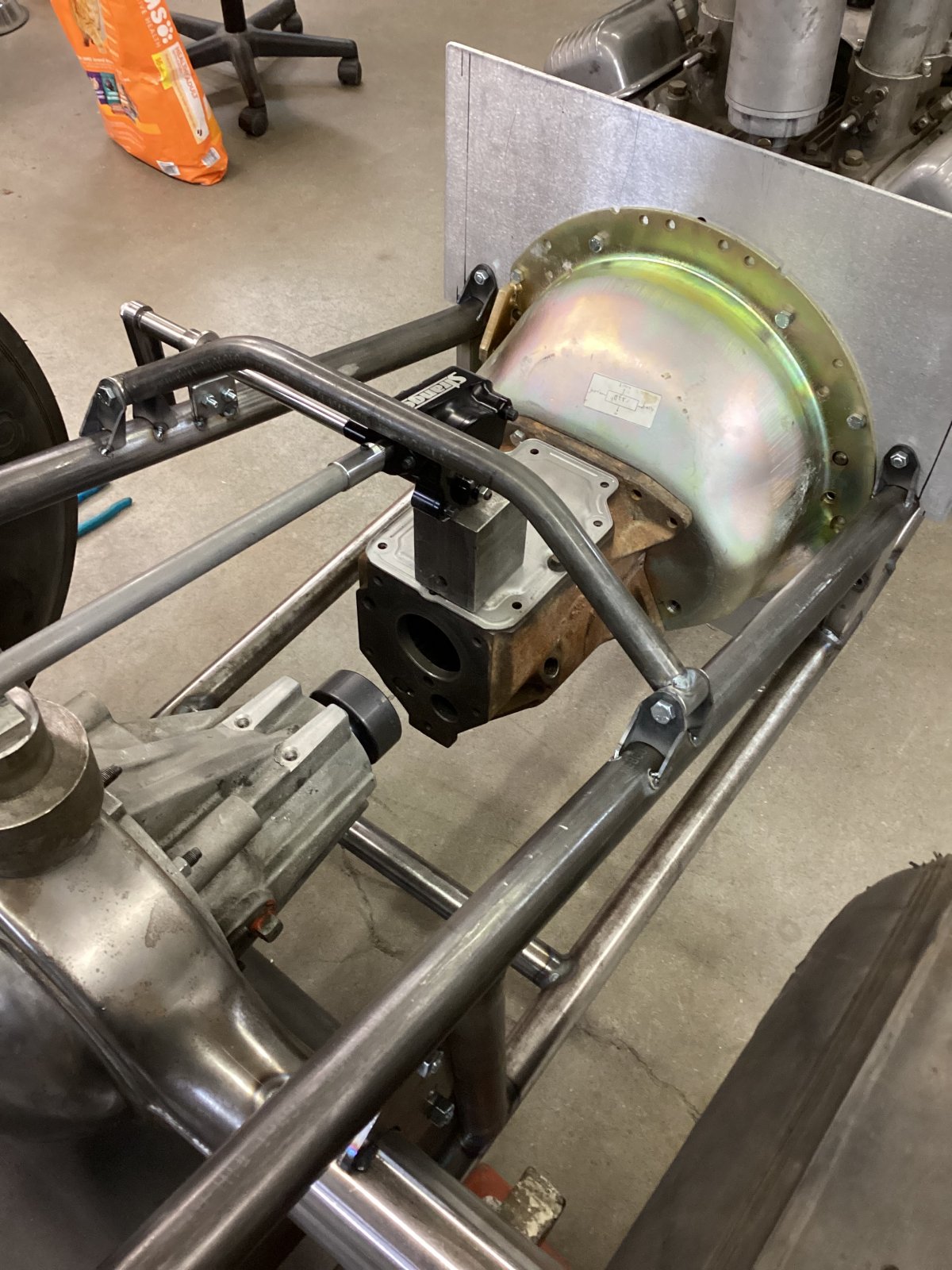

    The current phase of the project is getting the caster corrected and mounting the friction shocks. That way when Chris is building the body at the nose section, he will know what he is fitting the body around. I also received some parts I had ordered, a small starter, quick disconnect for the steering and a Girling style master cylinder. Tomorrow, I will pull the engine and saw the excess off the engine plate. IMG_0591.jpg IMG_0592.jpg IMG_0593.jpg IMG_0594.jpg IMG_0601.jpg IMG_0602.jpg IMG_0603.jpg IMG_0598.jpg IMG_0599.jpg IMG_0600.jpg

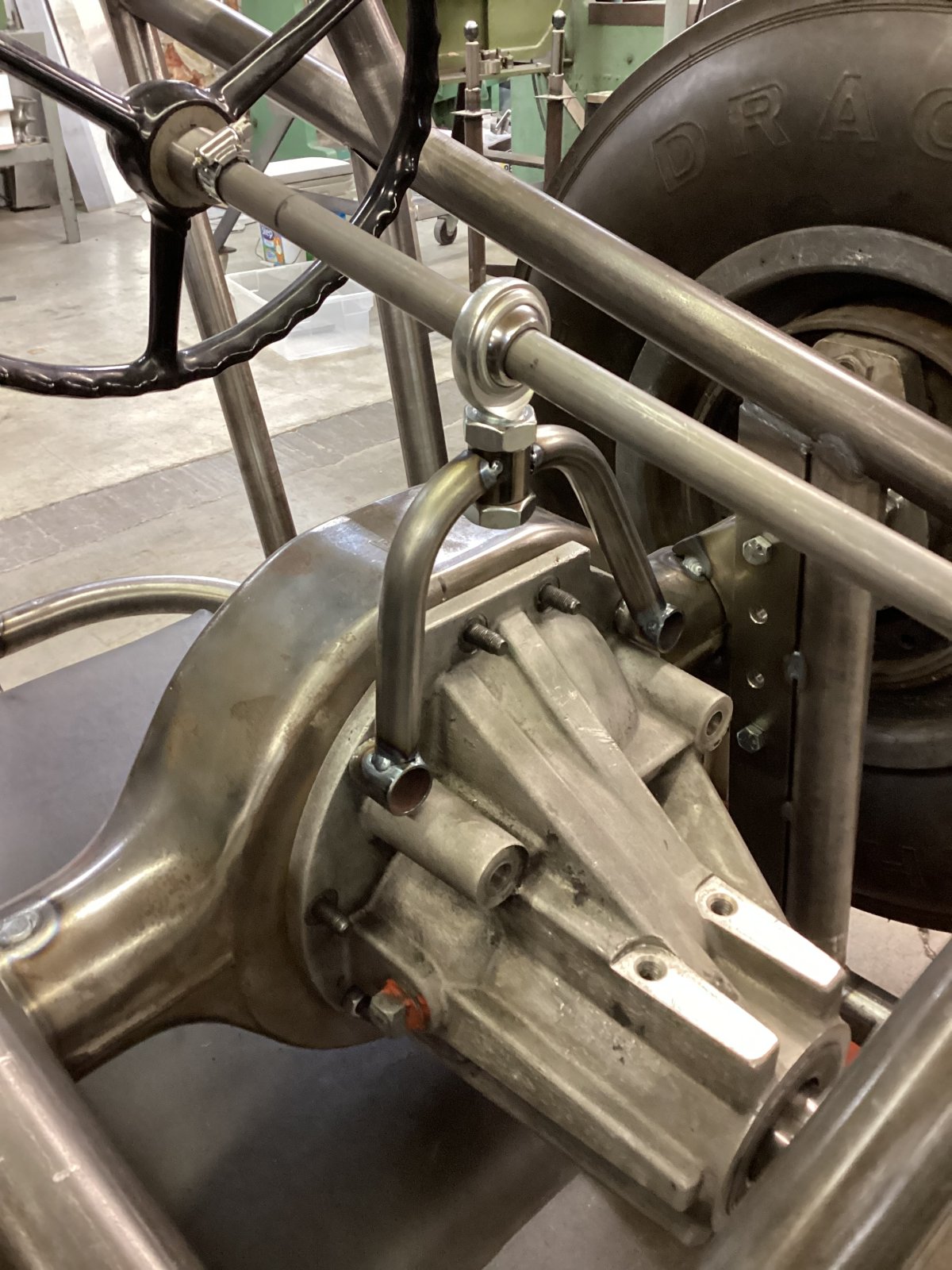

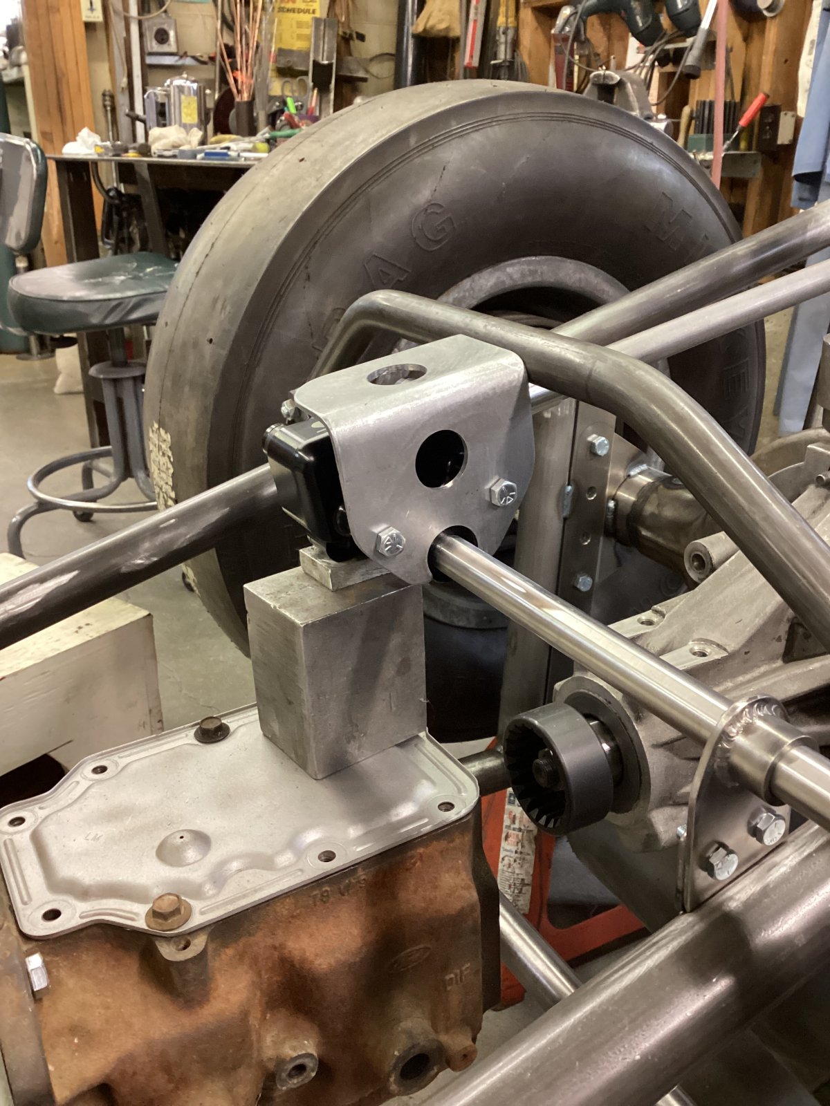

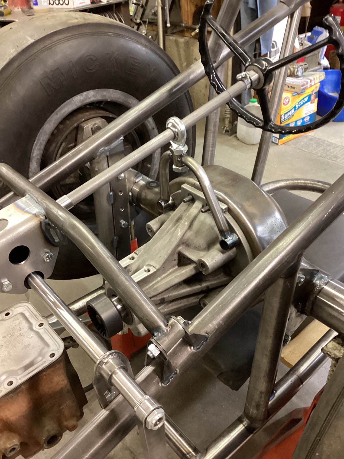

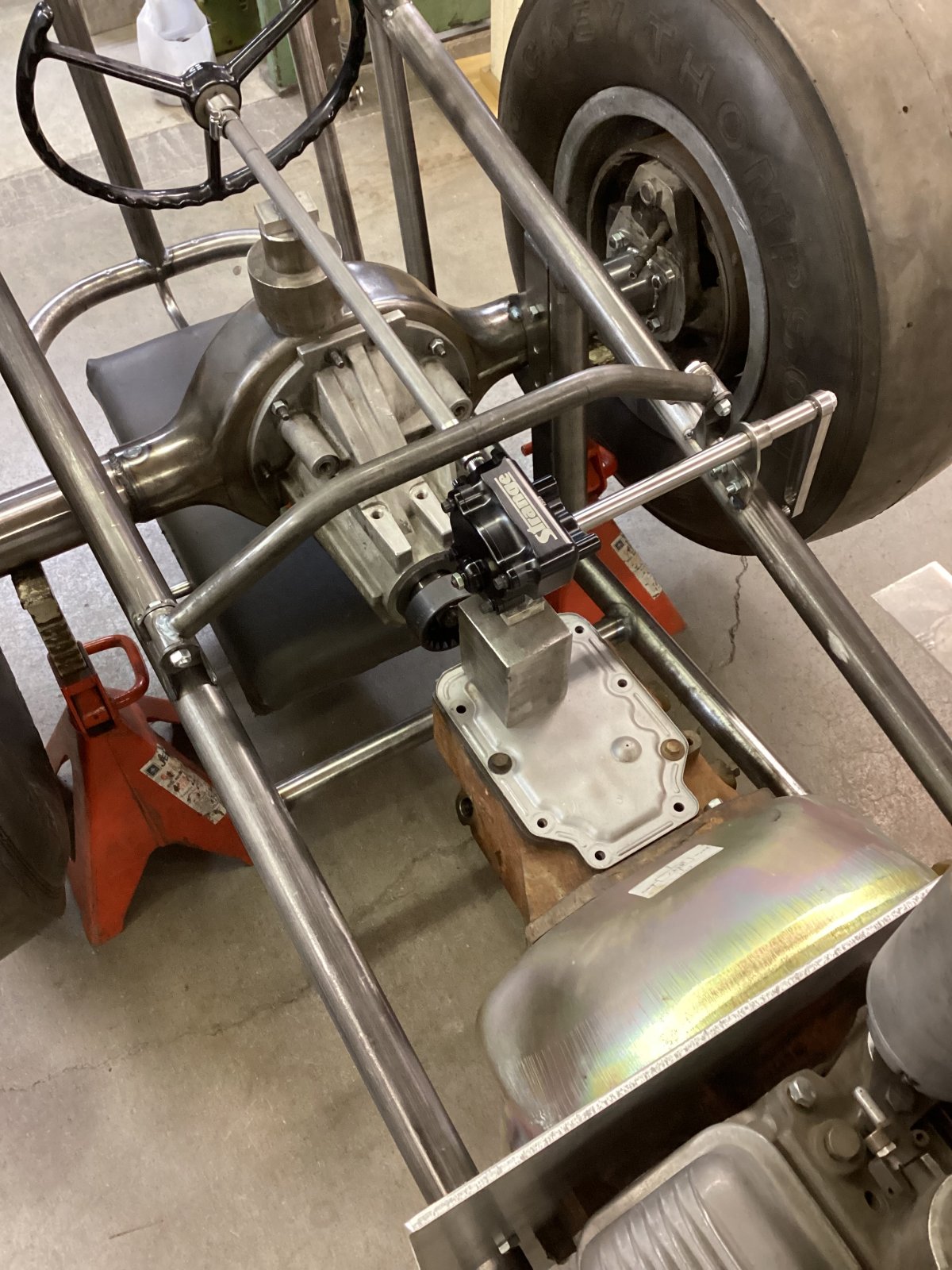

    Today, I got the steering shaft support, fit and tacked together. Mounting the brake master cylinder is next. IMG_0613.jpg IMG_0614.jpg IMG_0615.jpg IMG_0616.jpg
