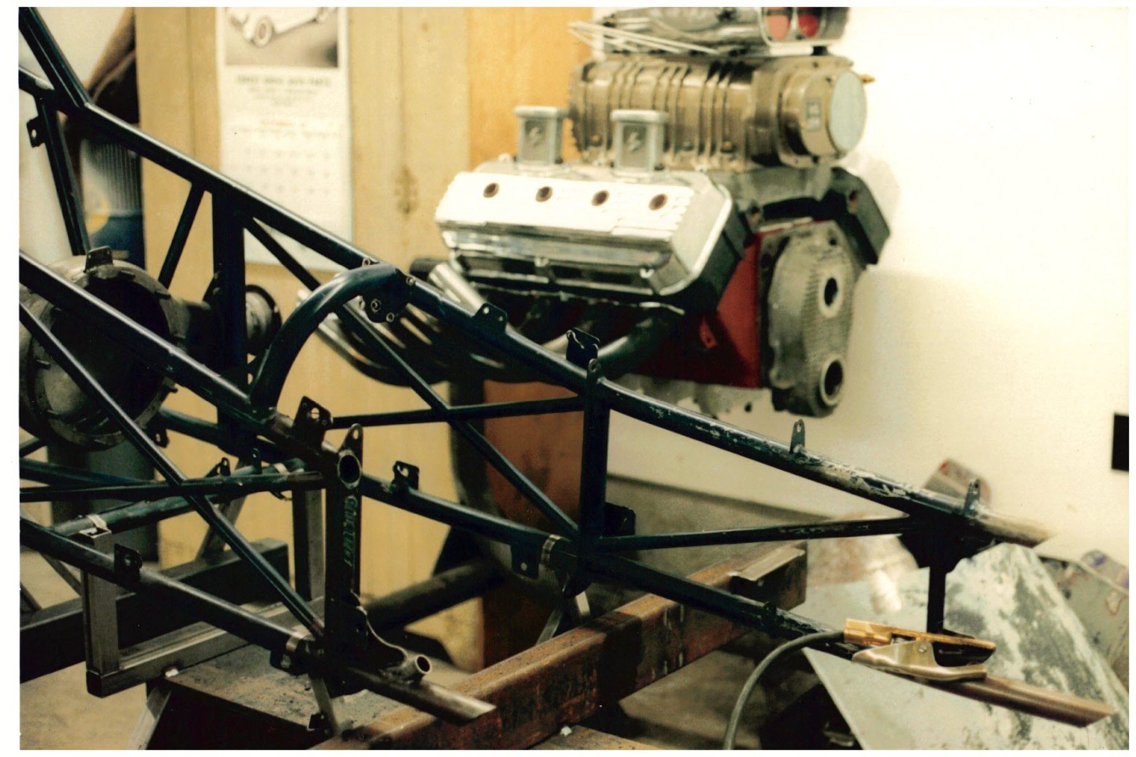

    Got a little done today, the steering support welded, polished the lips on the front wheels and tacked up a set of pipes. I had a crummy set of flanges, and tacked on some 4" stubs, so Chris will have something to fit the openings at pipe exit. The real headers will come later, and will probably be 2 sets, one with collectors for mufflers at Portland International Raceway on Wed nights. IMG_0619.jpg IMG_0620.jpg IMG_0618.jpg IMG_0622.jpg

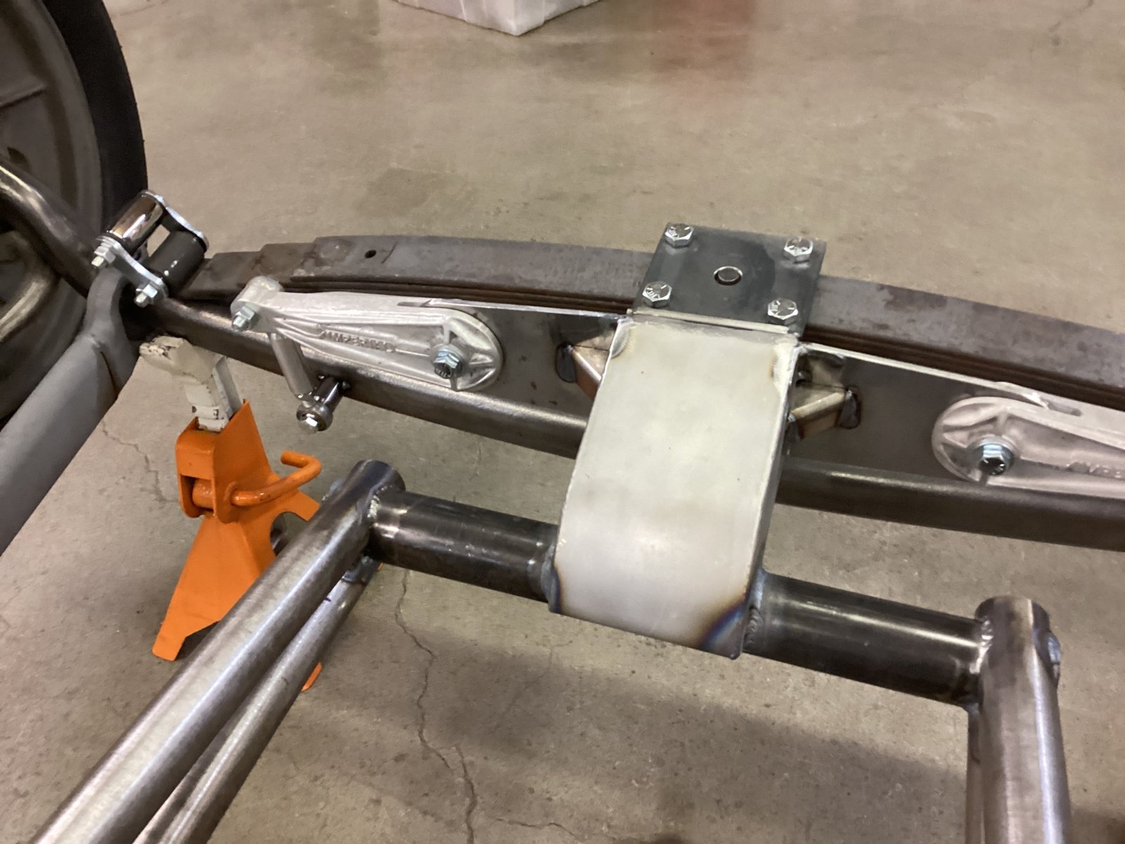

    Yesterday I drilled the blank friction shock castings, and today I got the plates tacked on. The next thing will be machining a couple links and some threaded bosses to weld to the axle and add some gussets. I have had these castings for 14 years, since I was building some HAMB Dragsters, and they finally found their place. IMG_0625.jpg IMG_0626.jpg IMG_0627.jpg

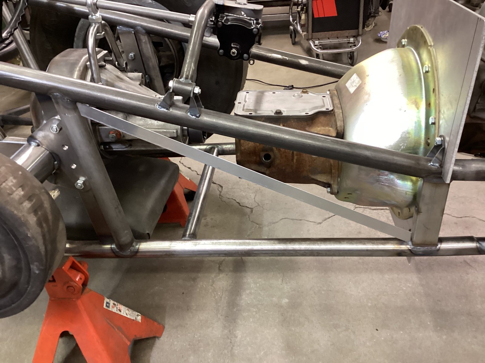

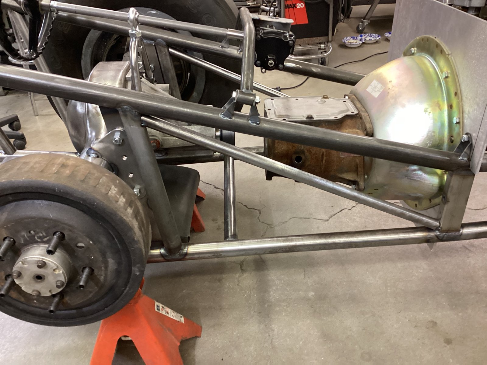

    Since my last post, I machined some shock links and bosses to weld to the axle. Today, I added some gussets to the shock plates, and fit the diagonal tubes in the motor plate area. IMG_0633.jpg IMG_0636.jpg IMG_0637.jpg IMG_0639.jpg

    I cut those wedges out of 1” .120 wall square tube, and will fully weld them. They are just to add a little support, and realistically probably aren’t needed as the friction shocks won’t have very much drag.

    Curious what determined the position of the friction shocks outer links (distance from centerline of car)? Was it the ends of the top leaf spring? Or just what looked aesthetically pleasing and what would probably have enough control (leverage) on the front axle?
  11. Marty Strode
    Joined: Apr 28, 2011
    Posts: 9,710
    Marty Strode
    If you look at the pictures of the original car, these links are very close to the distance outboard of the nose section of the body, or where the body will be.

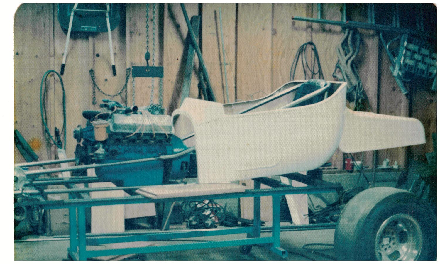

    Thank you, I have always had so much respect for Machinists, and still have problems even spelling the word. I have a pretty good selection of machines, but mostly can make things flat and round. My fabrication has been a long road, starting with my first roadster in '64, that would be laughable today, but I was 16 and only had an oxy/acetylene outfit, a borrowed arc welder and disc grinder. My brothers and I started building "water pumper" Dune Buggies in the late 60's, that graduated to Sand Dragsters and Funny Cars. I built my first more serious drag roadster about 50 years ago, and since have been collecting equipment for all aspects of fabrication, and learning as I go. It has been a fun journey, and I have been around some real craftsmen, hoping some of their skills would rub off on me. Thanks to all who take the time to view my threads ! 2012-07-19 105309.jpg 2012-12-15 150143.jpg 2012-08-22 111154.jpg 2012-08-22 110155.jpg
