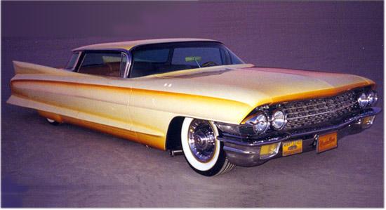

    Maybe you can sink the glass into the car so you don't have to cut the glass heres a pic of gene winfields caddy as an example.

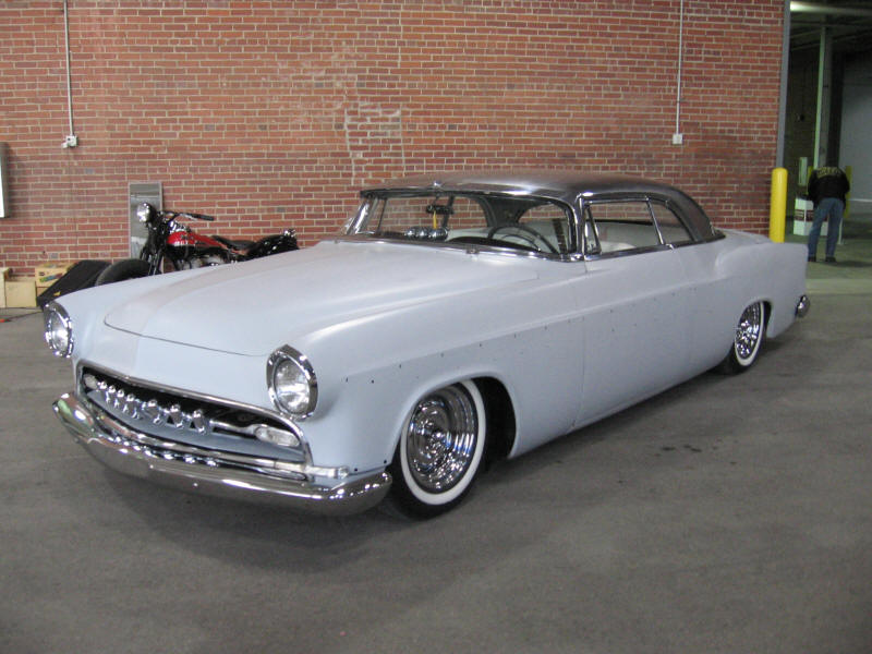

    That"s what a friend of mine did with his car - turned out great

    more pict of that desoto please!!!!
