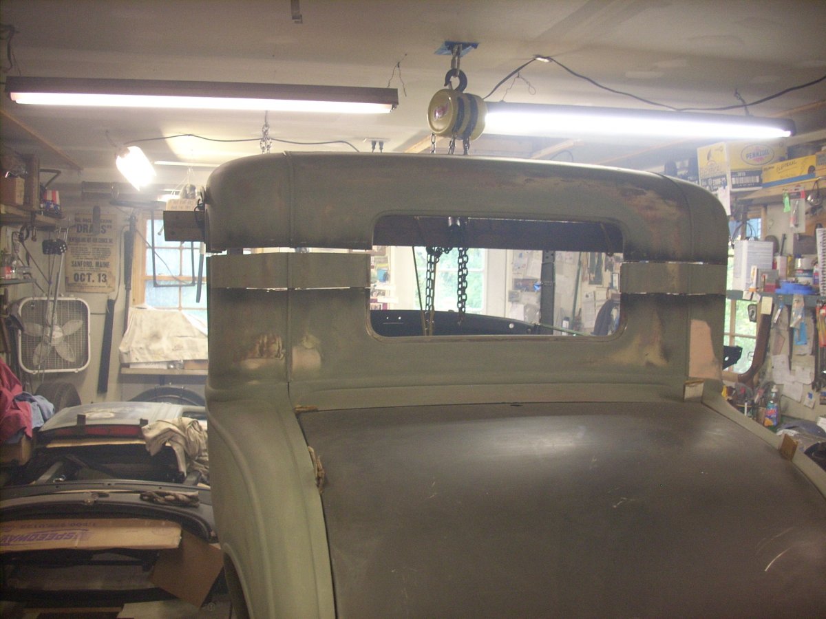

    I cut through everything, then fit , glue and peg wood back together. I always make initial cuts ( through the sheetmetal) with a 4.5" angle grinder with a thin kerf metal cut off disc. Finish cuts through wood with a sawzall with a fine tooth METAL blade. All while keeping pressure UP from the cuts to avoid binding. Nothing worse than a sawzall binding up- big mess real quick. I do 'em by myself so I can concentrate and use the appropriate language without offending anyone. A chain fall and a piece of 2x4 and bingo. Silent partner.
    When you start to weld it back together, go slow and just tack things- I start at the cowl post and work my way around. You may have to put relief cuts in the top section in the rear corners depending on how much of a chop you do. And pie cut the areas around the windows so the posts marry nicely ( top will be bigger than the bottom)
    Pics of a 3" chop- the right amount I think to keep it from looking squashed ( although a 5" chop looks pretty freakin' COOL!)
    You CAN do it! Good luck!

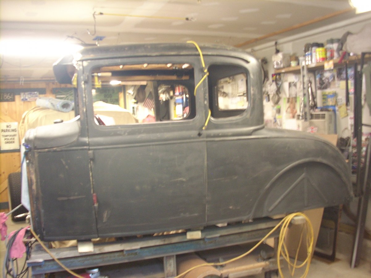

    Here's a shot at the p***enger side. After the chop. The two holes are where the screws were. Let me know if you need any more.

    Bracing;
    "X" brace at the B pillars, and a brace from the cowl back to that to keep door openings from moving.
    I use re-rod ( concrete reinforcing rod) 5/8" dia. from Home Depot for bracing- 10 ft. for $6 bucks. Easy to cut, and welds up nice and easy.
    Take your time, and keep tacking till everything's lined up. Watch for heat buildup if you're using a Mig- a little tap on the trigger and move around. Good exercise! (Stay hydrated, but not TOO hydrated!)
    Pic isn't too clear- hard shot to get it all in.
