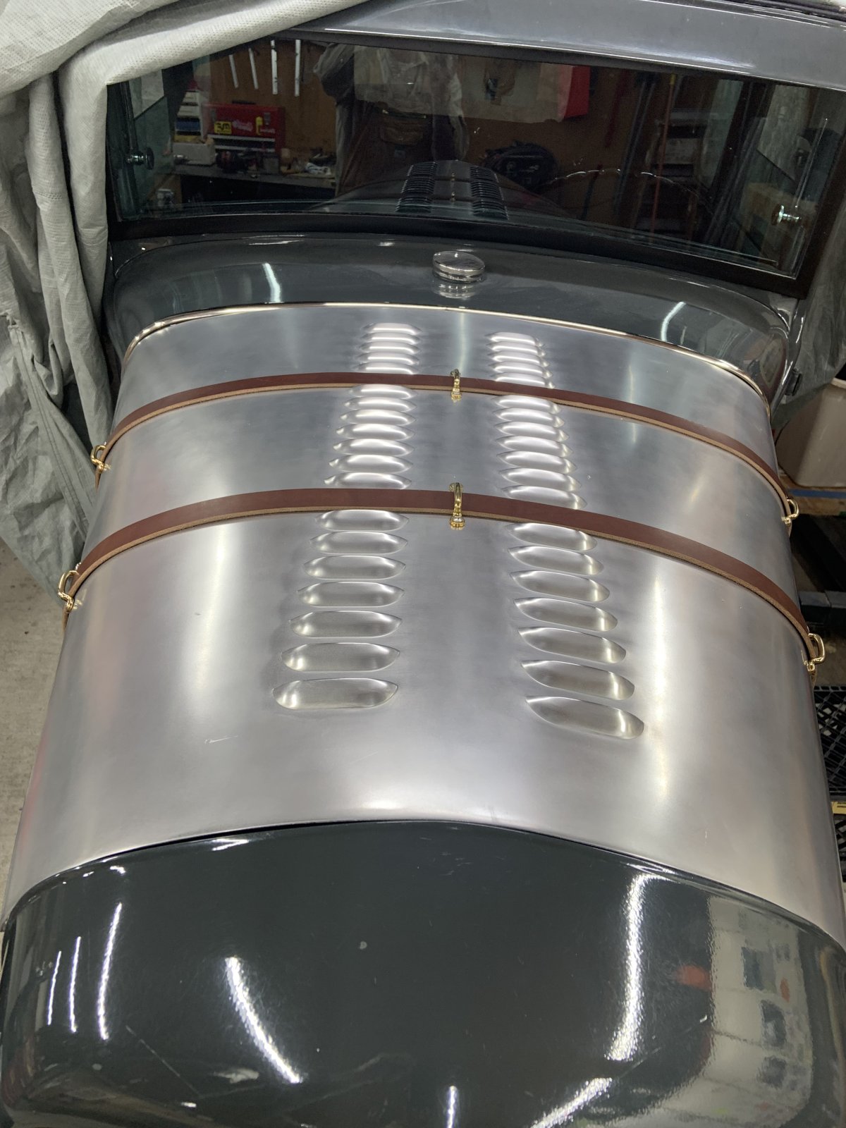

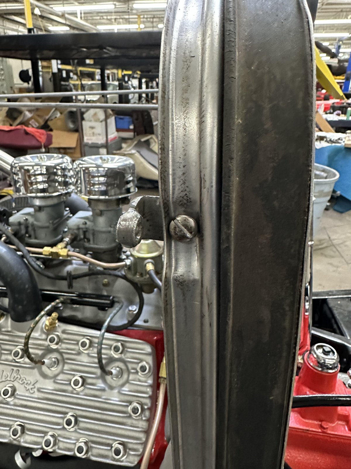

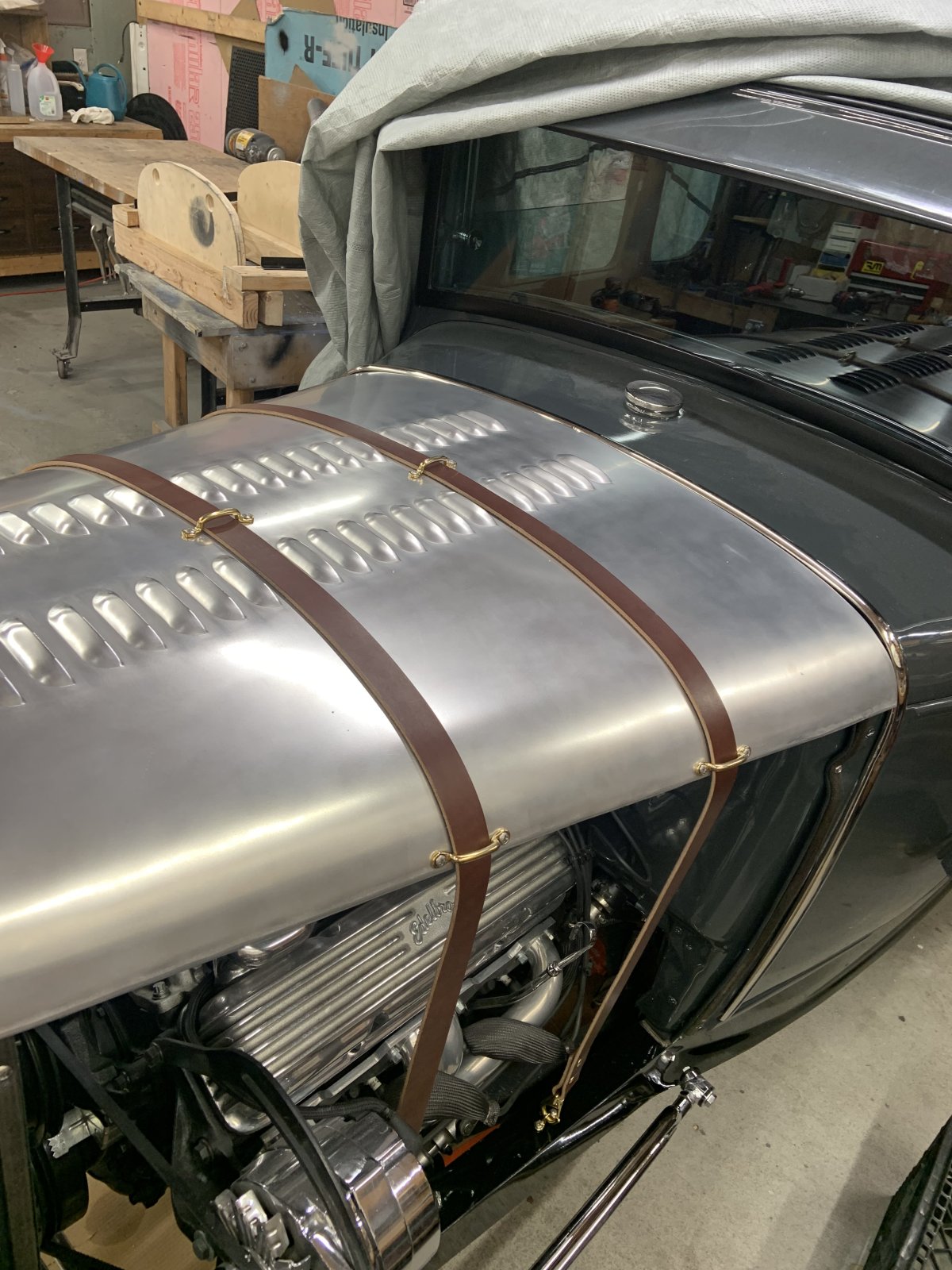

  6. BJR
    Joined: Mar 11, 2005
    Posts: 11,684
    BJR

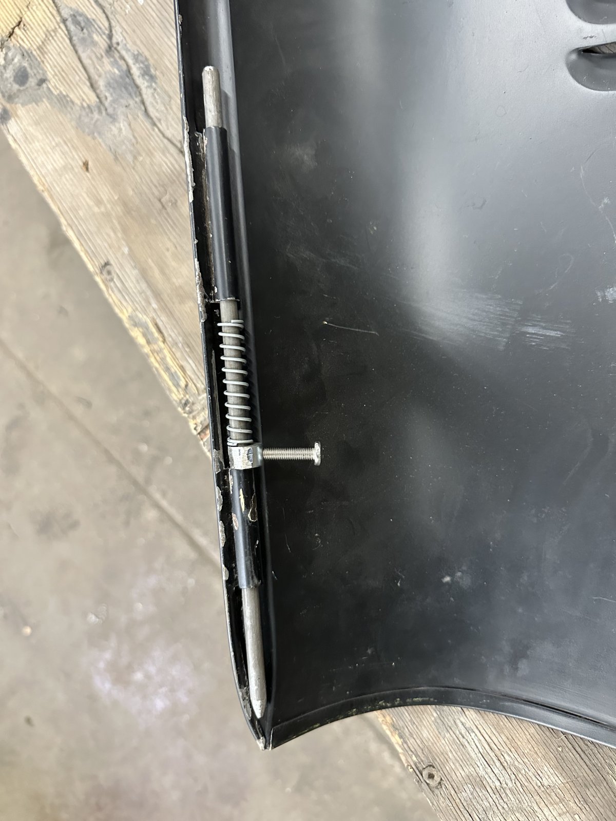

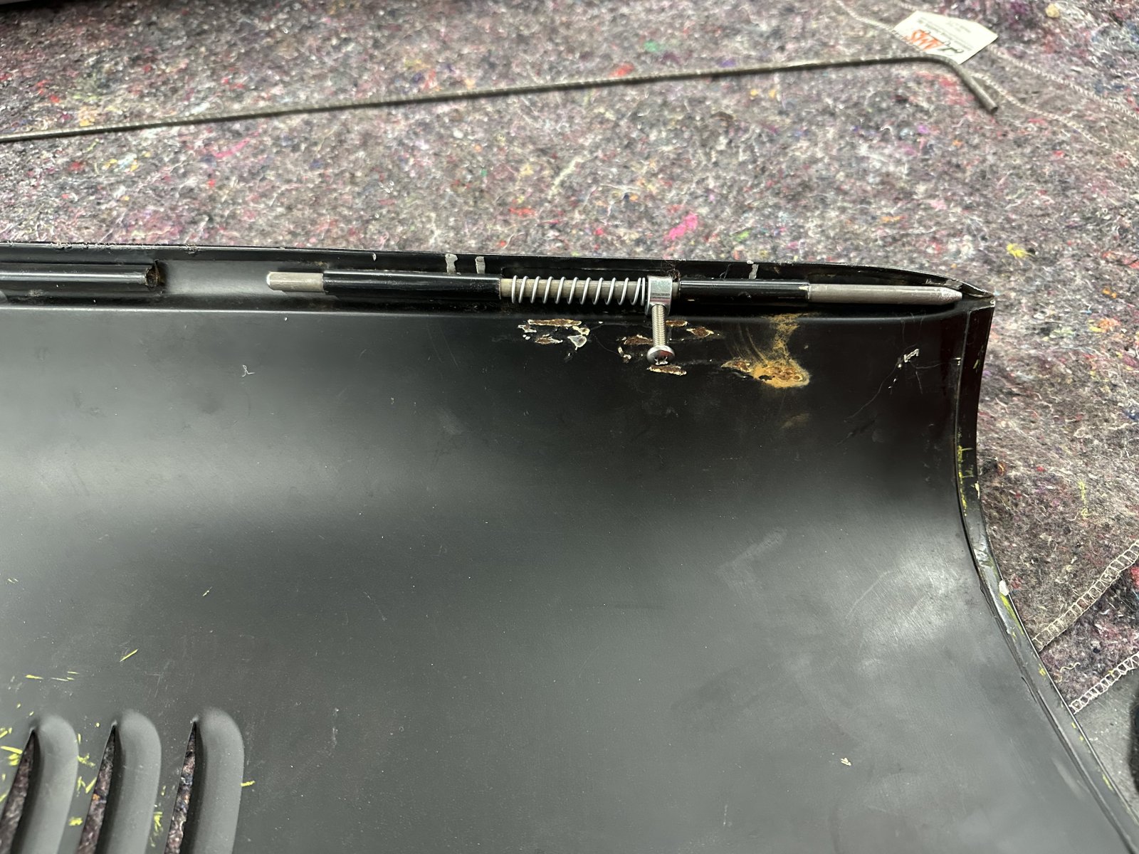

    Here is how I held down a 2 piece hood top on a 32 Roadster I am building at work. IMG_2101.jpeg IMG_2102.jpeg IMG_2059.jpeg IMG_2151.jpeg

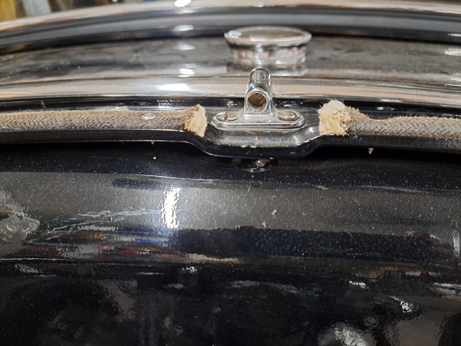

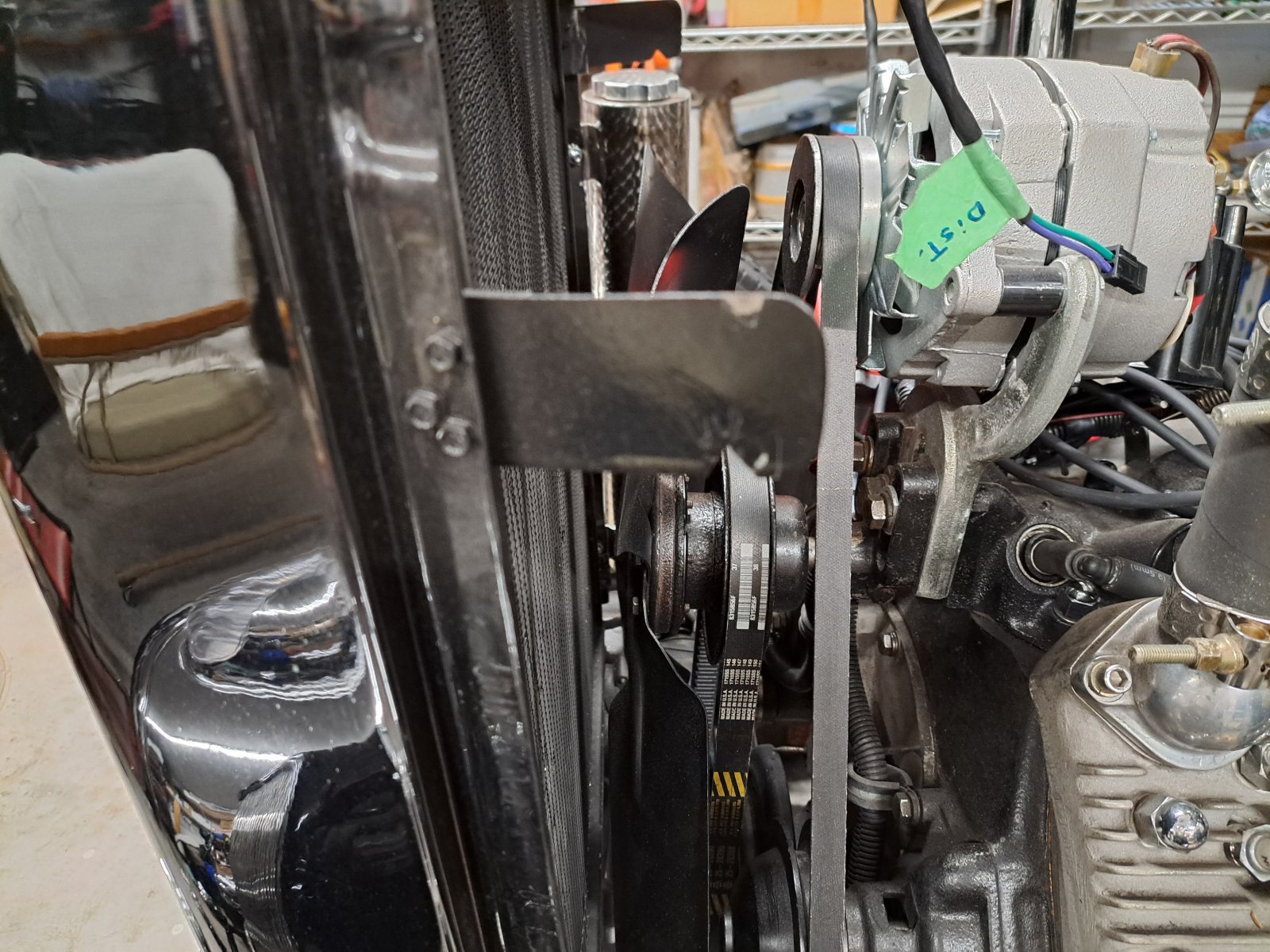

    I have a center hold down on my 31 A roadster with the stock hold downs on the front of the hood to lock it on. It is a 32 hood modified to fit the A. The last pic shows it mounted. Simple to do.

  16. GordonC
    Joined: Mar 6, 2006
    Posts: 3,491
    GordonC
    I should have also mentioned I welded a piece of rod to the center of the hood to go into that receiver on the cowl.

  18. Dino 64
    Joined: Jul 13, 2012
    Posts: 2,540
    Dino 64
    from Virginia

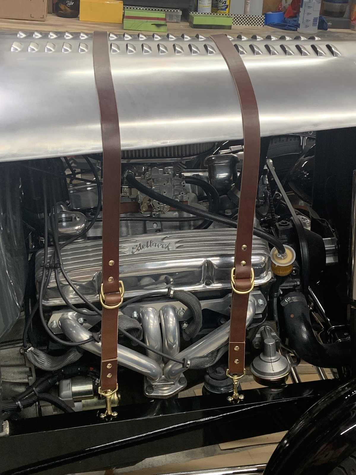

    Did it with bridle straps of leather, the double D buckle for keeping it tight IMG_6918.jpeg IMG_6907.jpeg

    If I understand you, there is no hinge. If you’re more specific I’d be happy to take some pics for you ;)
