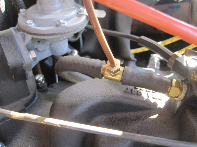

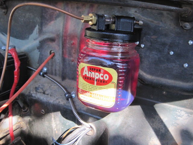

    I've got one on the 8ba in my '39 p/u. Bought it off that auction site. It came with everything including a T filling to allow me to tap into the PCV hose from the carb. Don't know if its a have to have by with today's gas I figure it can't hurt. IMG_3368.JPG IMG_3368.JPG IMG_3369.JPG IMG_3370.JPG IMG_3371.JPG
