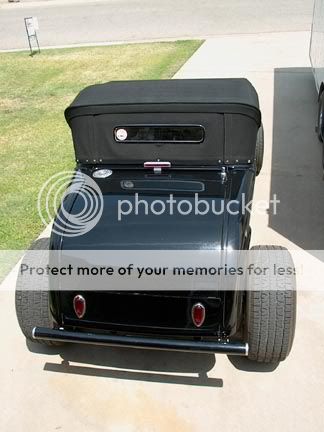

    So.... Now that I have a cover that I cant see behind me. Whats everyone doing for the rear window?
  8. I used the top from Speedway, called the Kwik top, it is supposed to fold but it looked like **** in it's original configuration so I re chopped it and made it a fixed top.
    What I like it it has irons instead of conduit or tubing whatever the bop tops are made of and when you look inside it looks like it would fold down, basicly like using original top irons and chopping them, most of those tops in the day didn't fold anymore once they were chopped and had the "Look"
    I am real happy and have less than half of an after market top and it doesn't look like hundreds of others.

  10. Hey Mike, I just wanted to different again. My girl friend makes boat tops so the back window material was avalible and way cheaper than one of those fancy rear windows in the frame:D.
    This was the first top we did and I'm real happy with it. Now if I can the Merc caps on the car I got from you it will be perfect.!

  12. fergenboysinc
    Joined: Nov 26, 2006
    Posts: 1,025
    fergenboysinc
    Thats a cool top! I probably should just "buy" the speedway window but...I have more time than money! So...here is the rear window-thingy that I have been messing with. Any advise would be helpfull.:D
  13. fergenboysinc
    Posts: 1,025
    fergenboysinc
    whoops, forgot the outside. The inside kinda looks like a jail cell window. :D It just needs some bars. NOT that I would know.:rolleyes:

    Hate to be rude, but that looks awfully like a copy of the Kwiktop. I just fitted one to a car.
  15. vintagehotrods
    Joined: Nov 16, 2002
    Posts: 2,705
    vintagehotrods
    Except he didn't have one to copy and it was made from scratch in his own garage. I know because I've seen it.
