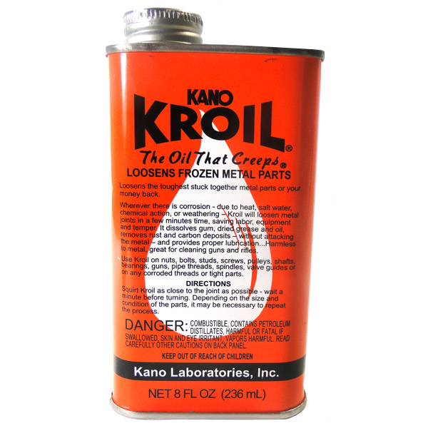

    My "go to" is Kroil. If that doesn't work then it is the hot wrench.

    Methyl Salicylate. That's the same stuff that gives Marvel's Mystery Oil the odor it has, it is a very good penetrating oil. Mixed with light solvents, that's how it frees gummed up or varnished rings and lifters and valve stems.
    I can't understand why Kano/Kroil is only available mail order? They should maybe make it easier for people to give them their money?

    Local motion and flow ( Parker store ) sells it here in meridian ID..
    Stuff is not cheap...
    Worth every penny !

    As a toolmaker for 30 years we had to deal with broken bolts and such. Some good tips Mart and love your videos.
    These days I use Kroil and was turned on by my buddy Jerry. He brought me a car of Kano Kroil and Silkroil and was very skeptical. Wow crazy how well this works and threw away my PB blaster and ordered a few more cans of Kroil. This stuff is amazing
