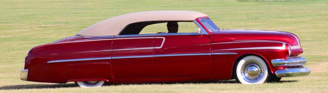

    Cut the roof down and build a new top Carson style but not removable. Frame with strips of steel, cover with padding and vinyl or canvas top. Like a 1951 Frazer convertible or fifties custom.
    If you do this brace the hell out of the body before you cut the top. If you make a permanent welded top you can cut the braces out when you are done.
    This would be a lot easier than trying to hammer weld and metal finish a roof, or adapt a roof off another car. Plus they look really cool.
    upload_2025-4-6_13-1-2.jpeg upload_2025-4-6_13-1-26.jpeg upload_2025-4-6_13-1-53.jpeg
