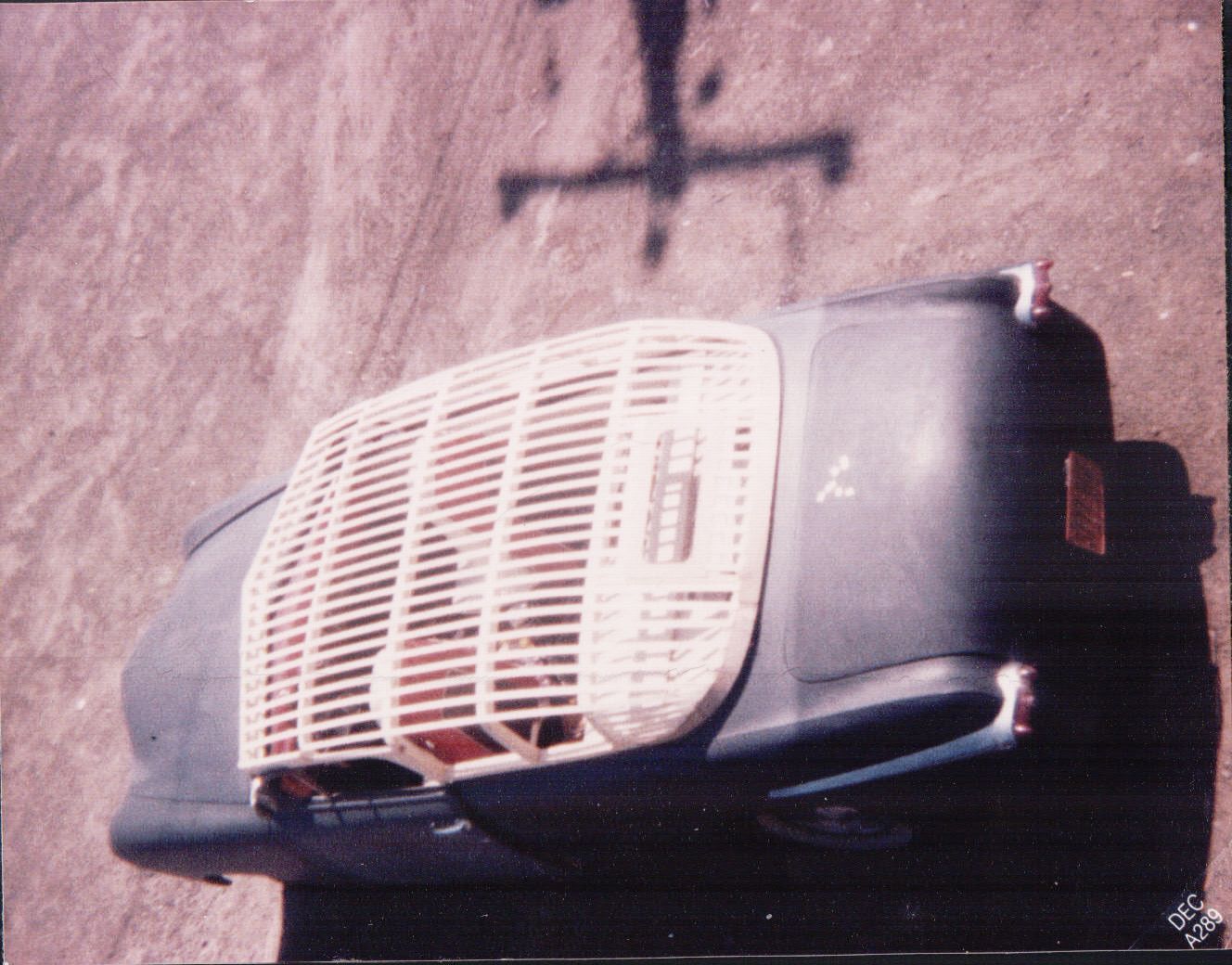

    Early Rambler convertibles were made this way. They were one of the first unit construction cars (no frame) and this style of top required little or no reinforcement of the body.

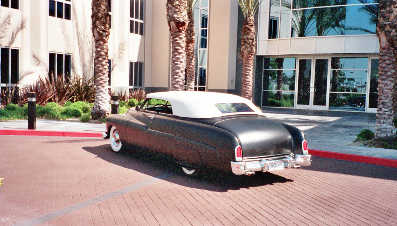

    from Minn. uSA

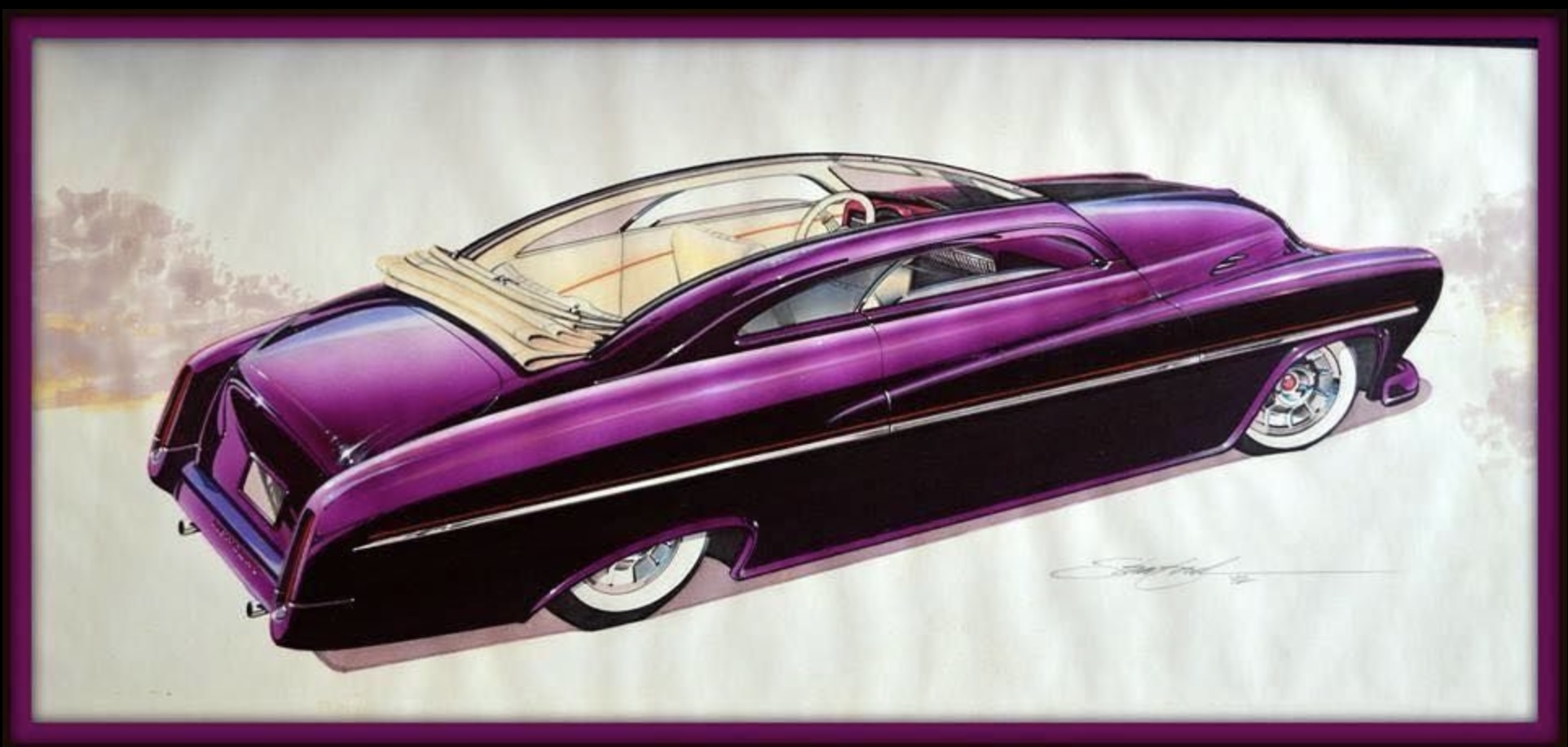

    If you want to do a sliding rag roof("M-400 "type, like the pic of the Sunshine Sedan Merc), you can use a sliding top from an acvw bug, or better, the Samba. They are repoped, nicely done. The same original company did some for a few almost-1-offs, like the Stude Lark, a**** others. Don't remember the name of it, or the current co that does them. There are a couple that differ in build quality & looks, too. Can end up looking factory-done, if you do a proper job on it.

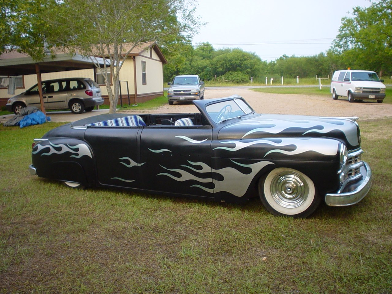

    Back in the '80s I bought this old drag car '51 Ford because it was cheap ($250). Didn't know what I wanted to do with it...but one drunken night (and a sawzall), cut the roof off.
    Reinforced the frame (3/8" plate), built a buck and made a fibergl*** roof. Threw in a 289/C4, some other custom touches and drove the wheels off it. Didn't have $1,500 in the whole thing.
  6. You should do it, you'll need to reinforce the door pillars , use square tubing and then build a bulkhead that runs behind the front seat and ties the driver and p***engers sides together and weld the bottom of that to the floor I've done it on my 51 Merc 4dr chopped top made into a convertible you can see it on the red merc 4 dr convert above.

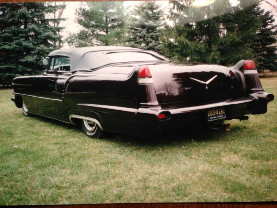

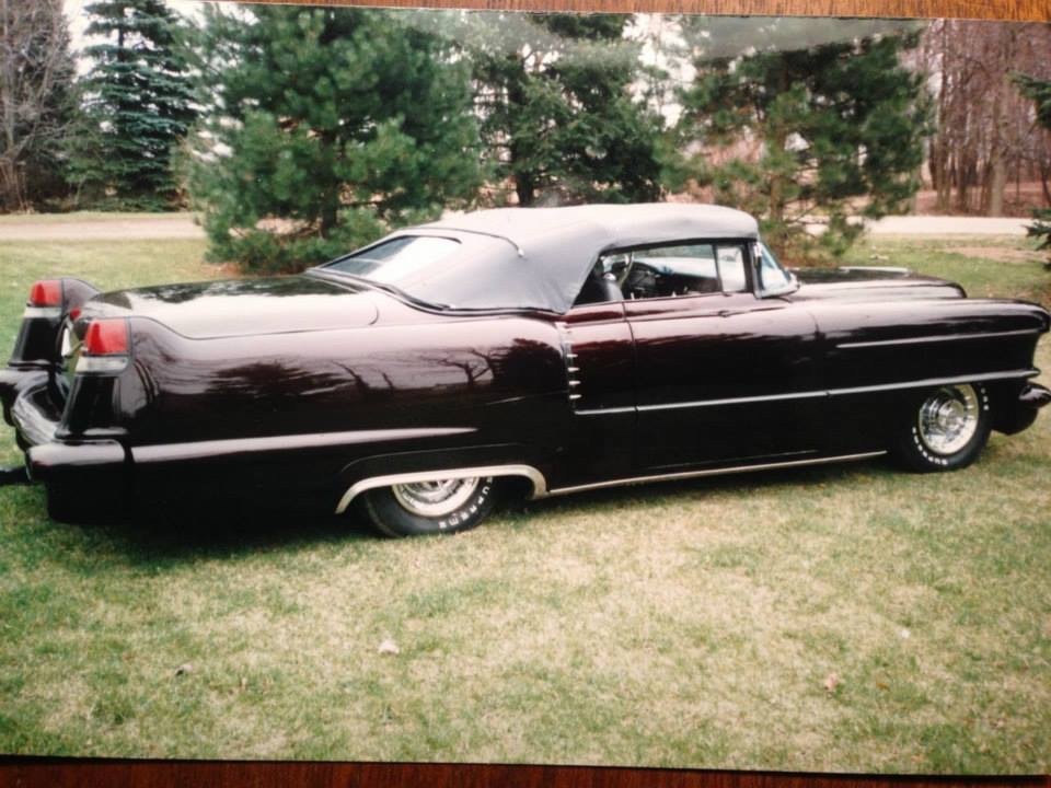

    I did that with my '56 Caddy, different car but, you get the idea. 9C64D119-468B-4661-86DE-5A17ED6FF2F0_1_105_c.jpeg 593C9E40-E1DE-47E6-9775-ECFF126C733B_1_105_c.jpeg

    Factory, the car was a 4 door hardtop. I cut the roof off, shortened it 16" behind the front seat, took the rear doors apart, welded the inner to the center post and rear door jamb, then used the remaining part of the skin to fill the gap in outer skin. The top irons are shortened '69 Catalina convert, the windshield chopped 4". The car still exists today, exactly the way my photos here from the late 80's.

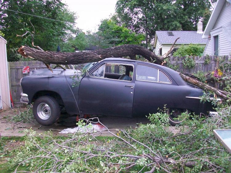

  14. I’d fix that beater.
    chop it while your at it.
  15. tubman
    Joined: May 16, 2007
    Posts: 8,679
    tubman
    I wouldn't drive it.:D
  16. I would.
    Look at old body repair books. **** like this got fixed.
    First rollover I fived all we bought was trim and gl***.
    Got nothing to lose but time
    Okie Pete likes this.

    Post clear pics on the photoshop thread and see what the guys come up with it.
