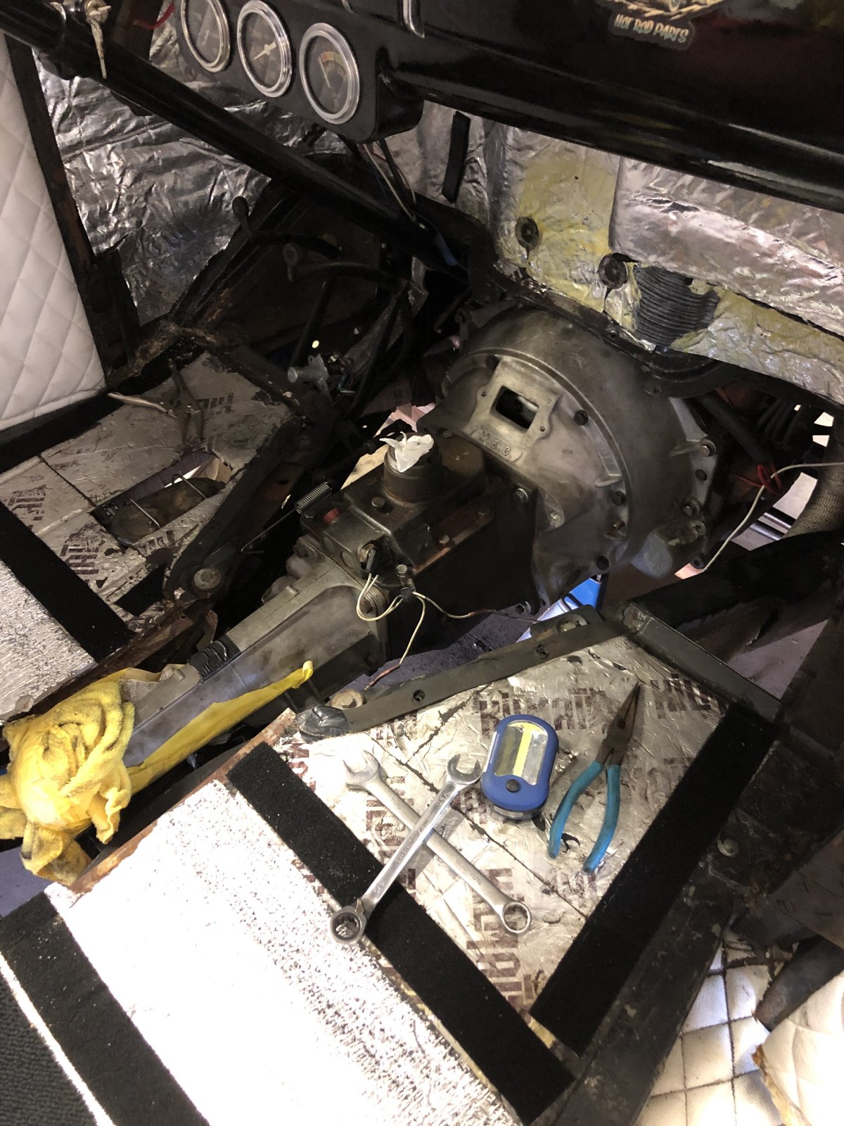

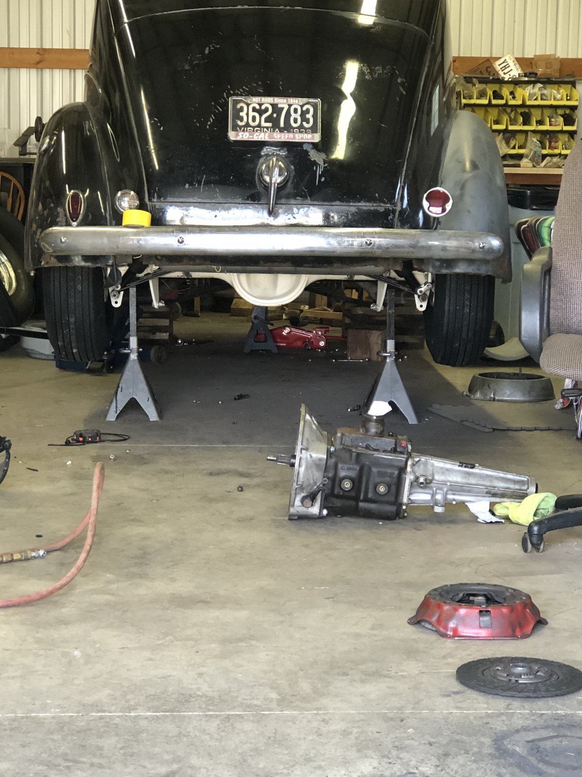

    The later is much stronger. I swapped my 39 3 speed for a 3.03 ford top loader 3 speed with a Jeep shifter conversion and I beat on it pretty good. Plus it’s fully synchronized. 80B075DE-4110-4F53-8D08-9B17F25E4C0E.jpeg E61AC052-DC0B-45C8-90C4-C33DF6E7E0C4.jpeg
