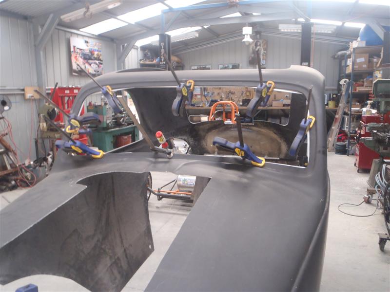

    All tips and advice greatly appreciated guys. Here are a few pics of window frame and firewall fabrication. Glen PC300003 (Medium).JPG PC300005 (Medium).JPG PC300006 (Medium).JPG PC310008 (Medium).JPG P1060017 (Medium).JPG P1060019 (Medium).JPG P1060006 (Medium).JPG P1060005 (Medium).JPG P1060004 (Medium).JPG P1060007 (Medium).JPG P1060013 (Medium).JPG P1060015 (Medium).JPG P1060021 (Medium).JPG

  11. rooman
    Joined: Sep 20, 2006
    Posts: 4,045
    rooman
    Is there a specific reason (apart from having somewhere to hang the firewall) that you framed the window opening? I usually just screw the window to the fibergl***. In your case I would have put it on the outside due to the rebate but the last couple of Fiats that I have done did not have a rebate so I just put the polycarb in from the inside with countersunk screws and tinnerman washers on the outer surface. To mount the tin I lay up a fibergl*** flange in the appropriate location.

  12. grdra1
    Joined: May 20, 2013
    Posts: 689
    grdra1
    Main reason was Ive been told that fibregl*** can bow in centre at top at high speed. I wanted to have support in this area, also as you said a place to mount firewall. Thanks for advice and pics, I would love to see more pics of topolinos you have built - mainly tinwork as Im up to this part of build. Again thanks to all replies and advice as Im a novice / self taught in most fabrication areas of car building. Also Graham and Tim I love your threads, I first started out with a angle grinder and drill and ark welder - its amazing what you can achieve with these tools and will / imagination. Now I have a lathe, mill / drill, tig welder ( self taught in the use of these items with help fron internet and guys on forums like this ). Glen
  13. rooman
    Posts: 4,045
    rooman
    Glen,
    send me your e mail address and I will send you what I have on topo tin.
    As for the bowing at speed the Fiat body usually has enough radius adjacent to the opening that it will not bow unless it is excessively thin in that area. I did notice that your body does not have a return around the top opening like the the ones that I have been using so your aluminum will help there.

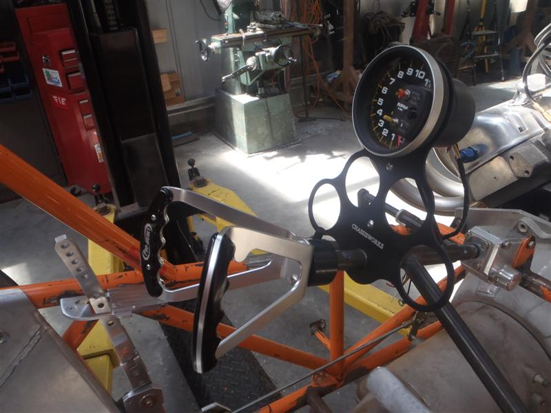

    Brought a Ch***is works gauge facia of ebay a while back, decided to make a steering coloum support and mount gauge facia to it ( I did not like the idea of an unsuported steering shaft anyway ). Pics tell the story. Glen PC010008 (Medium).JPG PC010013 (Medium).JPG PC020017 (Medium).JPG PC020016 (Medium).JPG PC090064 (Medium).JPG PC090066 (Medium).JPG

  18. mad mikey
    Joined: Dec 22, 2013
    Posts: 9,505
    mad mikey
    Great idea with the gauge panel, highly visible as well as functional. I like it !!!!
  19. Kenneth S
    Joined: Dec 15, 2007
    Posts: 1,526
    Kenneth S
    Good idea supporting the steering.

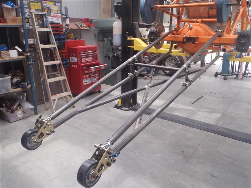

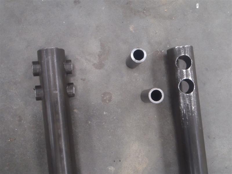

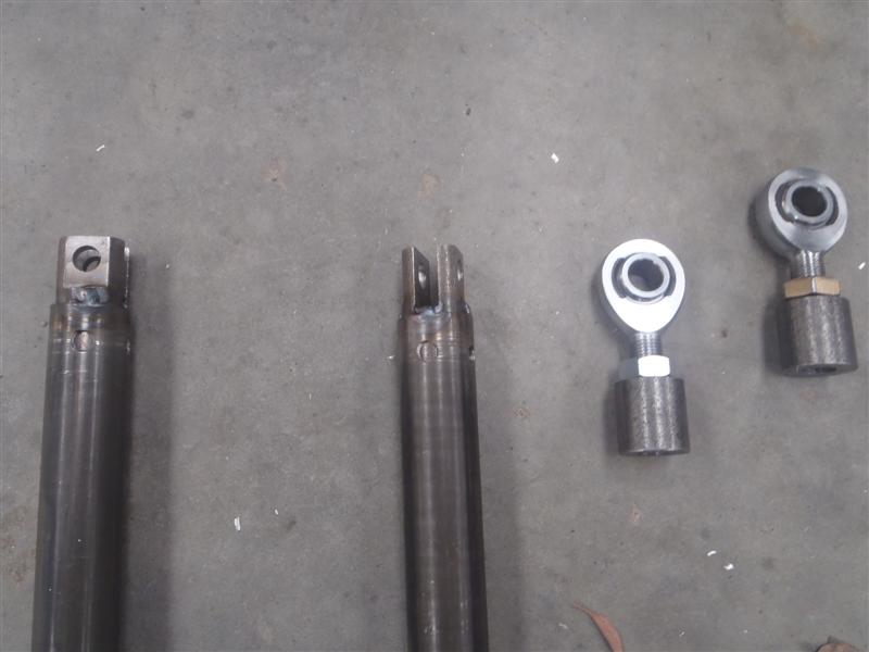

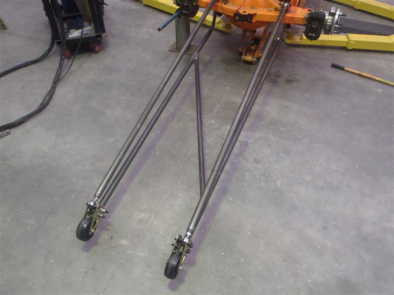

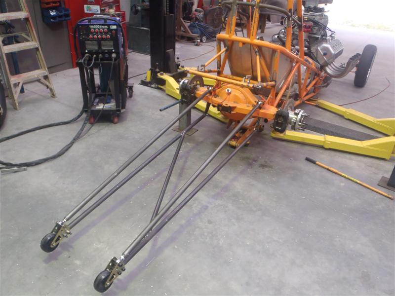

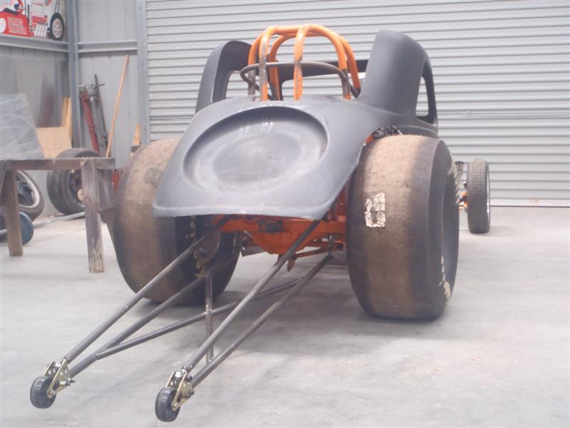

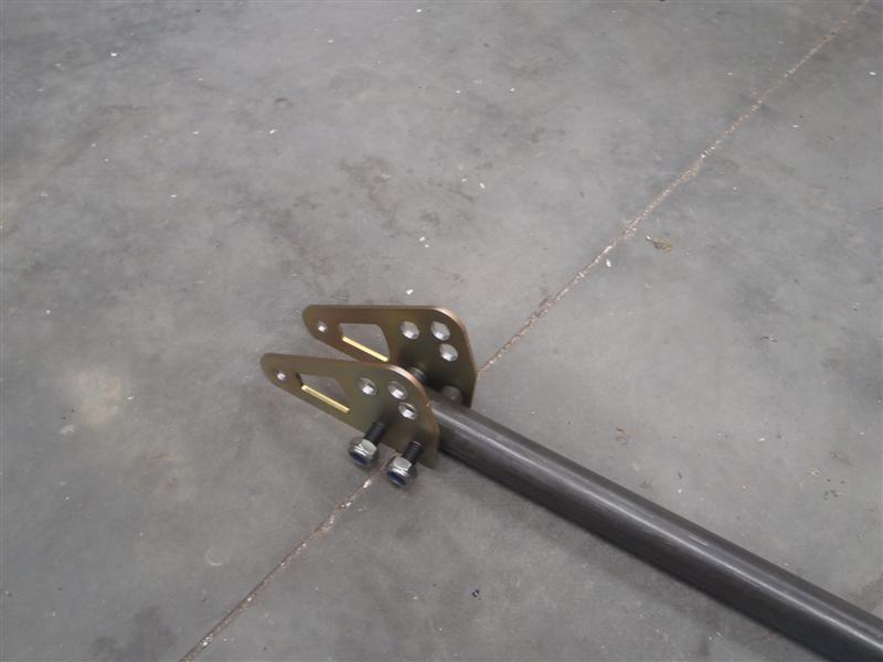

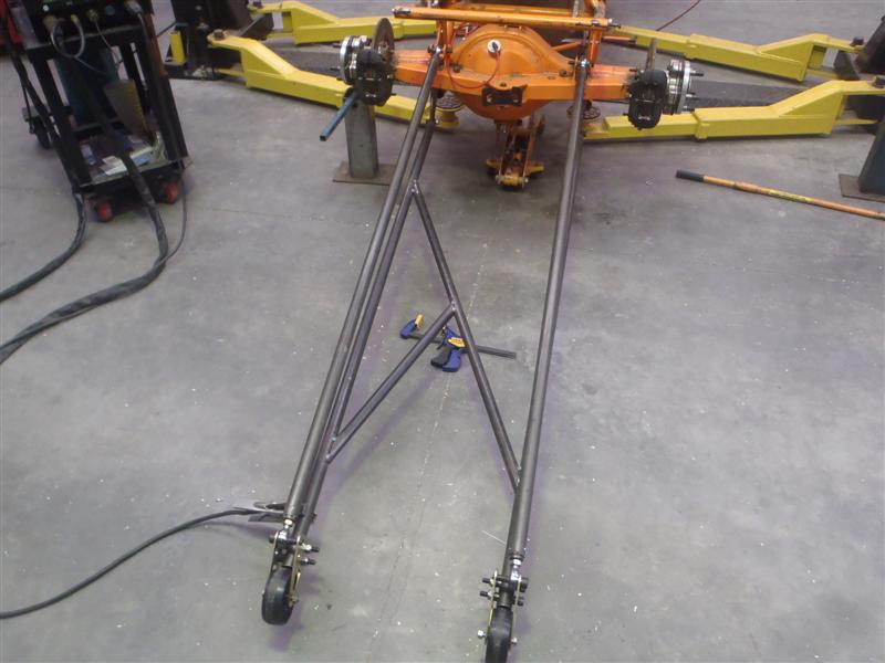

    These are the second set of wheelie bars Ive built, as first ones were to short (period correct though). Been told these will be safer, and i also think they look aswsome, also notice the chute launcher. Glen PC050022 (Medium).JPG PC050023 (Medium).JPG PC050024 (Medium).JPG PC050020 (Medium).JPG PC050019 (Medium).JPG PC050021 (Medium).JPG PC060031 (Medium).JPG PC080050 (Medium).JPG PC180081 (Medium).JPG P2060048 (Medium).JPG
    volvobrynk, loudbang and 9sectruck like this.

  23. dreracecar
    Joined: Aug 27, 2009
    Posts: 3,476
    dreracecar
    from so-cal
    On your next set of bars, try and get the "X" brace ends closer to the ends of the lower strut as this helps when dealing with the shrinkage from welding and right now the wheel mount has leverage against where the brace ends and would be the starting point for either it bending or breaking if it hit hard enough, and if you bend the ends of the "X" brace first so that the tube has a direct intersection into the lower tube the heat affected zone by welding is also reduced
    At minimum, one should run a crossmember across the base of the rear part of the "X"(weld to the X tube and not the lower tube) and construct a "K" from the point of the wheel attachment mount to the center of the cross tube.

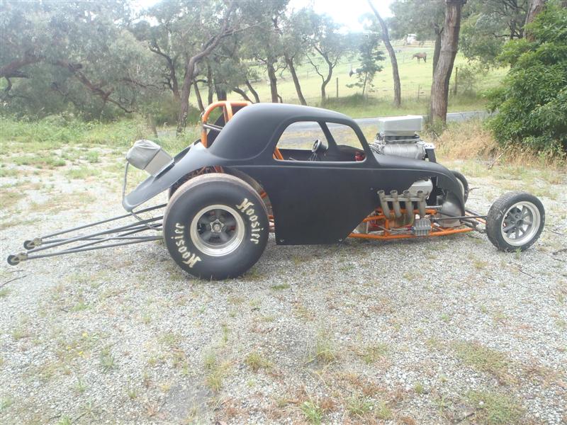

  28. grdra1
    Posts: 689
    grdra1

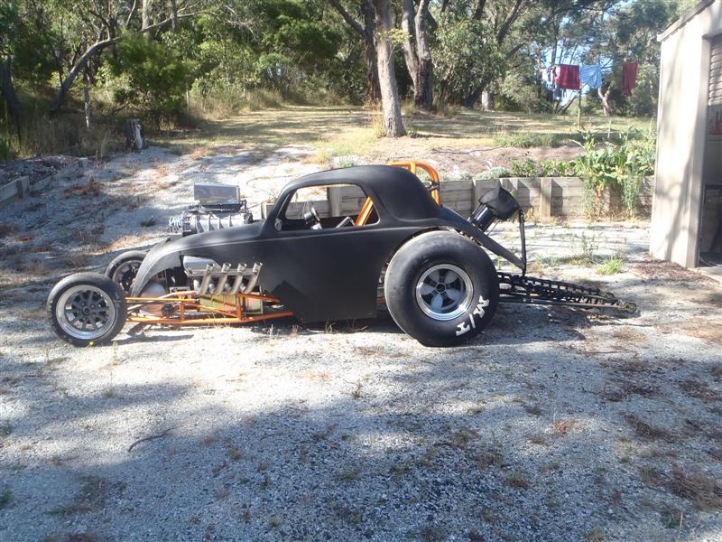

    Ch***is colour is as purchased, ch***is will be semi gloss black. Not sure on body yet possible some sort of dark red with lots of gold flek, early hot rod style. But lately lve been leaning towards leaving body just the way it is. Glen
  29. volvobrynk
    Joined: Jan 30, 2011
    Posts: 3,587
    volvobrynk
    from Denmark
    Despite being a nice color, wasn't there a rule back in the day, that you could race it ones or twice in primer and then it had to go to paint. And you had to wear clean coveralls, no dirty T-shirts or jeans, right?
