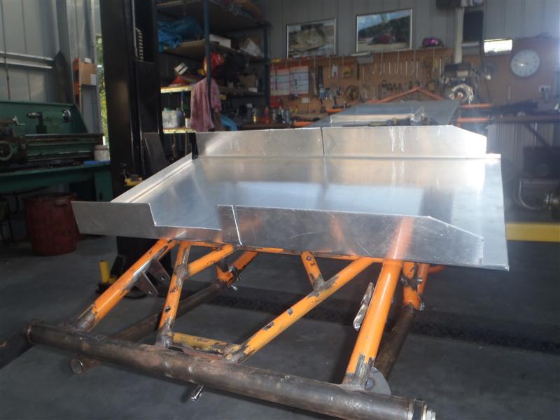

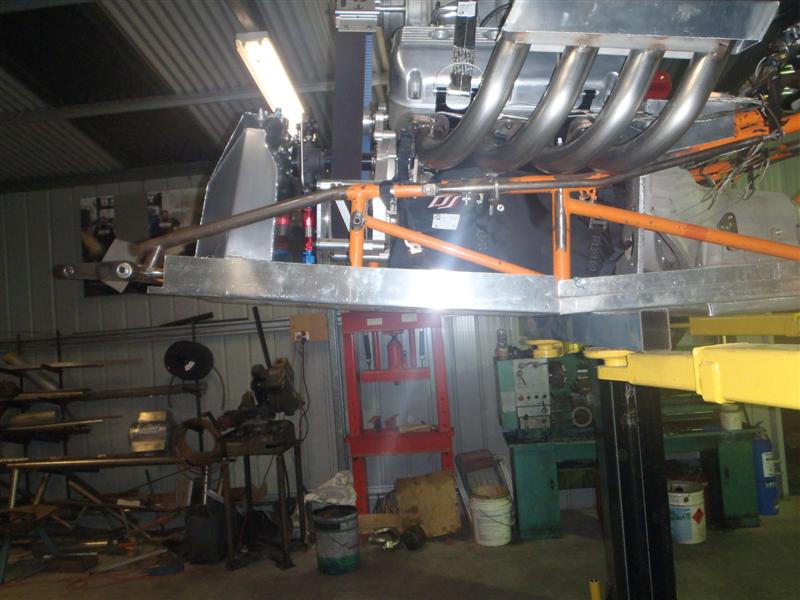

    Modified floor pan for altered today to suit deep pan of powerglide. I was thinking of making a full length floor pan to catch any fluids from engine / fuel tank etc. What do others think / currently use. My current floor runs from rear of engine back. Glen P6170225 (Medium).JPG P1010232 (Medium).JPG P1010238 (Medium).JPG

  9. Kenneth S
    Joined: Dec 15, 2007
    Posts: 1,526
    Kenneth S
    I would run a belly pan for the transmission also. Anything to help keep any fluids off the track, and from going under the tires.
  10. dragsled
    Joined: May 12, 2011
    Posts: 1,975
    dragsled
    from Panama IA
    I put one on my car also, Runs from the motor back, Helps for dropped bolts and nuts also
  11. grdra1
    Joined: May 20, 2013
    Posts: 732
    grdra1
    Never thought of dropped nuts and bolts etc, I will definatly extend current pan. Stay tuned for progress / pics. Thanks heaps, Glen

  16. dreracecar
    Joined: Aug 27, 2009
    Posts: 3,476
    dreracecar
    from so-cal
    If you feel the front get light its because air is lifting the front of the belly pan

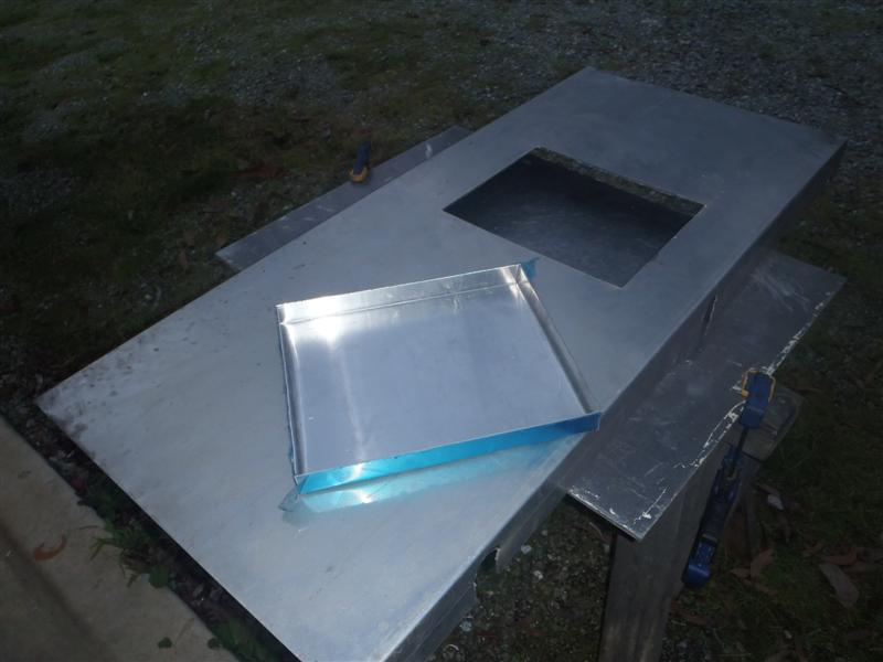

  23. grdra1
    Posts: 732
    grdra1
    A few pics of tin work recently fabricated. Glen P1010721 (Medium).JPG P1010623 - Copy (Medium).JPG P1010631 - Copy (Medium).JPG P1010635 - Copy (Medium).JPG P1010627 (Medium).JPG P1010716 (Medium).JPG P1010723 (Medium).JPG
