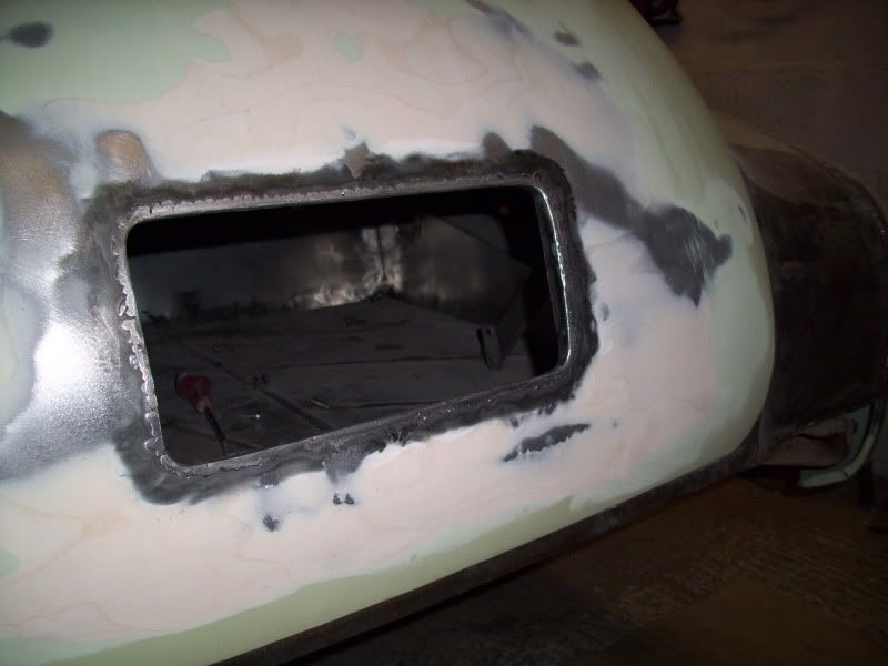

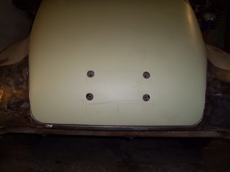

    <TABLE border=0 cellSpacing=2 cellPadding=2 width="100%" height="100%"><TBODY><TR><TD vAlign=top colSpan=3>A number plate behind gl*** was a very common modification for a custom in the forties, not quite sure of the legal implications in 2012 but I went for it anyway.
    To keep the height of the letters the official G.B. size, I had to make the opening a little taller then most of the examples I found in my research, but I think it looks fine.
    A fairly simple weekend sort of job, and for those interested in a little How-to, I've included a run of pictures so you can all laugh at my welding skills. [​IMG]

    Another 48 Poncho! I love it! Mine is a streamliner I am in the process of making into a mild custom. I am definitely steeling your license plate design. I was looking for a new way to mount my plate since I am not a fan of the HUGE stock mount.

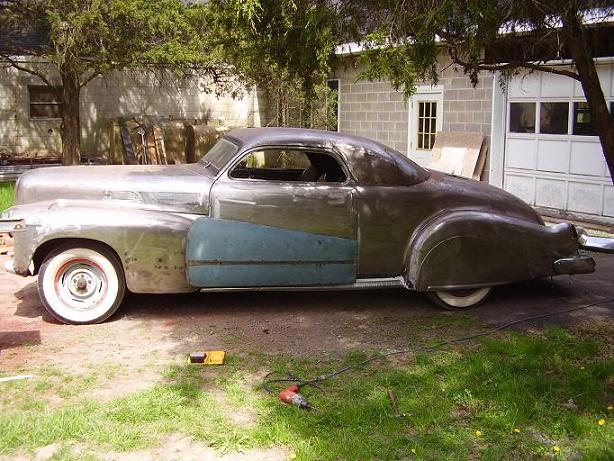

    incredible work,,,brings back fond memories of my 41 caddy kustom. I did fadeaways as well, but I used pieces from a buick for mine,,kinda makes me feel like a slacker after seeing your wonderful fabrication job :)..here are a couple of pics.....man, I miss that car. By the way,,,the headlight idea = genius...he should sell those..

    Very nice work, love the build....and that caddy..... beautifull.
