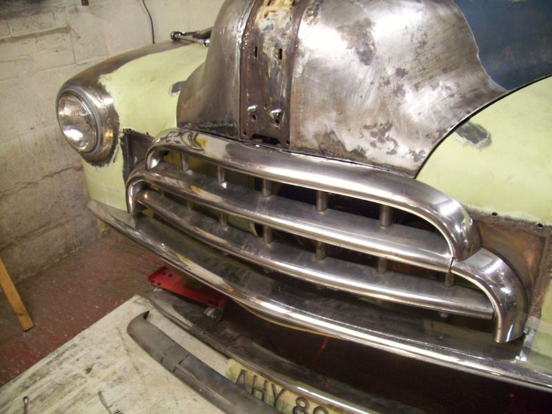

    No stopping me now.
    Some time back a mate had an Oxford M.O. grill as a bit of garage art, which he lent to me with the instructions if you use it you can keep it.
    Thanks Vince.
    A quick mock up, got potential but a little small, if you squint, a bit late forties Caddy don't you think?
    Decided to give it a go with the view to widen out the bottom with an extra bar stretching into the front fenders, first panel tacked in.
    Both filler pieces welded in.
    The slam panel rail I altered to the new grill shape using parts of the original with a few additions, nice and strong now tying the two fenders together.
    Some new mounting tabs welded to the grill and all fits quite nice.
    Picked up a Rover 2000 front bumper on Ebay to use for the bottom bar.
    Scribed the ends into the fenders, but not too keen on how it tapers into the fenders.
    Bidding on another now which I will alter differently for a more pleasing shape to flow with the bumper.
    Quite pleased with the result, I will of course be extending the grill pieces that are short.
    I want to pull the car out into the yard to view properly as at the moment I am crammed up against the back wall, not a good way to make design changes.
    Next job is to reform the nose of the bonnet doesn't look to bad in the photo's but is actually protruding over the grill by about 3/4 of an inch.
    One problem at a time.

    A little more progress on the Poncho.
    After fitting the new grill the bonnet needed shortening by about 3/4" and reshaping on the bottom edge.
    I did this by first making a new bottom lip out of a piece of 16g shaped and bolted to the slam rail, using wooden wedges to keep the contour accurate to the new grill bar.
    Next I slit the bonnet vertically along both sides of the trim recess and then a couple of horizontal slits each side to ***ist in m***aging the new shape before welding.
    Once this was completed a little work was needed on the internal panel that holds the catch, nothing too complicated usual cutting and shutting.
    That's about it for the Poncho nose job not a m***ive task but all progress in the right direction.
    That's not me in the pictures by the way, I'm far better looking! Thanks for the help Harley.
