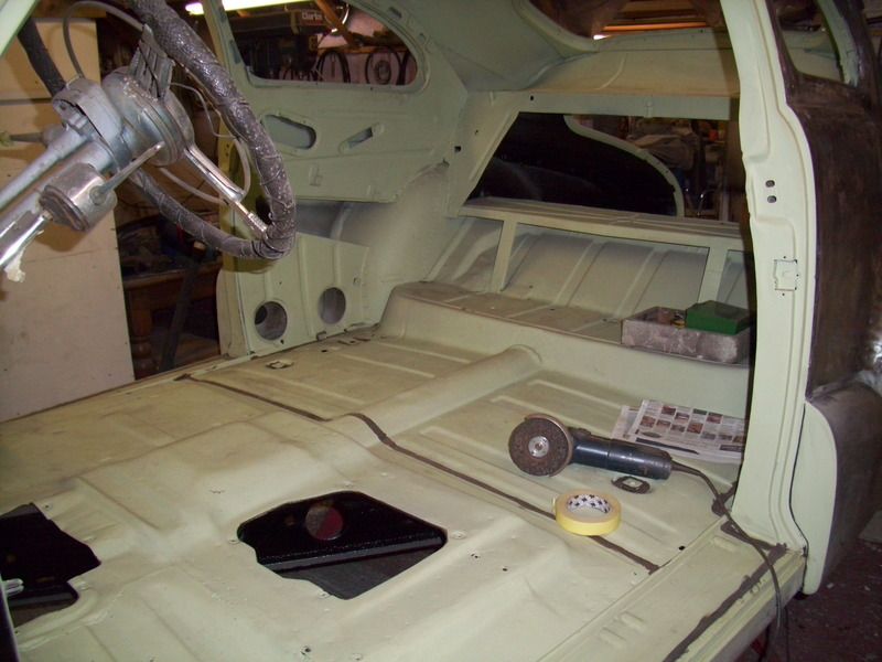

    Boot and interior primed after hours of wire brushing with a grinder.

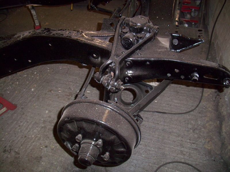

    Front suspension remarkably good condition, all greased and ready to go but I am going to fit some tube shocks to the front
    A question for the more technically minded ,what are these springs wrapped around the drums for?
  14. Fedcospeed
    Joined: Aug 17, 2008
    Posts: 2,011
    Fedcospeed
    Vibration dampen on the drums, ;)and or dirt catchers

    I was thinking along those lines Fedcospeed could they also be a heatsink.

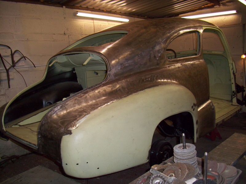

    Body is now filled and totally primed but before the big ***embly there were a few remaining jobs to take care of.

    Next up was find a home for the battery, you may not be familiar with a Poncho's heating system but it is extensive starting under the front fender and finishing with a huge box under the drivers seat, this was all removed and skipped long ago for an extra 10 horsepower, but what it left was a nice convenient hole in the floor ideal for the battery, made up a simple box welded in place soon sorted.
