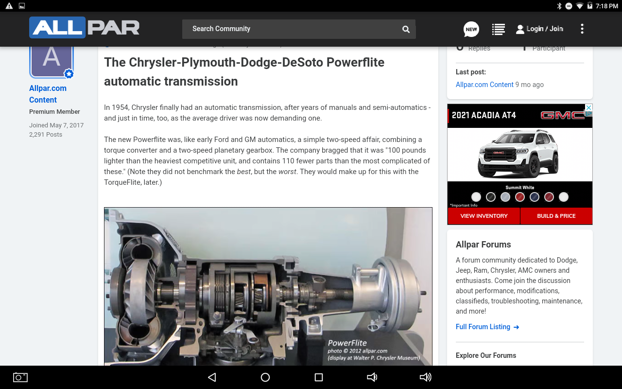

    Don't know if this helps , there's more info in the article Screenshot_2021-08-29-19-18-48.png

    It sounds like you have a M4/M6 Fluid Drive trans, NOT the Powerflite...correct? Do you have a 'clutch' pedal in addition to the gas/brake?
    This ***embly has attaching bolts with nuts on the engine side of the crank flange; this requires a long box-end wrench and skinny fingers to spin the nuts off once loose. I have never seen these nuts rusted or otherwise difficult to remove other than doing them one at a time.
    Now the bad news...if the engine is stuck then you will indeed dis***emble everything else before you can remove the crank with parts attached.
    Yes, there is one bolt that is behind the flywheel. Back it out until it hits the flywheel then cut off the head of the bolt. Back it out again with pliers and cut off another 1/4 inch or so...repeat ...repeat.
    Do not cut it flush against the bell. Once removed, the bell should lift off.
    If the engine is stuck then resign yourself to the fact that the flywheel will stay in place until the crank is out.
