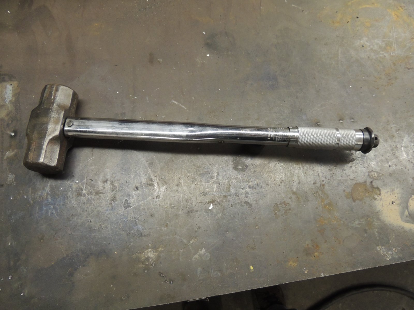

    Here is a picture of my Torque Hammer which lets me adjust the amount of force I use when hammering a panel or stud. Never seen another one like it........
    :p:D:p:D:p:D:p:D:p:D:p:D:p:D:p:D:D:p Just Kiddin!
