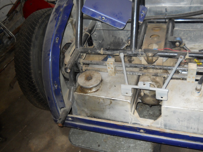

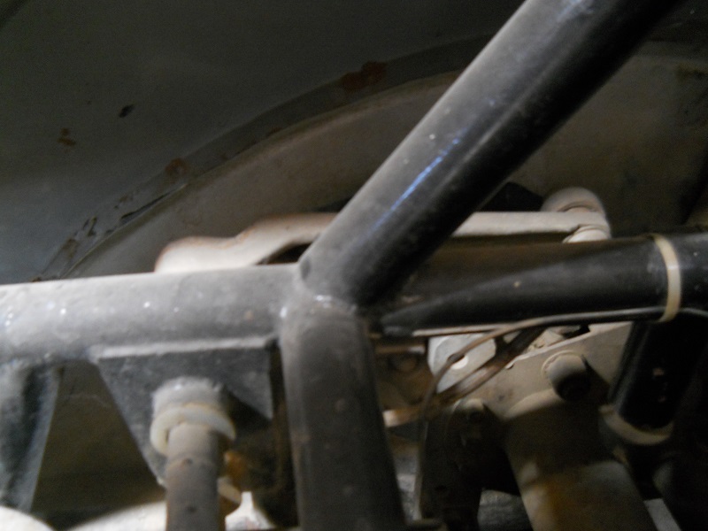

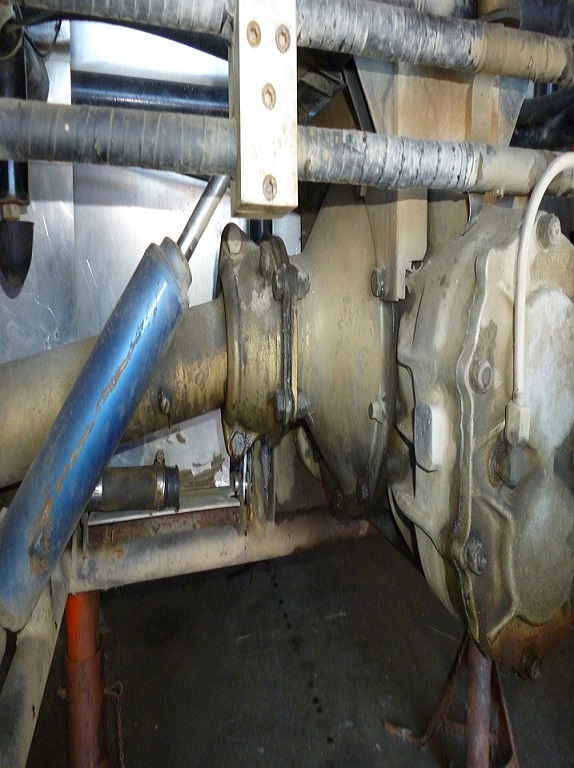

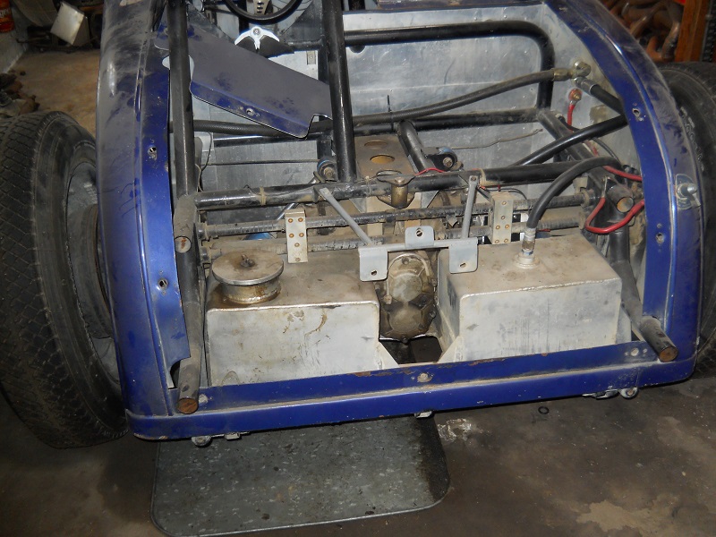

    These pics show one way to mount them. I am building a copy of a famous Track Roadster, so that is why they are mounted on the outside of the rails, on all four corners. PAC Racing Springs (who bought out Gary Schroeder) supplied the bars, arm and stop blanks that where splined, along with the bronze bushings. That way I could trim and shape the parts to my satisfaction. To calculate the size and length of the bars, you generally need to know the weight of the car at all four corners, minus the un-sprung weight, and the length of arms that fit the application. I decided on 8" for the arm length, and needed 26" long bars that were 1" diameter spline. With most of the parts on the car, and some shot bags in strategic places to simulate fluids, I weighed the corners with a set of digital scales, and let PAC send me what I needed. If you can use a standard length and spline on the bars, they are available in small increments and very reasonable for price. IMG_7212.JPG IMG_7213.JPG IMG_7214.JPG IMG_7216.JPG IMG_7217.JPG
