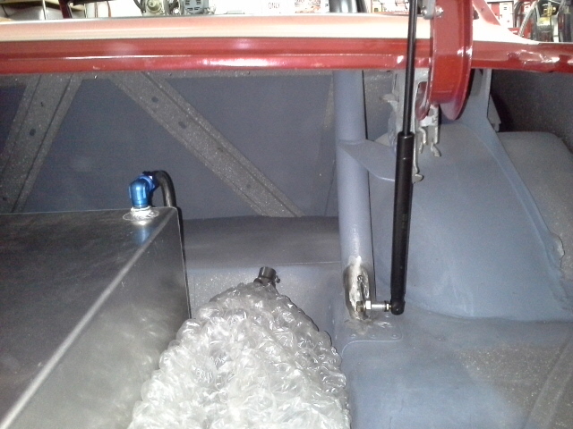

  6. DDDenny
    Posts: 23,012
    I tried to reinstall that @#$%& thing in my 67 Nova, the shop manual says it takes a special tool, the key is being able to stand on your head.:eek:
    So, I built some mounts off the hinges and installed gas struts, they work slick.
    ekimneirbo, mustangsix and mad mikey like this.

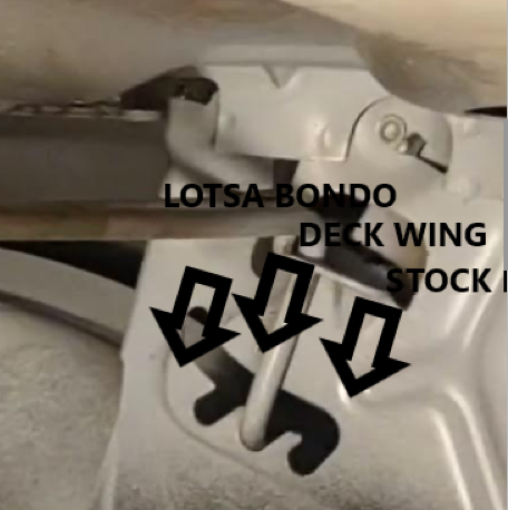

  8. 36cab
    Joined: Dec 2, 2008
    Posts: 963
    36cab
    Maybe this will help?
