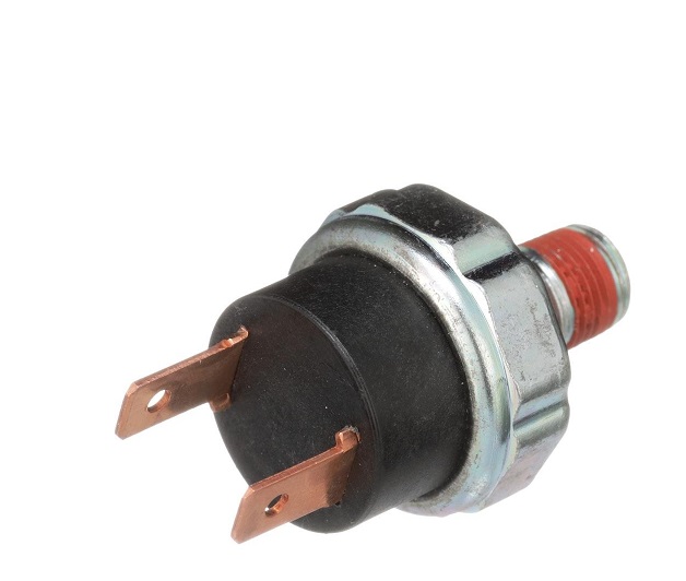

    Why not use the power to the HEI? It's switched power, and should be wired with enough current capacity to supply the choke heater.
    Chevy used an oil pressure switch when they started using electric chokes around 1981, so the choke will only get power once the engine starts. The switch was PS-135 (Standard Motor Parts number).

    you'd need to add the other switch, while keeping your oil pressure sending unit that you already have. Chevy put the oil switch on the side of the block above the oil filter.
