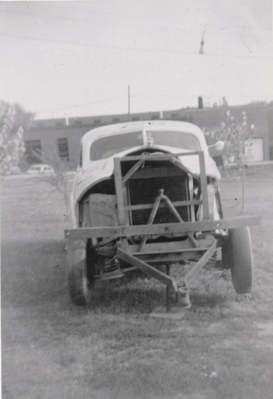

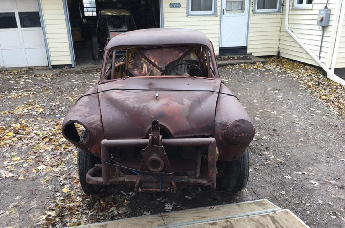

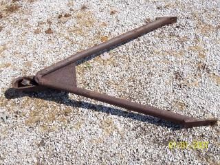

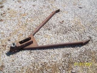

    Lots of back-in-the-day pictures around of race cars with tow bars made from Ford front wishbones.
    Here are a couple of a typical wishbone tow bar saved from an old hamb thread.
    My buddy Mike Gray's Henry J stock car, the Tow Bar is made from the Lowe A frame of the car it has a Ford axle and buggy spring. This car ran the opening night at Fonda 1953!

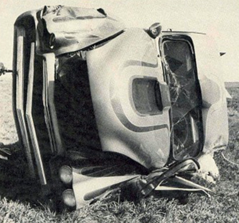

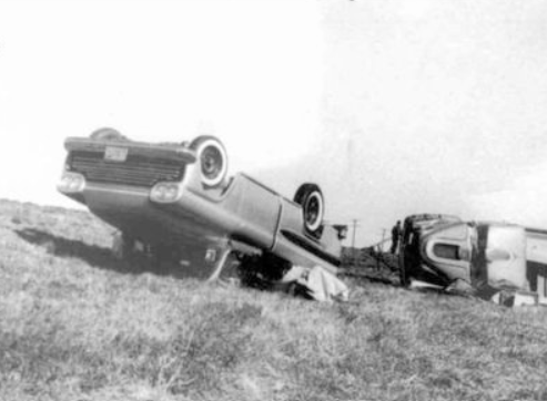

    The Rod and Custom Dream Truck...
    ....this one didn't end well!

    really helpful to see both sides; thank you

    i subscribed to R&C from about 7 years old to maybe 18. i would ask for renewals for birthdays and Christmas - good grief it was $3.50 cents for cryin' out loud. where's a kid gonna cough up loot like that in 1962?
    and i remember the dream truck. maybe here on the HAMB, i've read about its tough life.
