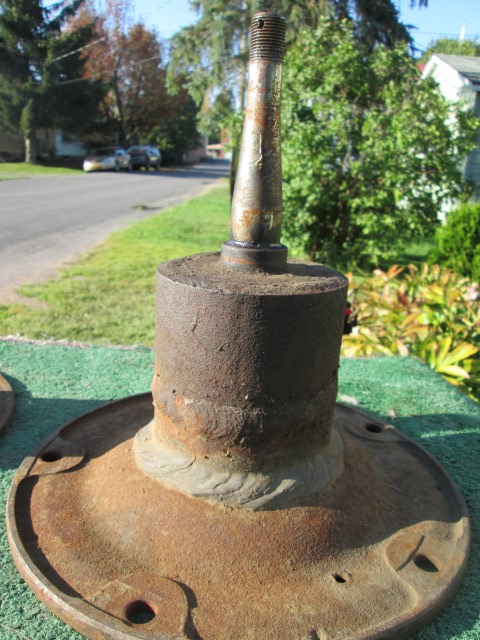

  11. These are a set of homemade tow hubs I picked (along with other parts) from an old time stock car racer’s collection several years ago.
    The wheel stud holes on the stock wide 5 hubs were drilled to slip over the rear hubs on the car, the center was machined out and a piece of pipe was welded on to slip over the floater snout.
    The pipe was capped and a stock Ford spindle end was welded on the capped end, then a stock Ford hub was placed on the spindle end.
    I sold or traded these to another old stock car buddy of mine.

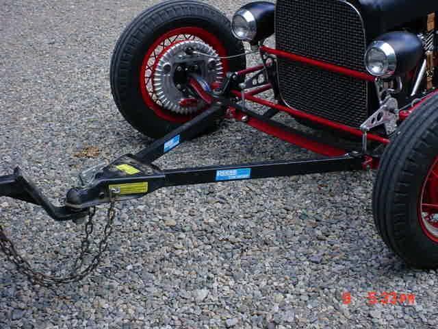

    Used this tow bar for the Zipper as well as several Jeeps. There are a lot of brake boxes on the market for use in cars that are flat towed on a regular basis and comply with state laws. Best source is etrailer.com

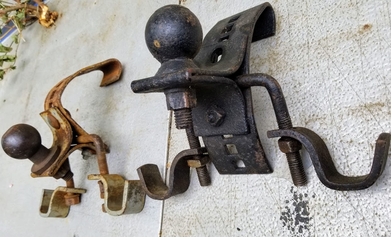

    Back when all my cars had real bumpers,I had clamp on type hitchs{ towed a lot of stuff with it too!
    Even had a one dolly wheel little trailer,that had two bumper hitch hook up as part of the trailer.[​IMG]
