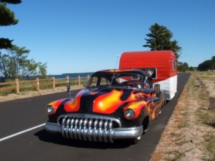

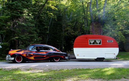

    My old rig. Sold both.
    Now selling a 70 Tag-a-long, and just bought a 62 Serro Scotty.
    Gonna pull the scotty with a 54 chevy truck. And have my wife or daughter follow in the 63 bug I just bought them.
    Ahh, good times to come.:D
