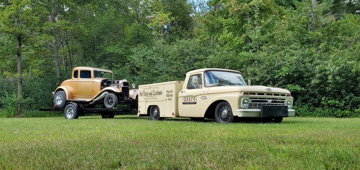

  7. 31hotrodguy
    Joined: Oct 29, 2013
    Posts: 2,699
    31hotrodguy
    I know your set up doesn’t fit in with the H.A.M.B. guidelines but it looks like you did a great job making it work and the truck looks great!!!

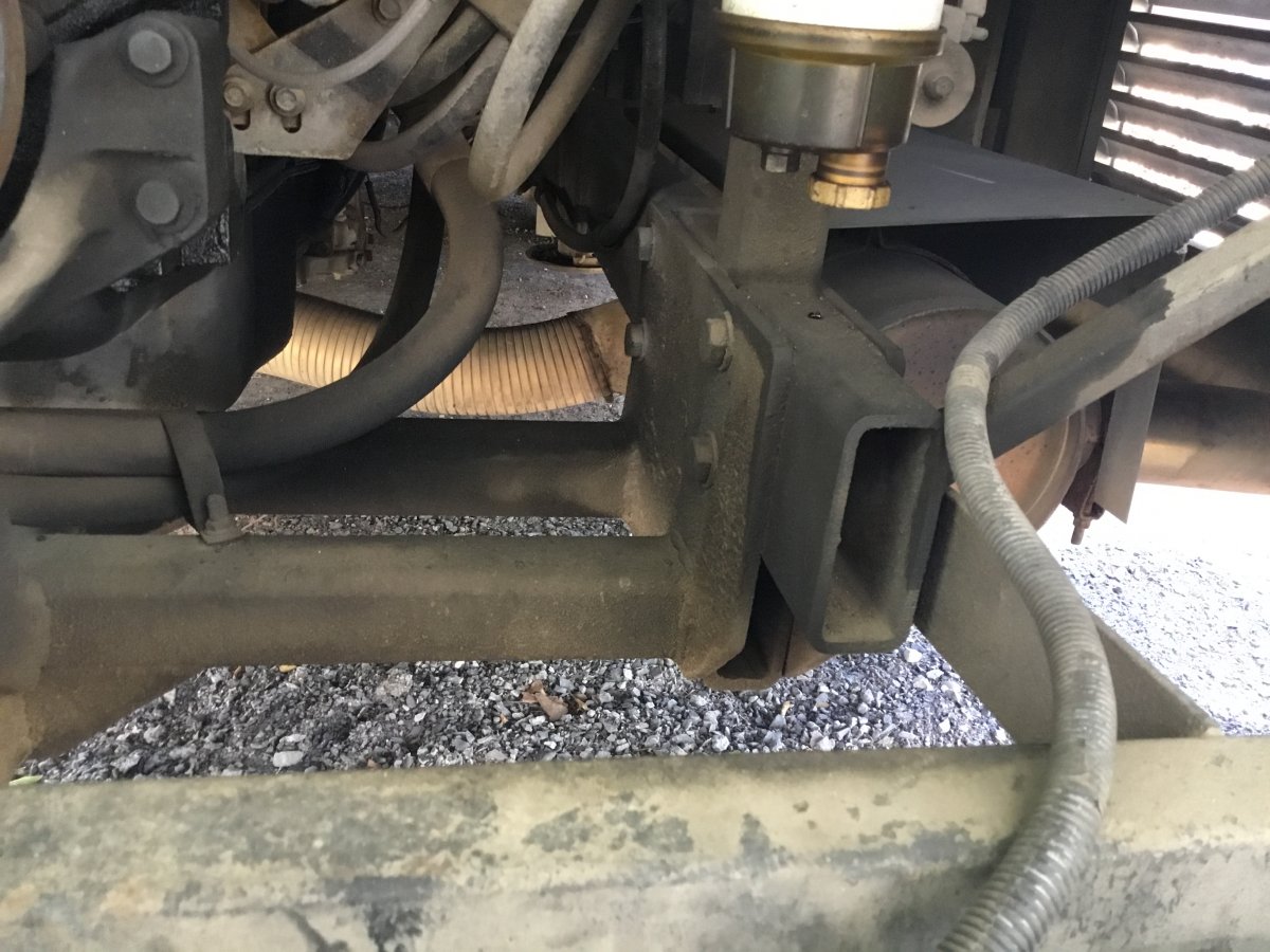

  28. Boneyard51
    Joined: Dec 10, 2017
    Posts: 6,838
    Boneyard51
    Finn, I understand and you are right. But upon inspection of my motorhome , frame, hitch, cooling it just appeared to me them company that made the motorhome were just covering their ****s in case of accident, due to most motorhome drivers are usually inexperienced drivers, by underrating the towing capacity. Another thing caused by lawyers and judges! .
    I will be towing close to 10,000 lbs behind my new motor home.
    Bones
    chryslerfan55 and 31hotrodguy like this.
  29. finn
    Joined: Jan 25, 2006
    Posts: 1,624
    finn
    You may be ok....I don’t know.
    I do recall severe cooling issues with school busses with rear engines. Remember, it’s not only what the hitch and frame will handle, and very few manufacturers are willing to throw away a marketing advantage that a 10k rating would have over a 5k rating.
    Good luck, though!
    chryslerfan55 and Boneyard51 like this.
