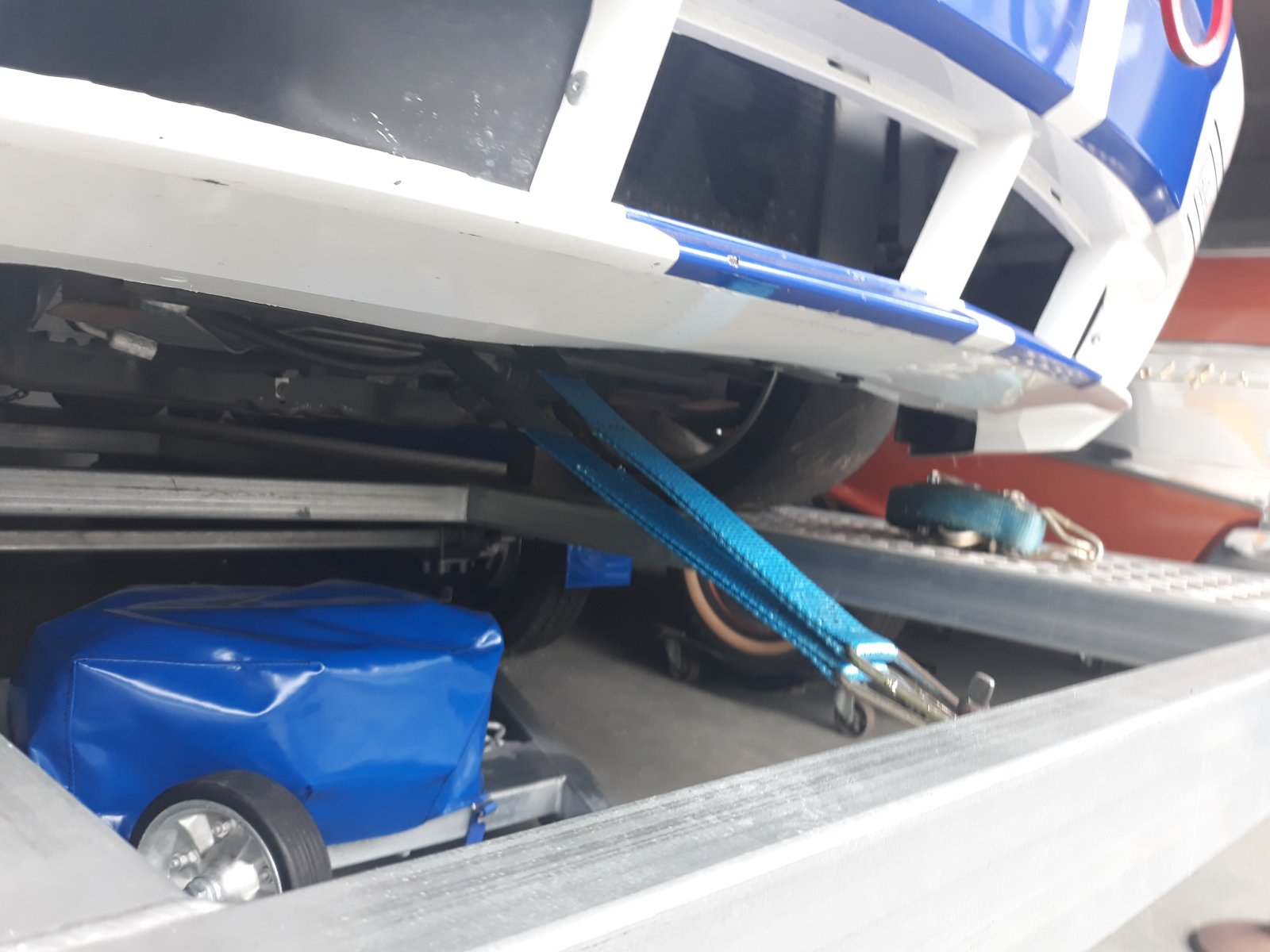

    You can buy these, Racers bolt them to their vehicles [you can leave them hanging down in the breeze and you don't "Shin" yourself]
    On my Lotus Cortina, I used an Engine Lift Eye from a Mazda 323 and bolted it to the anti-roll-bar mount.

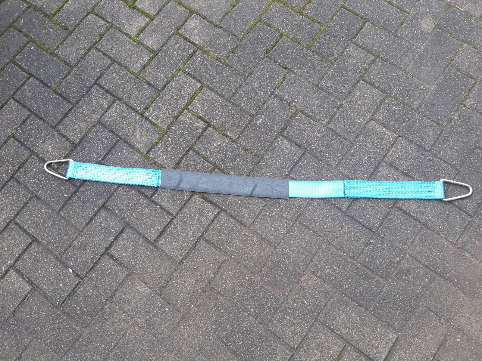

    I sewed up one of these from some excess webbing cut off a ratchet tie down. I used a "keeper" at each end which I can shackle together.
    Just leave one of these in the trunk , plus you can use it on multiple vehicles [simply wrap it around the cross-member]
